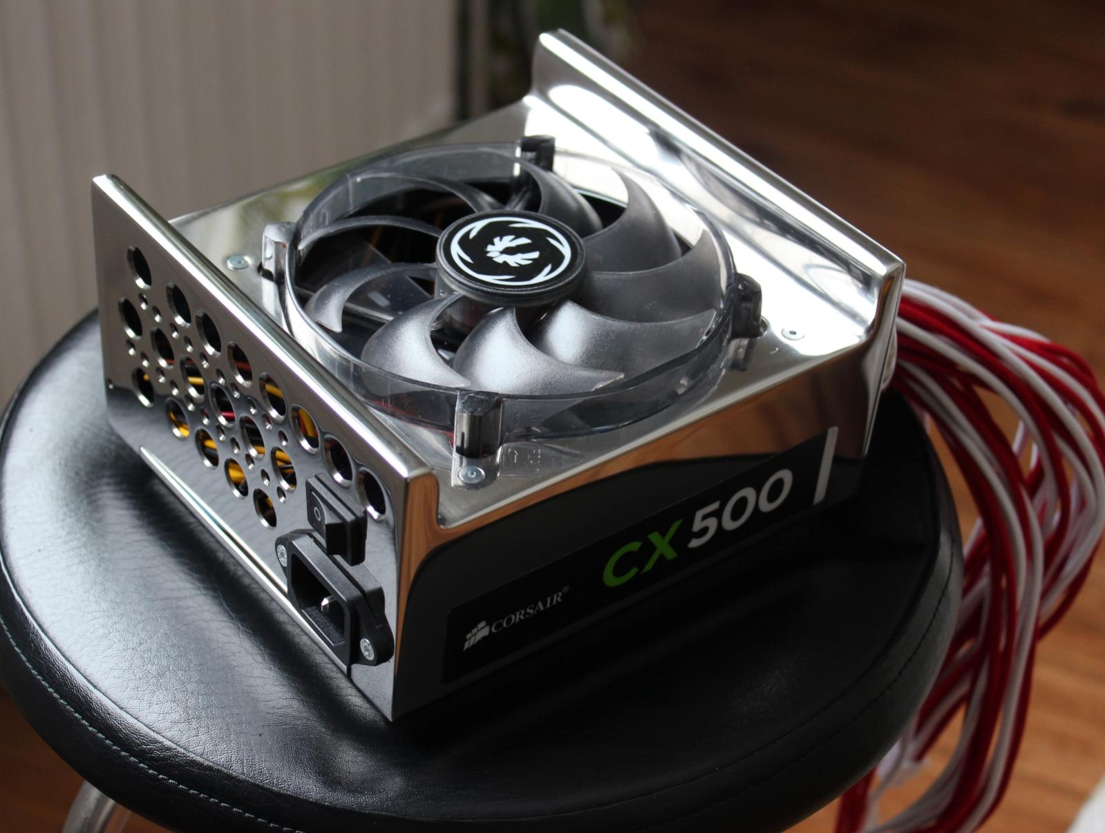

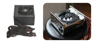

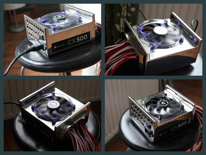

    Wanted to get nicer look for my cheap psu.

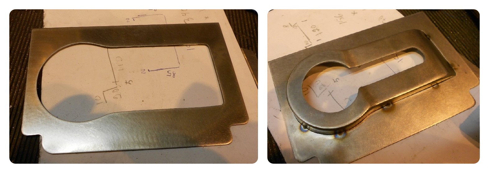

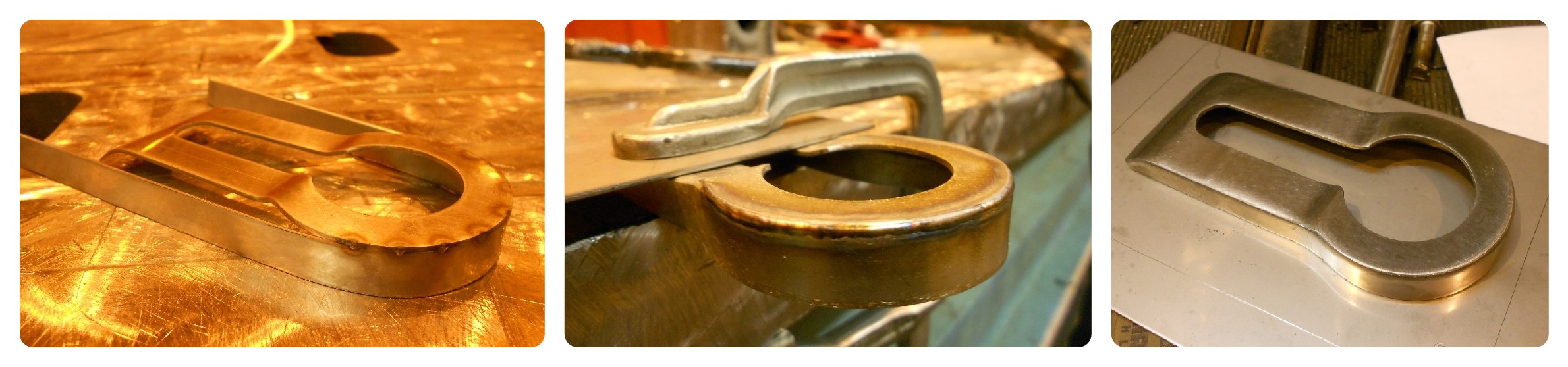

    So i made new casing for it from stainless steel.

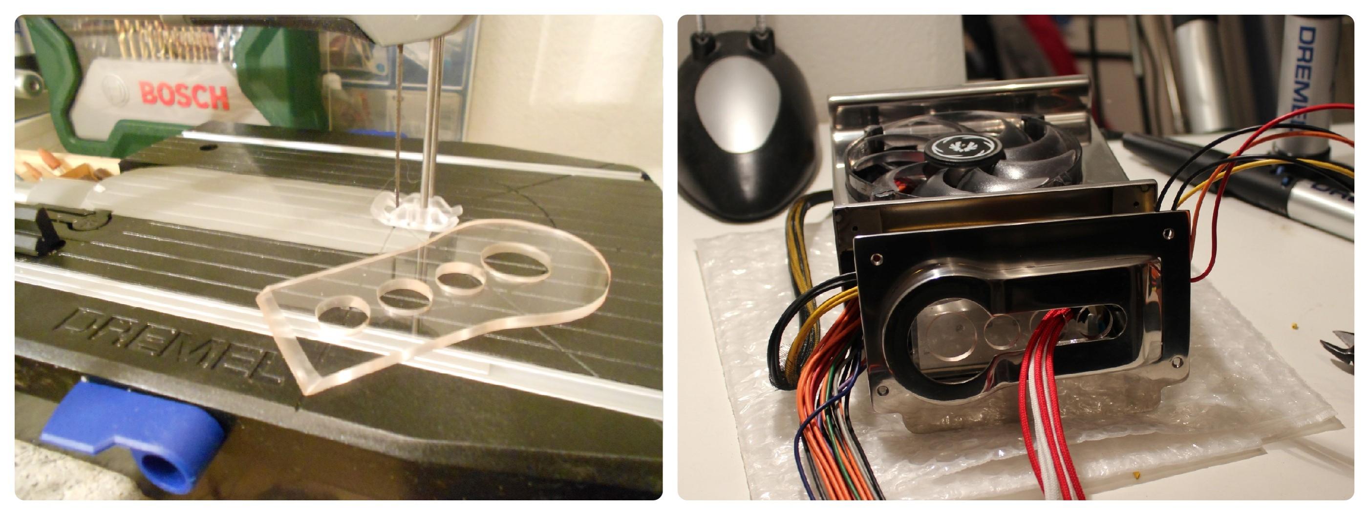

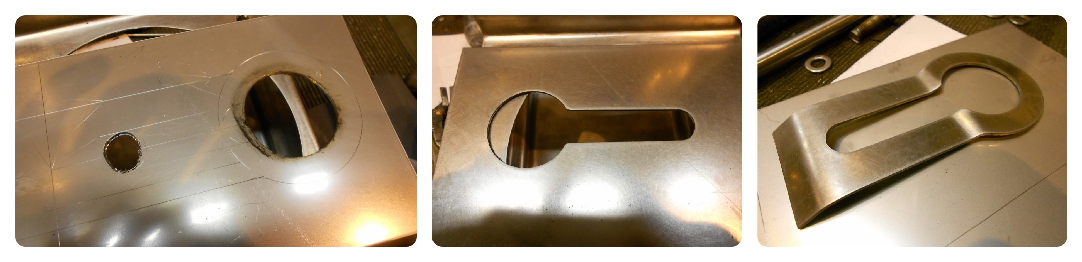

    Used angle grinder and dremel for cutting.
    Holes are made with drill, bigger holes are largened with sanding drums and tungsten carbide cutters.
    Used tig for welding.

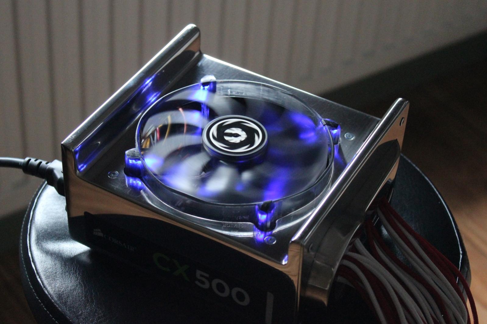

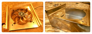

    Fan is also re-shaped. Cut and grinded smaller.

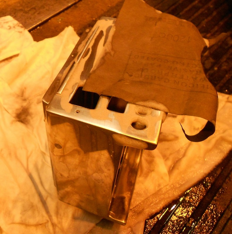

    Finally polished with wax and felt disk.

    Wetsanded and rewired to get nicer look.
    I also changed the caps for better ones.
