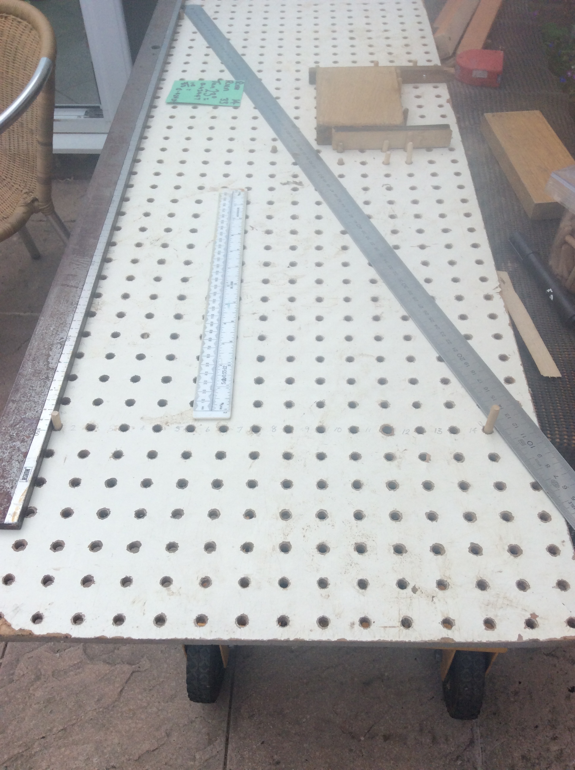

    About 40 years ago, I salvaged a lot of pegboard from a shop refurbishment. I put 3 sheets over my first workbench. This was not an original idea, since it was first published in “Fine Woodworking.” Reprinted in “Proven Shop Tips” The contributor was Dennis J. Teepe.

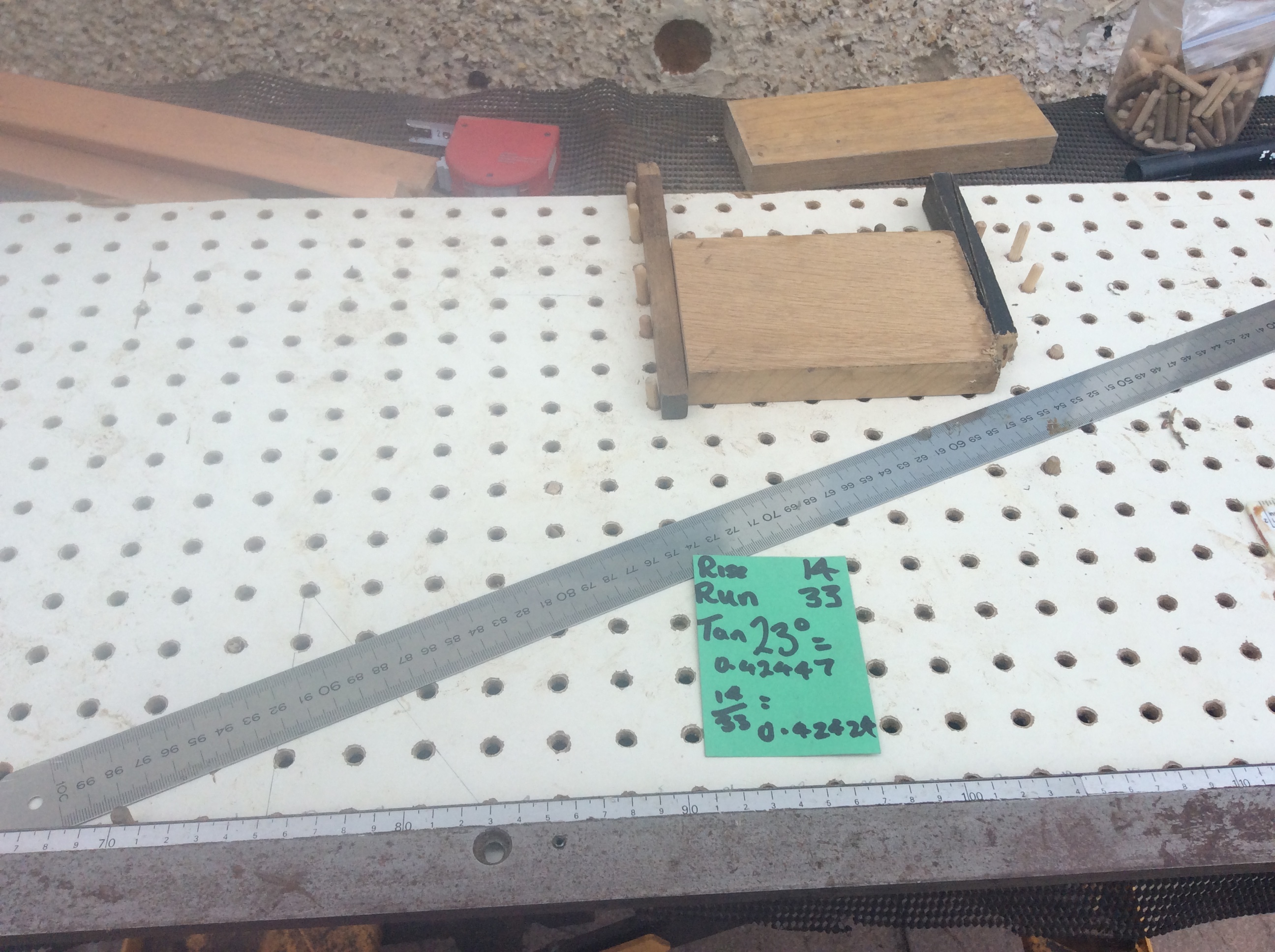

    At the time I was going to night classes at Reading Tech college, training in Carpentry & Joinery, especially interested in roofing geometry, where sometimes the pitches are given in Rise and Run, where rise is the Opposite, Run the adjacent and the rafter is the hypotenuse.
    Purely as a intellectual exercise, I drew up a table of all degrees from 1- 44. The angle formed by the straightedges above is 23 degrees, having a rise of 14 & a run of 33.
    I have never used this chart. All the fractions are within 0.002 of the tangent. Is it actually of any use to anybody?
