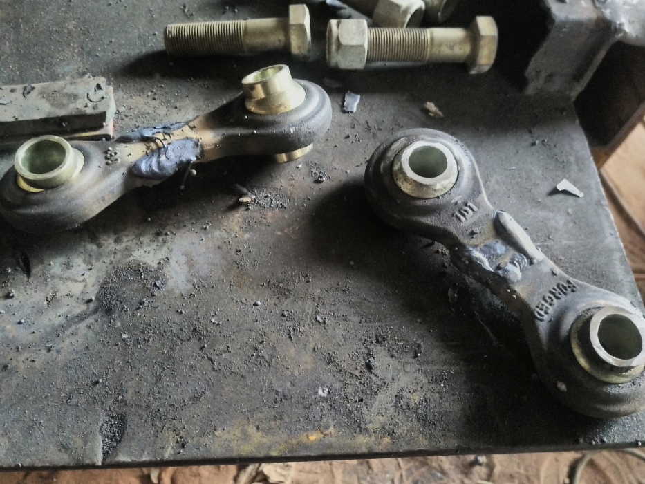

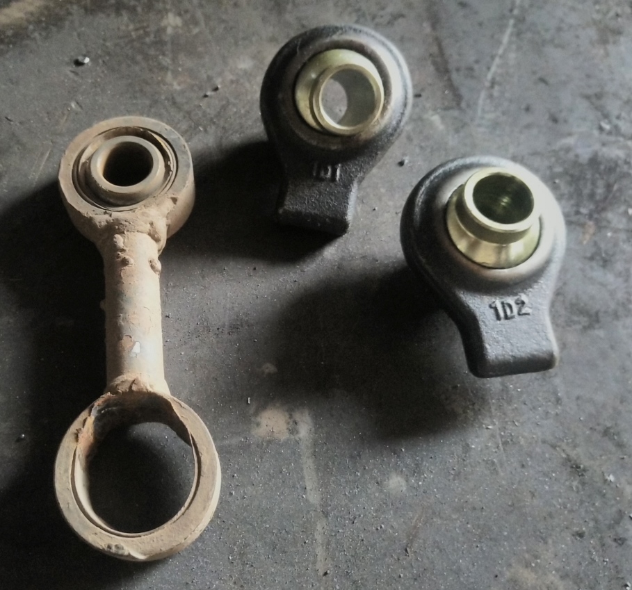

    A Pete came in yesterday with the lift axle touching the ground on 1 side and 6" off the ground on the other. The guy said he had, had it in the Pete shop for some other repairs but they told him they couldn't get the parts to repair the lift linkage for 4 months. He said never mind I know a guy who can probably make the parts and have it back on the road in a couple of days.
    I looked at it and said yeah if I can get the things I need from tractor supply I should have it done by tomorrow.
    Went to T&S bought 4 weld on ball ends for a 3pt hitch and 4 new bolts called him last night said it was ready.
    The old dog bone from the left side and the weld on ends, the one on the right side was broke off

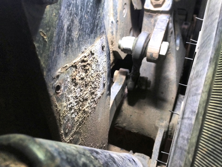

    installed
