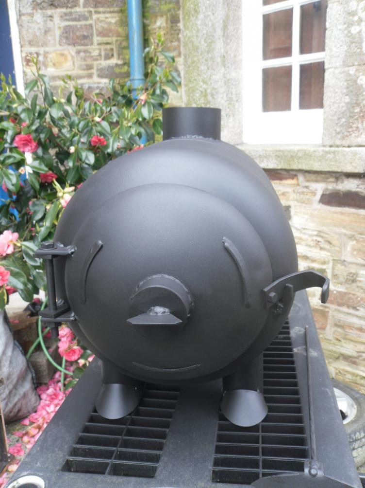

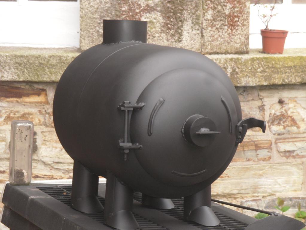

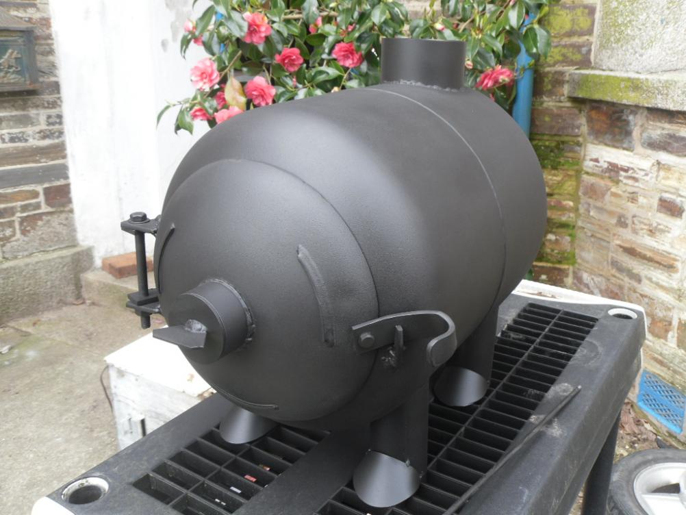

This was made for a friend, the first of many Piggies!
I have seen Piggy burners before but I took it one step further and added feet :D

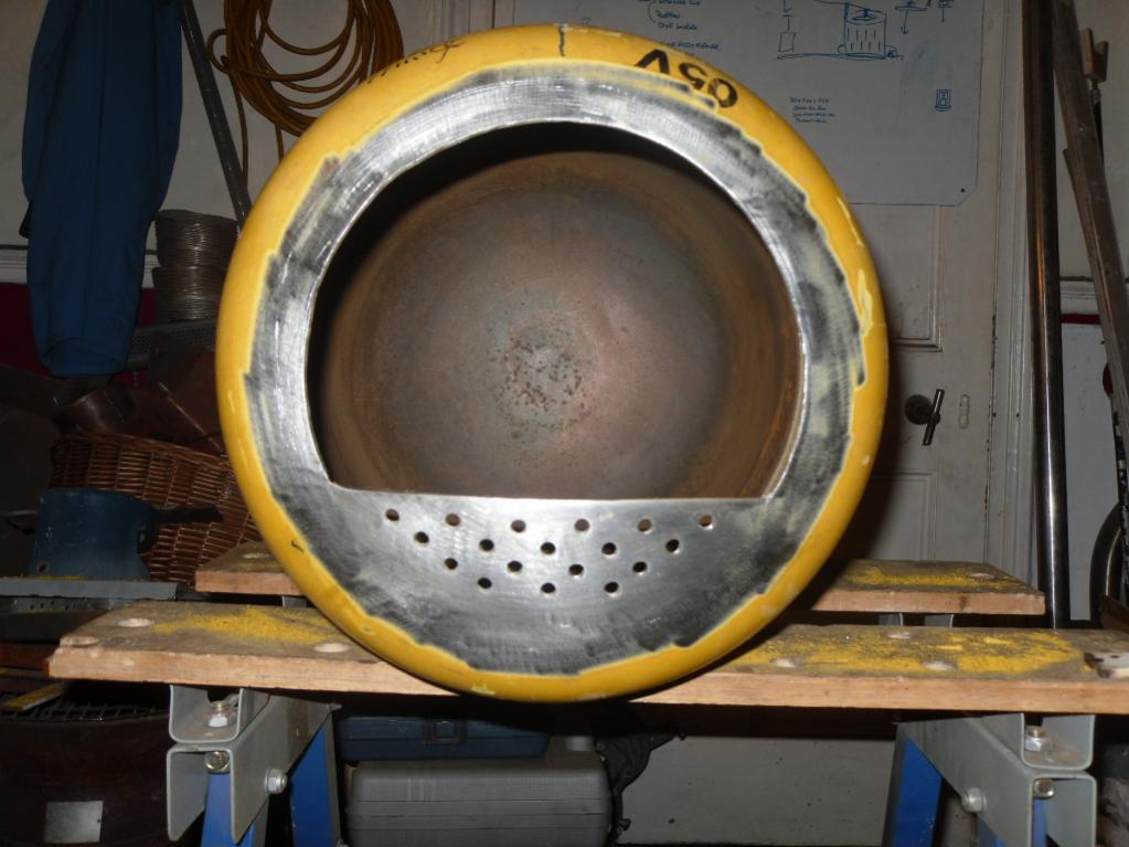

It has a 4" flue and was fitted into an existing fireplace. In the last photo the holes drilled just behind the door stop embers dropping out when you open the door.
Once it was all painted it looked so good I wanted to keep it..
