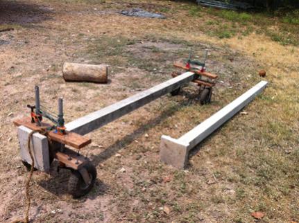

Had to build a roof over the "patio" area of our home in Thailand and didn't want the excess baggage of brothers-in-law helping. So came up with this DIY precast cement pillar mover. Solid wood with wheels, holes drilled through and pipe clamps. Extra wrap with line so that the pipe clamps didn't loosen up. Works like a charm. Attachment 1548
