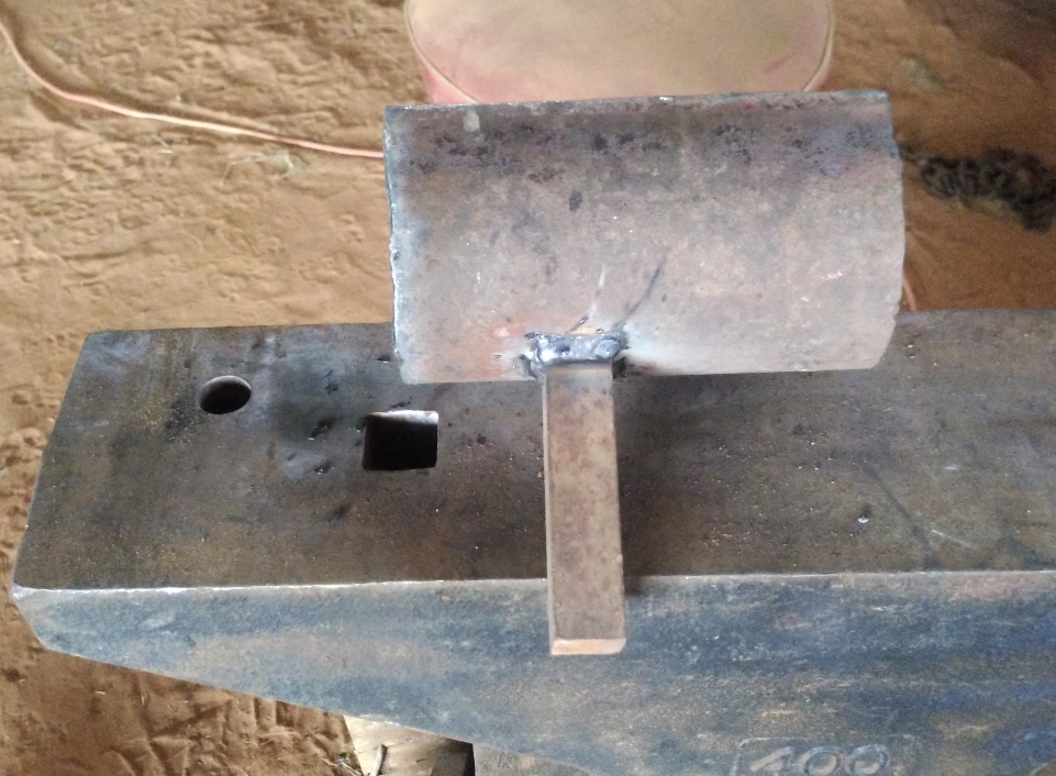

I was getting ready to rebuild a muffler but needed a way to hold the exhaust pipe while I punched louvers in it
I made this saddle and welded a piece of sq bar to it to sit in the Hardy hole on my anvil
Attachment 42562

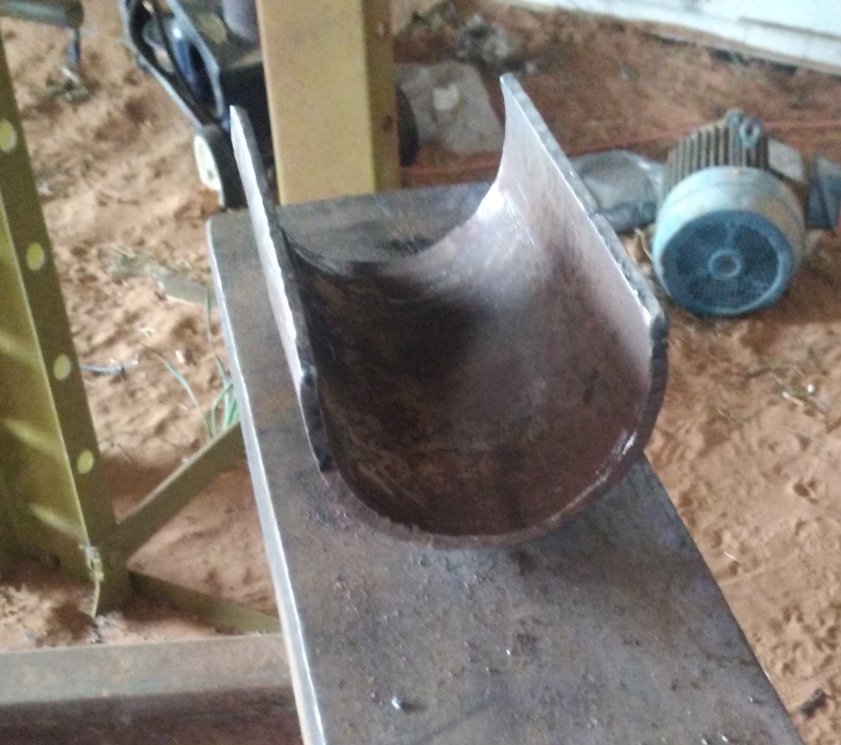

I used a piece of 4inch pipe cut out a section from the length then hammered the edges until it made a deep saddle
Attachment 42563
