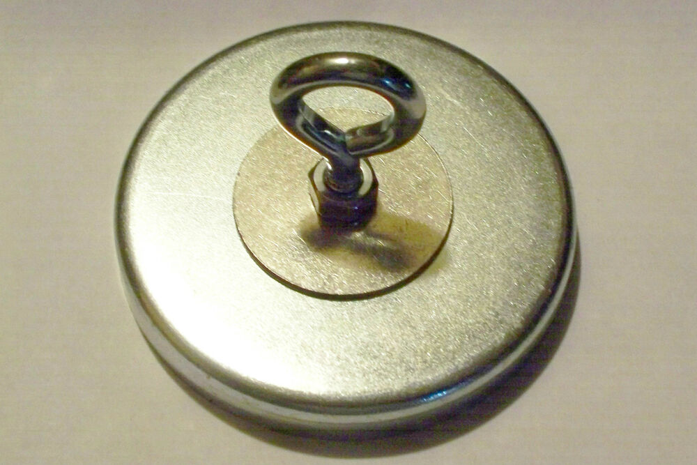

Hi Cap. I like your new machine and I think you may have already seen a tweak or 2 that you may want to incorporate if you want to cut multiple disk at any single session.
1 would be you probably noticed you may want a quick arbor.
One way to accomplish this would be to attach one of these
Attachment 34962
to the arbor that you screw into the drive. For most disks this could be a reasonably small one since they are very strong. then all you would need to do would be to lay the piece of metal on the magnet adjust for your diameter and cut to change parts just lift the finished part away and slap another in place.
To insure you had your part perfectly centered you could allow the arbor shaft to extend above the magnet just enough for the center hole to locate center. But for disks that you did not want or need a center hole use a shortened arbor which does not protrude.
I noticed something about the cutting process in your video which I feel you may have done for demonstration purposes you allowed the plasma to continue cutting through several complete revolutions. with speed control the plasma would make the cut in a single pass. For demonstration purposes going round and round does make a spectacular show but can be a bit misleading for a viewer who may never have used a plasma causing them to think that maybe plasma is not all it is cracked up to be, also re cutting over and over just induces more heat into the part and can cause it to be distorted when cooled this erodes the electrode and the nozzle pieces rapidly making your cuts more costly.
And one tip I might include if I may. If you will adjust your torch so the tip is closer to perpendicular to the workpiece or only very slightly angled into the cut the quality of cut is greatly enhanced plus the consumables will last longer as well.
This was not intended to be any criticism to you your machine or your video and please do not take it as such. just a few friendly comments you can use or disregard. And as always keep up the good work on your tools

Hello Frank S. Good eye Frank, Yes, I was trying to think of a better way to attach the blank, your magnet Idea is the best with the stud protruding up a bit to ketch the blank hole much better. The reason is spins too fast is I underestimated the speed of the voltage regulator I bought, that is as slow as it goes so many passes is the only way unless I get a gear reduction motor. I will work on that.
I also noticed the blank was wobbling for some reason it is not level to the horizontal I think your magnet idea will fix that too.
I Really appreciate your input and thank you very much for the time you put into looking at this project. Feel free to chime in any time as better ideas work better..,,,Cap.

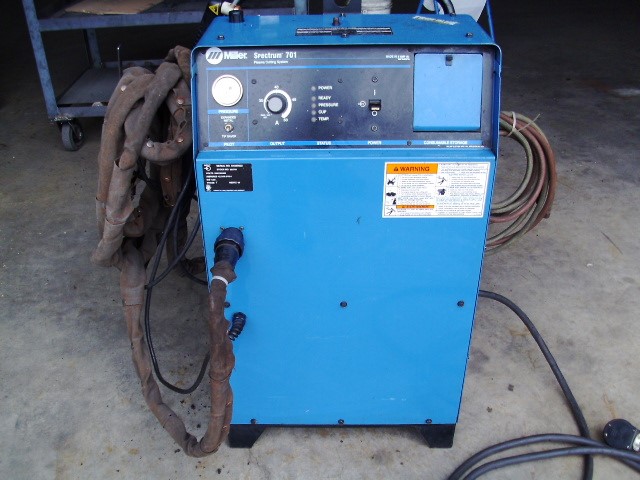

My Miller spectrum plasma cutter will cut through 3/4" mild steel but the IPM (inches per minute) would be 20" or less, it will cut 1/8" mild steel at up to 120 IPM.
Even at that if I were to cut say a 1/8" thick disk 6" in diameter on a circle cutting machine such as yours it would have to rotate at 6.6 RPM max.
Here is a picture of a plasma machine exactly like mine
Attachment 34969
Your plasma machine is probably quite a bit smaller, if so it would have a slower IPM rating as well. Additionally your machine appears to be rotating around 50 RPM and it looks to be direct drive from the gear motor you possibly might want to consider creating a 10 to one reduction to do this cheaply find an old 18 speed bicycle use the largest peddle sprocket and the smallest wheel sprocket this should get you a lot closer to the desired RPM and would be relatively simple to incorporate on your machine. If it turned out not to be enough then add a jack shaft with 2 additional sprockets
I know it is not optimal but at the same time a quick simple solution
I ll give that some thought....Thanks....Cap.
