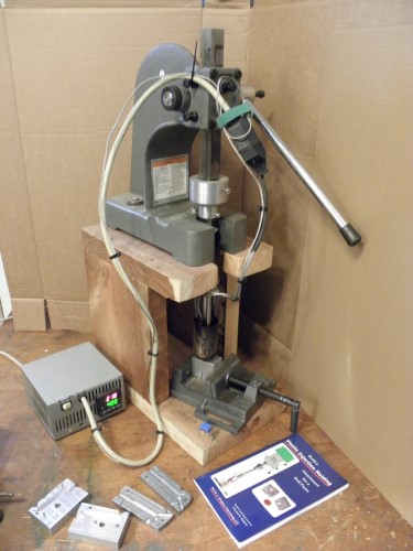

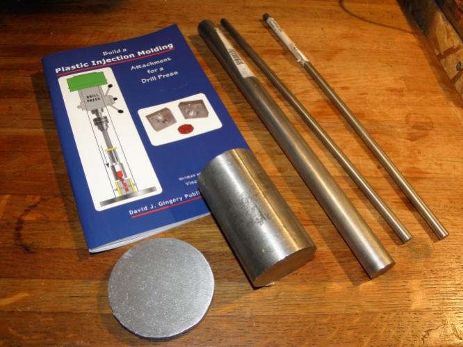

Homemade plastic injection molding machine. Made by following plans from Gingery publishing Plastic Injection Molding Attachment for the Drill Press. The plans specify using a drill press to apply load to the injection molders cylinder. I have mounted my injection molder to a 1 ton arbor press that is positioned on a stand to allow the injection molding cylinder to hang below the arbor press.

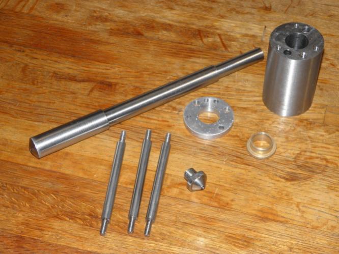

Start with stainless steel stock:
Attachment 3282
Machine the basic mechanical components:

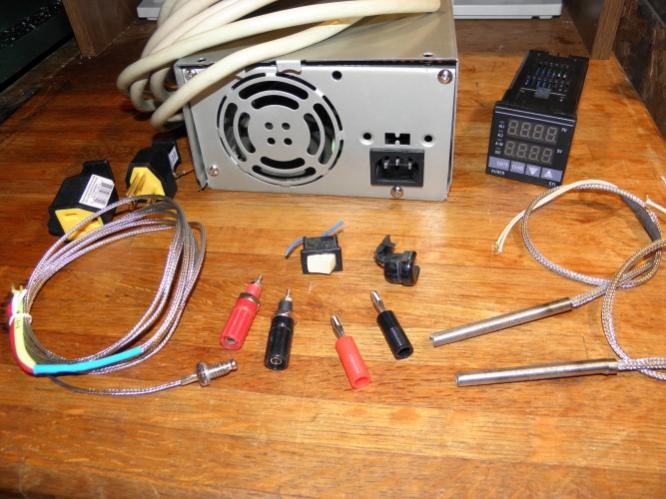

Collect electrical components:
Attachment 3284

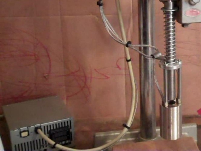

Assembled components attached to arbor press:
Attachment 3286

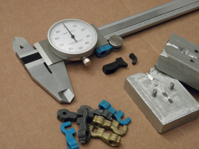

Injection molded repair part (thumb roller hook) for dial caliper (original broken part shown below caliper in picture.):
Attachment 3287

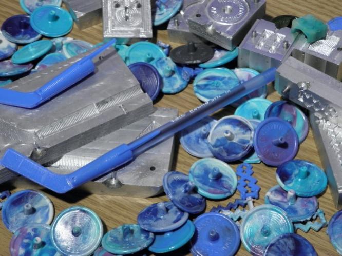

Misc. other injection molded parts/molds:
Attachment 3288
