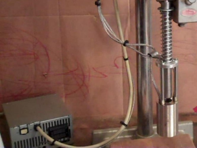

    Homemade plastic injection molding machine. Made by following plans from Gingery publishing Plastic Injection Molding Attachment for the Drill Press. The plans specify using a drill press to apply load to the injection molders cylinder. I have mounted my injection molder to a 1 ton arbor press that is positioned on a stand to allow the injection molding cylinder to hang below the arbor press.

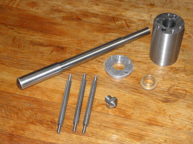

    Start with stainless steel stock:
    Machine the basic mechanical components:

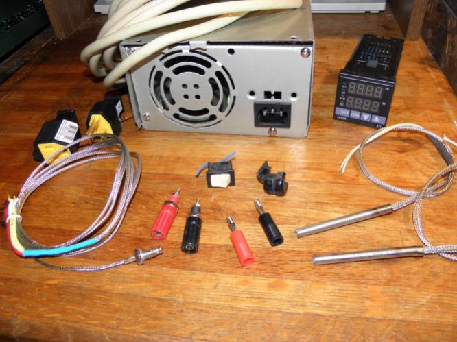

    Collect electrical components:
    Assembled components:
    Assembled components attached to arbor press:

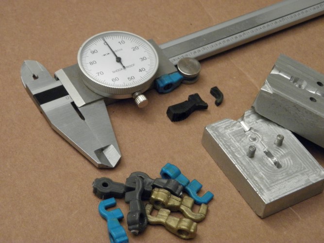

    Injection molded repair part (thumb roller hook) for dial caliper (original broken part shown below caliper in picture.):

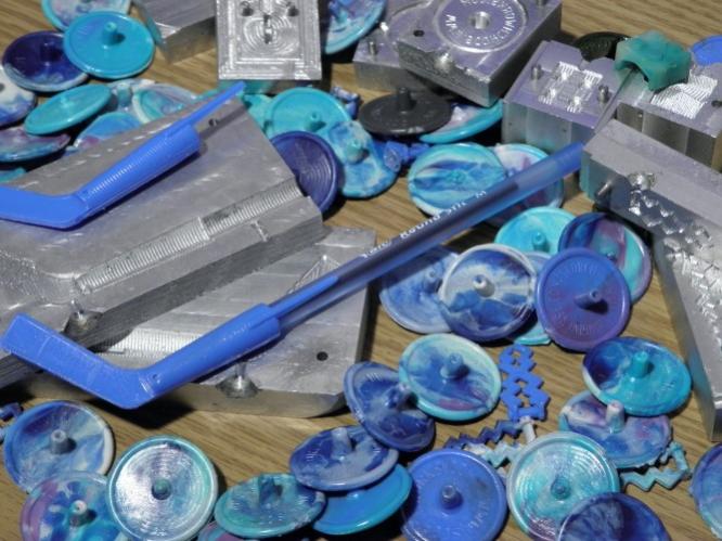

    Misc. other injection molded parts/molds:
