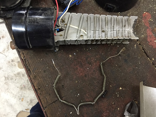

    So as usual research as to how to make a hot wire cutter. Needed some Nichrome Wire...

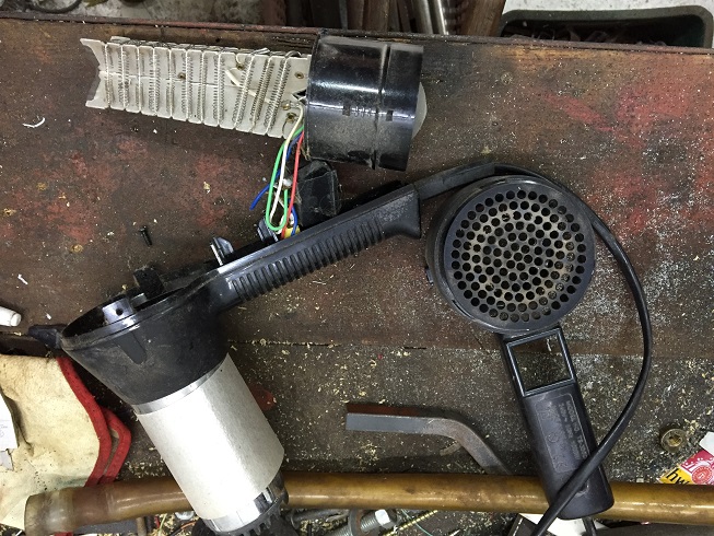

    Where to get it...toasters, hair driers, old irons... Wife has a hair drier....Will she notice if I remove one of the heating elements??
Name:	blow drier 1.jpg

    After careful investigation I removed one element.
Name:	element removed.jpg
    Perhaps after the cleaning the hair drier will actually work better as it will definitely blow stronger. Filter at the back was totally blocked.
    Wire turned out to be 26 gauge.

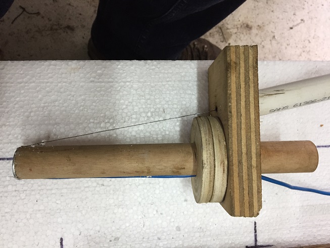

    Then to build the little cutter to accommodate the 75mm net pots I drew one out and was going to use a 25mm broomstick as the pivot so extrapolated the angle to determine the length of the broomstick.
    So how it works, I cut 25mm holes in the foam,and then power up the cutter. The broom stick fits nicely in the hole. I then just slowly rotate the broom stick and the angled wire cuts a perfect cone shaped hole in the foam.

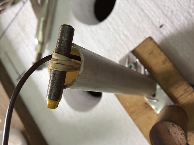

    To keep the tension on the wire once it is warm I fitted 2 elastics on the one end of the wire and pulled then tight in a piece of condute and secured with a steel pin on the other end. I cut the condute at the same angle as the wire to pull in the same direction as the wire.
    To stop the wire burning the broom stick at the bottom I first fitted a 25mm washer, the same at the top a piece of scrap ali plate.
    I fitted 2 wooden washers under the top support. this was in the event that I wanted to cut different sized holes. Then I only have to remove the washers.
    Perhaps this explains it better.
