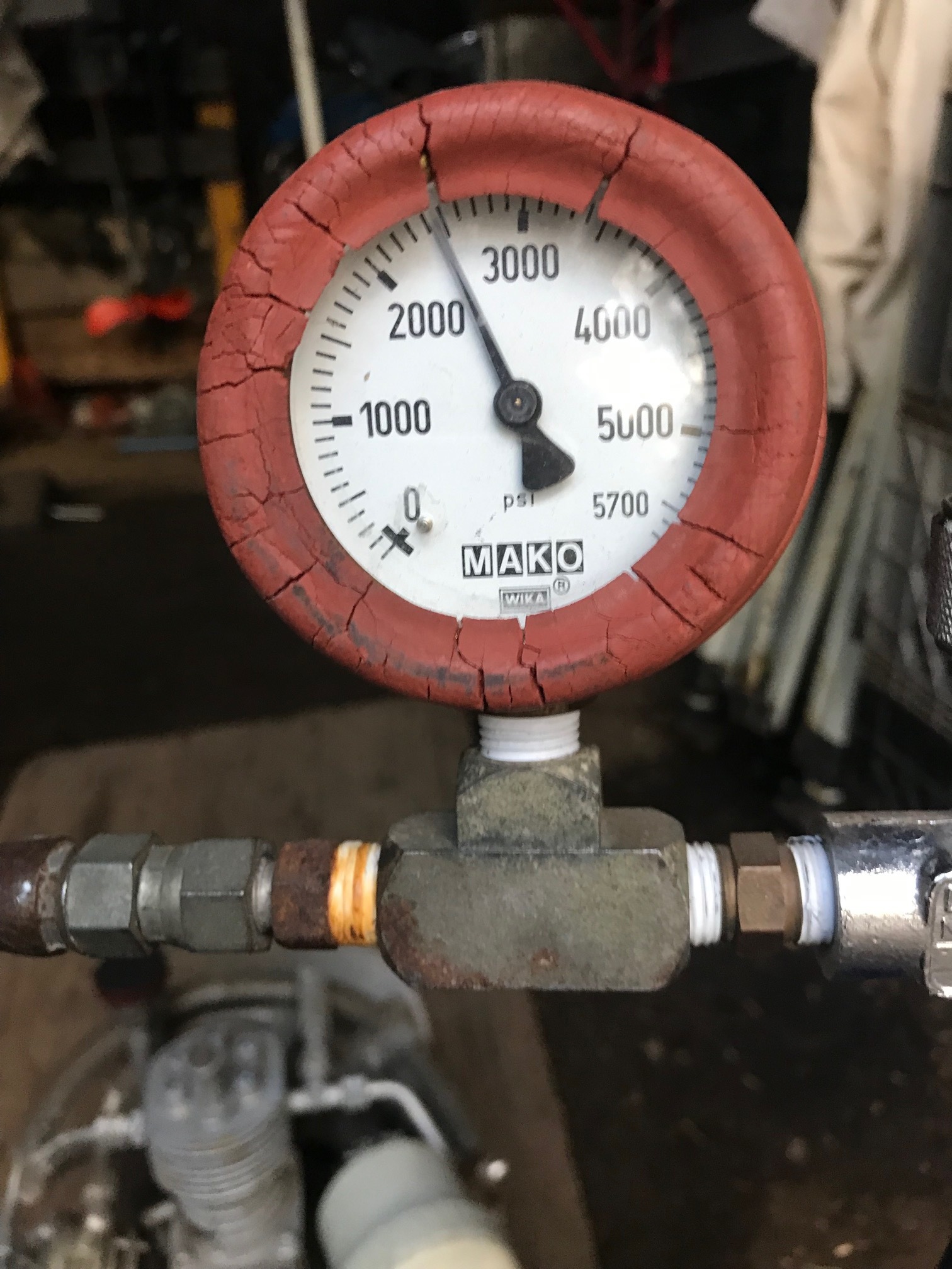

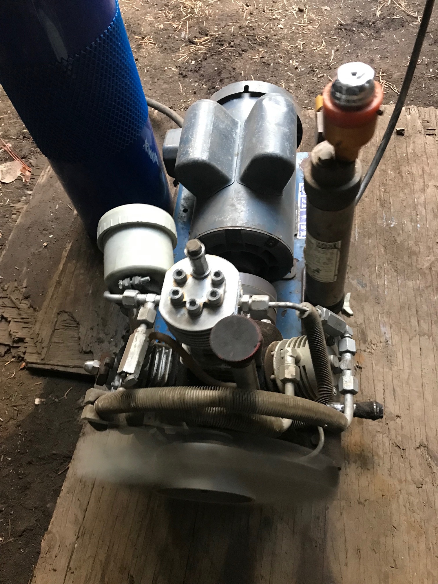

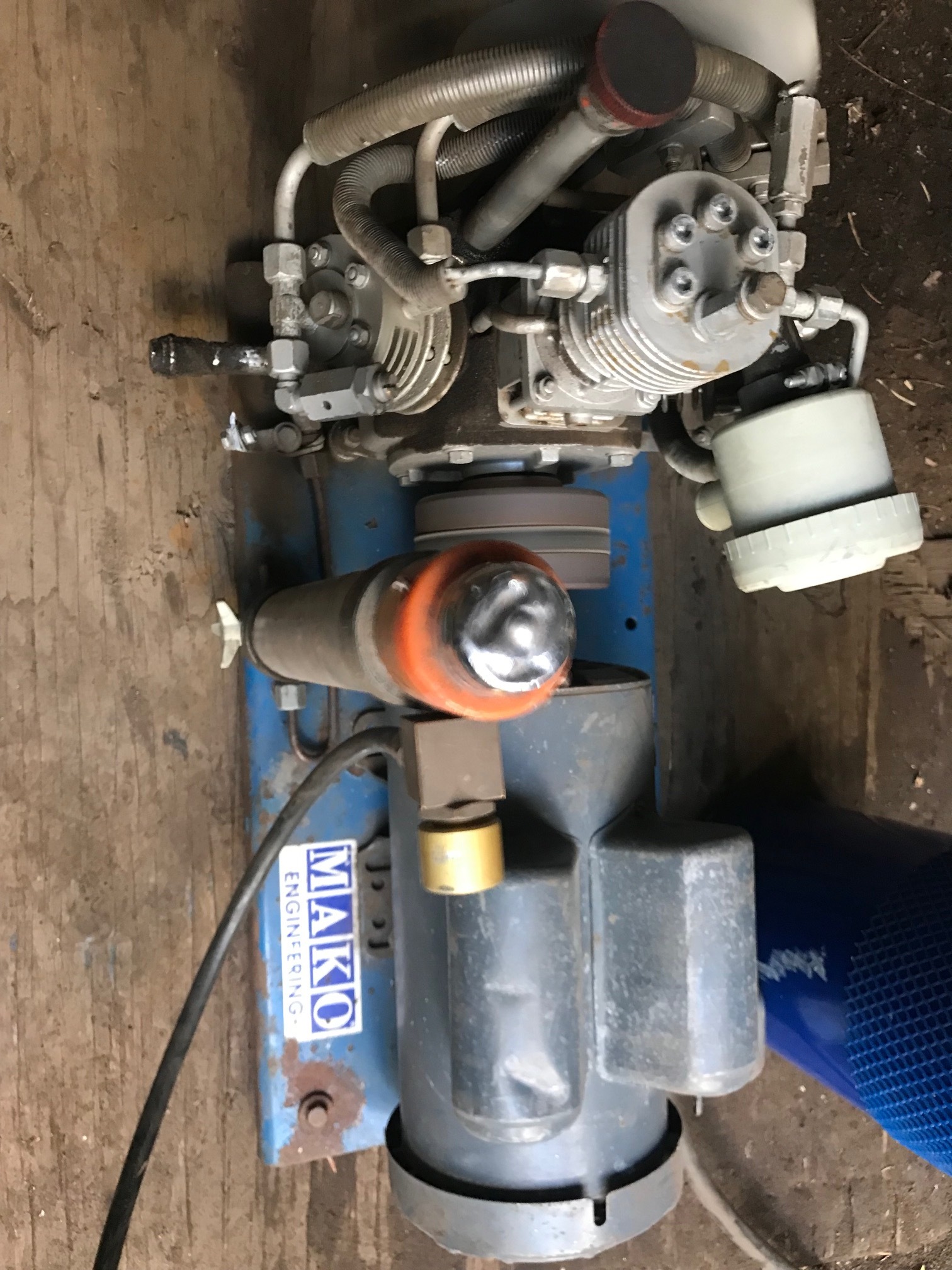

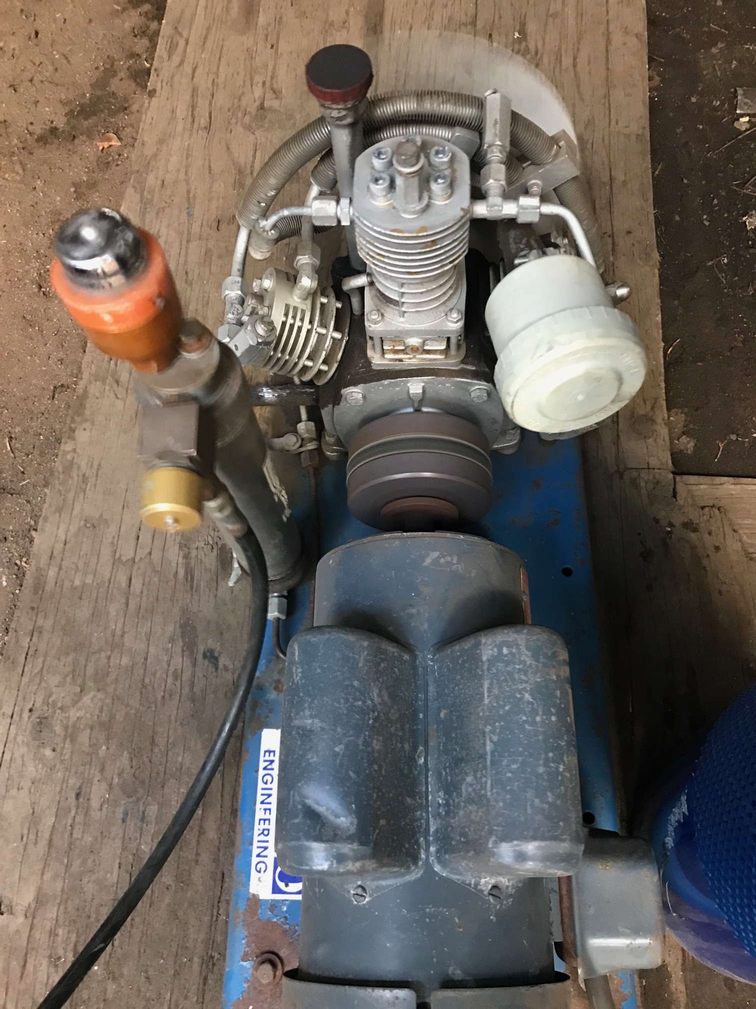

Here is a easy way to have compressed air whenever and wherever you need it. First you will need an air compressor capable of pumping up to 3000 psi(207 bar).
Attachment 40996 Attachment 40997 Attachment 40998
I use an old MAKO compressor.

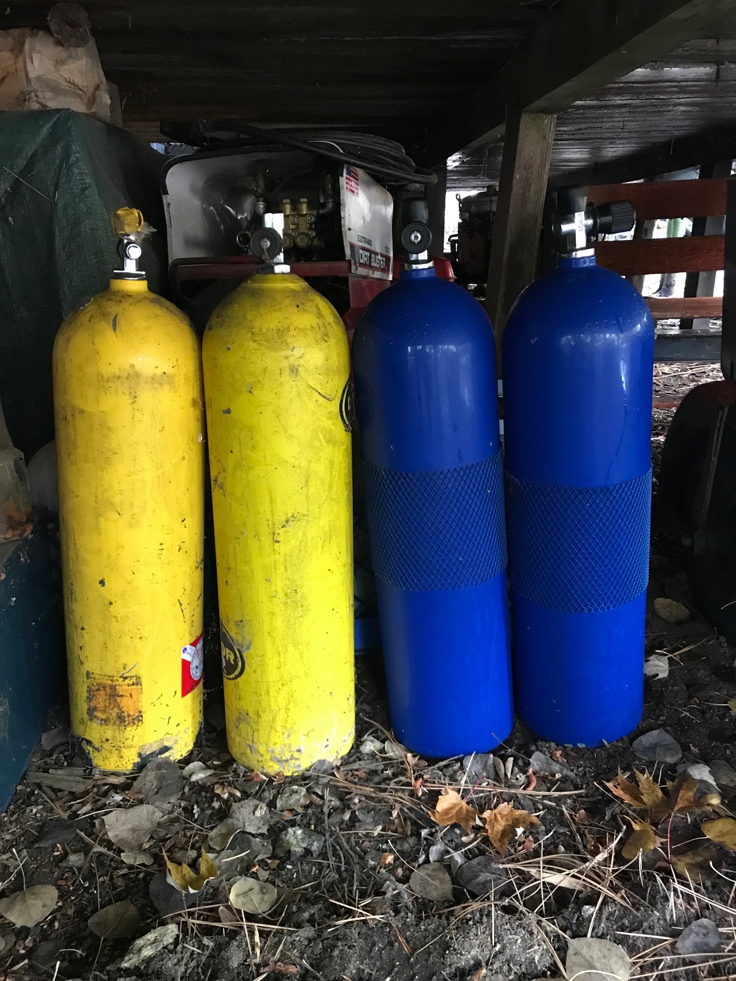

Next you will need one or more SCUBA tanks. I have eight.
Attachment 41000

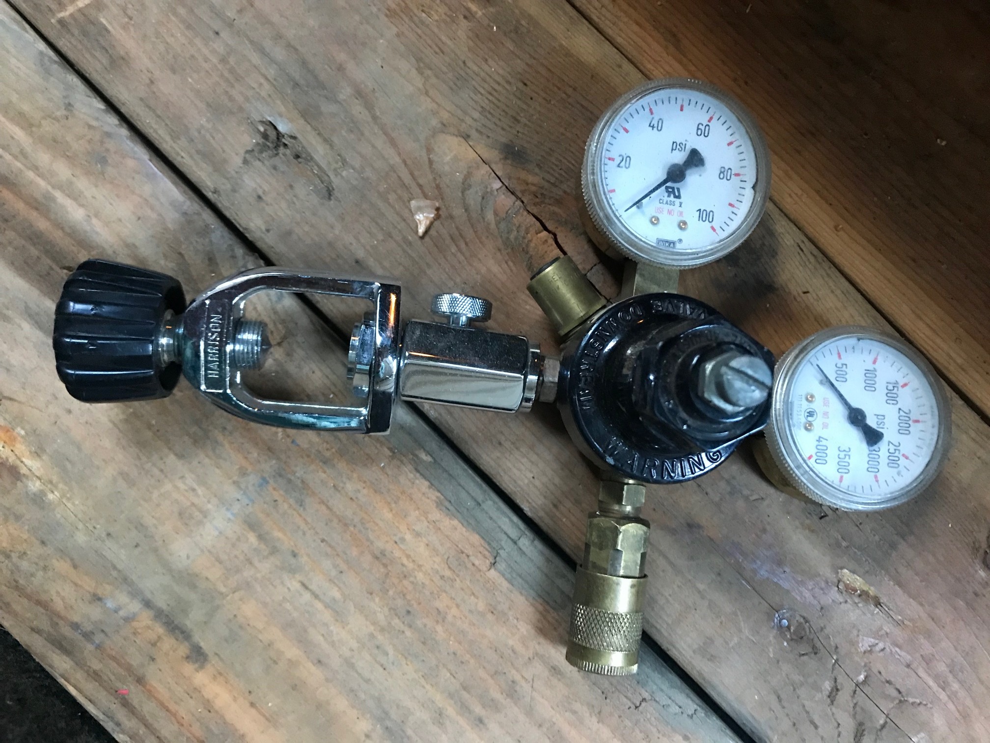

Then you will need a yoke and regulator.Attachment 41001
I only fill mine to 2500psi.Attachment 40999
