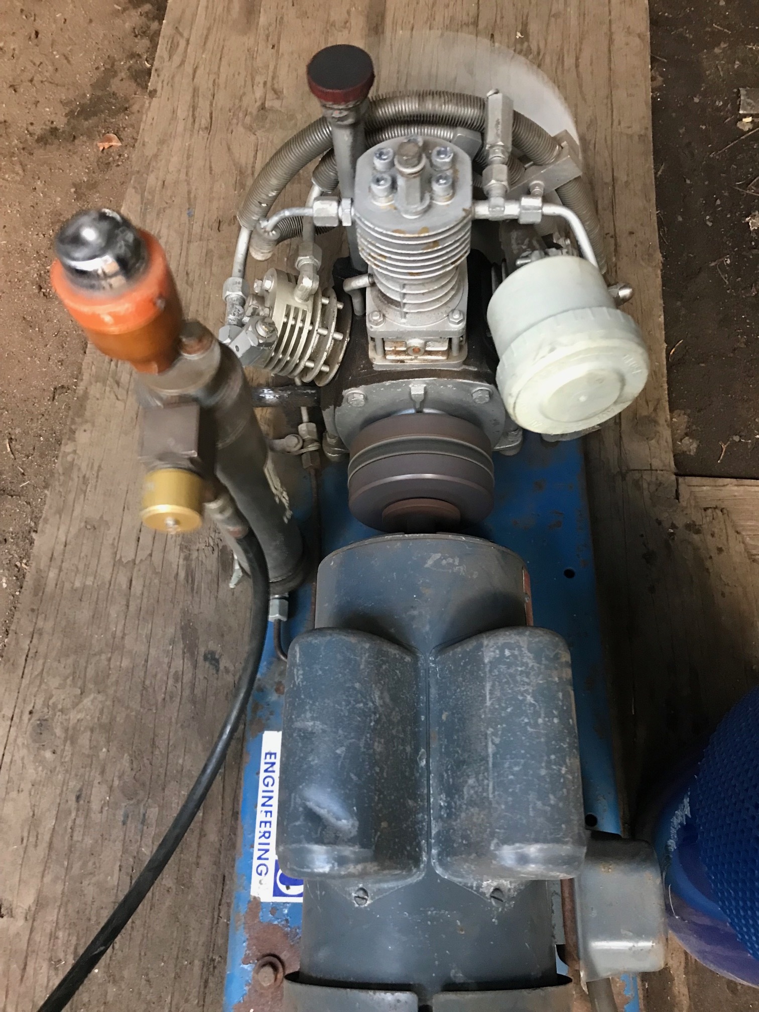

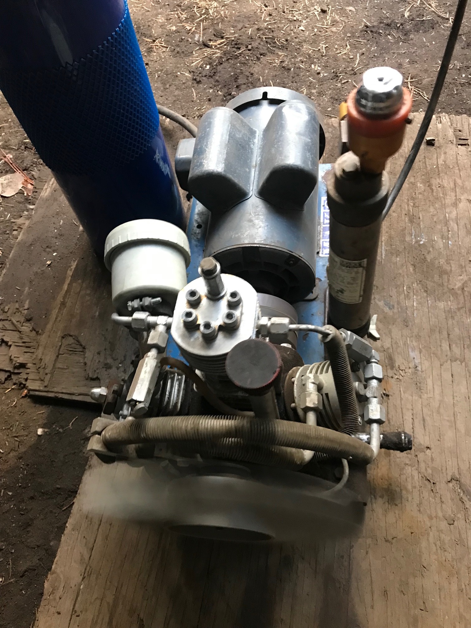

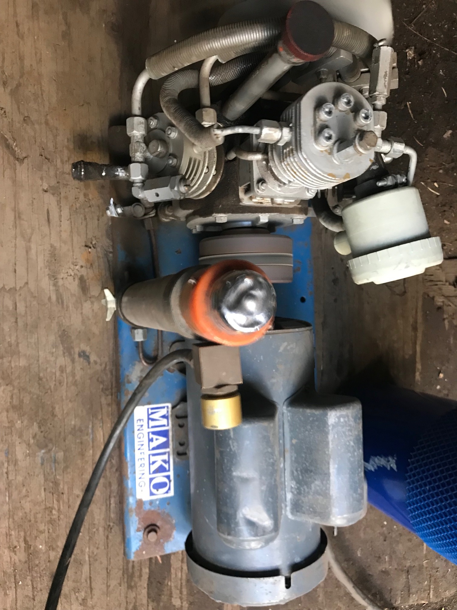

    Here is a easy way to have compressed air whenever and wherever you need it. First you will need an air compressor capable of pumping up to 3000 psi(207 bar).
    Portable Compressed Air-img_2314.jpg Portable Compressed Air-img_2315.jpg Portable Compressed Air-img_2316.jpg
    I use an old MAKO compressor.

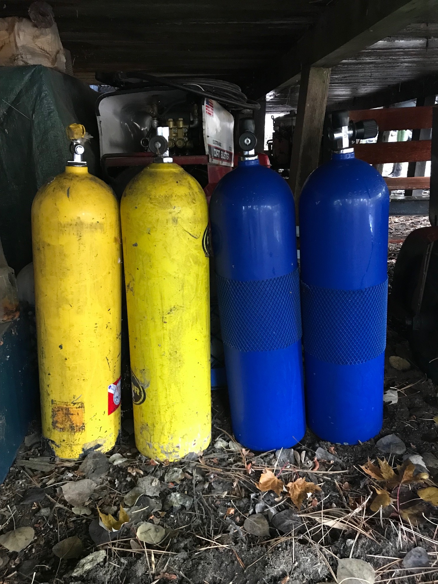

    Next you will need one or more SCUBA tanks. I have eight.

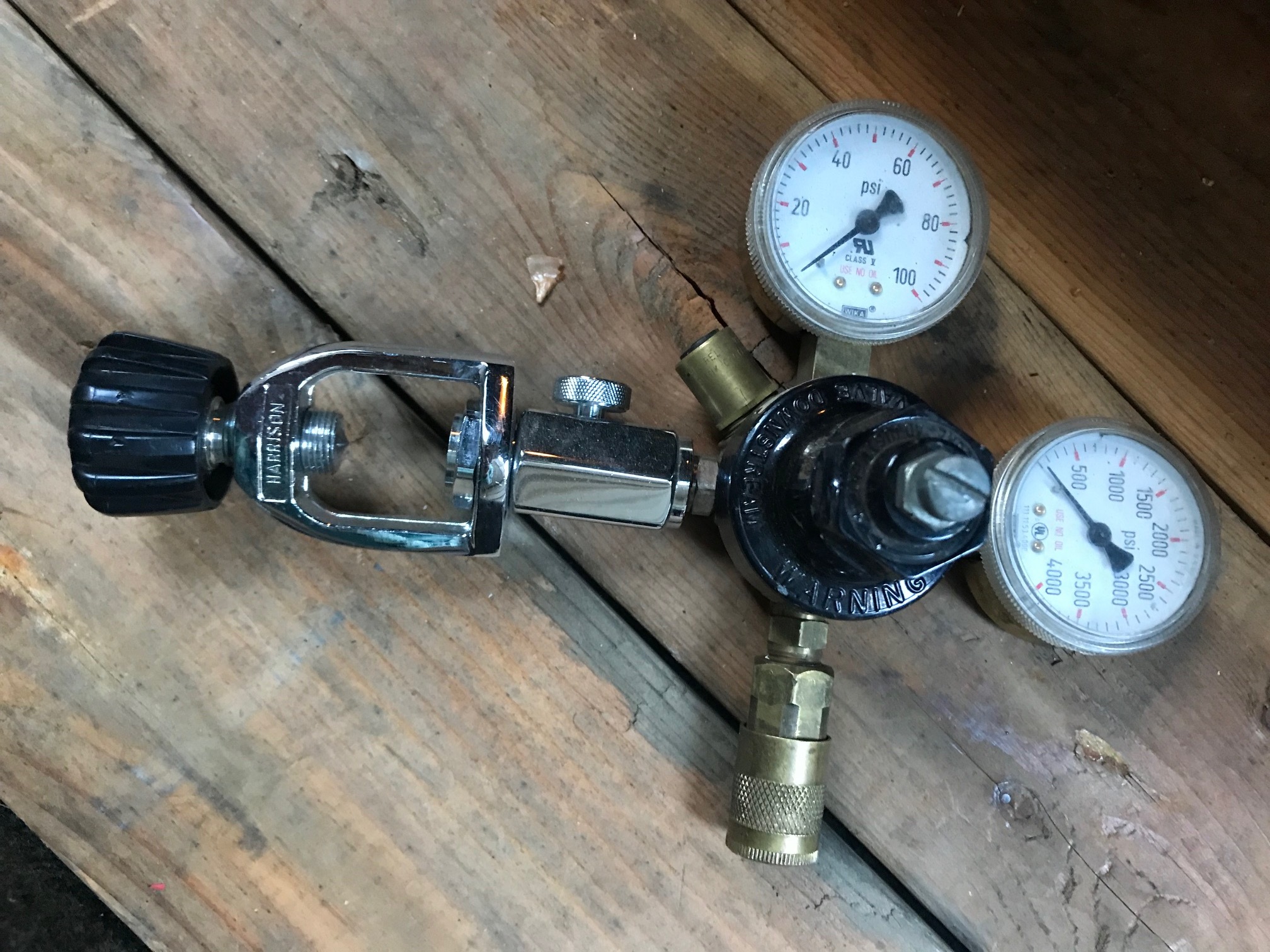

    Then you will need a yoke and regulator.Portable Compressed Air-img_2317.jpg
    They will last a surprisingly long time and you will always have air when you need it...
