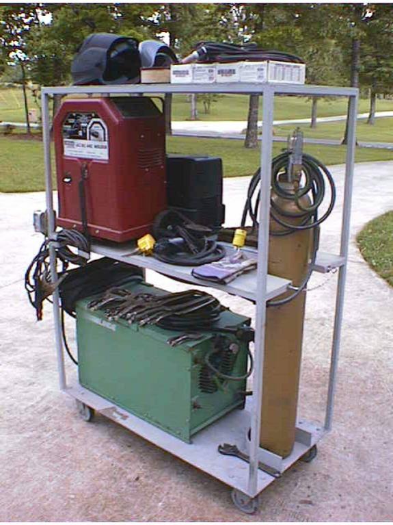

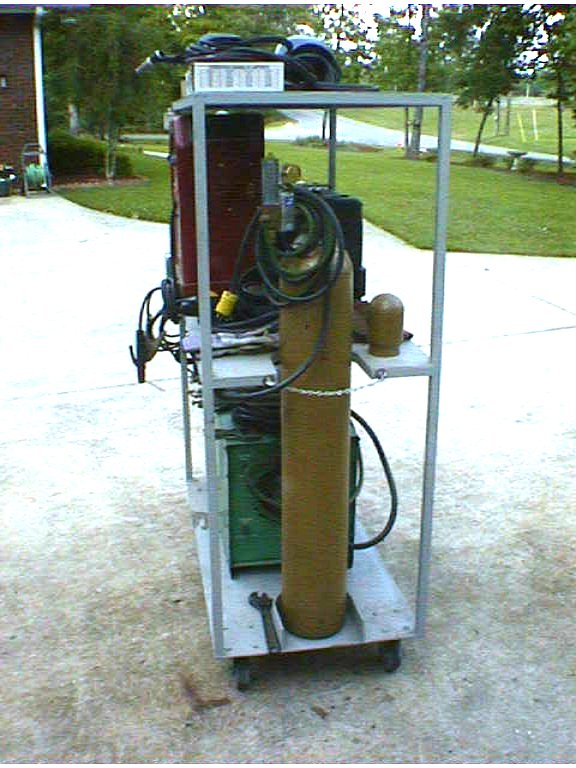

portable welder rack
with a ever decreasing amount of floor space in a 24x24 garage I had to go vertical. I had a tombstone welder, a small wire welder, a plasma cutter and acquired a Millermatic wire welder. I decided to pile them all up together. Here's what I came up with
Attachment 1394Attachment 1395Attachment 1396

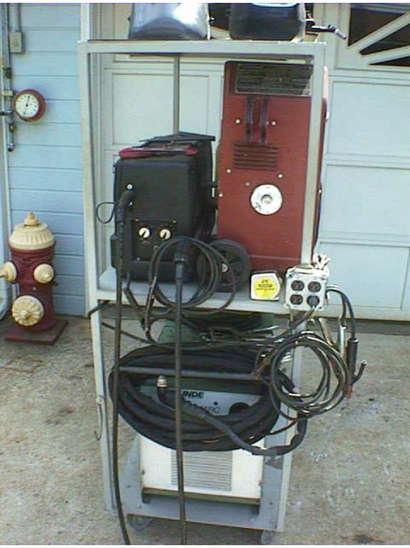

the big ole green plasma has been replaced with the Millermatic and the plasma now resides on wheels under the workbench... worked out well for me... is mobile with enough power cord to reach the driveway and also to clean...
I added an outlet on the front for grinders and such which is really handy and cuts down on cord clutter.
later
John
Nice packaging on that cart! I see a hydrant in the first picture. Is it just decorative or does it have an alternate function?
thanks DITer... the hydrant is strictly decorative... early plug I got from work.... dated early 1900s
