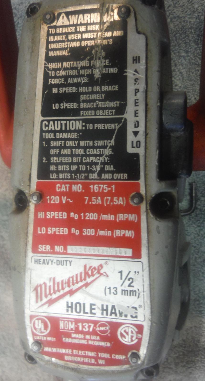

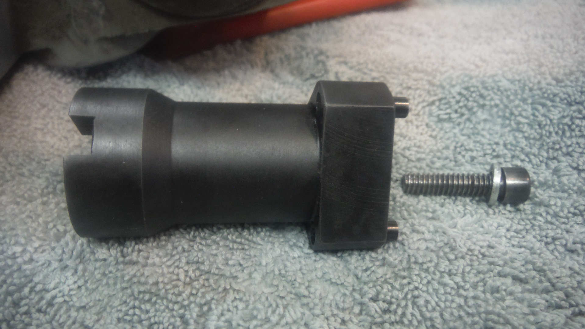

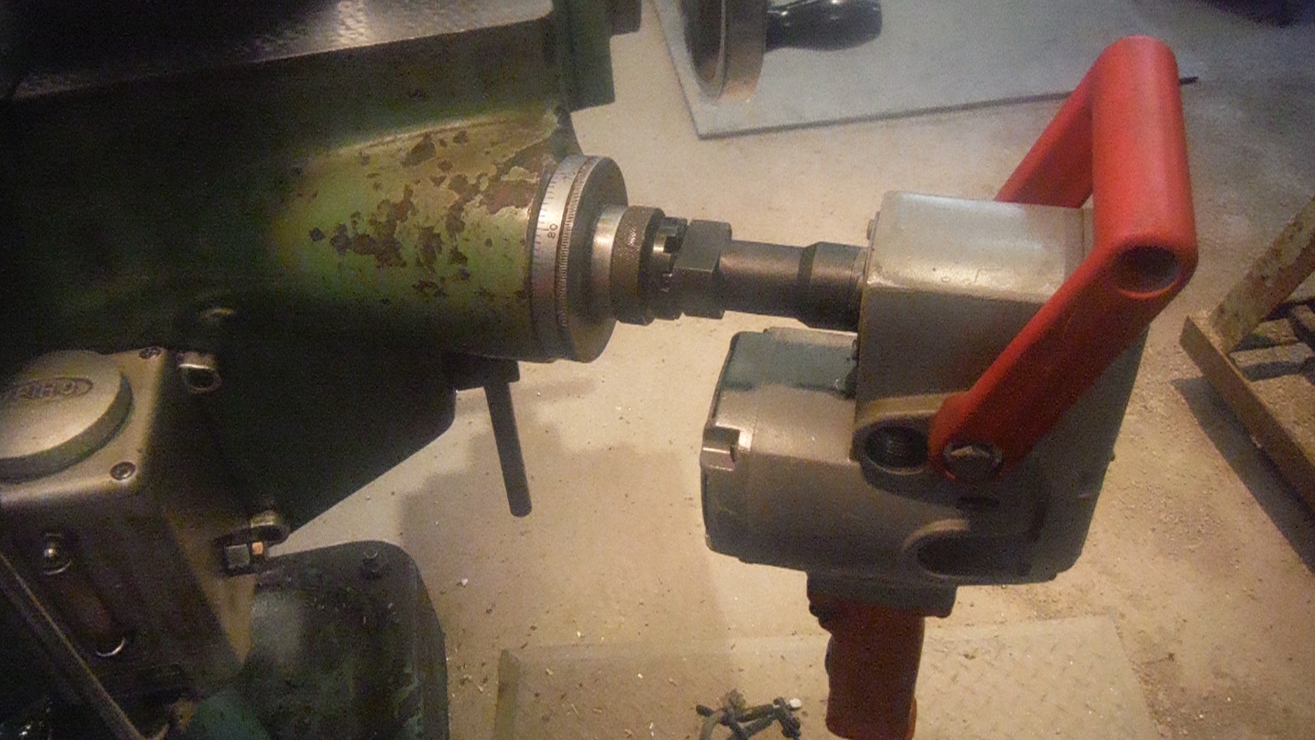

I finally made an adapter to use a Milwaukee Hole Hawg as the power source. I don't think it will fail.

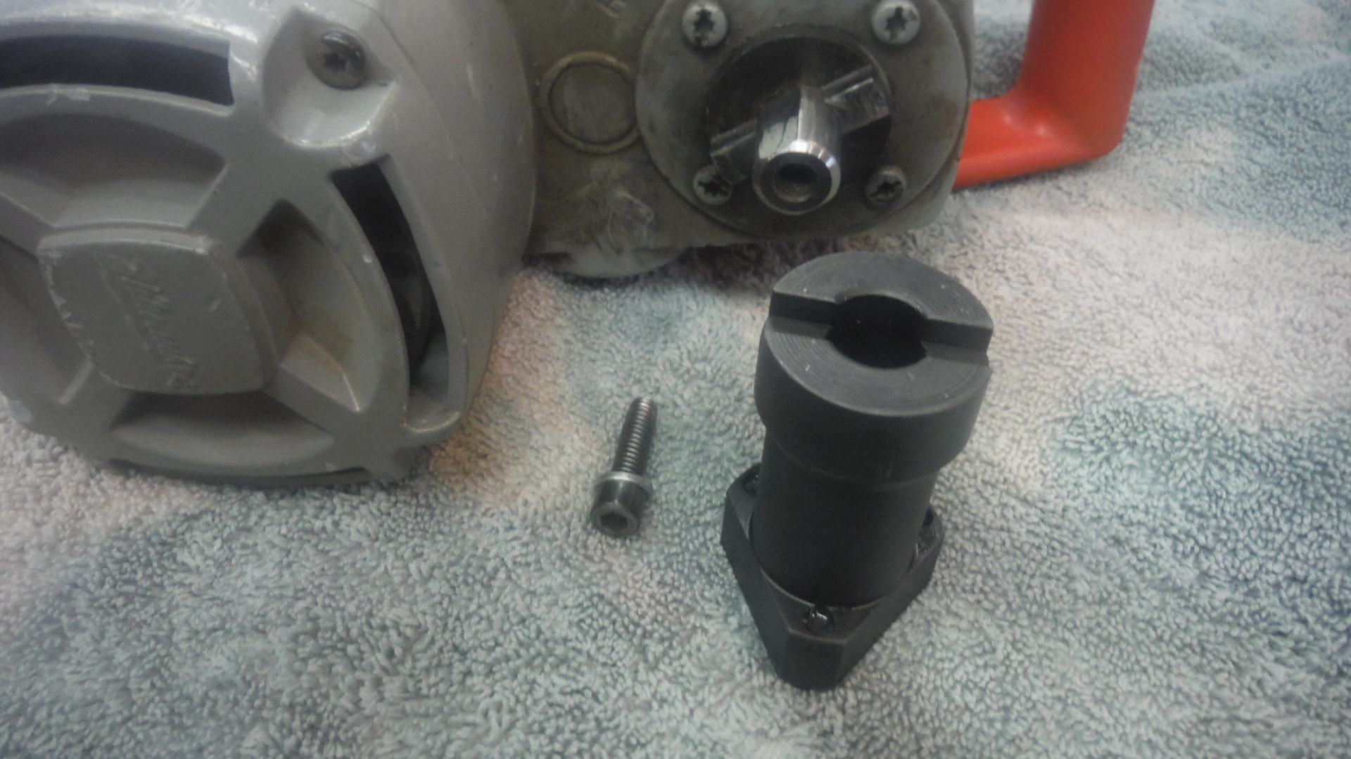

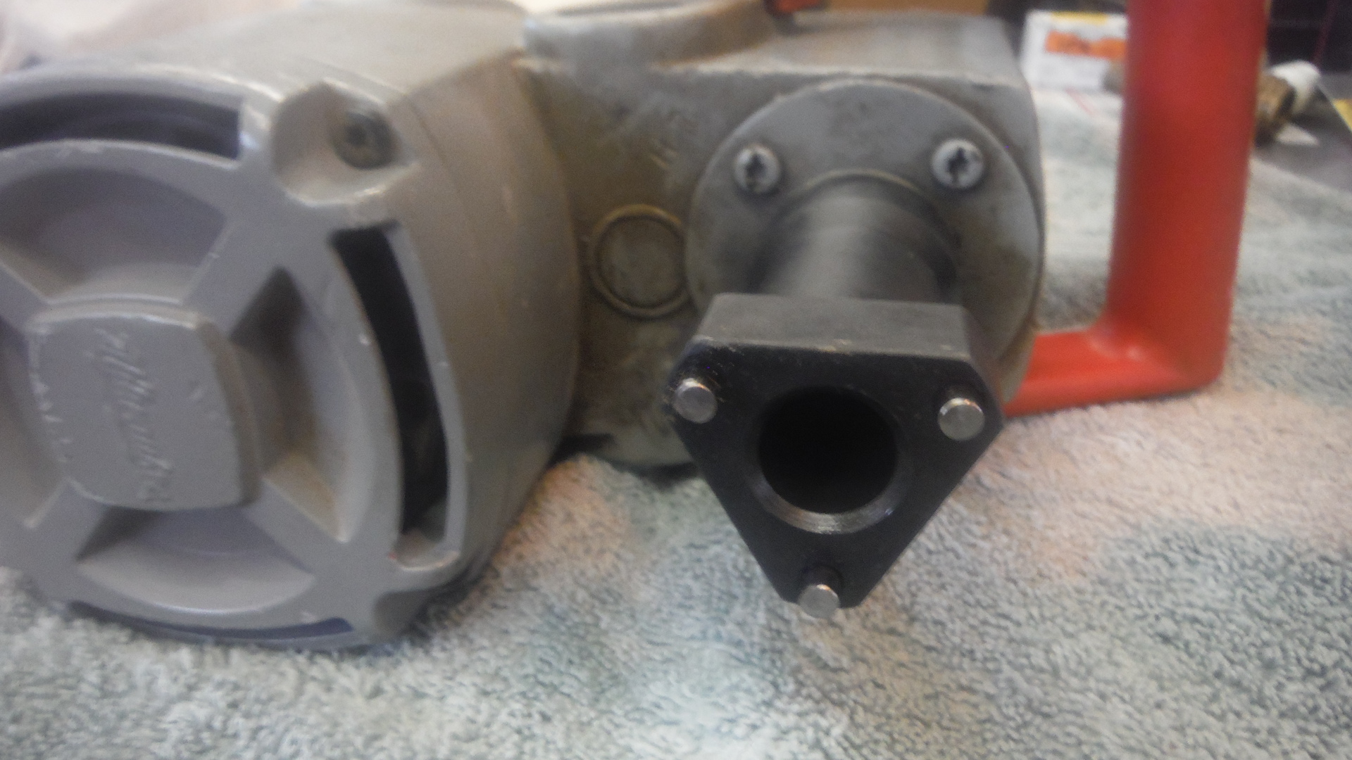

It dawned on me that you don't really need 9 notches in the adapter; just need 3 pins at 120º; 3/16 Dowel pins fit nicely in the slots on the sleeve of the Z axis of the mill. BTW, the Z-axis shaft on the DoAll is 16mm. not 5/8"
The pins are on a .65625R
The end that fits the Milwaukee was bored for a slip fit and keyed 5/16". The stock 1/4-20 LH shcs holds the adapter on.
If anyone wants a drawing, let me know.
It works really well and the low-speed setting on the Hole Hawg seems to be ideal.
