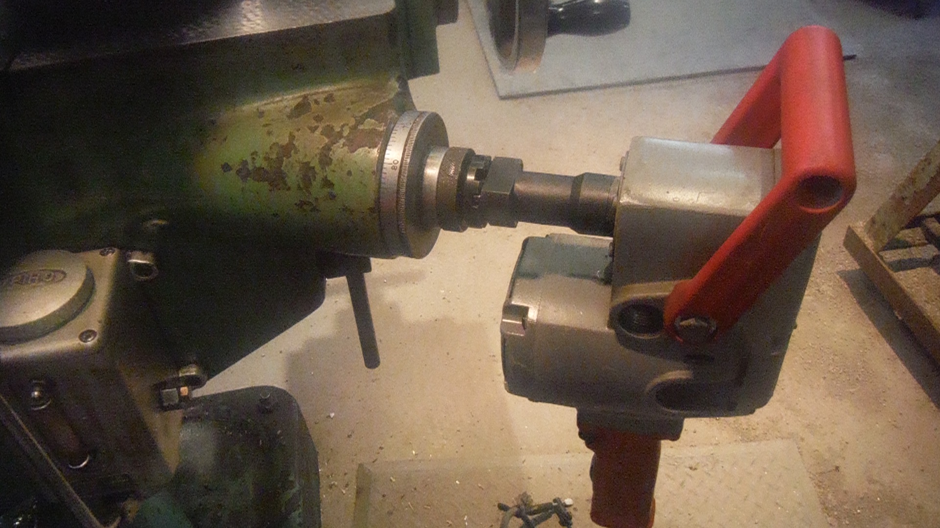

    Read many threads about buying or making powered Knee Axis for Bridgeports or clones.
    I have spent many years moving the knee up and down and up and down at work and as a matter of necessity, had gotten used to it.
    But now retired with a DoAll mill at home, I just don't need the aggravation.
    Always seems that you need the table UP or DOWN; seldom where it's at, especially when milling the ends of a part, then drilling/reaming

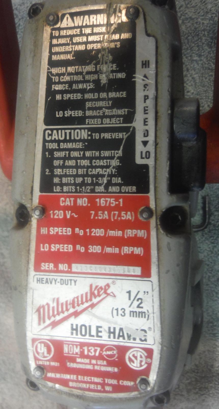

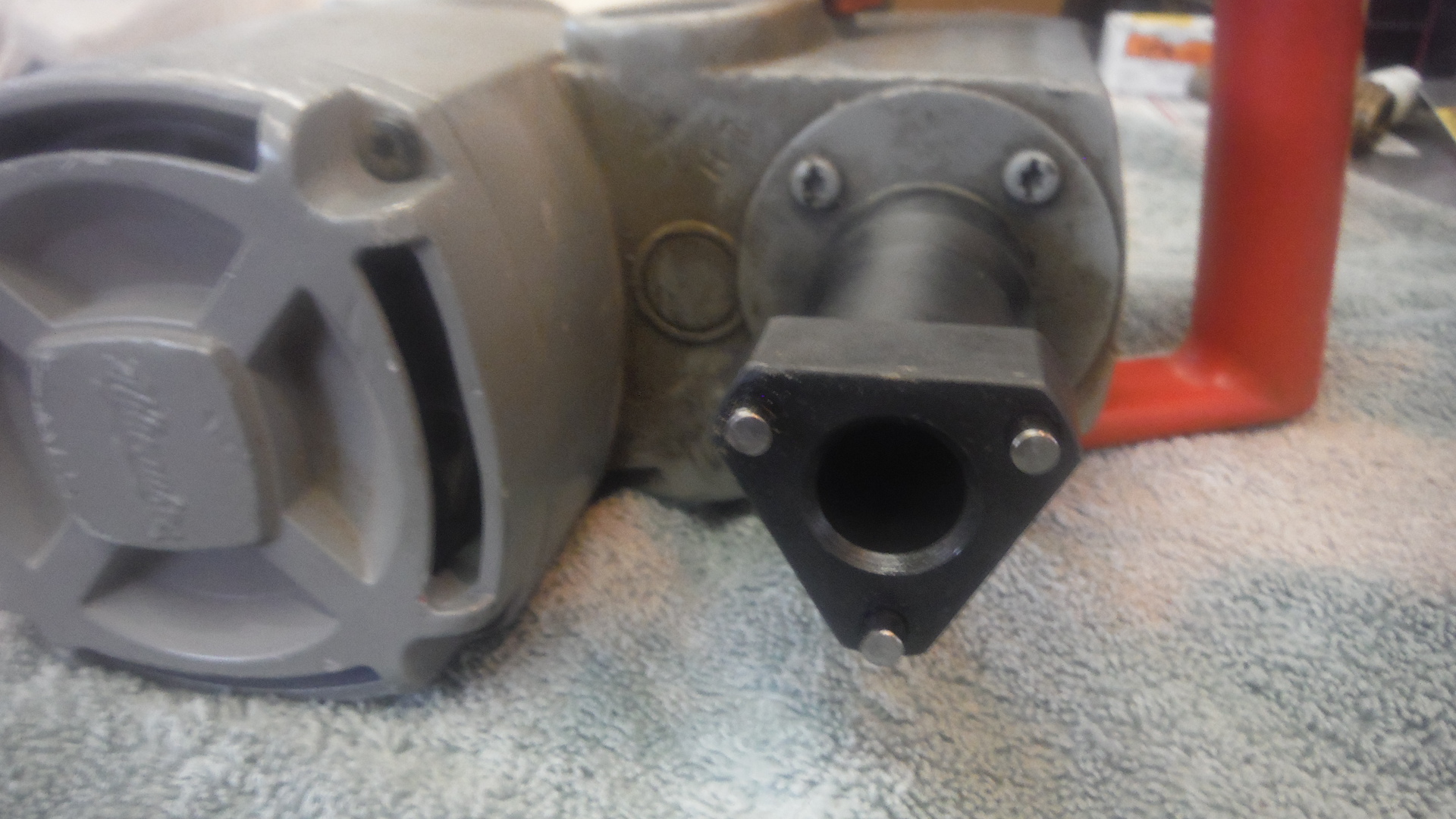

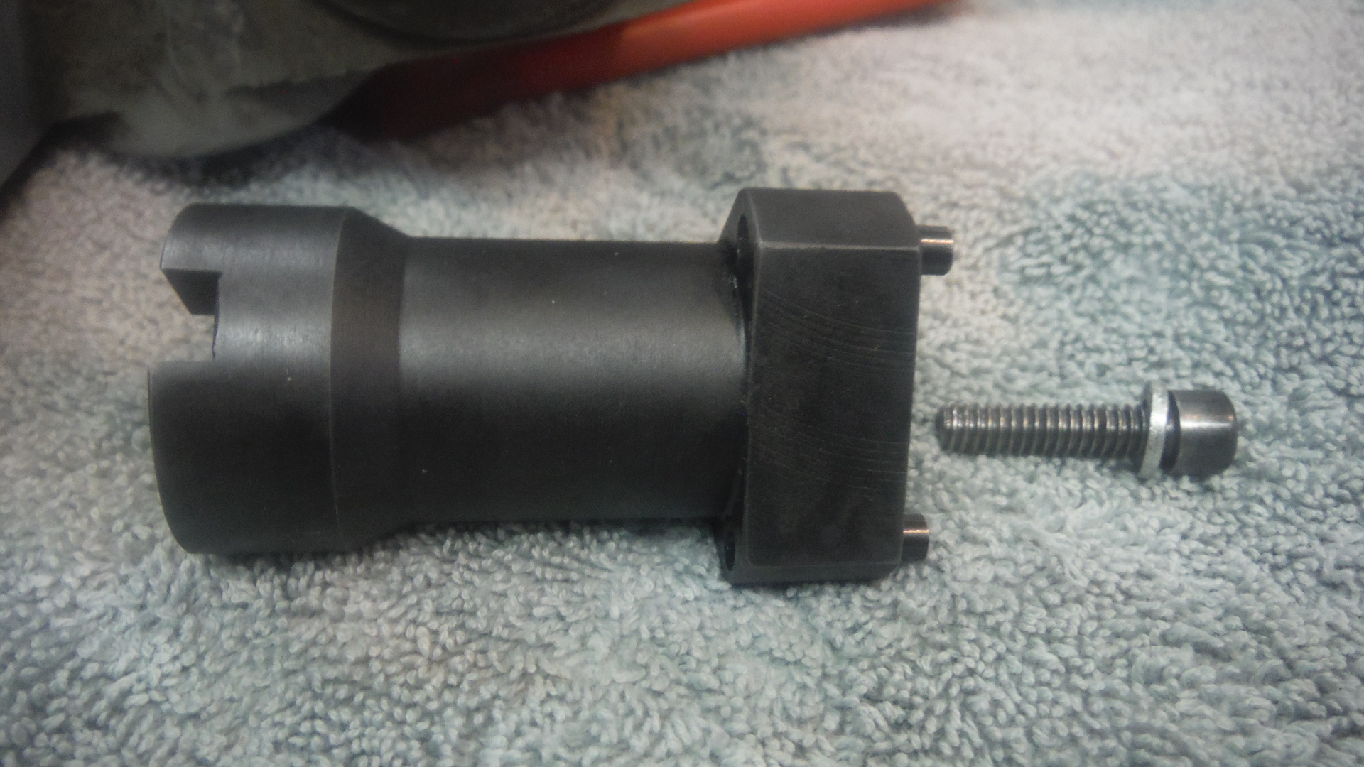

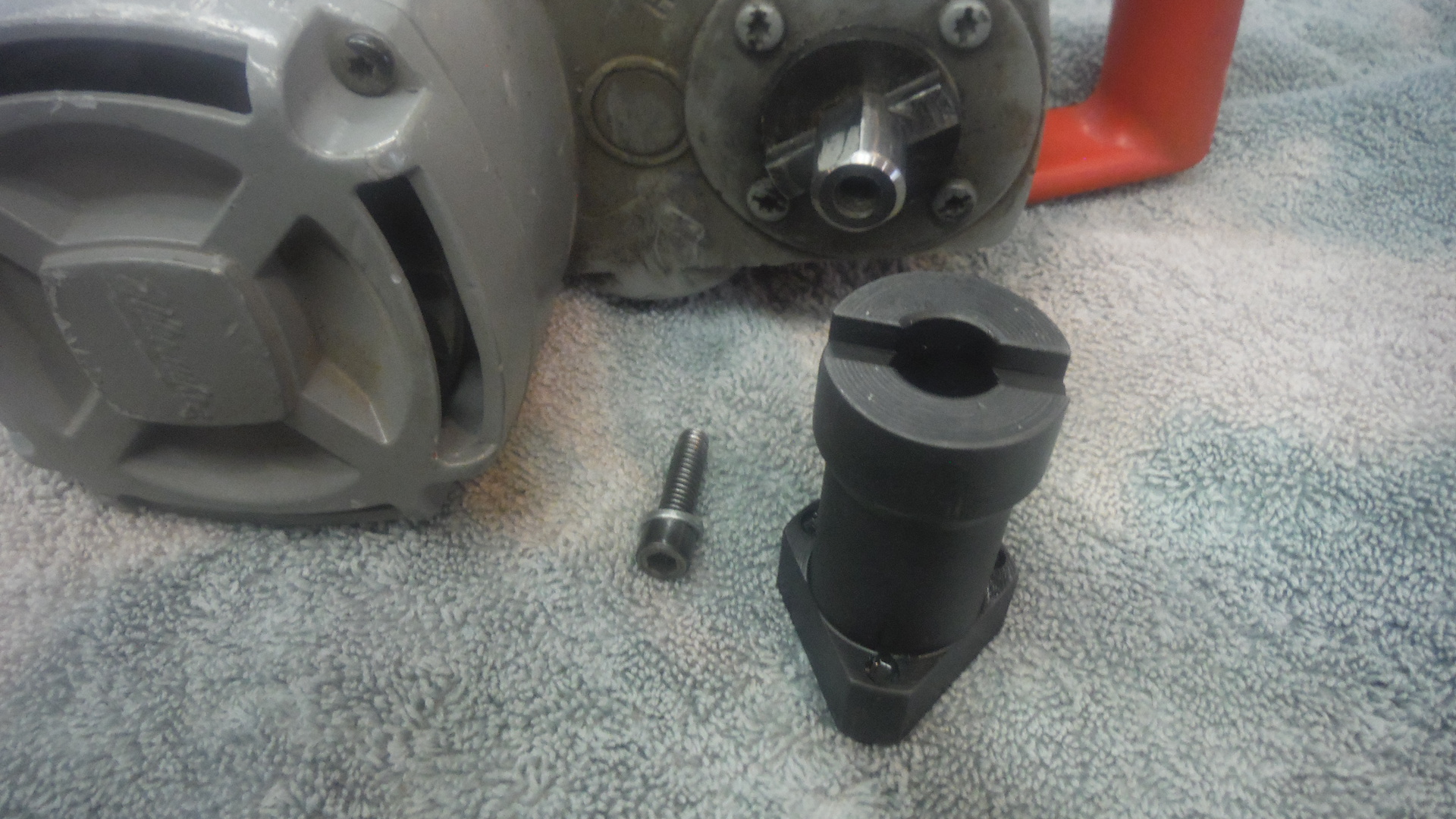

    I finally made an adapter to use a Milwaukee Hole Hawg as the power source. I don't think it will fail.
    It dawned on me that you don't really need 9 notches in the adapter; just need 3 pins at 120º; 3/16 Dowel pins fit nicely in the slots on the sleeve of the Z axis of the mill. BTW, the Z-axis shaft on the DoAll is 16mm. not 5/8"
    The pins are on a .65625R
    The end that fits the Milwaukee was bored for a slip fit and keyed 5/16". The stock 1/4-20 LH shcs holds the adapter on.
    If anyone wants a drawing, let me know.
    It works really well and the low-speed setting on the Hole Hawg seems to be ideal.

    Agreed, the Hole Hawg is a bit overkill, but does the job. I didn't want to start using my Makita 12v cordless drill and burn it out.
    A good cordless (say 18 to 20/24 v) should work for your Clausing 8520. Check out the Kobalt drills at Lowes.
    And, you'd always have a nice (?) drill around
    Sorry about the small pix. I think I just copied and pasted, rather than upload.
    These should come in OK

    How are you controlling the drill? Can you go a set distance or just manually turn it on and get close then adjust by hand?

    I'd recommend two additions. Counterweight the knee, there are a handful posted here, for reduced motor load, but not such a ratio the knee is 'weightless'.
    A low RPM geared DC motor with a variable speed control seems ideal. It really doesn't need much faster than you'd crank by hand. I do know of one instance a corded 1/2" Milwaukee in the hands of an aggressive apprentice wore out the lead screw nut trying to achieve escape velocity.
    Anyway; my interest is to broaden the feed rate per spindle revolution [typ .0015, .003, & .006]. This increases tool radius selection, desired surface finish on varied materials. Also allows the spindle remain fully retracted and locked for an extra bit of rigidity.
