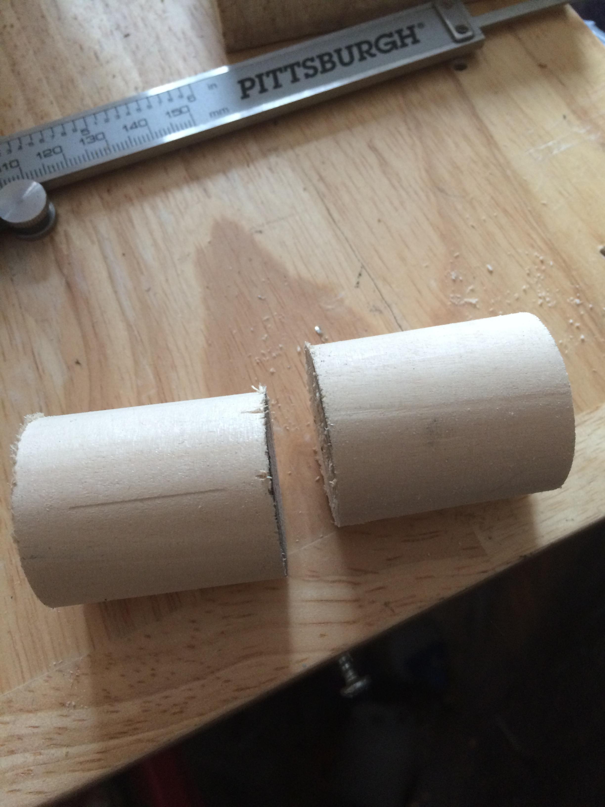

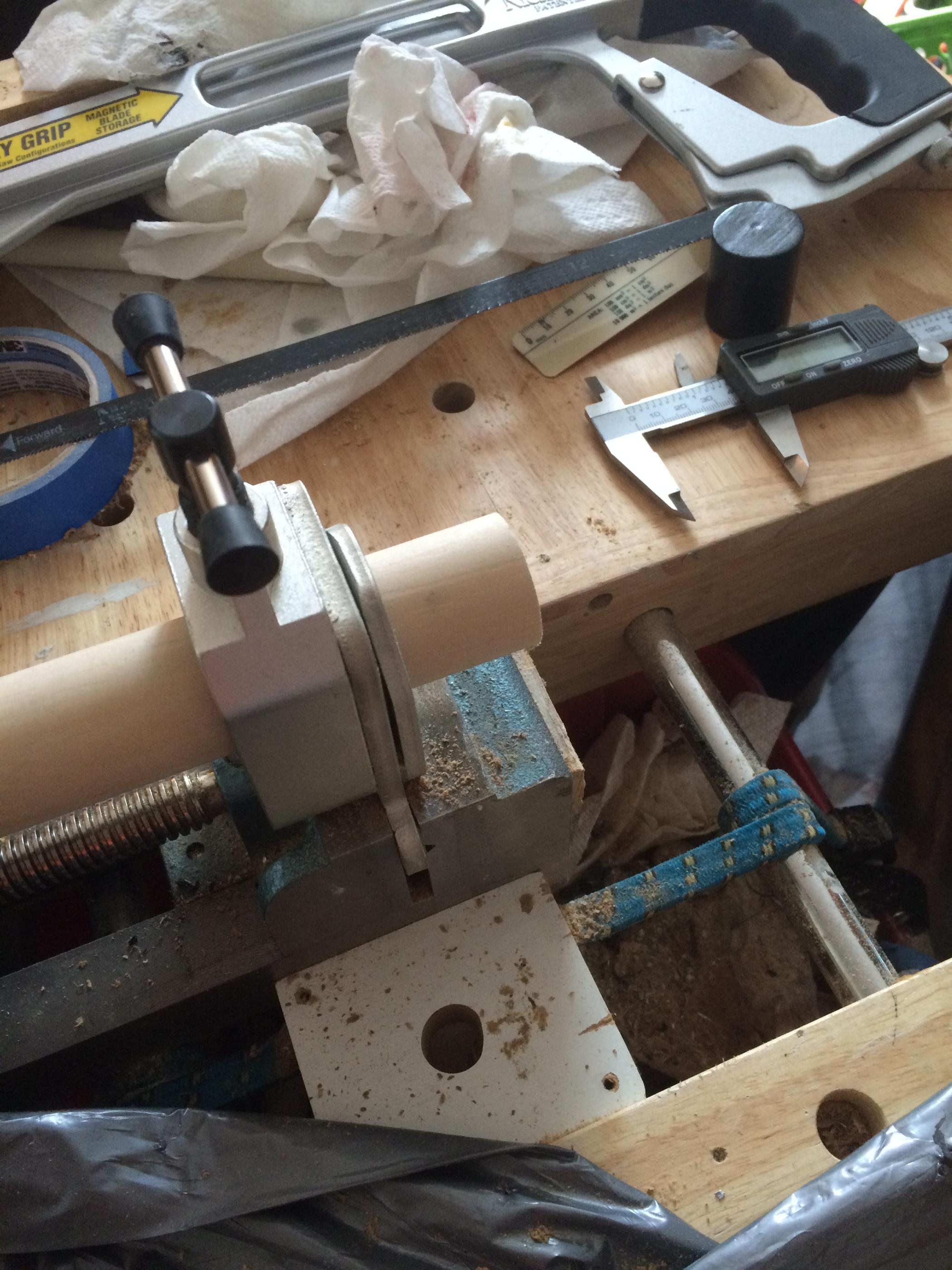

    Precise method for cutting large wood dowels with hacksaw
    You can use a bicycle tube cutting jig that mounts on a vise for cutting dowels up to 1.25 in diameter. The cut is precise and clean. You can order the tool from any online bicycle parts supplier. Tony

    "bicycle tube cutting jig" is for fabricating frames, ie tubing. Had to google it.
    Couldn't see trees in whole forest, not cutting bicycle 'tubes'. First thought was "uh, hello ...razor blades won't do"?
