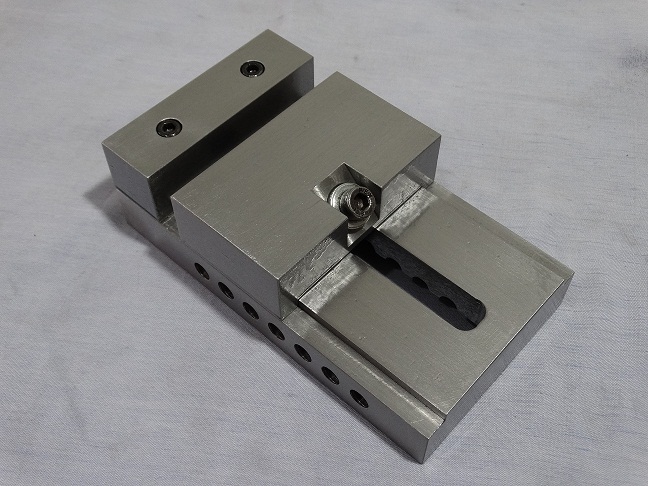

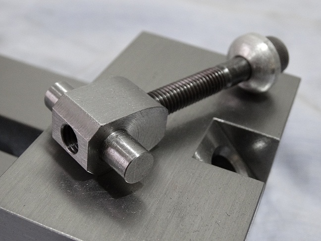

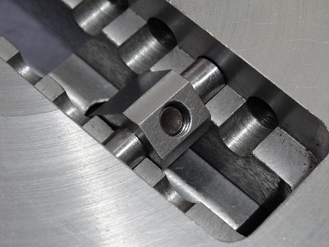

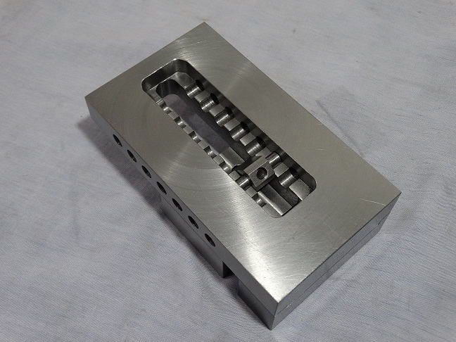

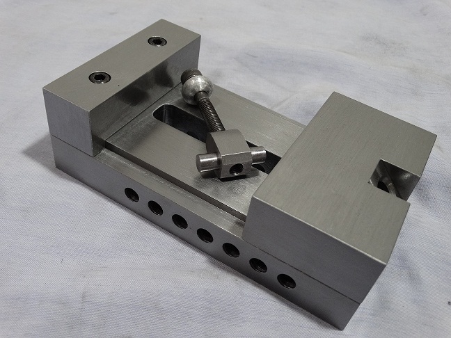

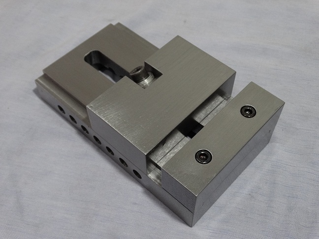

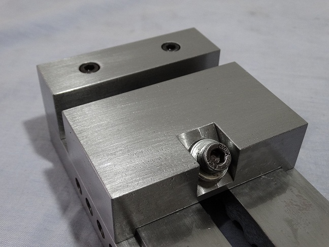

This is my version for precision vise or milling vise. I made some simplifications in the project, to facilitate the manufacture. I created an alternative model for the fixation nut and changed the fixed jaw and the movable jaw. This project is a good exercise to train manufacturing skills and patience.
