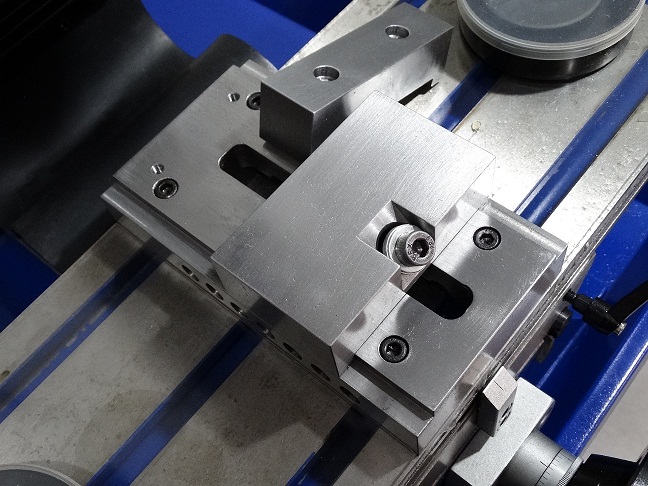

DIYSwede, thanks for sharing the link. The projects are very interesting! In the case of the vise, the way the clamping system was performed by Ishimura's is more difficult to manufacture, in addition to taking up more space in the movable jaw. The fixing on the milling machine also didn't interest me much, I'll post a picture of how I fixed my vise, much simpler. Hug!
1 Attachment(s)
I prefer the traditional fixation, without accessories, just as I did on the vise with a dovetail. Thanks for the interest and I'm already going to work on new projects!
Attachment 36358
