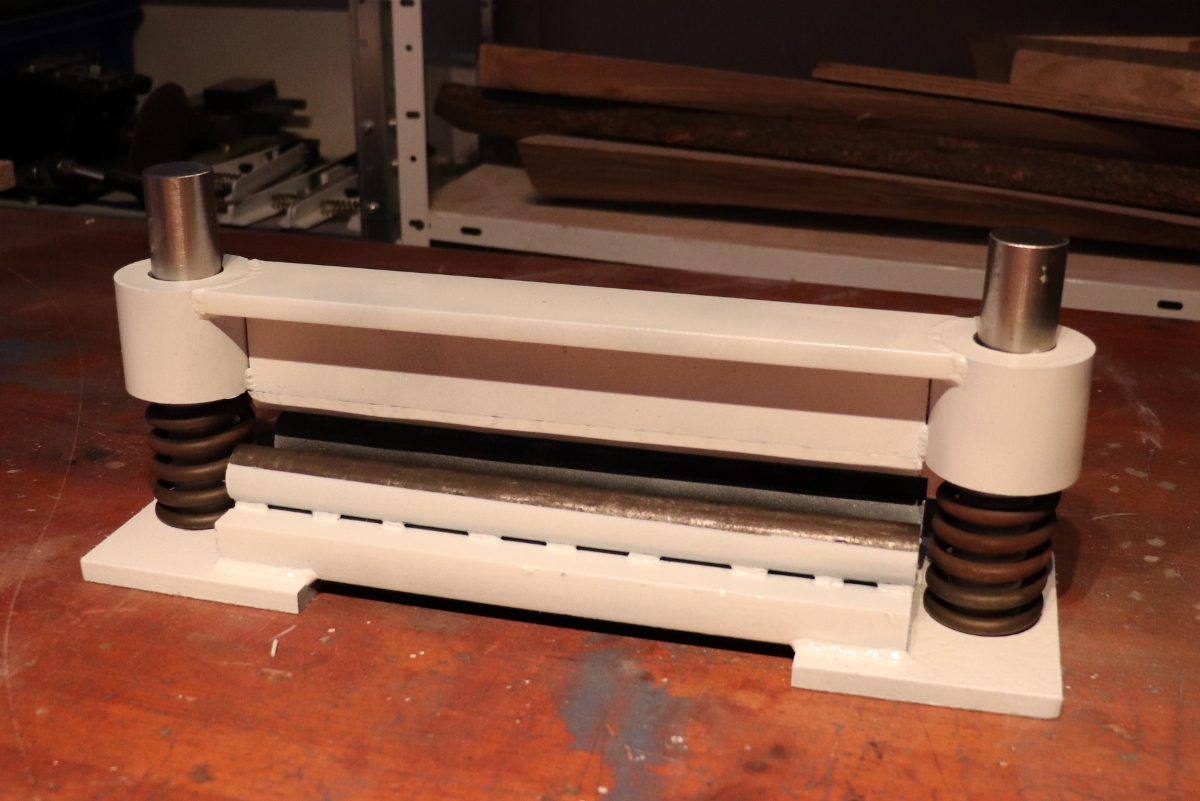

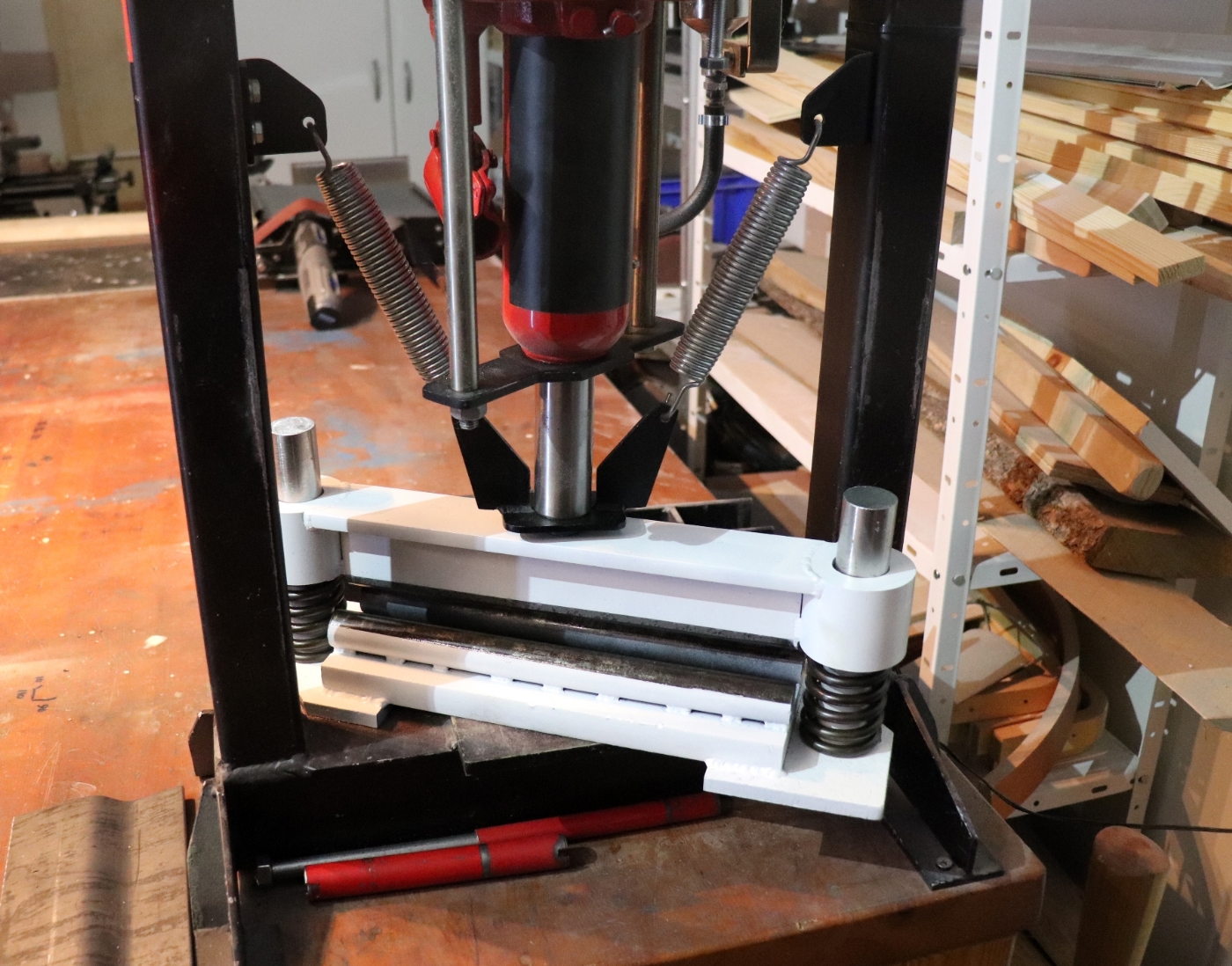

Made a simple brake to my press.
Info about mounting the jack: http://www.homemadetools.net/forum/m...255#post109941
Info about the actual press: http://www.homemadetools.net/forum/h...615#post104791

Allows to bend max 310mm wide 5mm sheets with 15mm radius.
Material is 10mm thick steel plate, valve springs from a truck and machine steel (SBQ) for the blade guides.
