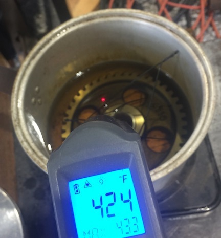

The heat part was easy with an old pot with lid, electric hot plate, corn oil and a digital thermometer. Testing the heat process, with oil temperature of 420˚-430˚f the bore enlarged to 1.002”, making this a light press fit.

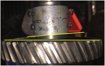

I needed a good set up on the press to ensure the gear went on correctly the first try.
The ram on the press is not ideal for pushing on precision parts. It is rough and dented from years jacking heavy construction equipment around. I wanted to remove the adjustment screw and machine it smooth, but that would not be easy. Also, it would just get banged up again, when back in its normal life.
02
Attachment 49601

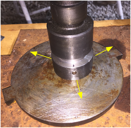

A collar, made from an iron pipe coupling allows various adapters to be attached to the ram. The set screws take none of the press load, they only hold the parts together and in alignment
03- 04
Attachment 49602 Attachment 49603

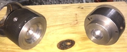

One end of the cam passes through the gear, the other end has a small boss to position another gear for a hydraulic pump that is driven by the cam. Steel adapters were machined to fit each end.

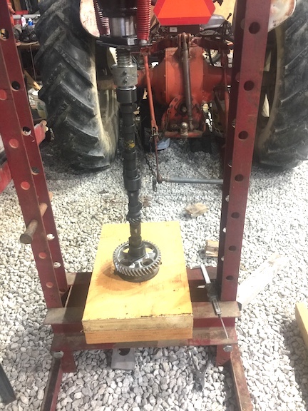

I thought maybe the gear would be down and stationary with the cam pushed down into it. For many reasons this was not a good idea.
06
Attachment 49605
With the top of the cam held stationary, in contact with the press ram, it was easy to position the bottom the cam as required to be perfectly aligned and perpendicular with the bore of the gear and the face of the press ram adapter. I was lucky to have an old gear that was a slip fit on this cam to use for alignment purposes.

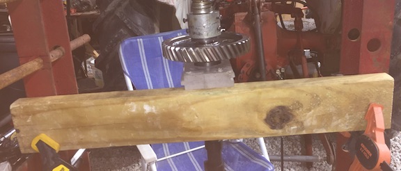

After perfect alignment is achieved the top of the cam was braced in place with a 2 x 4 clamped to the press anda piece of plastic deck material, bored to fit the cam bearing, screwed to the 2 x 4
