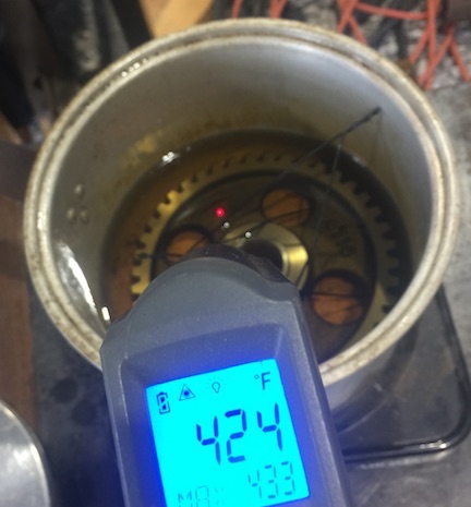

    The heat part was easy with an old pot with lid, electric hot plate, corn oil and a digital thermometer. Testing the heat process, with oil temperature of 420˚-430˚f the bore enlarged to 1.002”, making this a light press fit.

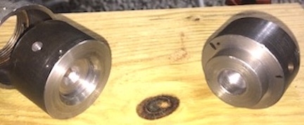

    One end of the cam passes through the gear, the other end has a small boss to position another gear for a hydraulic pump that is driven by the cam. Steel adapters were machined to fit each end.
    05
    Press / Shrink Fit Cam and Gear assembly-05-push-adapters.jpg

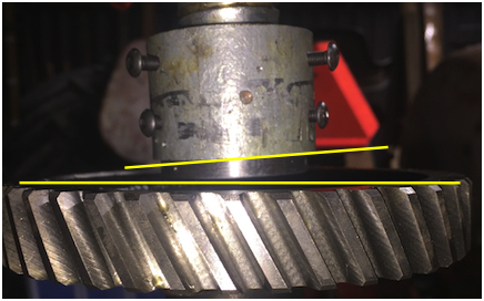

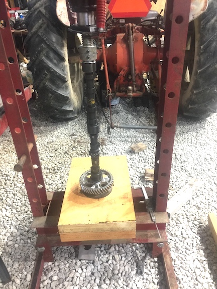

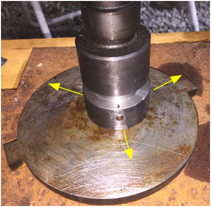

    I thought maybe the gear would be down and stationary with the cam pushed down into it. For many reasons this was not a good idea.
    06
    Press / Shrink Fit Cam and Gear assembly-06-gear-down.jpg
    With the top of the cam held stationary, in contact with the press ram, it was easy to position the bottom the cam as required to be perfectly aligned and perpendicular with the bore of the gear and the face of the press ram adapter. I was lucky to have an old gear that was a slip fit on this cam to use for alignment purposes.
    07-08
    Press / Shrink Fit Cam and Gear assembly-07-perpendicular-alignment.jpg Press / Shrink Fit Cam and Gear assembly-08-alignment.jpg

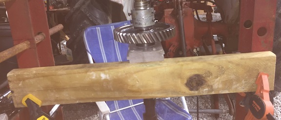

    After perfect alignment is achieved the top of the cam was braced in place with a 2 x 4 clamped to the press anda piece of plastic deck material, bored to fit the cam bearing, screwed to the 2 x 4
    09
    Press / Shrink Fit Cam and Gear assembly-09-cam-support.jpg
