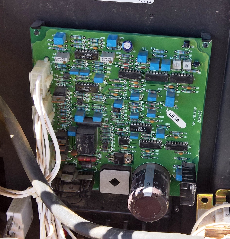

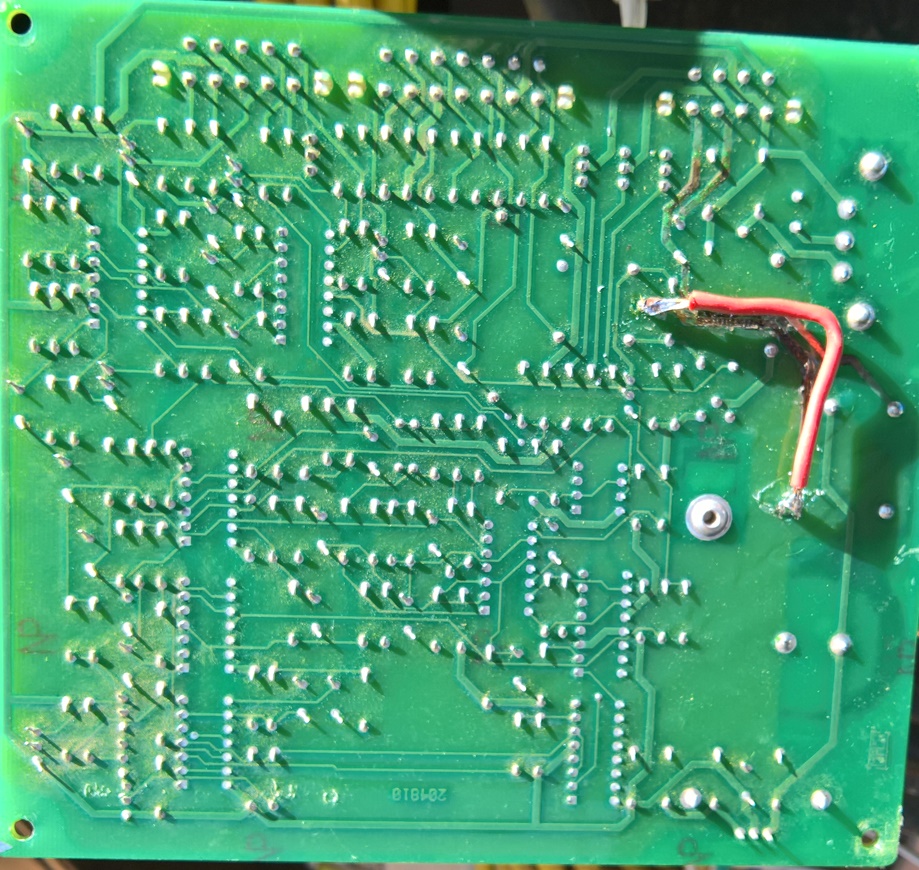

    last week while attempting to re attach my spool gun to my mig welder I shorted a couple of wires resulting in burning one of the traces on the pcb.
    upon checking for a replacement or a repair faciality the prices were all over ranging from $400.00 and up a refurbished replacement board sells for $700.00 And I didn't even want to know what Miller wanted for a new one but it turns out a brand new one from Miller would have only been an additional $75.00. However neither option is something that I was willing to dig into my piggy bank for.
    So here was the problem I could tell by looking that on the surface it appeared to be only a single trace which was burned and the board was not heavily populated in the nearby region. Now you have to understand a soldering iron in my hands is a lethal weapon mostly because I normally use a 160 or 200 watt gun or heat up a 1 lb copper iron to solder with, and for me to solder any wire smaller than 14 ga is like sending a 20 kiloton bomb to wipe out an ant hill.
    Na just kidding as long as a board is not heavily populated and the connections are spaced far enough apart for me to be able to distinguish one from another I'll work on something simple like replacing a trace with a piece of insulated wire.
    I wanted to use 18 or 20 ga wire for the bypass surgery but failing to have any wire that small I pulled 5 or 6 wires out of a 16 ga stranded wire then tinned up the ends and joined them to the board Had the welder going in a few minutes the piggy bank is safe from the hammer for yet another day.

    By the way I do have a small 4o watt iron just for these times

    Never say never. I like it! Good to see you get this up and running again Frank!

    What was the worst that could happen, hammer a hole in the piggy bank?
    I called Miller talked to a tech guy we decided that there most likely was not any other damage to the board, He said if I sent it to them they send everything out to innovat for repairs so I called them their guy said much the same as the Miller guy, then said hey it wont cost you any more for repairs if you try it and that fails to fix the problem then send it to us may even have a few bucks knocked off the final bill since you will have already repaired the trace assuming you didn't do more damage in making the initial repair.
    If the bridge rectifier had ben toast I would have de soldered it and replaced it as well. I'm fine with things I can see but when I have to use a microscope or powerful loop to see something then I'm not the one, as I am electronically challenged for the most part.
