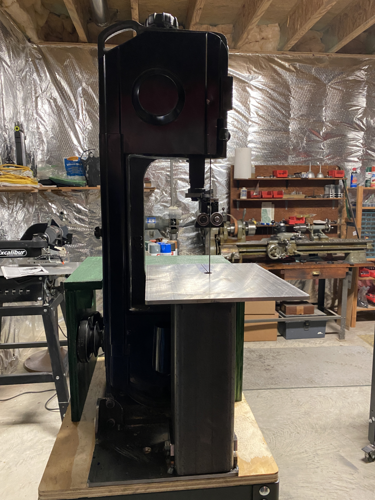

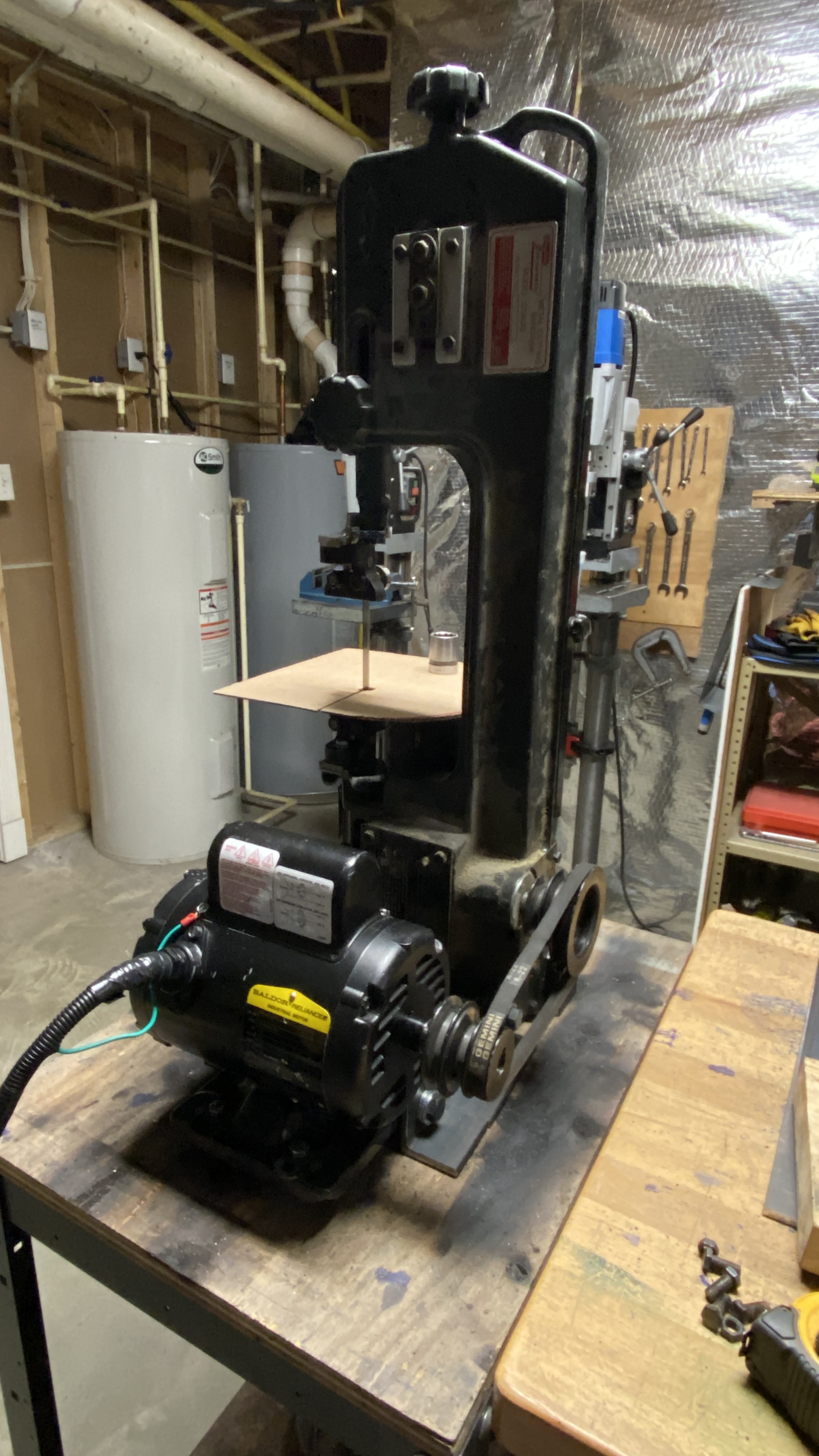

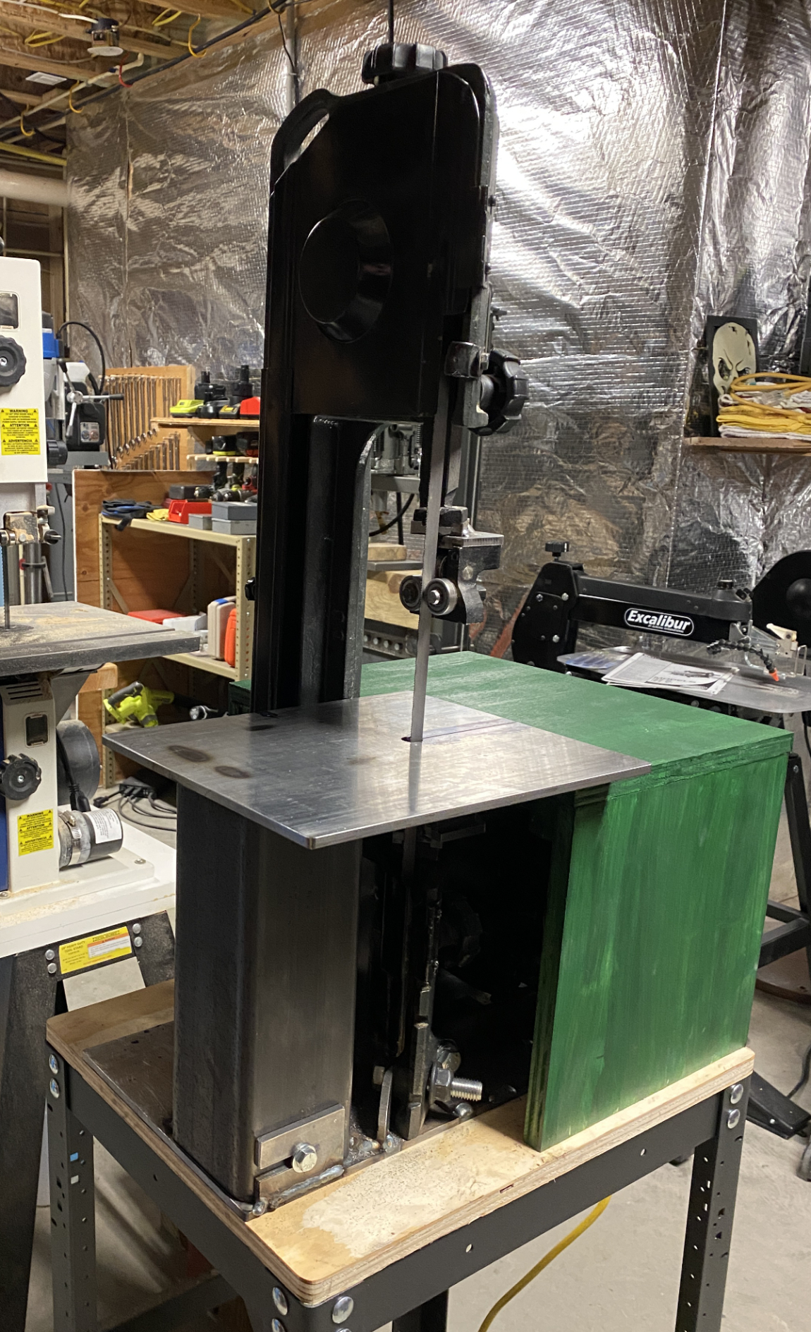

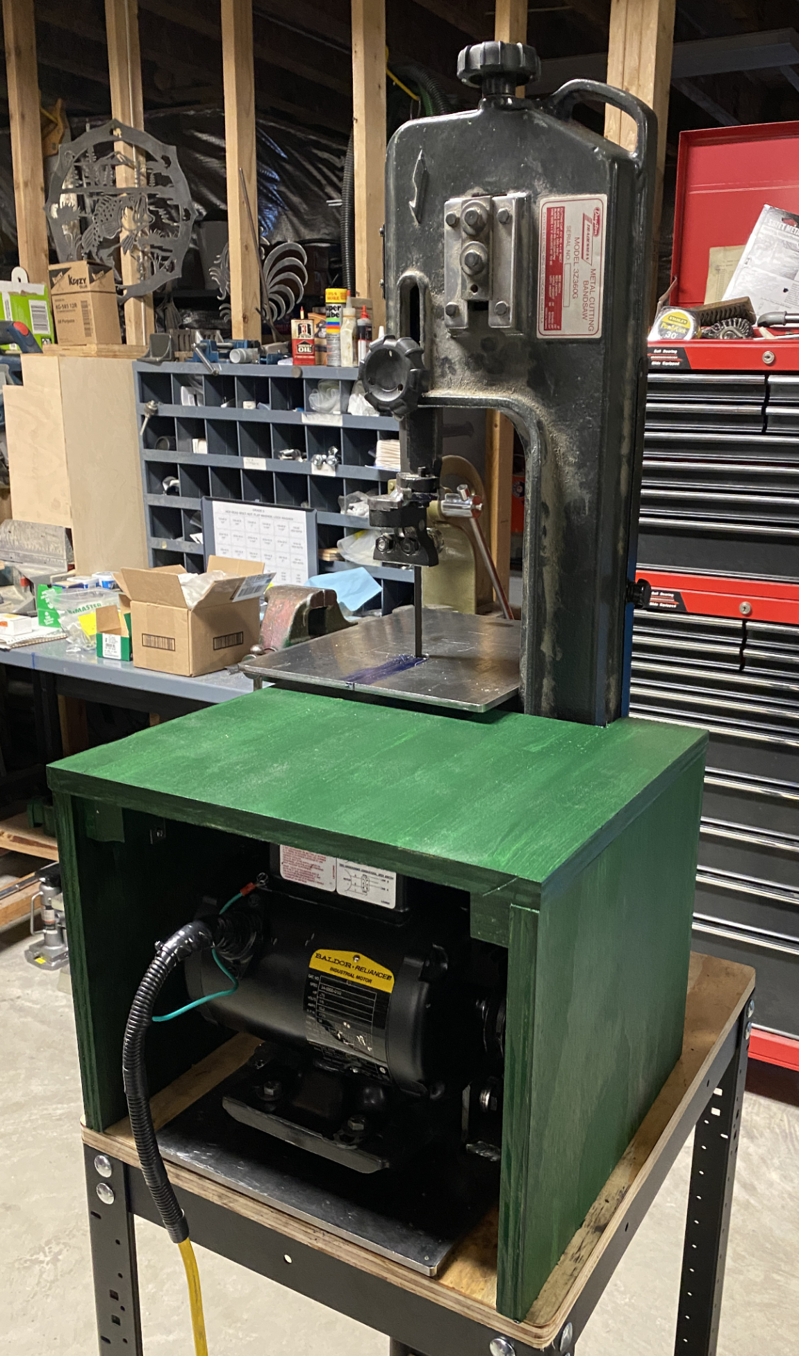

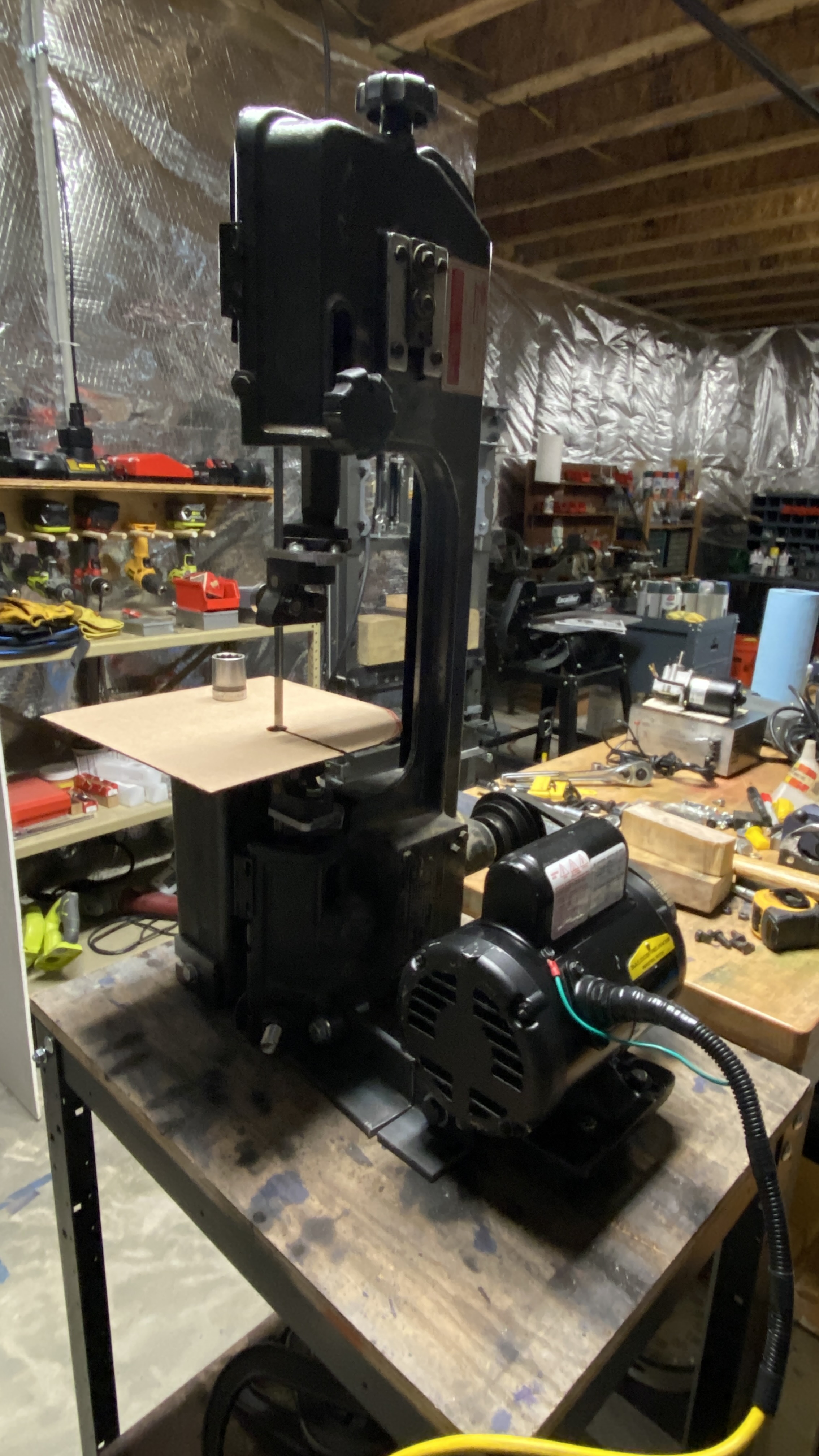

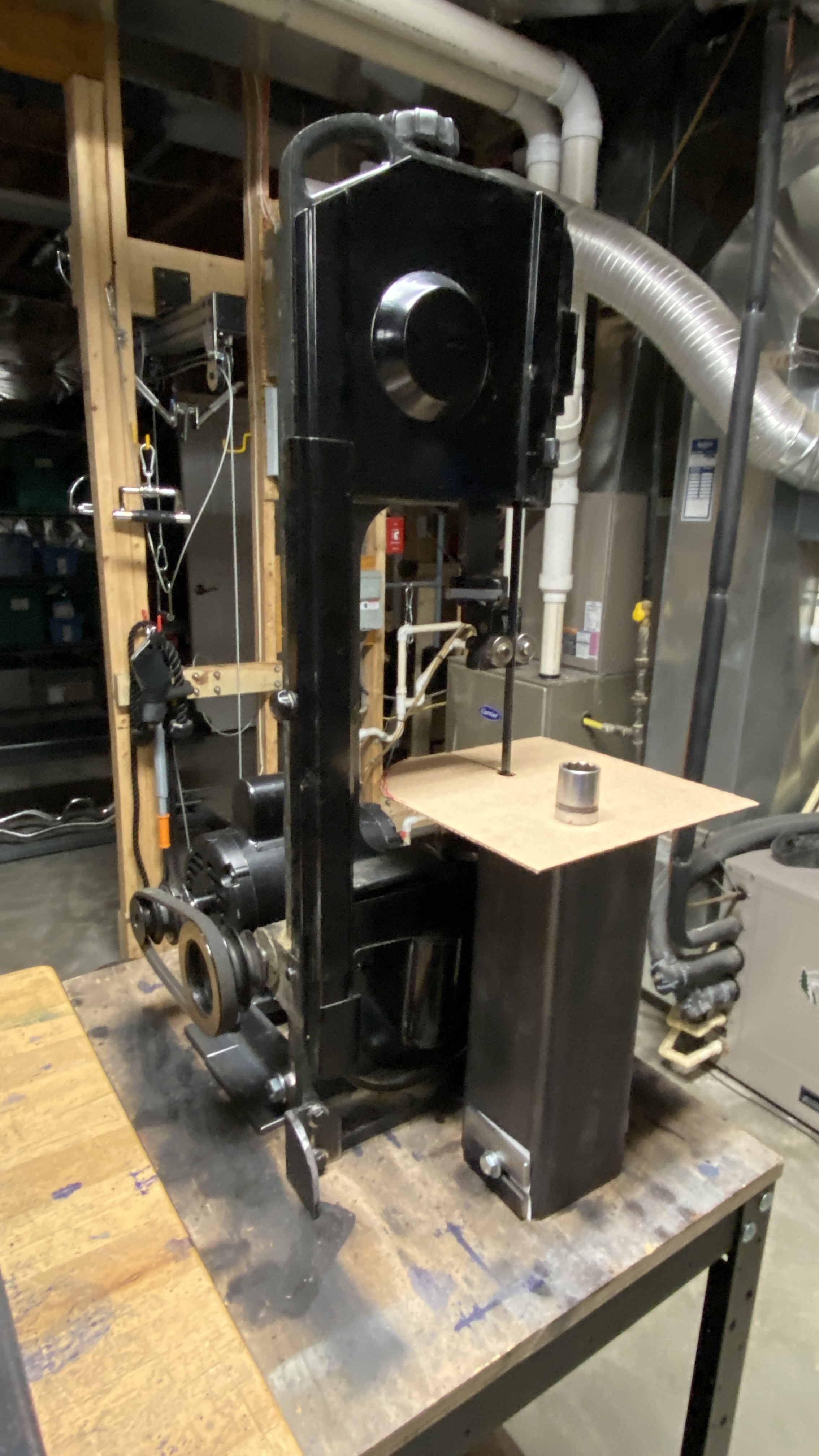

A TEFC motor would obviously be best for my little bandsaw conversion project. However, I found a virtually new 3/4 hp, 1,725 rpm, open enclosure Baldor motor for $80. I'm replacing the little 1/3 hp open enclosure motor that's been on the saw for the last 35 years. Now the problem arises as to how best to keep the chips away from it in its new position relative to the saw.
I thought maybe I would make a cover out of sheetmetal or plywood that would extend up both ends of the motor and over the top. This would at least keep chips from landing on it, and shield the belt and pulleys as well. The top of the cover could extend a bit under the table surface. There would still be plenty of circulation around the motor.
Steel chips are heavier than grinder dust or sawdust, and I'm hoping they are too heavy to be sucked into the motor if they are kept away from the ends.
The whole set-up will sit on a 10" x 20" piece of 1/4" steel plate and the brackets supporting the saw, table support tube, and the motor will be welded in place. The cardboard table template will be replaced by 1/4" steel plate. The square tube supporting the table can be slid forward to gain access to the wheels and blade.
Any advice other than get a TEFC motor?
