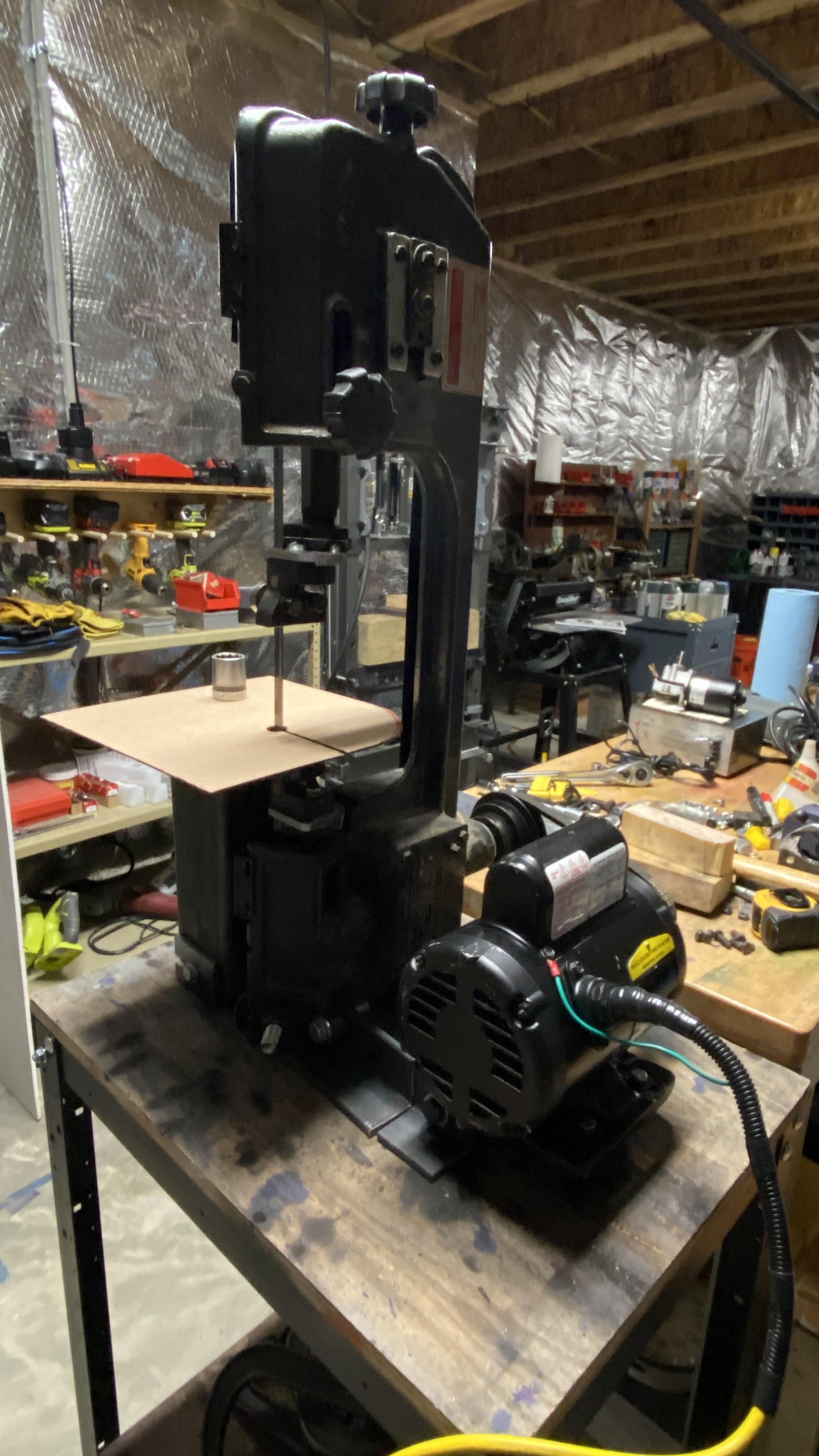

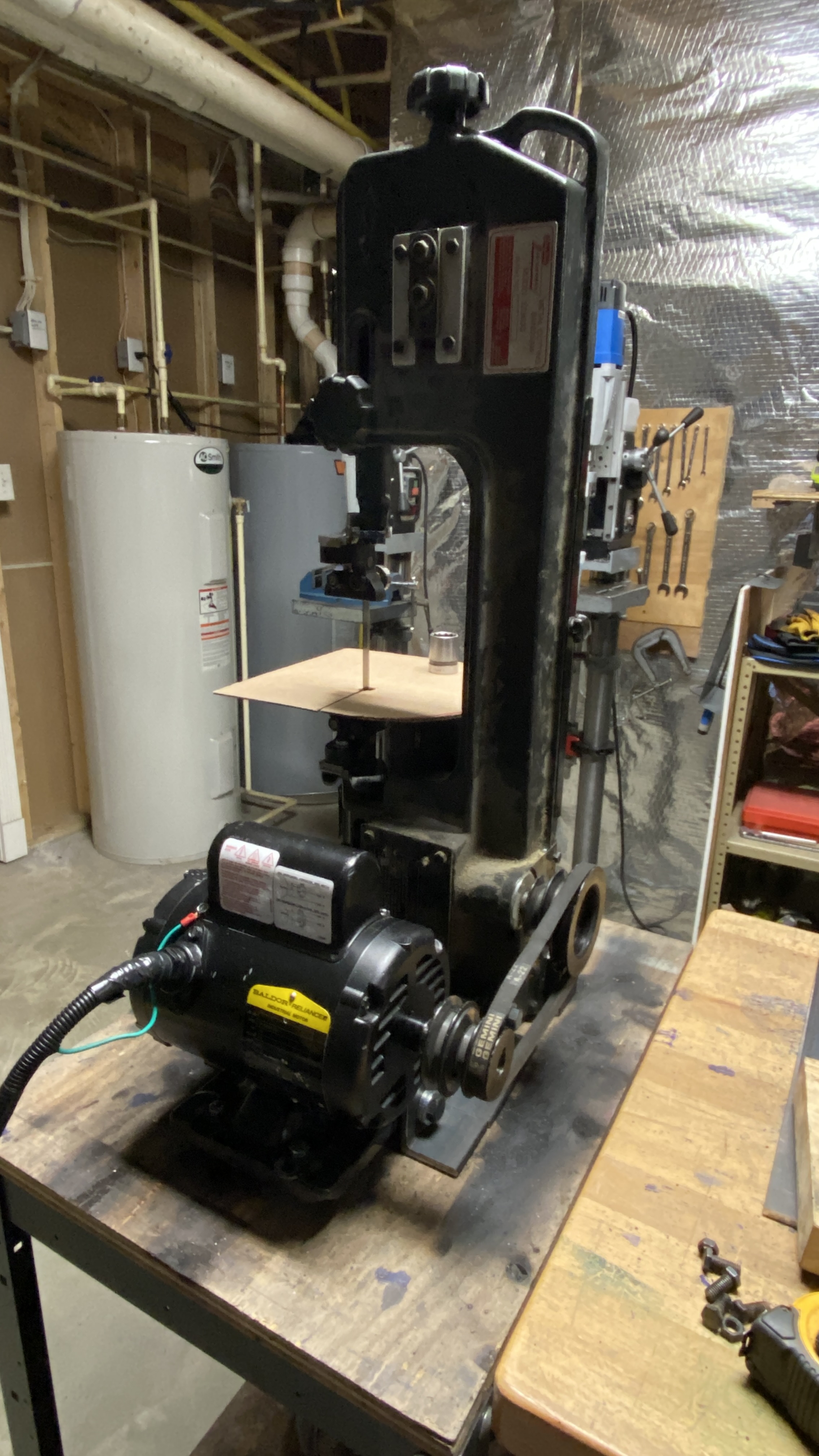

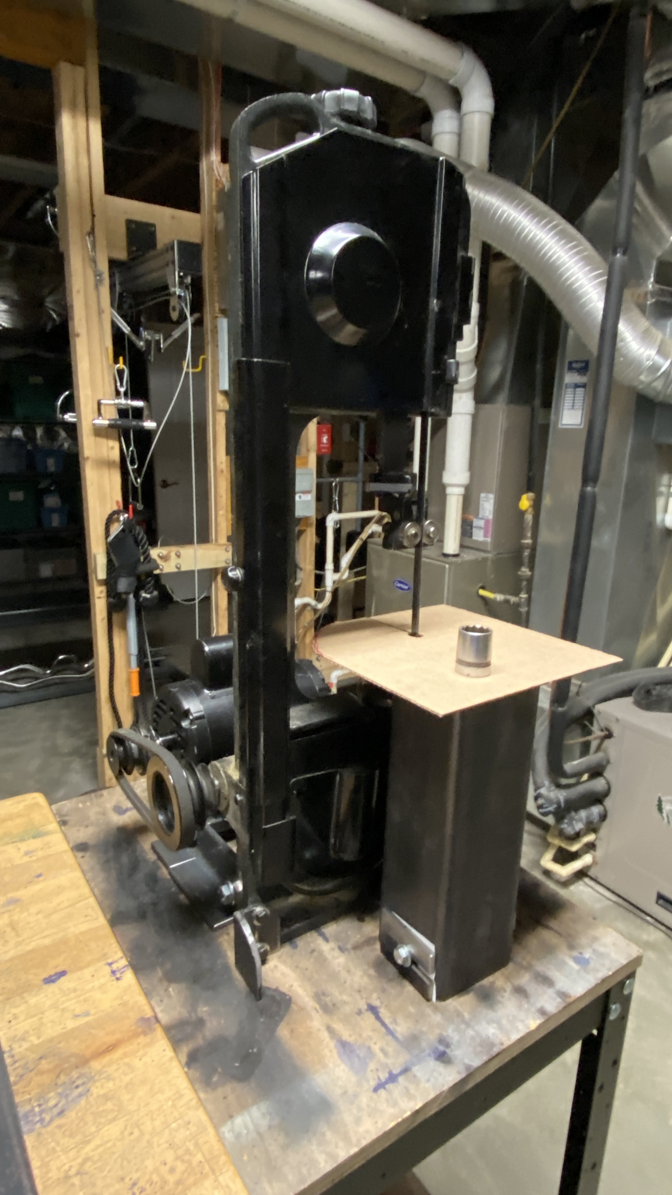

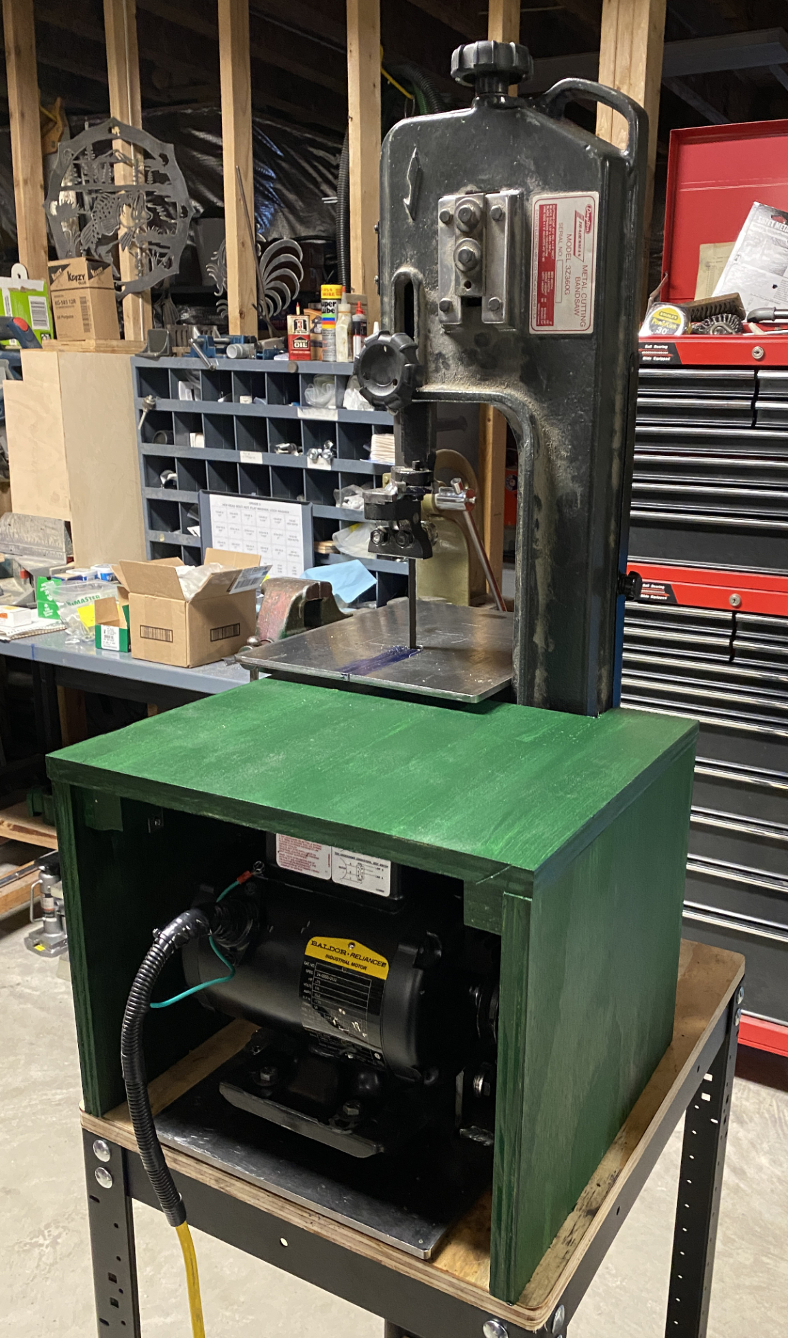

    A TEFC motor would obviously be best for my little bandsaw conversion project. However, I found a virtually new 3/4 hp, 1,725 rpm, open enclosure Baldor motor for $80. I'm replacing the little 1/3 hp open enclosure motor that's been on the saw for the last 35 years. Now the problem arises as to how best to keep the chips away from it in its new position relative to the saw.
    I thought maybe I would make a cover out of sheetmetal or plywood that would extend up both ends of the motor and over the top. This would at least keep chips from landing on it, and shield the belt and pulleys as well. The top of the cover could extend a bit under the table surface. There would still be plenty of circulation around the motor.
    Steel chips are heavier than grinder dust or sawdust, and I'm hoping they are too heavy to be sucked into the motor if they are kept away from the ends.
    The whole set-up will sit on a 10" x 20" piece of 1/4" steel plate and the brackets supporting the saw, table support tube, and the motor will be welded in place. The cardboard table template will be replaced by 1/4" steel plate. The square tube supporting the table can be slid forward to gain access to the wheels and blade.
    Any advice other than get a TEFC motor?

    Use some filter material over the vents, and perhaps put a small fan in there to blowing cooling air over the motor. That's my plan for my bandsaw, anyway. I have one similar to this: https://www.amazon.com/AC-Infinity-C.../dp/B009OWVUJ0 Though I may use that on my HF flux-core wire welder, instead and use the squirrel cage blower my FIL gave me for that. It's open on both sides of the fan, and would need a pair of filters. Something like this: https://www.amazon.com/Duck-Brand-Co.../dp/B08F268Q4M Or they make fibreglass filter material that is similar in size and shape.

    I had wondered what you were using the motor for. Before you go too much further, drain the gearbox and fill it with a good grease. Those 4x6 bandsaws will eventually chew up their gears when used vertically because they don't pick up the oil very well in that position.
    You can cut a couple circles out of a cheap furnace filter and secure them to the ends of the motor with large hose clamps or cable ties. It won't be pretty, but will keep most of the dust out. There shouldn't be any overheating issues unless it's run hard for several hours.

    Arrange a baffle, preferably angled on top to help direct chips away from where you don't want them to go. Could be nearly simple as a cardboard box to work out proportions, hanging over one edge allowing entry of air, from underneath. A covered vent, ducting flow from a muffin fan (pushing out), insures fan has sufficient flow, if desired.

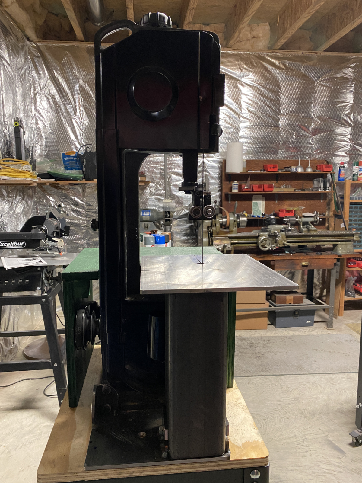

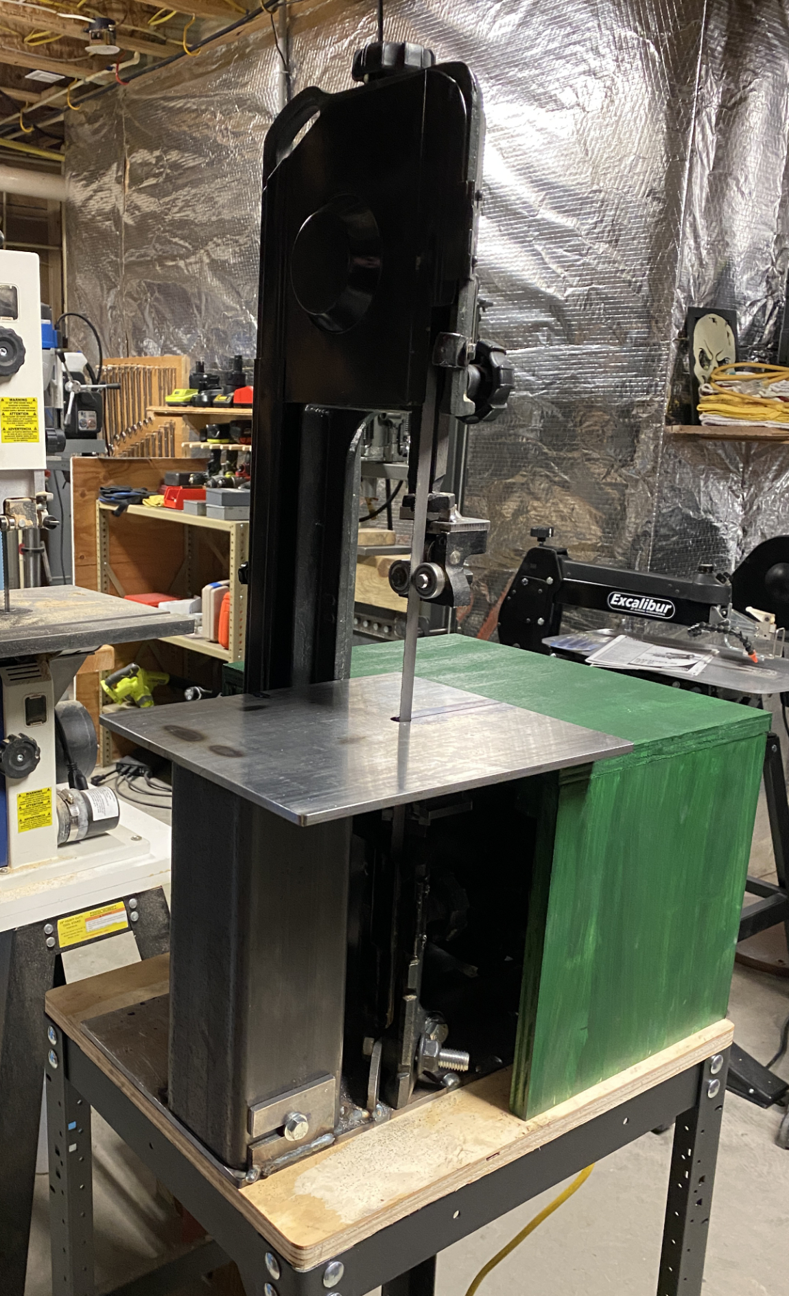

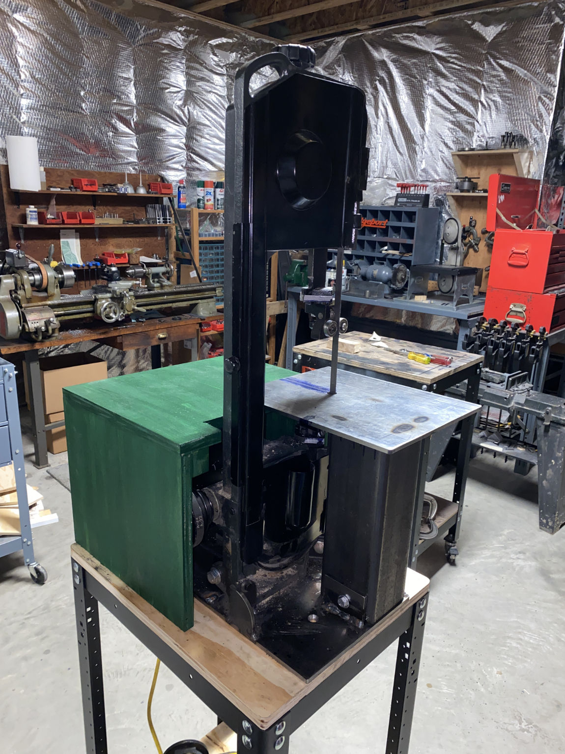

    Here's the finished saw, with a protective box over the motor:
    Attachment 45061 Protection of open enclosure Baldor motor-4x6b.jpg Protection of open enclosure Baldor motor-4x6c.jpg Protection of open enclosure Baldor motor-4x6d.jpg

    No question, that'll work. Plus no specific maintenance requirements.
