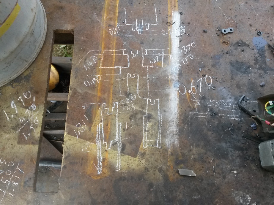

So I took some measurements
Attachment 30685

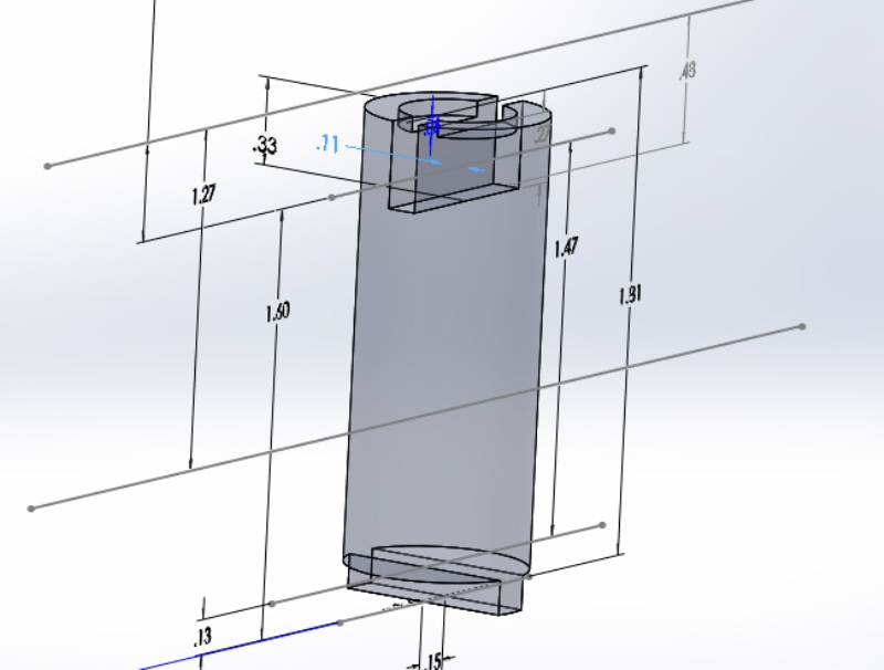

then drew it up
Attachment 30686

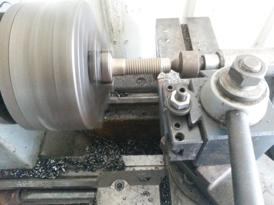

Then to find a hard enough piece of stock to make the coupling out of the closest thing I could come up with to be near hard enough was a 7/8" grade 8 bolt
Attachment 30687

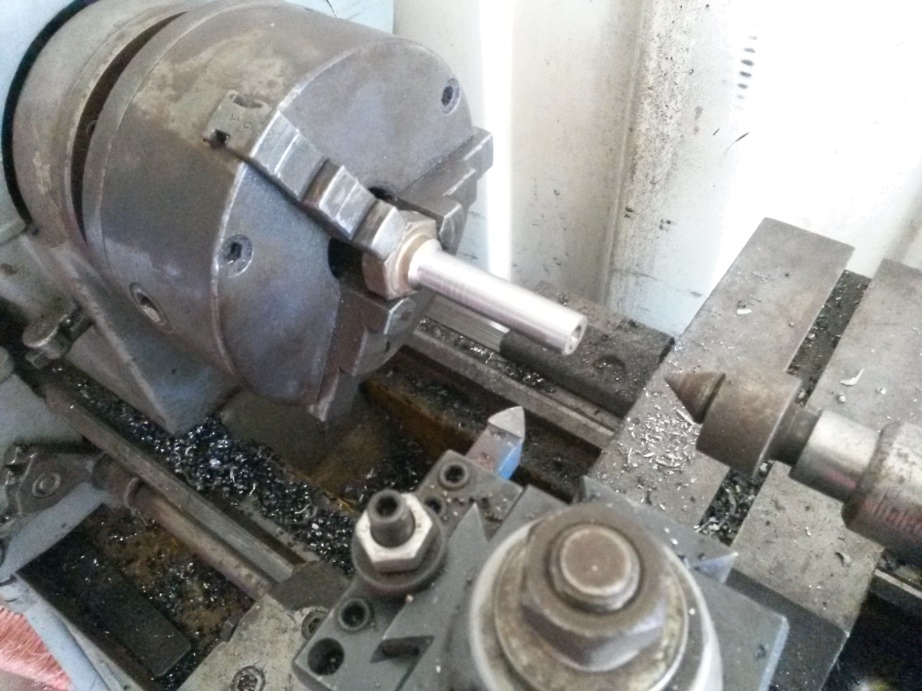

After turning it down
Attachment 30688

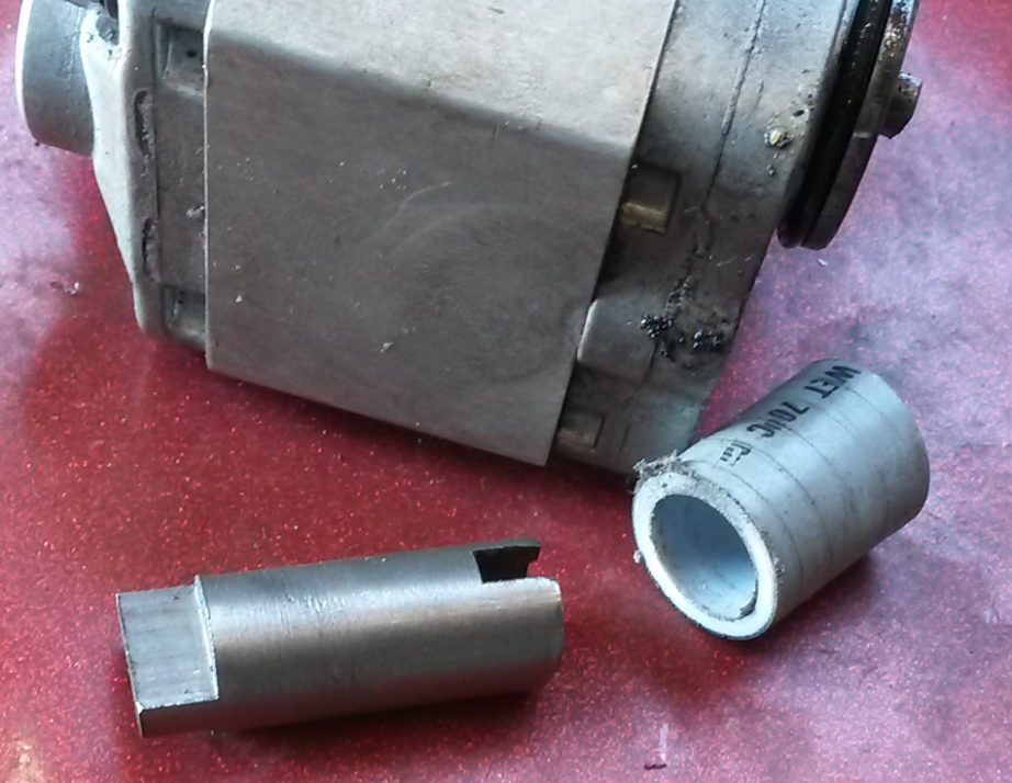

I milled the ends to fit the pump on 1 end and the motor on the other then thought one things these coupling do is the can wobble of center since nothing held them true except for the slits and tang being 90° to each other
on 1 end I recessed the slot by counter boring the coupling just a little and for the other end I found that PVC nonconductive flex conduit was just about .2
020" undersize in bore I pressed it over the coupling and the motor shaft the pump end has the recess so both ends are now held centered

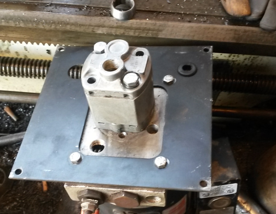

Attachment 30689
Assembled and ready for a tank to mount it in
