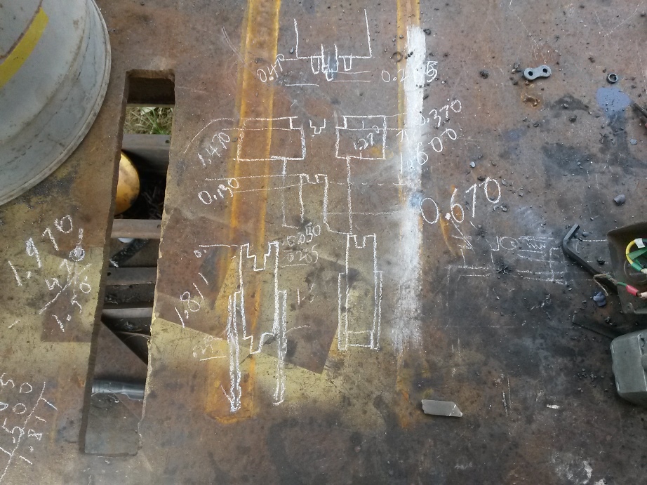

    So I took some measurements

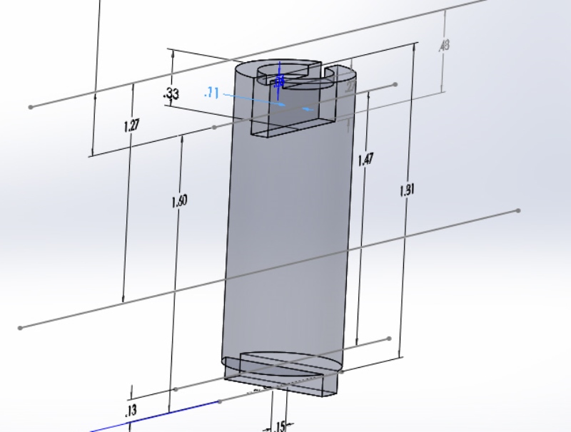

    then drew it up
Name:	pump motor coupling.JPG

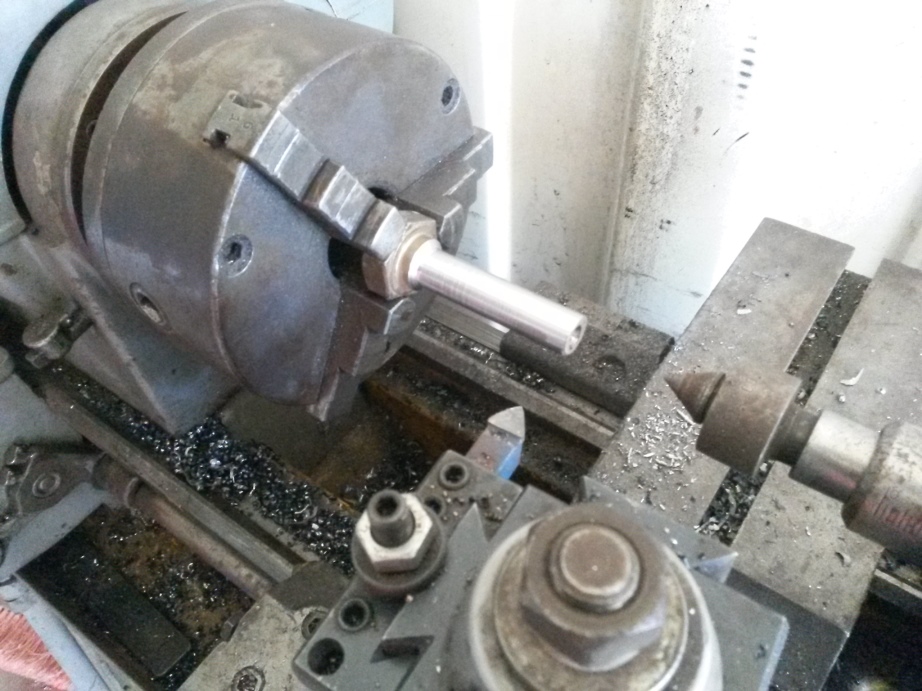

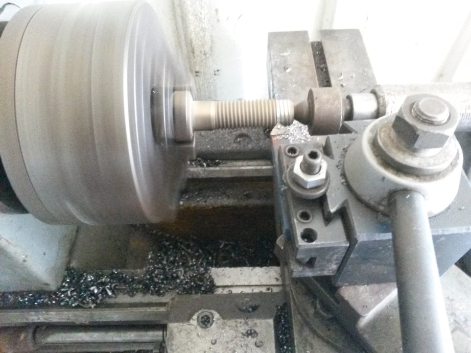

    Then to find a hard enough piece of stock to make the coupling out of the closest thing I could come up with to be near hard enough was a 7/8" grade 8 bolt
    After turning it down

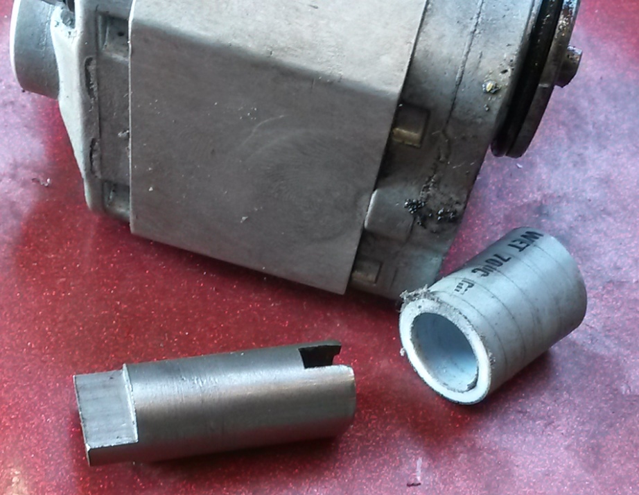

    I milled the ends to fit the pump on 1 end and the motor on the other then thought one things these coupling do is the can wobble of center since nothing held them true except for the slits and tang being 90° to each other
    on 1 end I recessed the slot by counter boring the coupling just a little and for the other end I found that PVC nonconductive flex conduit was just about .2
    020" undersize in bore I pressed it over the coupling and the motor shaft the pump end has the recess so both ends are now held centered

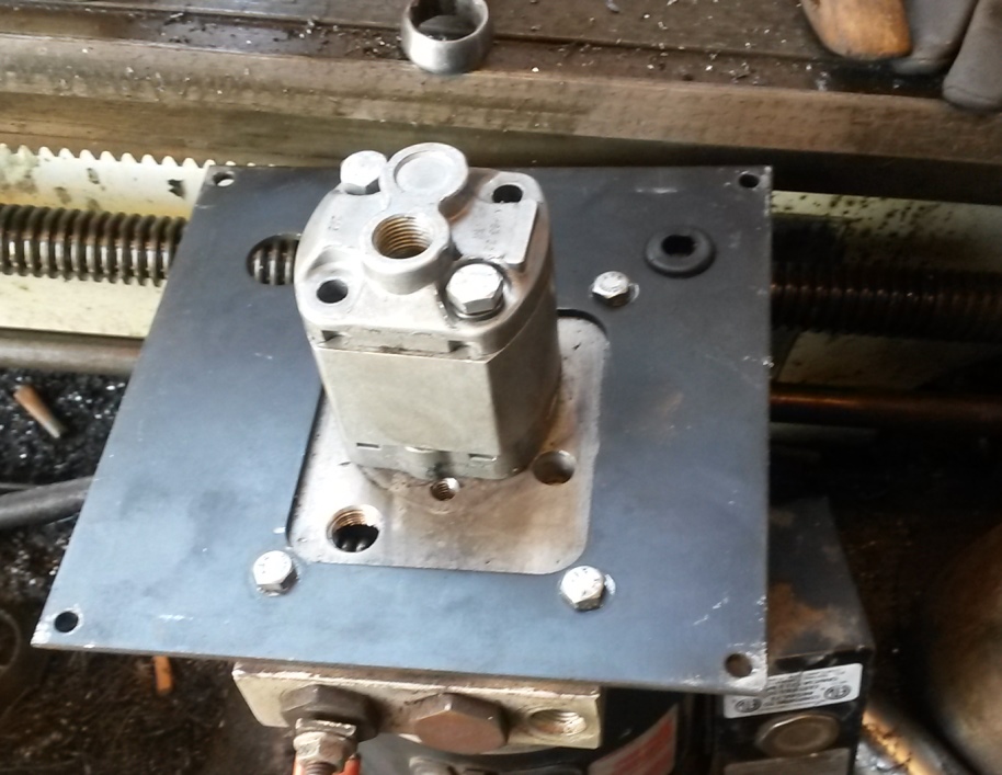

    Assembled and ready for a tank to mount it in
