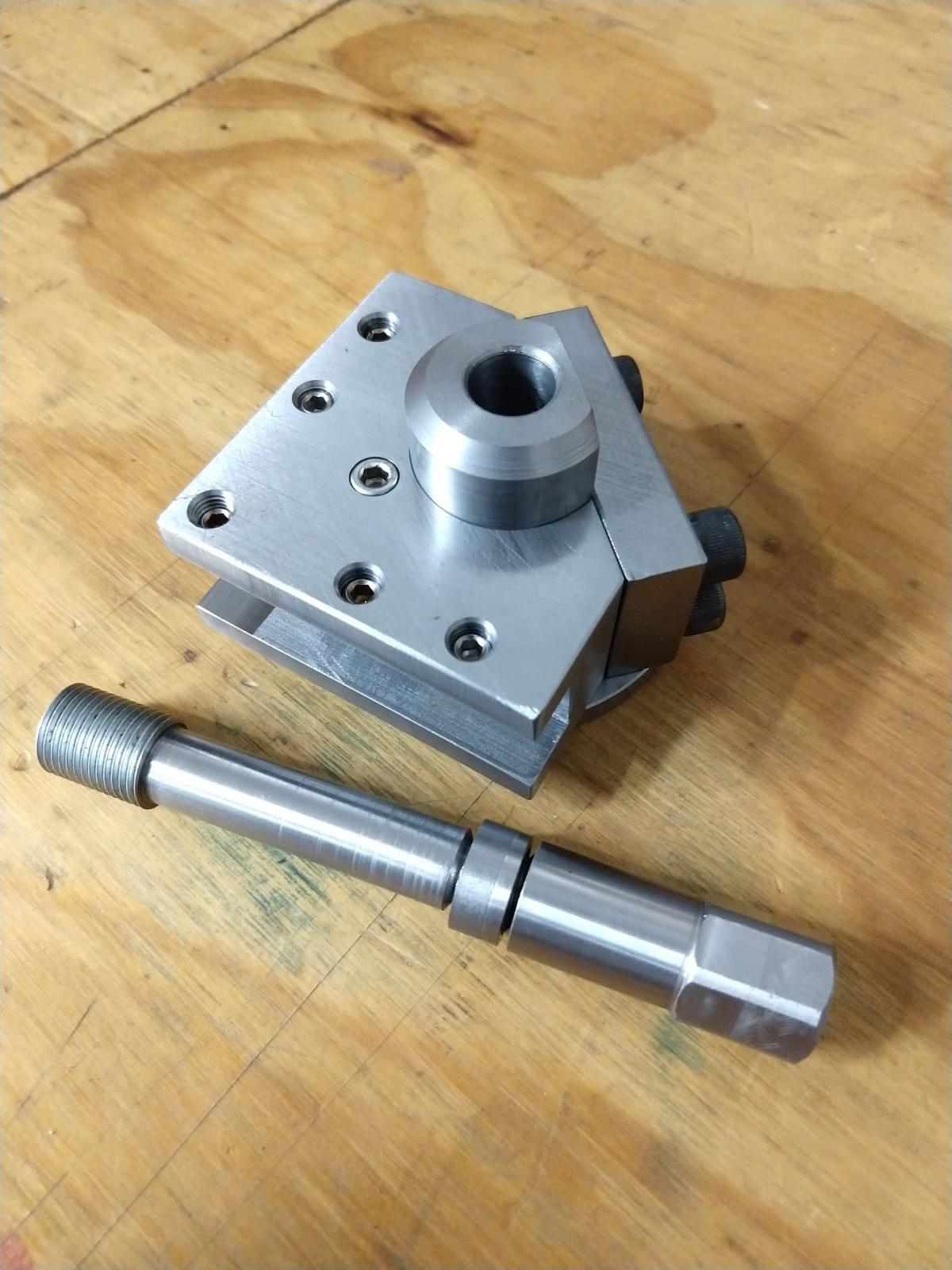

i just finished the tool post today. I have never been disappointed on any plans I've bought here and yours was no exception. Very well detailed and complete. You must've put a lot of time into them.
I did make a few changes as I have a larger lathe. I wanted to hold 5/8" tool bits so also had to mill the tool pocket deeper (.500"). I just went slightly larger on the tool holder dimensions adding 1/8" all the way around. Ideally I would have liked to raise the height but didn't have material any taller. I used 5/8-24 all-thread for the stud as I already had a t-nut made and had the all-thread I also didn't drill the mounting nut all the way through.
The only big mistake was when I drilled the holes that hold the tool bit down I did it on the wrong side. Just put it in the vice and started drilling and tapping. Oh well not big deal I guess. Thanks for a great project.

Nice job on the toolpost.
Nice workmanship also!
