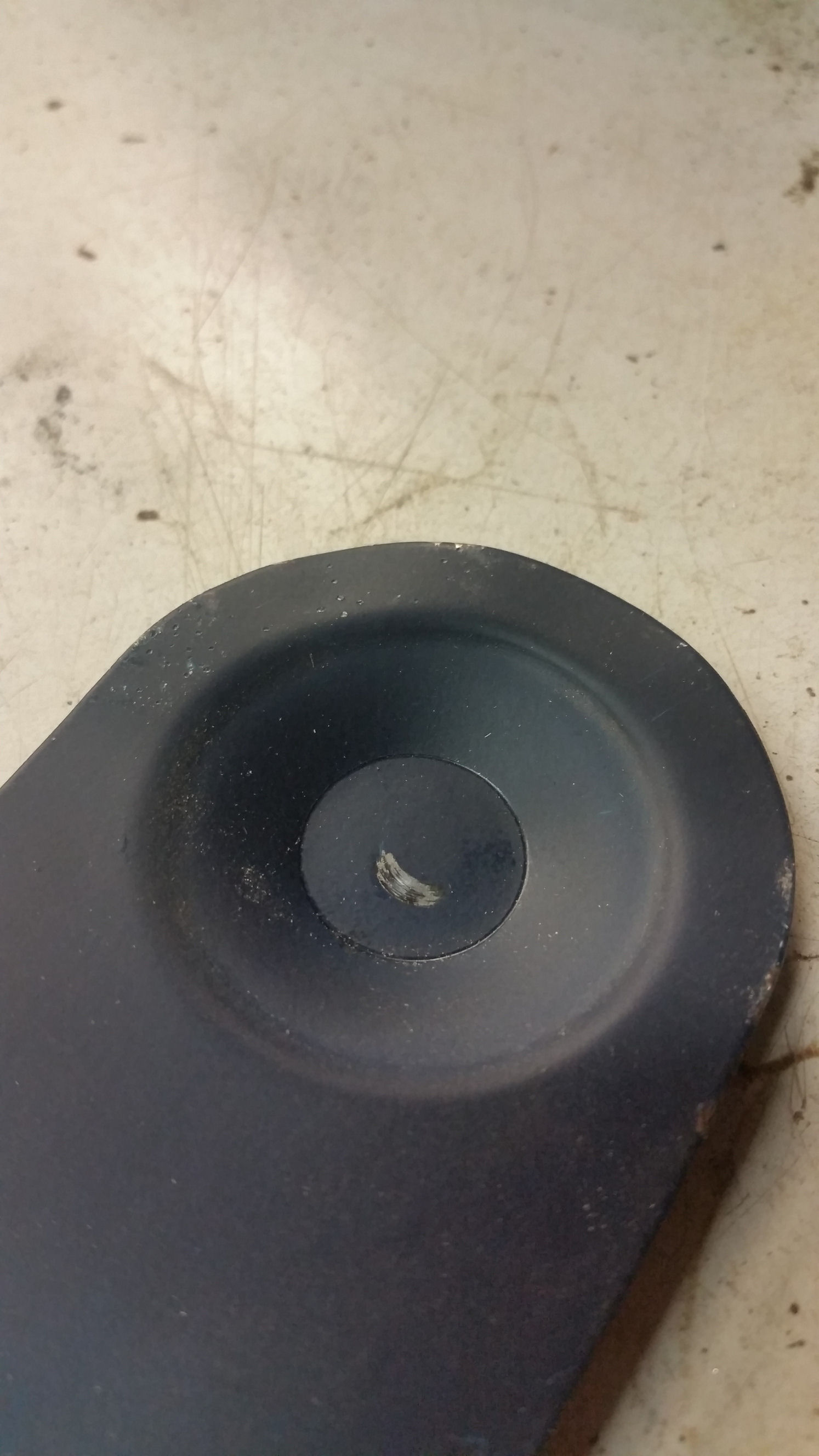

Hi all, This one came about when i needed to press the bump of a pulley cover out a bit more to clear a new bolt.
This is what i needed to press out more.

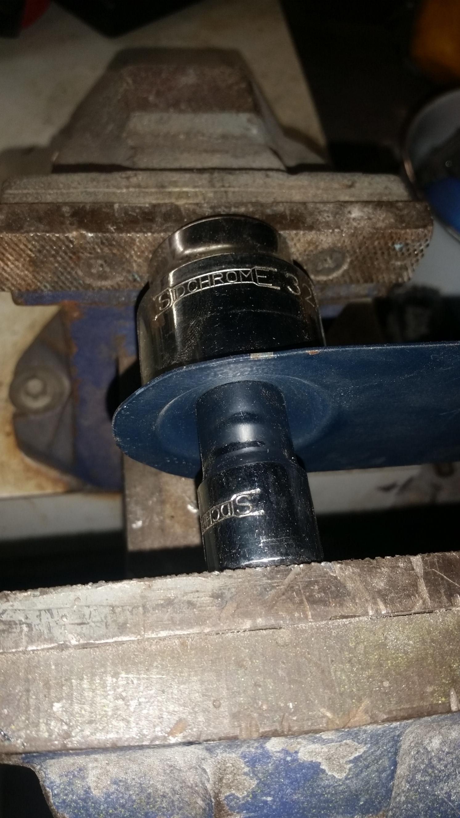

So I grabbed a couple of sockets of different sizes to suit and set them up in the vice with the piece in between them.
Attachment 3787
Gave the vice a good twist or 2 until it had pressed enough

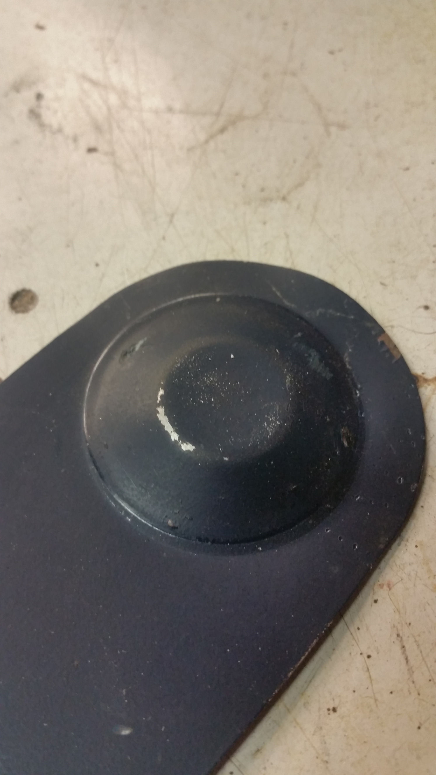

And this is how it came out
Attachment 3785

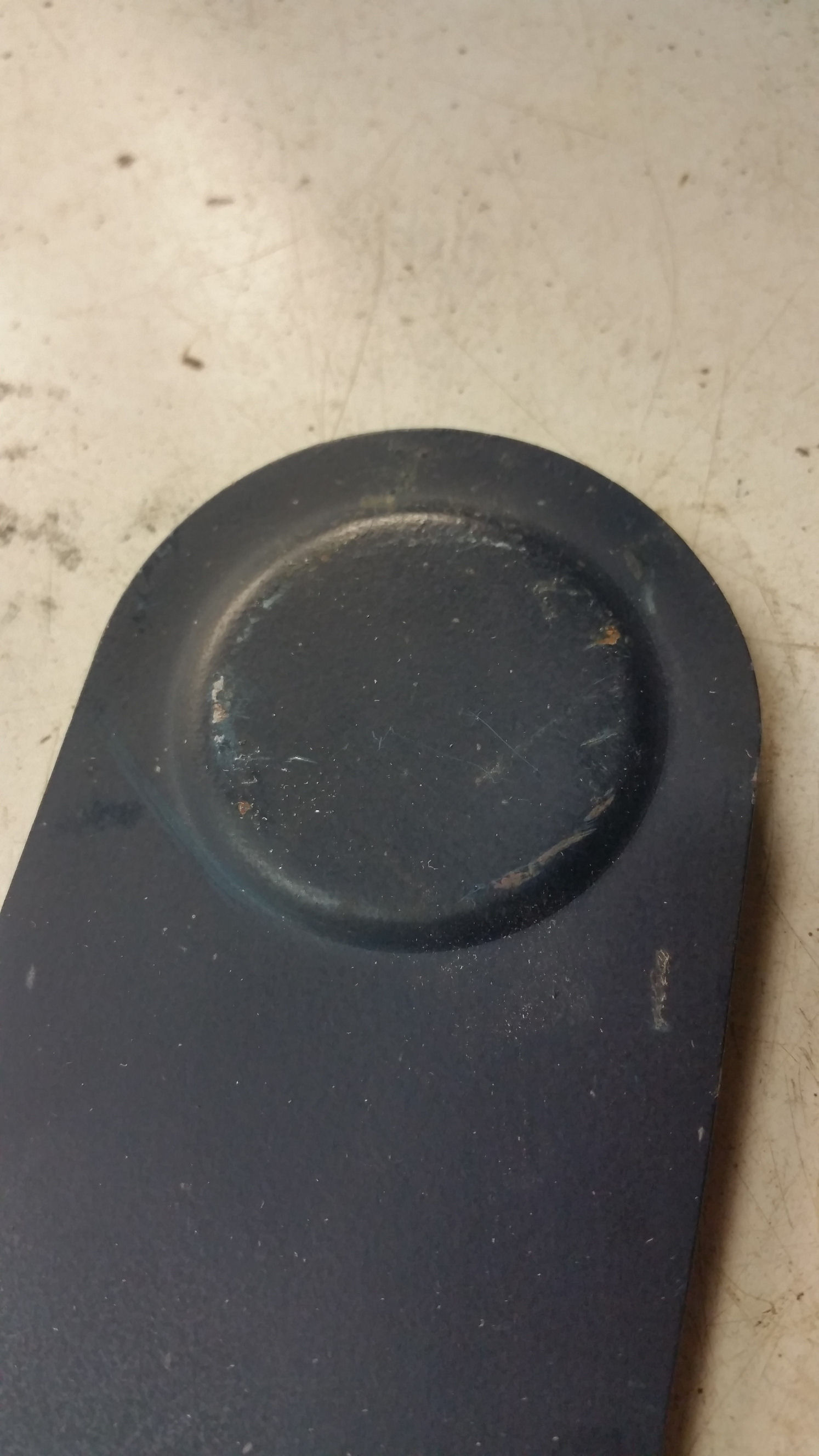

This one you can see where the bolt head rubbed. Not any more! :cool:
