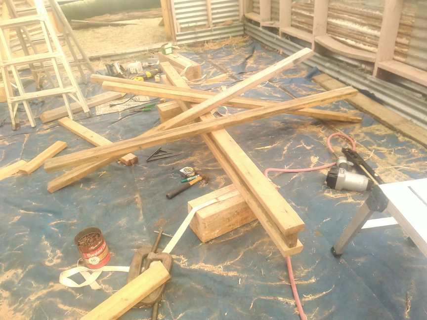

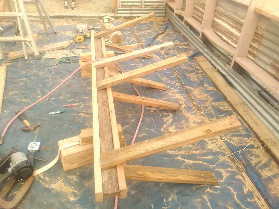

I started these by nailing 3 8 ft 2x4s together to make an "I" beam then cut 8 2x4s 32" long and nailed them in place then sued some scrap pieces as under braces
Attachment 40434
using the air nailer and butting the legs up to the I beams I saw no need to do any fancy coping or cutting at angles

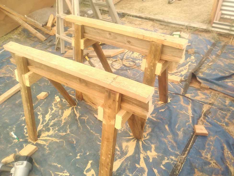

then just saw in half a pair of horses can be made in about 15 minutes
Attachment 40436
