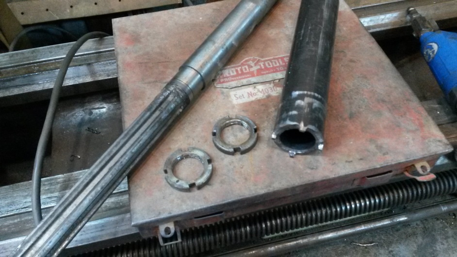

The quill bearings on my very old ENCO bench mill decided to fail.
Causing me to have to make a 4 prong socket to remove the bearing nuts

I replaced the ABEC7 angular contact pair a few summers ago on my Wells-Index mill. There is no zerk or any other access to lubricate them once installed in the spindle.
I was able to procure new old stock of the original New Departure bearings from Bearing Locator. And not too bad a price.
I made some tools to support the spindle to press the bearings off and on.
