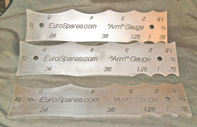

A radius gauge
These radius gauges are sold for use in metal shaping by various people. I think the original gauge may have been done by Fay Butler.
I wanted one and since I have a CNC mill I decided I'd draw up and make my own. I ended up making a small batch (7 ea) since I had to buy a length of aluminum bar, and they made nice holiday/birthday gifts for some gearhead friends of mine.
I called them "Arrr!" gauges because who doesn't like to talk like a pirate?
Attachment 26685
I don't have any photos of them on the mill. The two 1/2" holes were for hold-down studs during machining, but they could also let the gauge be hung on a nail on the wall.
cheers,
Michael

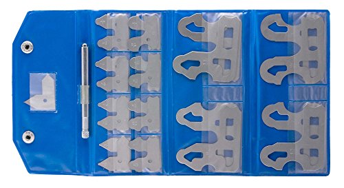

I used to have a set of radius and fillet gauges which had both concave and convex surfaces for checking weld sizes very handy to settle a dispute over weld size
1 Attachment(s)
Something like this?
Attachment 26686
I've got those in both metric and inch versions and they are very handy, but they only cover smaller sizes of radii. I took a length of scrap AL round bar, about 1.75" or so diameter, and made as many different OD discs out of it as I could, with a hole in the middle of them to string them on a piece of soft wire. Those let me do some checking for radii a bit larger than the machinist sets cover.
The gauges like I made are commonly used for checking a radius on a body panel. If you are extremely serious (or a designer at an auto manufacturer) you might have a set of sweeps like this 85 part set for $3000 from Fay Butler
Fay Butler Metal Fabrication: Sweeps
That's a bit beyond my needs! If I have to, I can print off some different radii onto paper and cut them out to try and narrow down the dimension on the part I'm checking.

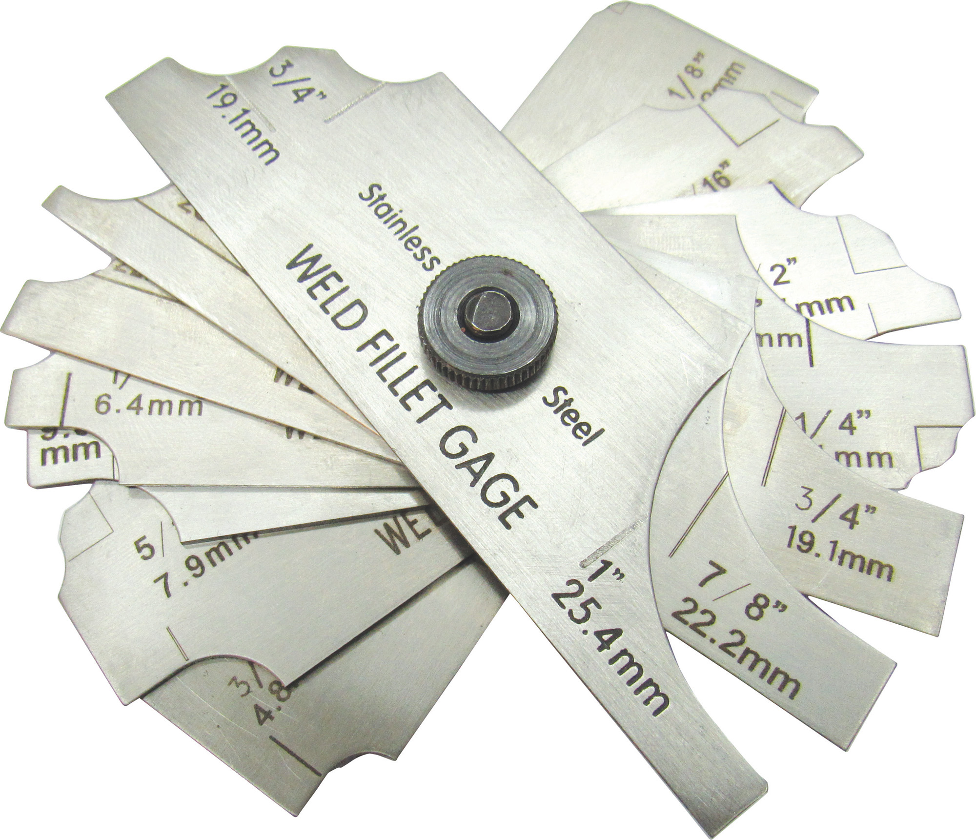

1 Attachment(s)
Mine were Starret but similar the weld gauges looked like this

Hello Michael,
can you make these even in metric sizes? I think in Europe there are a lot off machinist ho will order a set.
1 Attachment(s)
I suppose the radii could be multiplied by 25.4 to make them metric. :)
Anyone who has even a small amount of knowledge of CAD could make the outline with standard metric sizes for standard metric stock, and any CNC shop could knock them out as they are a simple 2.5 D operation, no fancy surfacing involved.
Here's a PDF of the basic gauge. It is 16" long by 3.8" tall and I think the PDF should be to scale. All I did to create it was to make a number of circles and fit them to three sides of a rectangle, and then trimmed everything and put a radius on the sharp corners. That should give you an example to help you to lay out a metric version.
I hope that is of some assistance to you.
cheers,
Michael
