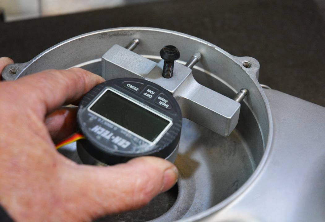

    I recently posted about some reverse engineering that I needed to do to replicate some classic motorcycle crankcases at
    http://www.homemadetools.net/forum/h...029#post120271
    Continuing on from that I needed to measure some corner and other radii, there are many possibilities for such tasks, for example MichaelMoore recently posted his templates at
    http://www.homemadetools.net/forum/r...348#post122031

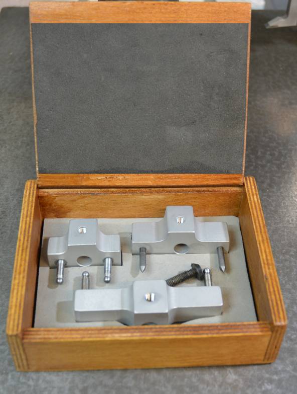

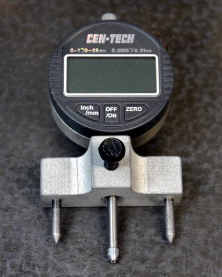

    This current post is about a set of radius gauges that I built using a digital gauge as the measuring element.
    Radius gauge and reverse engineering-radius-gauge-06.jpg Radius gauge and reverse engineering-boxed.jpg Radius gauge and reverse engineering-radius-gauge-11.jpg
    I have put the full story in a PDF which can be seen and/or downloaded from:
    Tony's radius gauge
    I have also written a simple bit of software to perform radius calculations and that is linked in the PDF file. I will also add a video in the next few days.

    I have just enhanced the software to allow calculation of the curve radius and centre coordinates when the XY coordinates of three points on a curve are known.
    This is useful if you use the DRO on a milling machine to determine the coordinates of three points. This does not need the radius gauge described above.
    The link to the software is the same as that in the PDF RadiusGauge.pdf

    I have not had time to edit the video that I promised so I have just uploaded a 3 minute unedited version of the most interesting part of the radius gauge construction.https://motochassis.com/FileDump/Rad...adiusGauge.wmv
