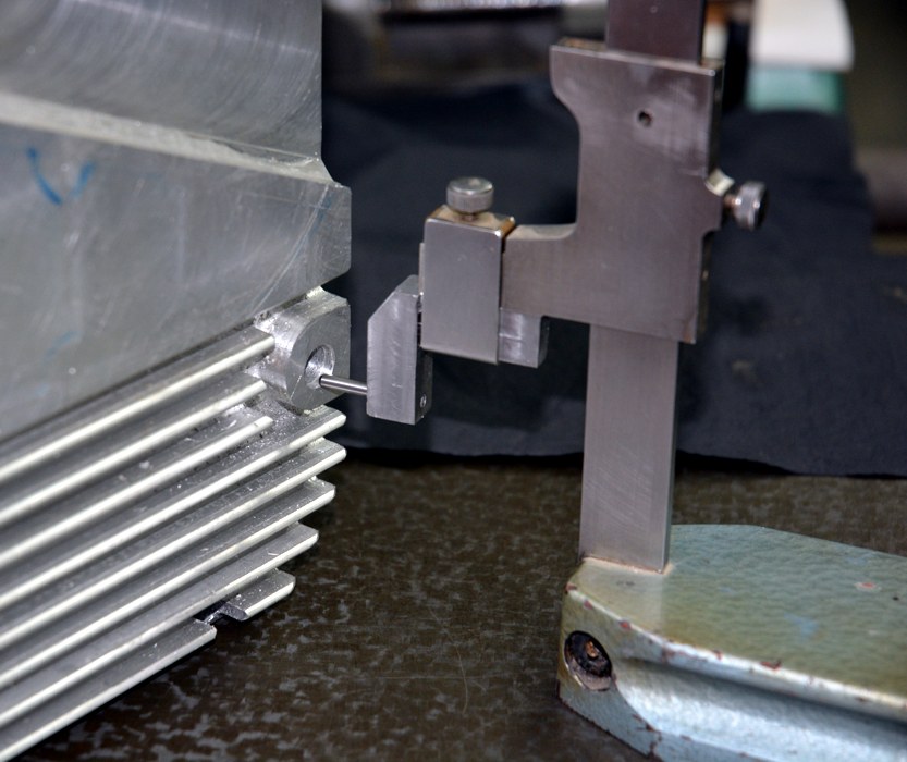

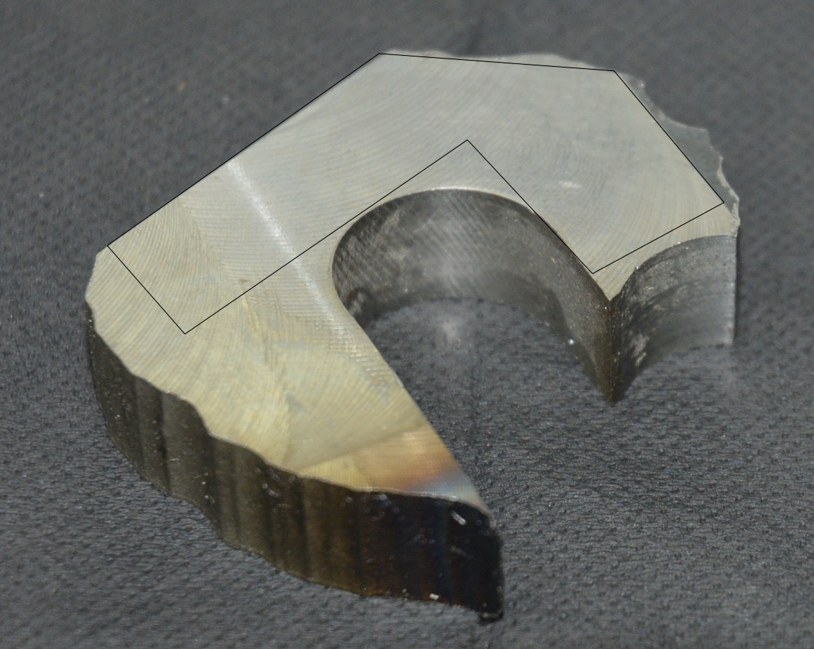

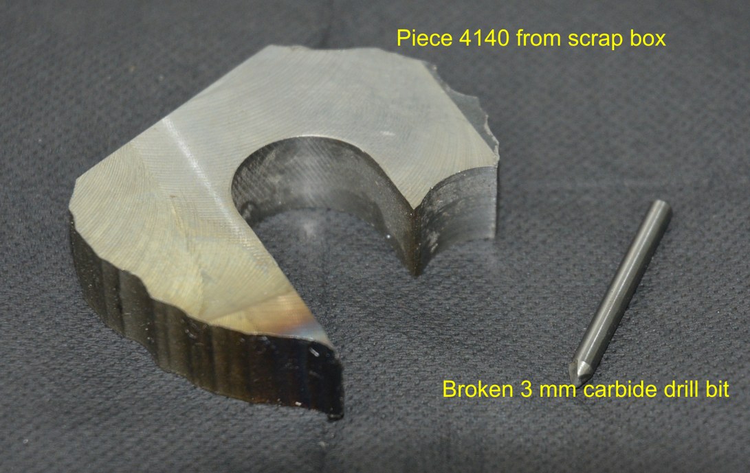

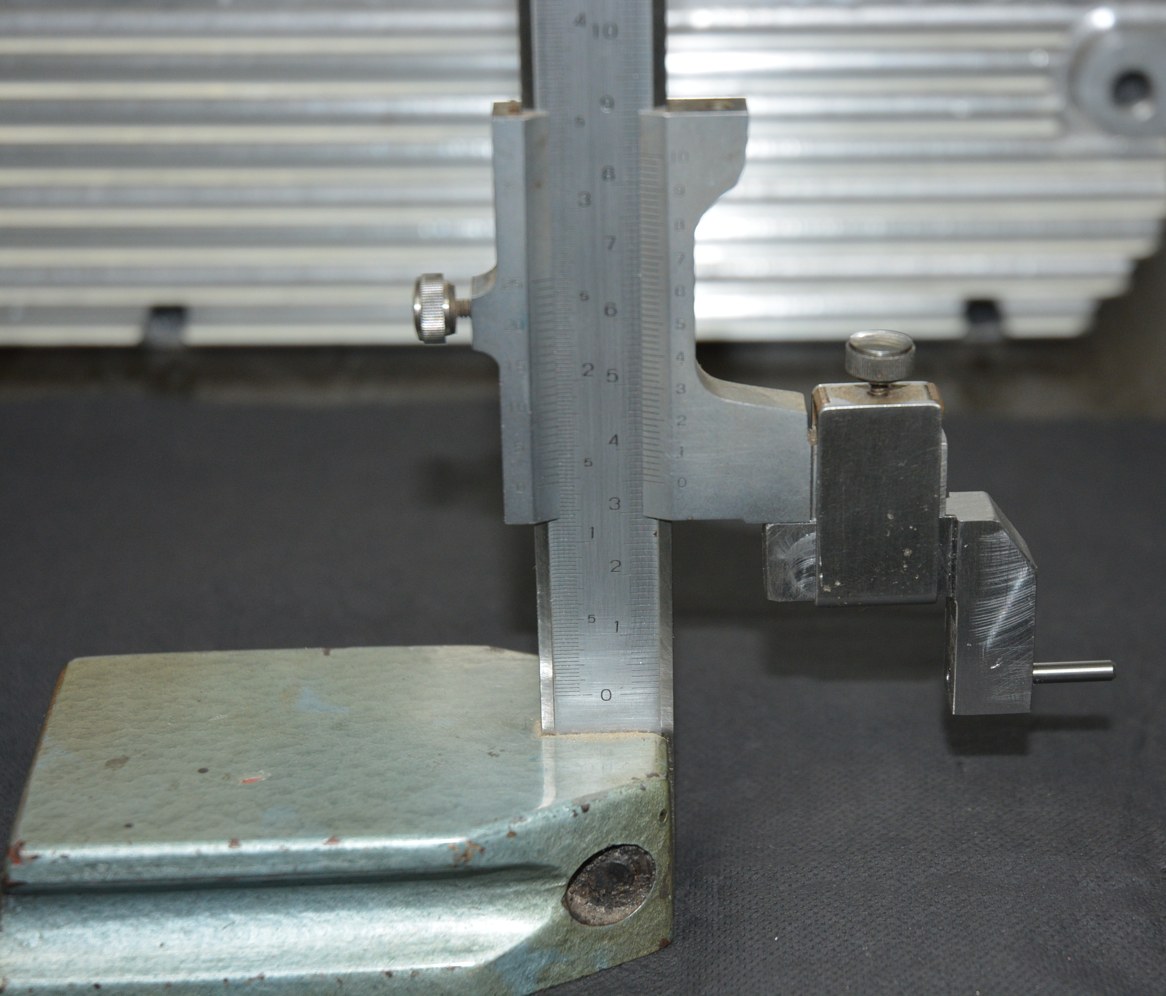

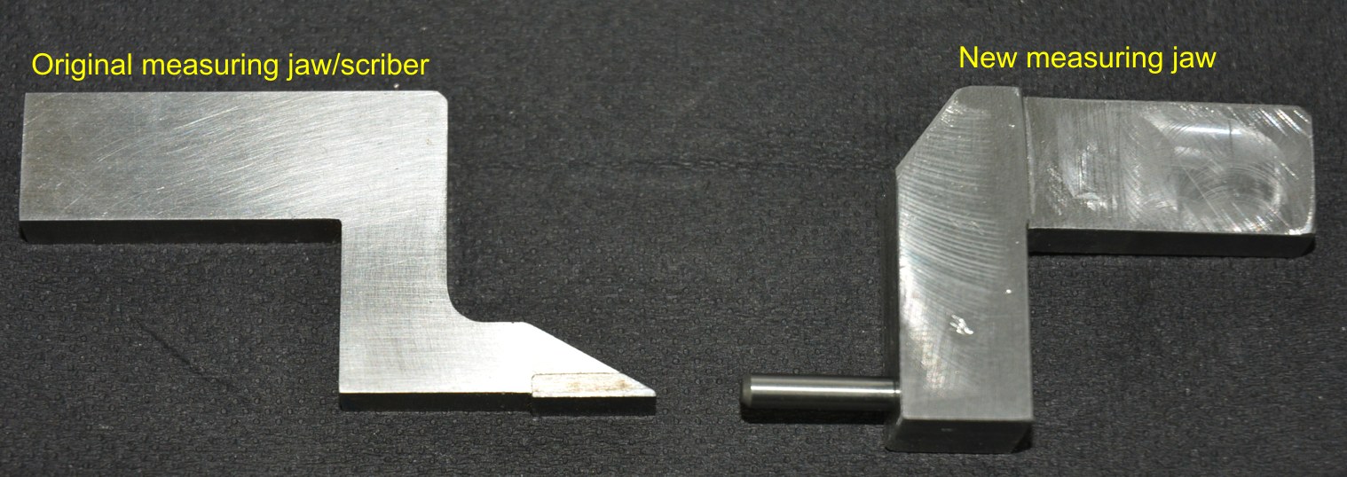

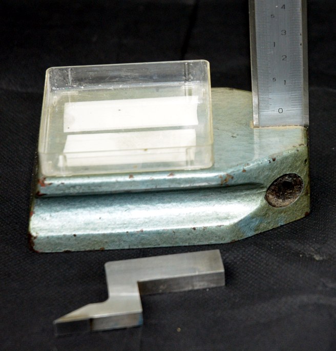

    This is just a quickie post. This afternoon I needed to measure the height of some holes off a surface plate. The usual measuring jaw/scriber has a flat bottom and is about 6 mm wide. This is fine for measuring flat surfaces but is not suitable for narrow vertical slots or holes.
    I decided to stop my work and make a replacement measuring probe which I am sure will pay me many times over in time saved down the road.
    My scrap box offered up a piece of 4140 which was hiding the piece that I needed, a broken 3 mm carbide drill bit completed the BOM.
    Height gauge addition.-raw-materials.jpg Height gauge addition.-hidden-shape.jpg Click on thumbnails for full size images.
    On the left are the materials and on the right we see the piece hiding in the block (never throw out even the most useless looking scrap).
    Height gauge addition.-finished-thing.jpg Height gauge addition.-old-new.jpg

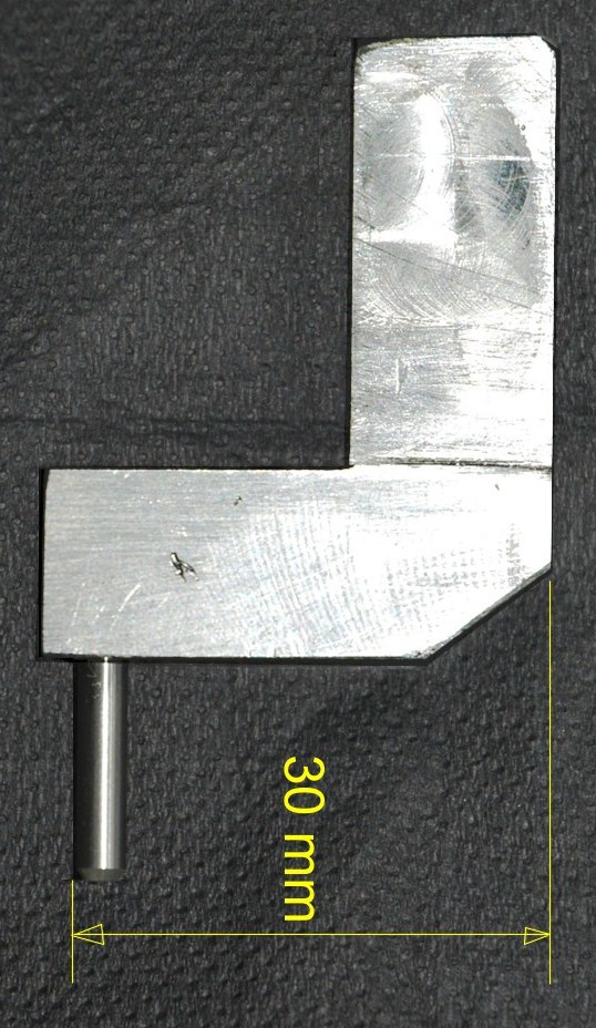

    Here is the result of half an hour's marking and milling compared with the original scriber.
    I wanted to position the bottom of the probe/stylus (I don't know what else to call it) such that it was the same distance down from the top reference surface as the original so that I could rely on the stock measuring scale. The original was 30 mm from the top surface to the underside of the scriber. To ensure this I initially drilled the hole centre, for the carbide drill bit, at 28.75 mm (30.25 - 1.5 = 28.75 mm. 1.5 is the stylus radius) down from the top surface. 30.25 mm instead of the final 30 mm to allow for any inaccuracy in positioning the hole. Then with the stylus pressed home I clamped the whole thing into the height gauge and used it to measure the height of a 10 mm gauge block. The vernier showed it to be 10.24 mm. I then milled another 0.24 mm off the top surface and retested. It was spot on as far as the vernier resolution could measure.
    Ready to go.

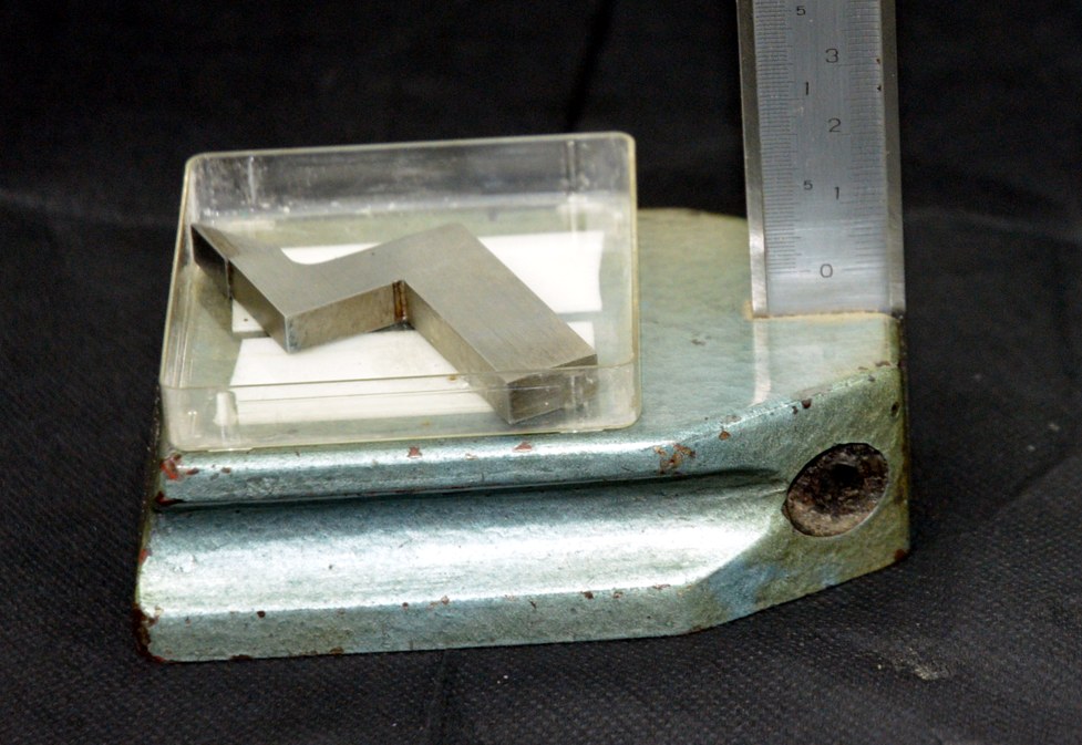

    Showing a typical application which the stock measuring jaw/scriber has trouble with. The new stylus has some material underneath it which prevents the stylus reading down to zero, the minimum is 3.5 mm but that is unlikely to be a problem for its intended and expected use.
    Final touch. I used double sided sticky tape to fix a plastic box to the height gauge base to store the part not in use. A minor thing to do but of great importance to avoid losing a vital piece.
    A simple device, which I now wish that I had made decades ago. It wouldn't surprise me if similar probes are available commercially and/or home built by others, but I have not looked. I needed it there and then and making it was quicker than searching the net, ordering one and waiting for delivery.

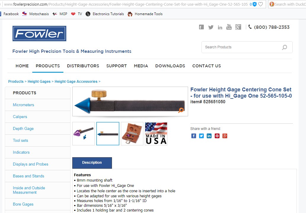

    In a spare moment on the net I searched for "height gauge accessories" and much to my surprise I found nothing like the piece in the above post. However, I did find this cone based hole centre finder.
    Height gauge addition.-cone-1.jpg click thumbnail for full size image.
    It looks like it could be useful but it relies on the hole entrance being in good condition, which is not always the case. I think that I'll make one anyway but I'll use a shallower angle on the point.

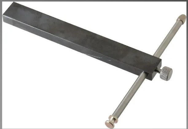

    Another accessory that I found was for using a height gauge as a depth gauge. I'll definitely make one of these. I have been doing some reverse engineering lately and that will come in very handy.

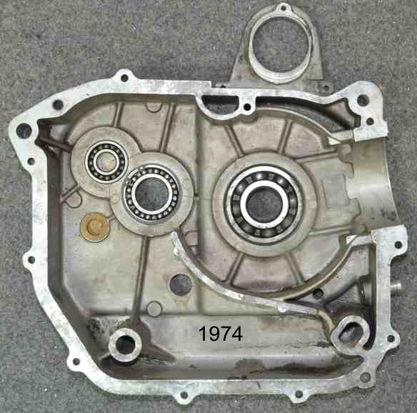

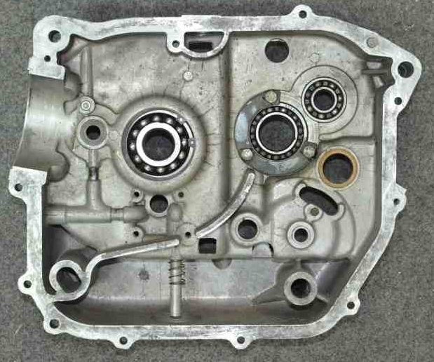

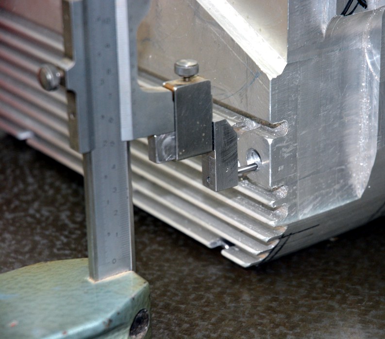

    I made a similar device, but instead of the clamping screw on a straight rod I used a threaded rod with a lock nut. This makes for an easy way to get a precise reference position. It has proved to be invaluable over the past few days for the reverse engineering that I have been doing. Motorcycle crank and gear cases with a view to making modified version out of solid 6061.
    Height gauge addition.-crankcases010.jpg Height gauge addition.-crankcases011.jpg Click thumbnails for full size images.
    Originals.
    Height gauge addition.-where2start.jpg Height gauge addition.-rainingswarf.jpg

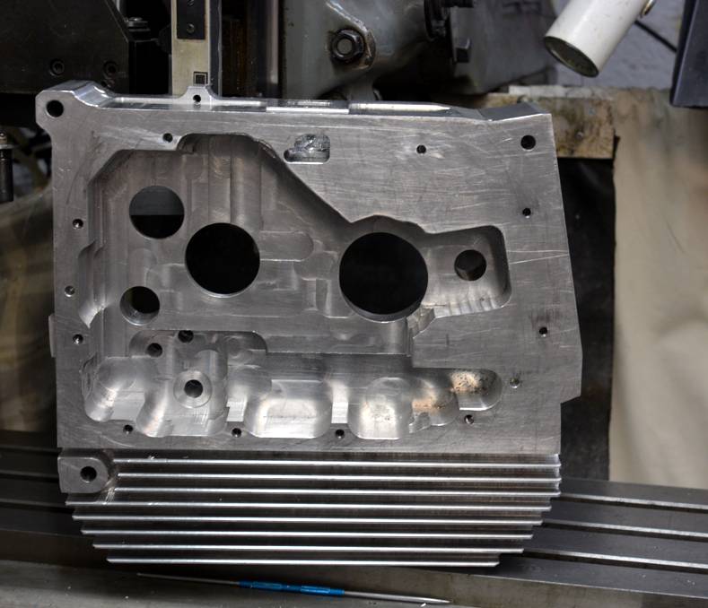

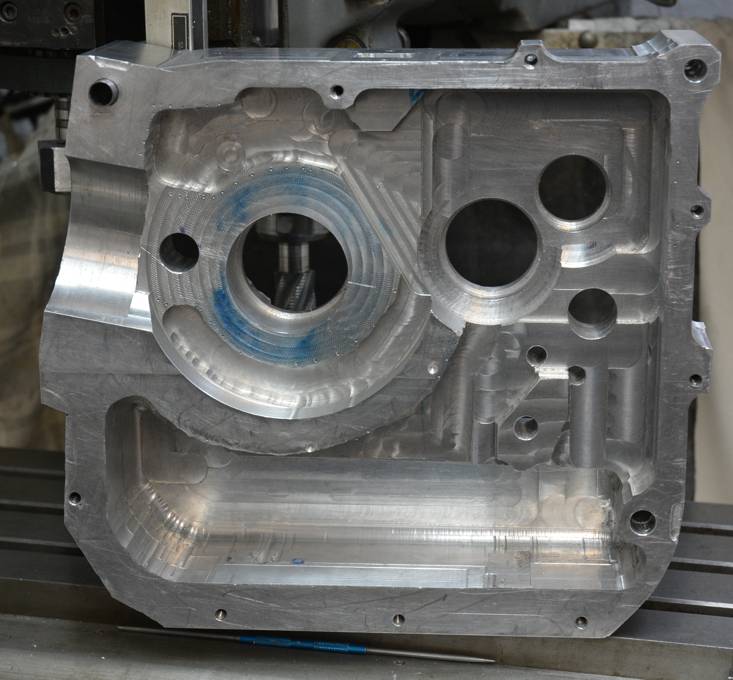

    The machining will be a mixture of manual and CNC. Most but not all roughing will be done manually. Finishing of the sections where the G-code can be written manually and those sections which lend themselves to using some G-code generation software that I have written will be done with CNC, the rest manually. I have no intention of spending the time to make CAD drawings in order to do 3D profiling of the undulating surfaces. Those sections will be redesigned to have fewer flat levels. The critical bearing bores will be made with a nice Narex boring head which I picked up a couple of years back.
    Alan

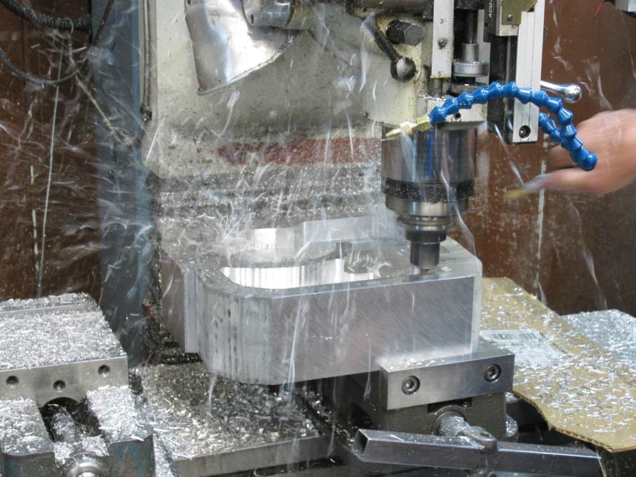

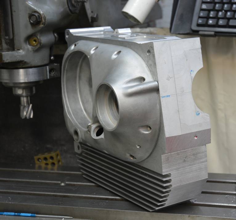

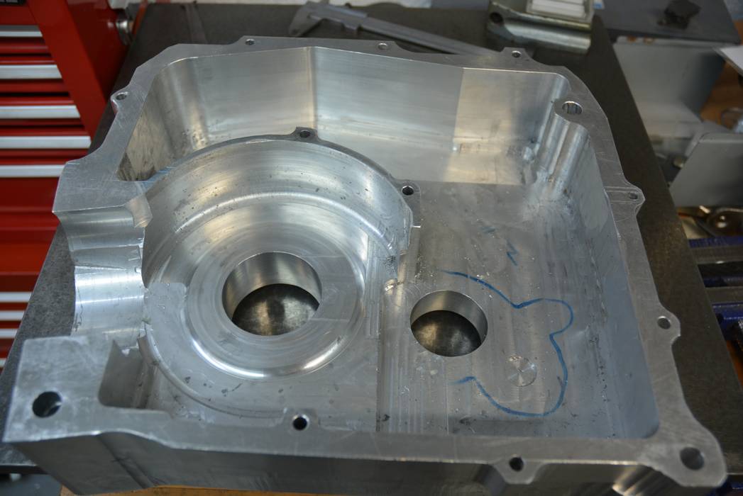

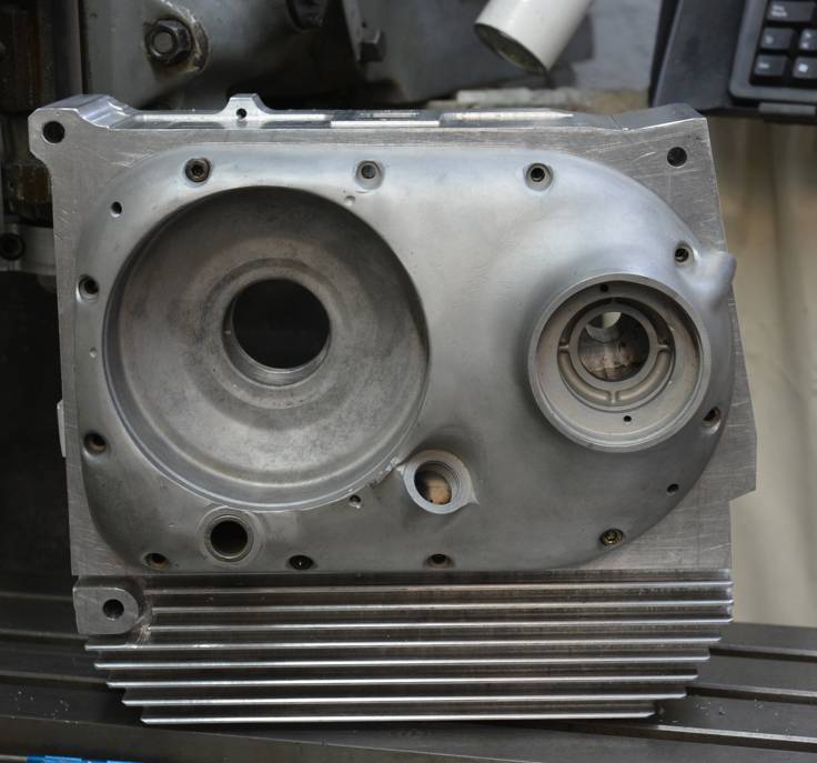

    here are a few pix. of progress to date as per your request. The original case halves weigh 4.1 and 4.2 kg. One of the new ones still weighs 8.5 kg and the other 10.5 kg so I still have a lot of swarf to make. I spent all morning machining and was most disappointed to have only removed another 1.2 kg.
    Height gauge addition.-dsc_0578a.jpg Height gauge addition.-dsc_0581a.jpg Click to see full size images
    RHS cases from inside and outside. This is the most complex half case.
    RHS with stock cover dowelled and bolted in place.
    Inside of LHS case. Simpler than the RHS.
