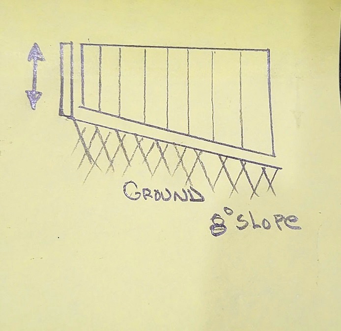

Thank you Buffalo John for your interest to help, n another words behind the gate it is not level it has an inclination of eight degrees. If you want to open the gate it will not open all the way these hinges are offset to give the inclination the gate needs from the inclination of the floor. i hope that I am making myself understandable.

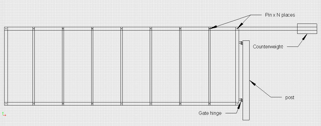

Here is a fairly simple gate design:
Attachment 42695

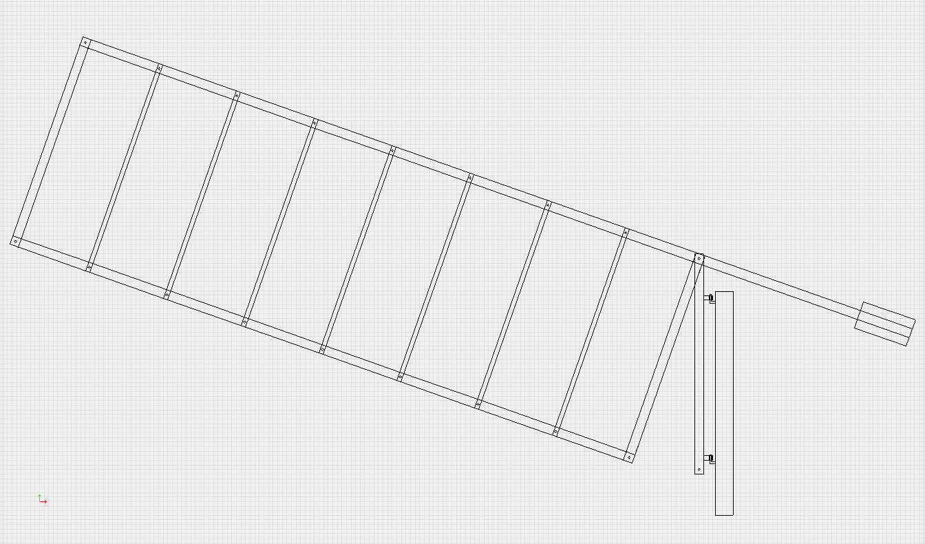

Then when you push down on the counterweight, it raises like this:
Attachment 42696
That angle is 7.5 degrees. There are pins to let the gate swing about the post. You can make the pins be parallel to the opening or at an angle if you want the gate to move more out of the way.
I did it as a 12' gate 4' high - just to get the perspective correct for the drawing.
The rest of the solution is left to the student...

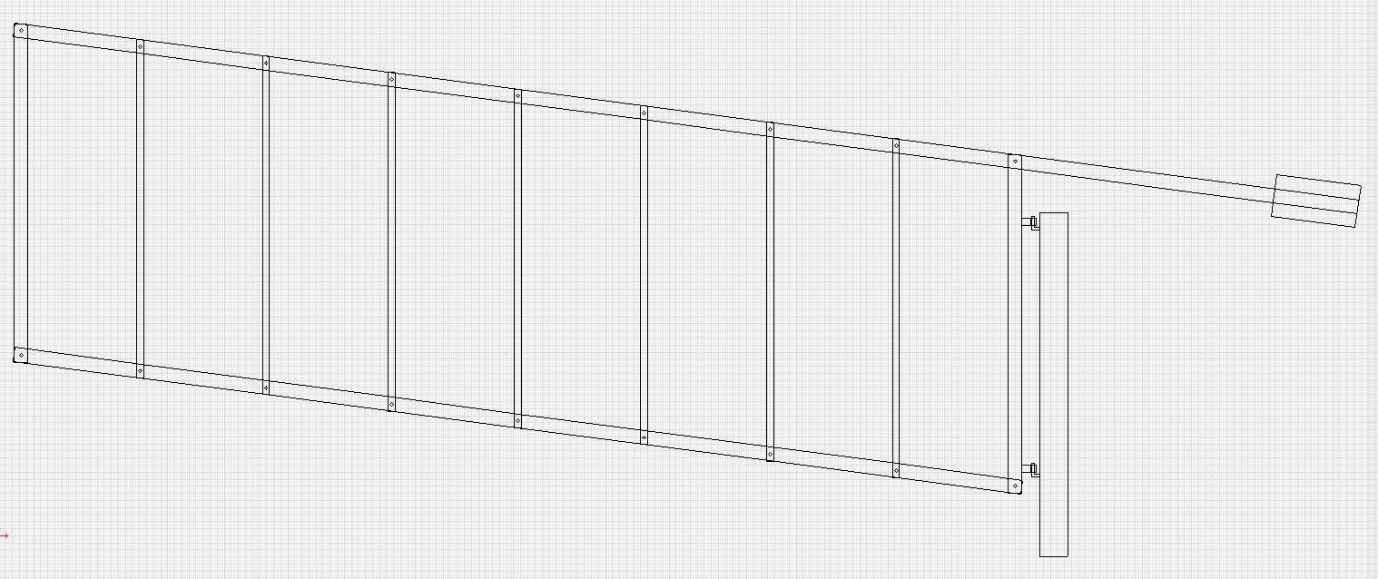

If you want the gate to be rigid so you can use wire mesh, you could do this:
Attachment 42697

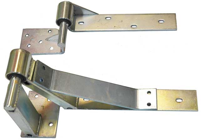

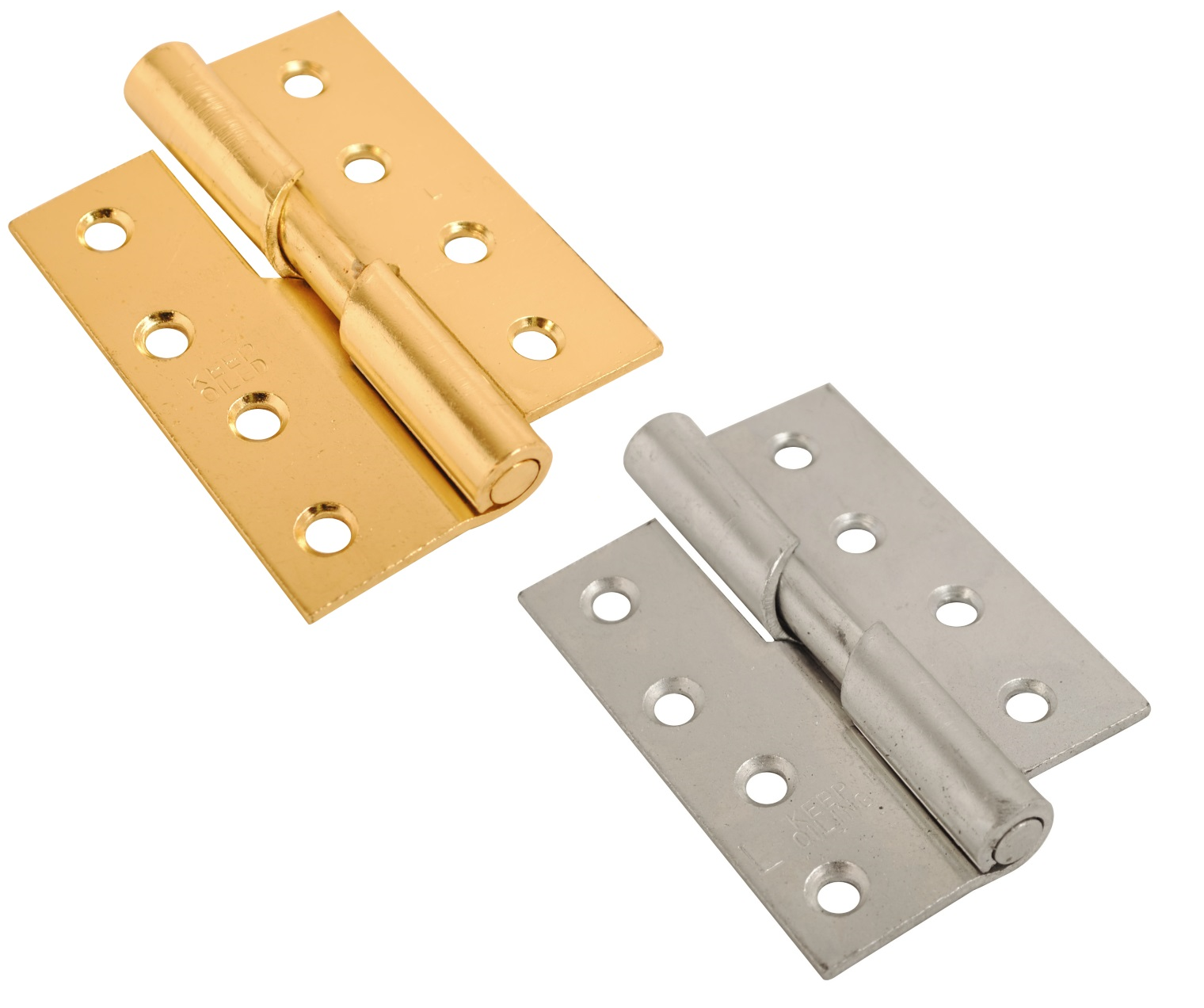

Edit: I found a couple of pics. The caming action I mentioned and offset pin idea posted by Baddog.
Attachment 42746Attachment 42745
Those hinges show 2 ways I've achieved that. The first style is only for small amounts of rise, and uses the ramp to encourage closing. But mainly it just allows the door to be closer to the ground when closed, and only works well when clean. More for a door than gate, certainly not a big gate. The one I did that on was a man gate, was much heavier than that, and only the bottom had the ramp.
The second is what I was talking about. But you have to offset the axis, not just the pins. Both pens remain on the single axis of rotation. The gate is a relatively rigid rectangle, so if you have the hinge axis kicked N degrees as shown, then when the gate is in line with the axis kick out, the bottom of the gate will have N angle to the ground.
