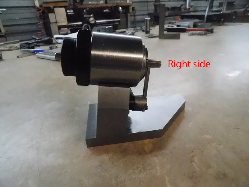

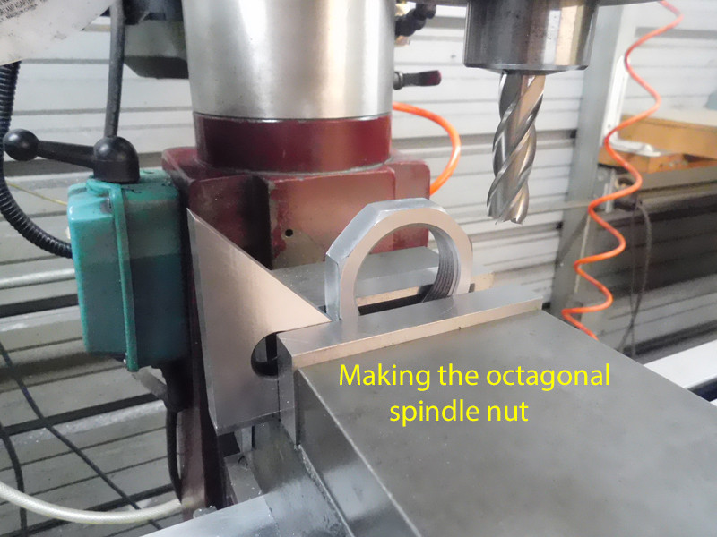

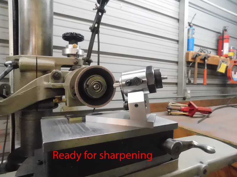

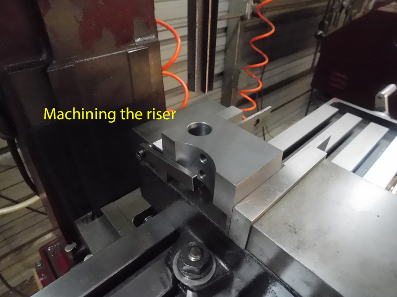

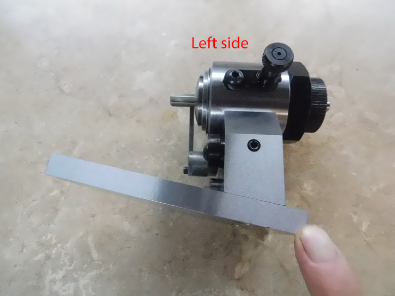

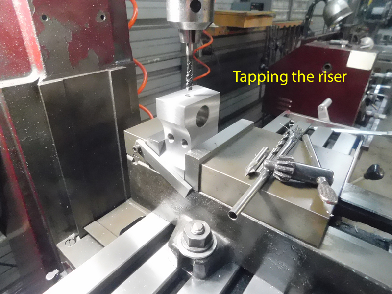

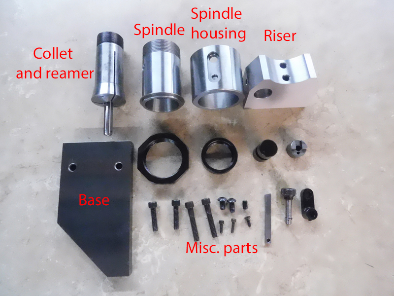

After completing the Countersink and Counter Bore Sharpening Fixtures made me think what other cutting tools I have that needs a special fixture for resharpening, after looking through all my fixtures the only other fixture I needed was one for sharpening chucking reamers, I came up with this design and built this tool I call a Reamer Sharpening Fixture, I now have fixtures to sharpen most any cutting tool I own except for taps, but taps aren’t that expensive and in my opinion aren’t worth the effort,
This tool was made from a variety of steels which includes 1018, 4140 Pre-Hard and O-1 Tool Steel, these steels were chosen for their particular application and durability, reamers from 1/8” to 1.125” can be resharpened, this fixture is not for sharpening the diameter of a reamer just the end cutting edges, this fixture was carefully and precisely made with precision ground surfaces, this tool looks and performs as well as intended.
I have included multiple photos of the machining processes of making this fixture along with a demonstration video showing the reamer setup and sharpening procedure.
As always thanks for looking and happy machining.
Doug
Attachment 25729 Attachment 25730 Attachment 25731
Attachment 25732 Attachment 25733 Attachment 25734
Attachment 25735
