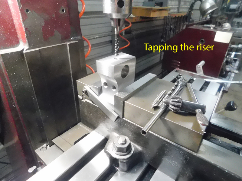

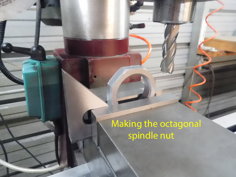

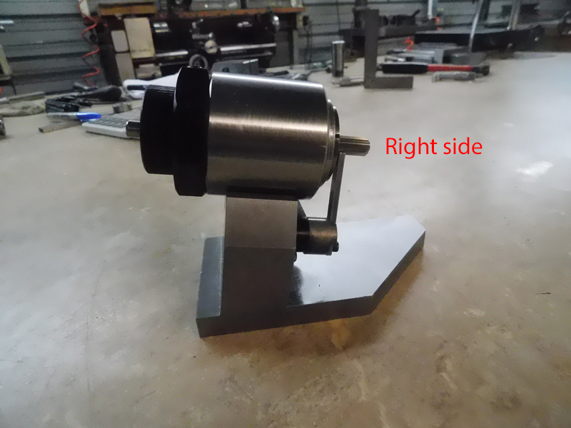

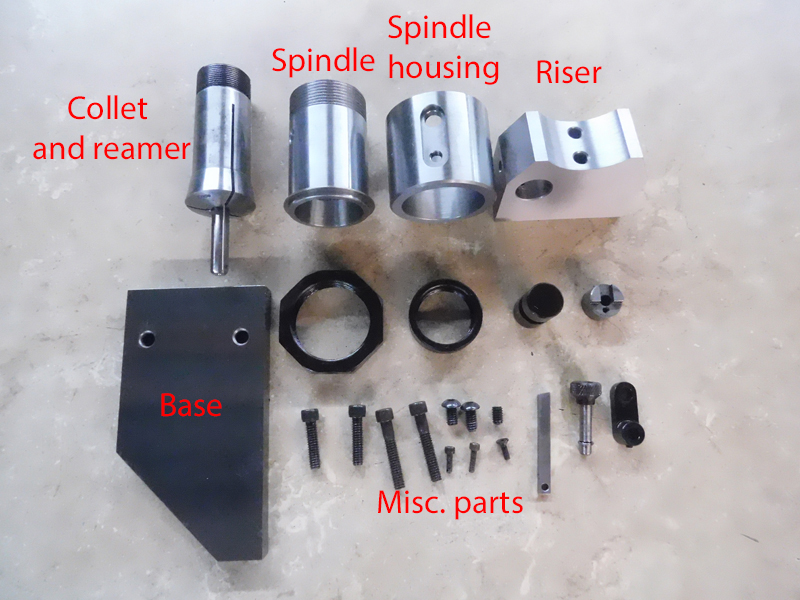

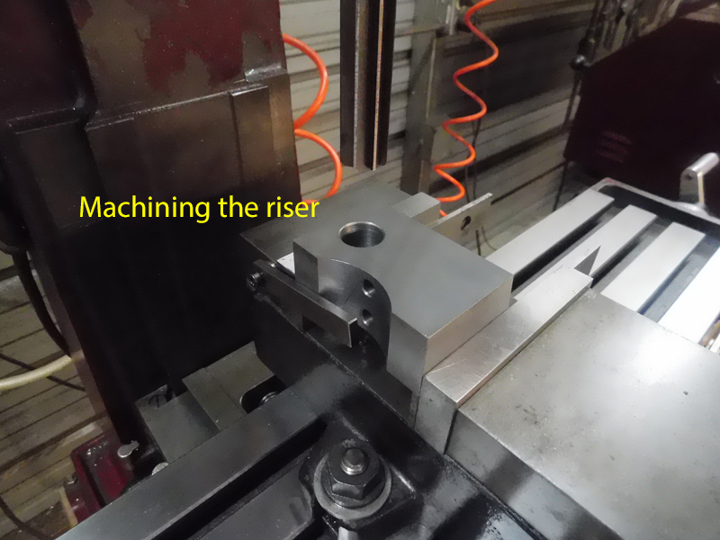

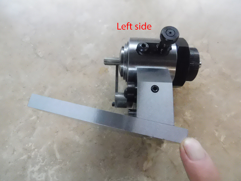

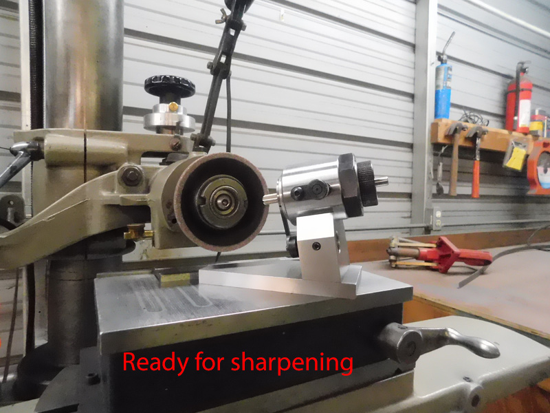

    After completing the Countersink and Counter Bore Sharpening Fixtures made me think what other cutting tools I have that needs a special fixture for resharpening, after looking through all my fixtures the only other fixture I needed was one for sharpening chucking reamers, I came up with this design and built this tool I call a Reamer Sharpening Fixture, I now have fixtures to sharpen most any cutting tool I own except for taps, but taps aren’t that expensive and in my opinion aren’t worth the effort,
    This tool was made from a variety of steels which includes 1018, 4140 Pre-Hard and O-1 Tool Steel, these steels were chosen for their particular application and durability, reamers from 1/8” to 1.125” can be resharpened, this fixture is not for sharpening the diameter of a reamer just the end cutting edges, this fixture was carefully and precisely made with precision ground surfaces, this tool looks and performs as well as intended.
    I have included multiple photos of the machining processes of making this fixture along with a demonstration video showing the reamer setup and sharpening procedure.
    As always thanks for looking and happy machining.
    Doug

    I'm running out of superlatives Doug, but it is beautiful and works like a charm. That fit on the pin was @¿@...nice, to say the least. Kind of a dedicated spindexer but the the no-lash nylon washer and gravity latch are excellent touches.
    I'm not however running out of questions. ~~ Always been curious as to the price of reamers, (expensive in my book) is it worth sharpening the flute to an undersized dimension?? I get that the cutting is done at the entry and the flutes act more as a hone, but have seen used ones with seriously worn or dinked flutes in flea markets and garage sales, and wondered if concentricity becomes an issue on a deeper ream due to the wear? Or maybe runout in the drive spindle causing it?
    Always thankful for your posts!!

    rossbotics,
    Nice fixture. Is that a shot pin on the left side for locating radial position?
    Dick

    As always thanks PJs
    Good quality reamers are a little pricey, the cost also reflects on the size of the reamer, the larger the more $ and so on, reamers are only sharpened on the end of the flutes, the entry, the most common cause of a reamer making an oversize hole is concentricity of the sharpening process, if one of the flutes is say .001" longer than the others then you have a wobble in the reamer as its cutting creating an oversize hole, its important to grind all the flutes a couple of times around or until you have no spark.

    Thanks Dick
    You are absolutely right
    Doug

    rossbotics,
    Thanks, I thought it might be.

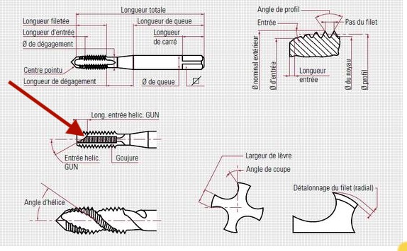

    Looking at your system, when you're speaking about taps, with this technology you can correct the entrance angle of the cutting part which is often damaged by carbon crystals or dirt for example.
