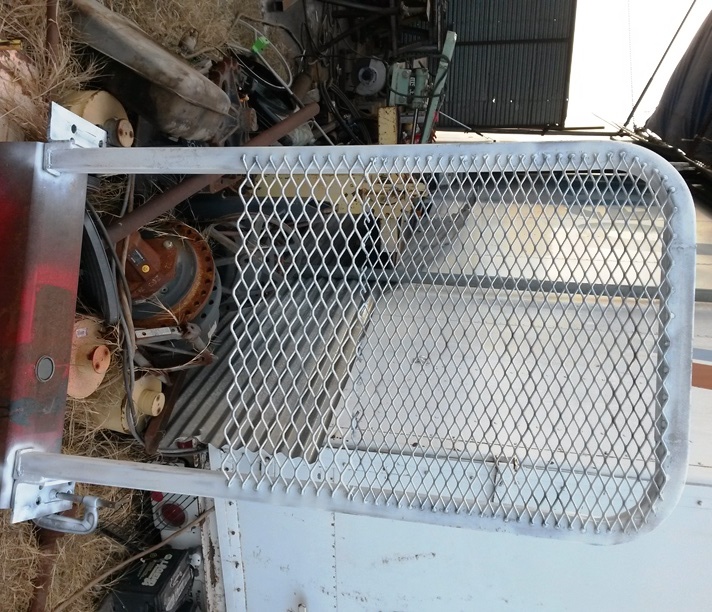

Rear brush guard for 8N ford
My little 8n is primarily used for mowing brush. The bad thing about brush hogs is they can throw it at you even if you have the front chain type guards in place My brush hog has no such front guards. So I decided to do one better forget about the mower place a guard on the tractor
I made it out of 2" sq tubing 3/16 wall thickness and expanded metal the tubing is part an old rollover protection bar modified to fit
It will mount in the same holes cast in the axle housing as the fenders mount on
Attachment 20968
