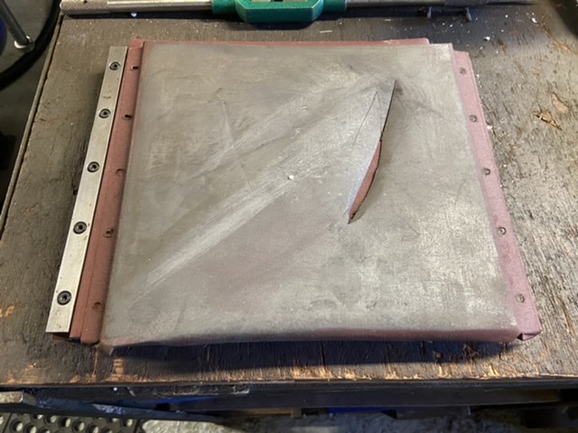

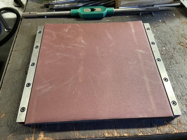

Here are some photos of the find, and how I cleaned the stock faces up on a home made lapping plate which holds an emery cloth taught on a flat steel plate. The 1” linisher is used to de-burr the sawn ends and the lapping plate removes any dings and dents that might be present on the bar. I do this even to new stock material as you can’t guarantee the bar has not been damaged from the stockist and I dont want to transfer the dents from the material on to the machine vice or machine table.

Attachment 21797 Home made lapping plate
Attachment 21798 Required material cut and de-burred ready to used and the remaining offcuts
