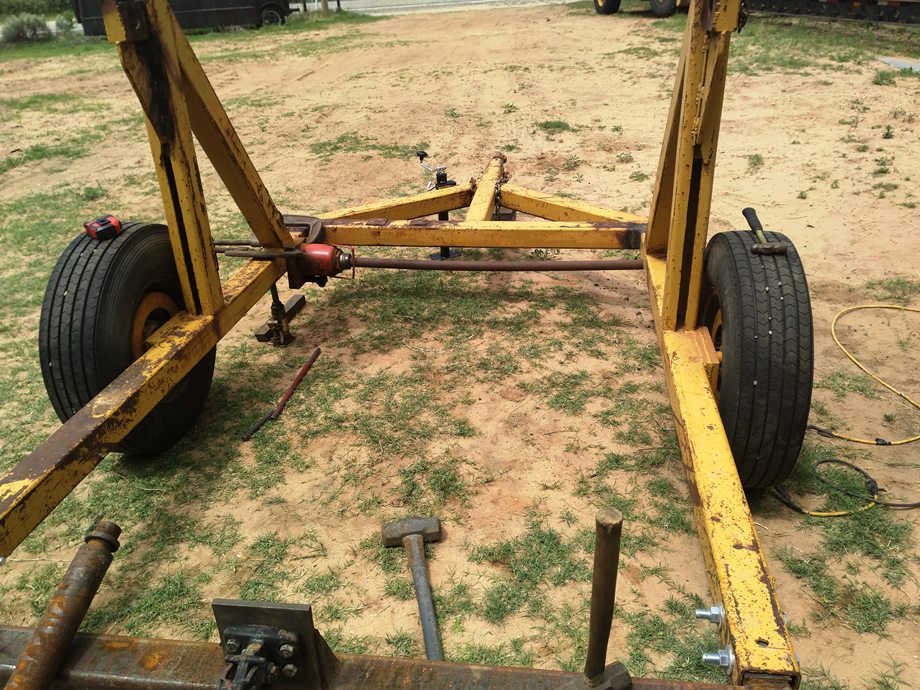

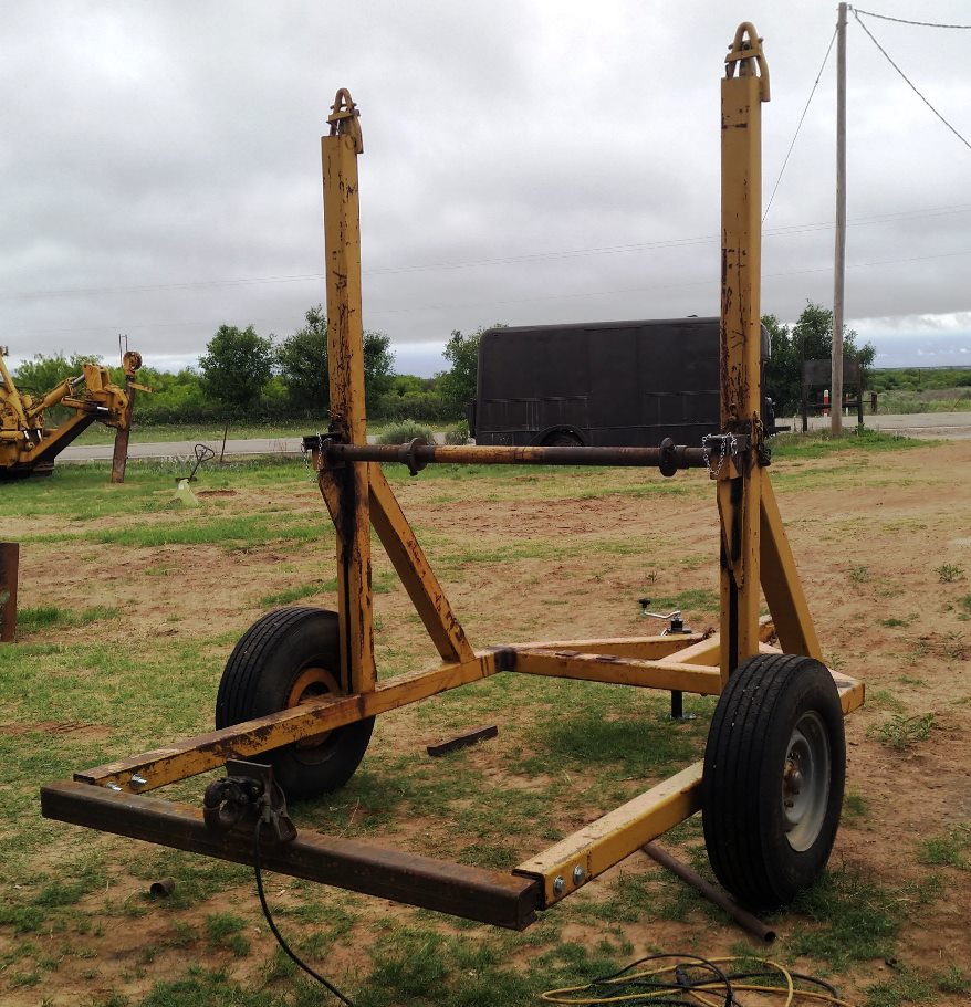

This reel trailer hadn't been used in years and needed some repairs.
The frame needed spread this was done with a 50 ton jack a long steel bar and some heat.
Attachment 49234

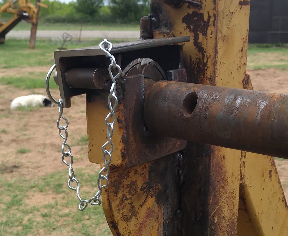

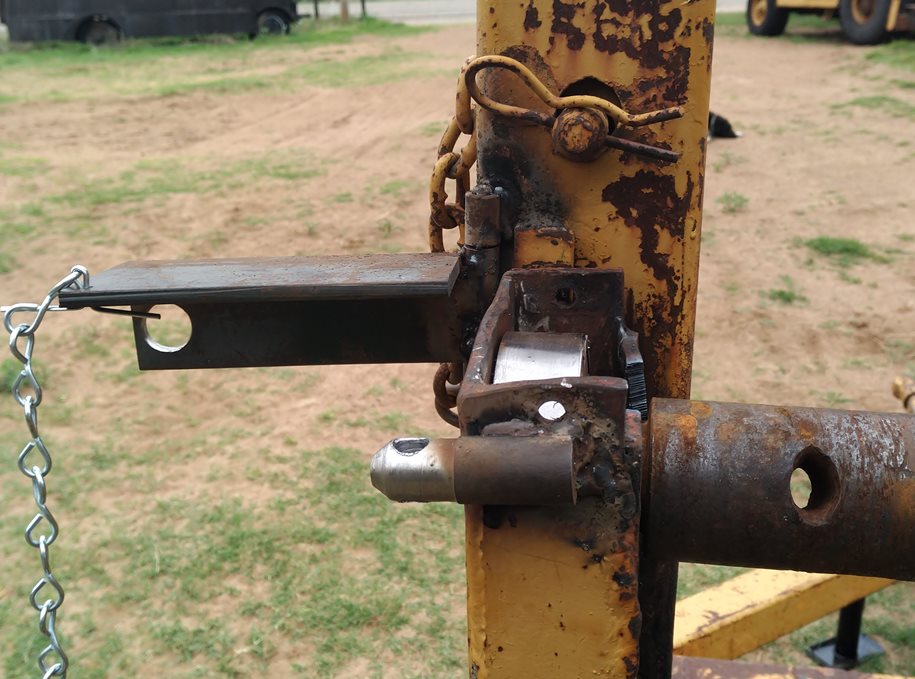

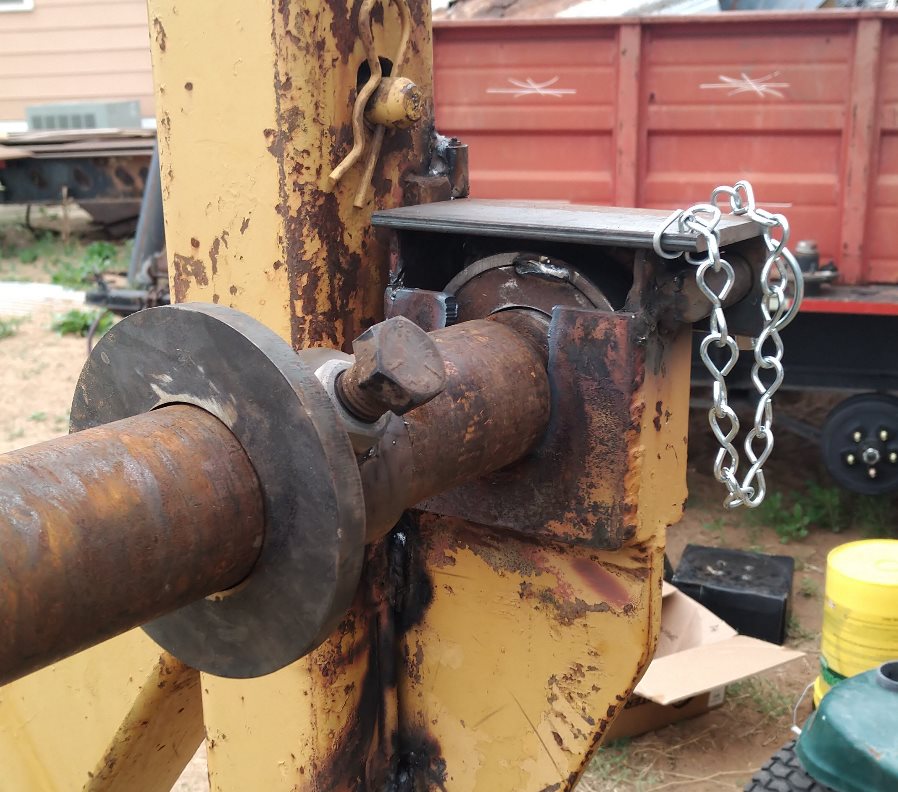

Then I added hold downs for the reel shaft
Attachment 49235
Attachment 49236
Attachment 49237
Attachment 49238
