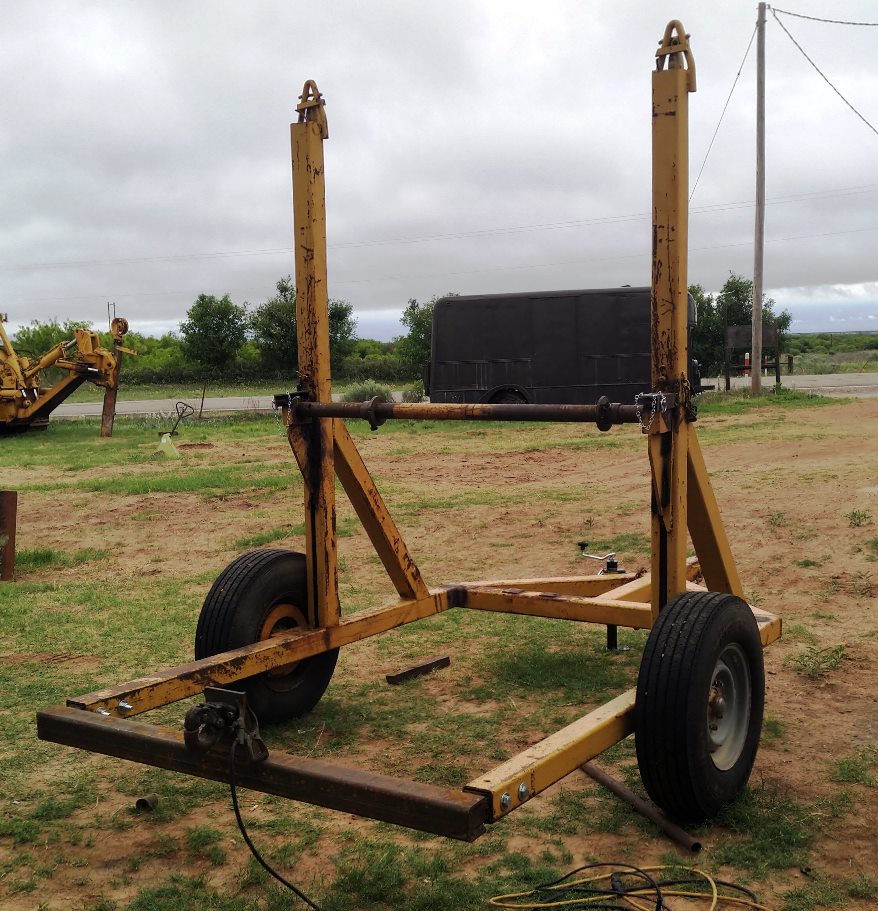

    This reel trailer hadn't been used in years and needed some repairs.

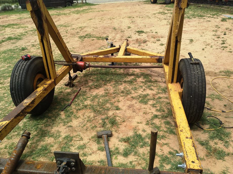

    The frame needed spread this was done with a 50 ton jack a long steel bar and some heat.

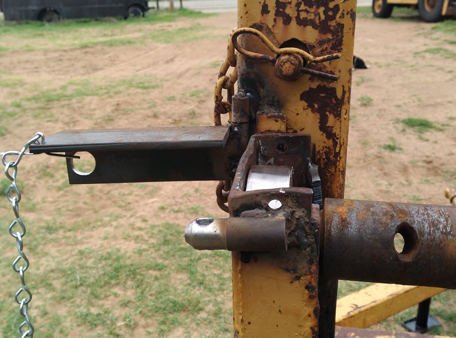

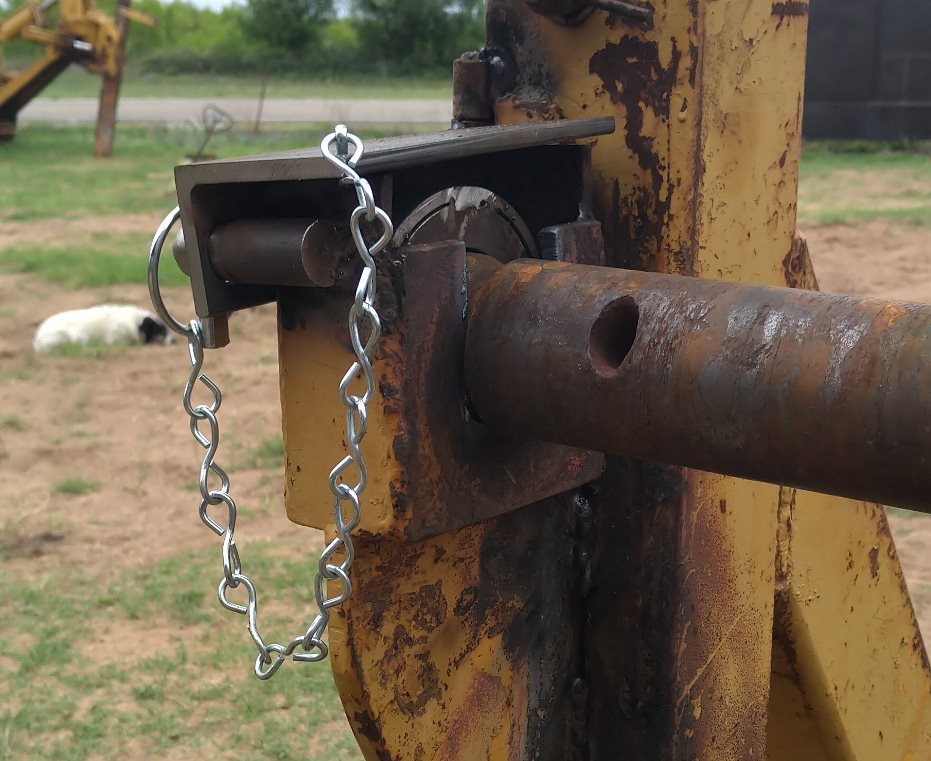

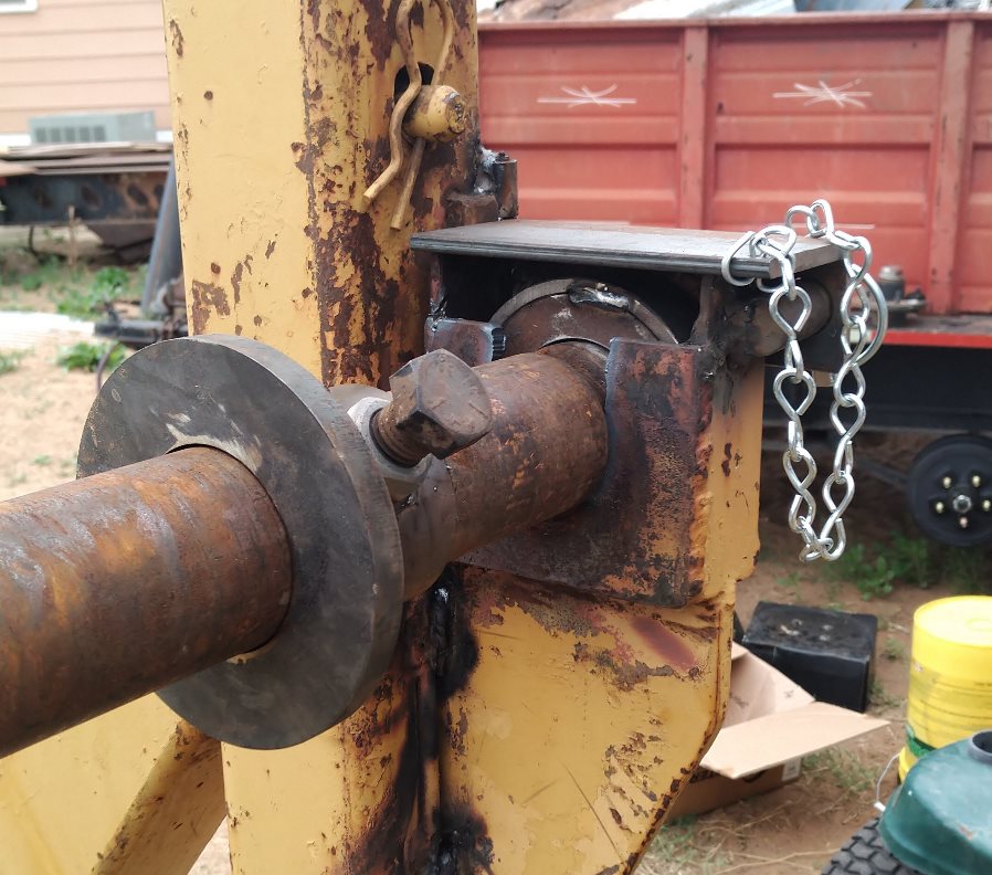

    Then I added hold downs for the reel shaft
