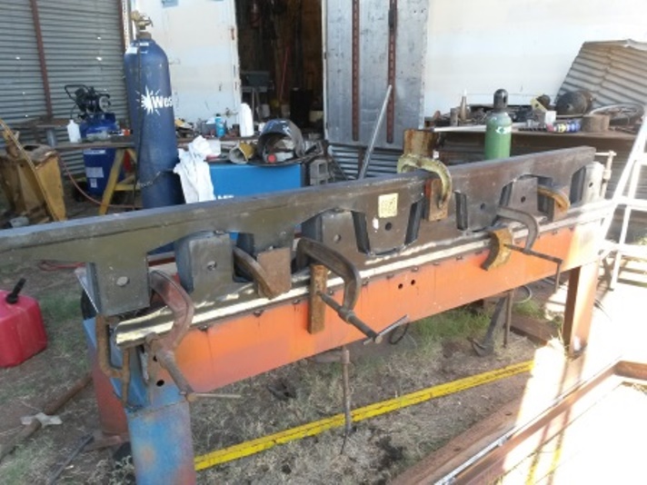

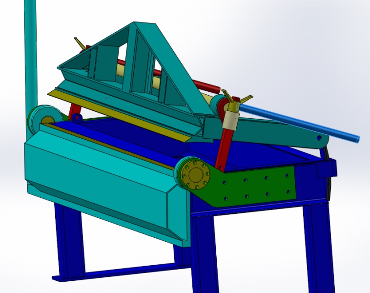

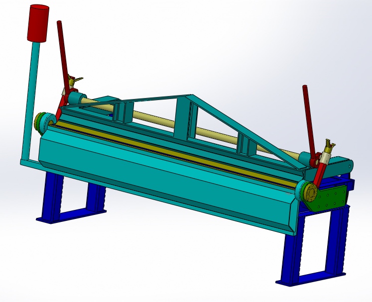

remake of my 7 ft folding break

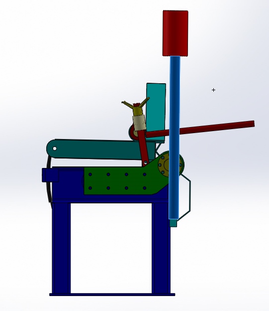

this is not a new tool but it will hardly resemble the itself.

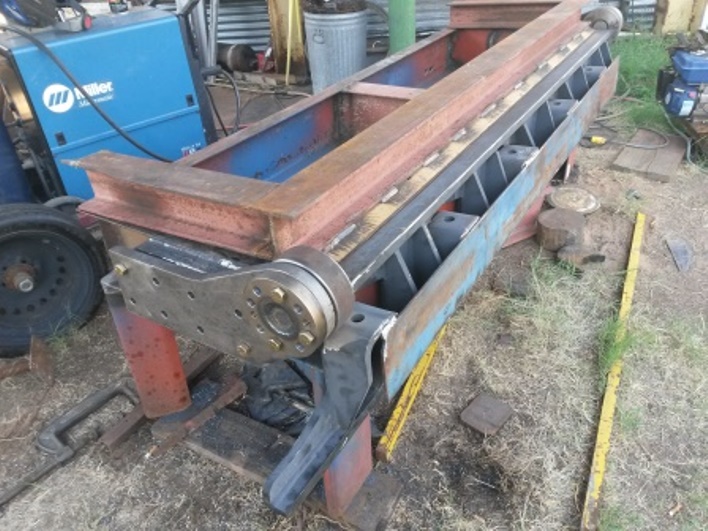

I made this about 3 years ago to do 1 little job then after finishing the job it got put on the back burner for completion
http://www.homemadetools.net/forum/7...0277#post57046

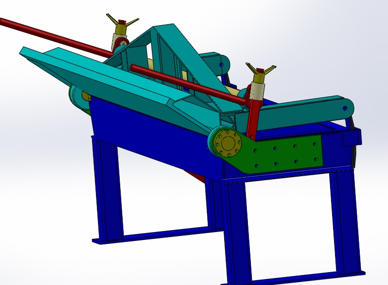

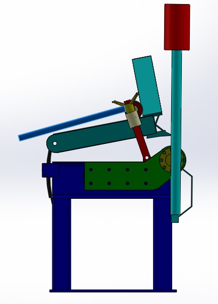

So for the past month I have been time allowing making tools and parts to finish it up I still might not get it completed as much as I want but at least it is now far enough along to be considered work in progress plus it is right in my way which makes me more inclined to do some work on it .
Attachment 19398

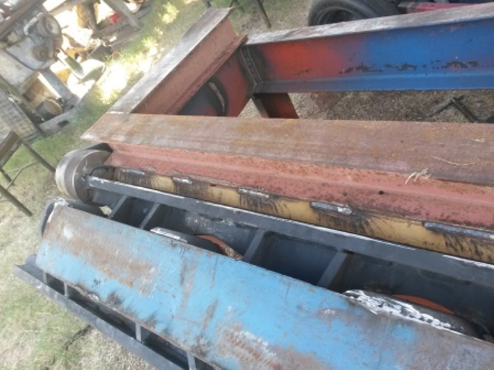

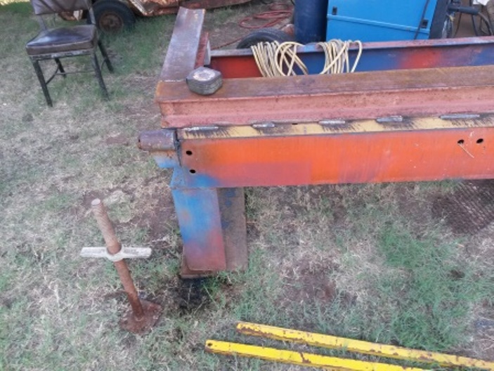

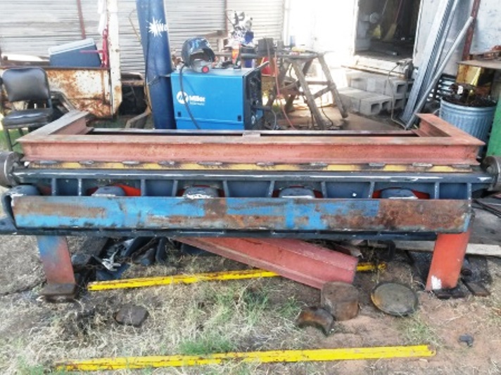

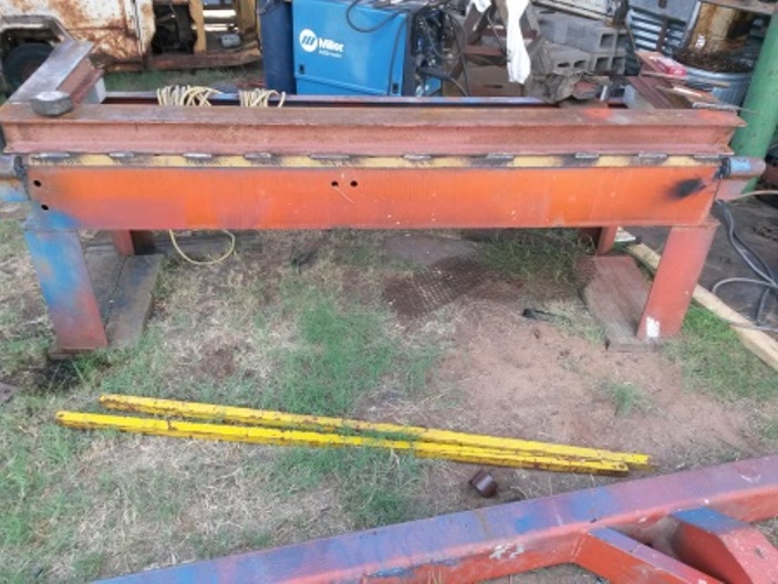

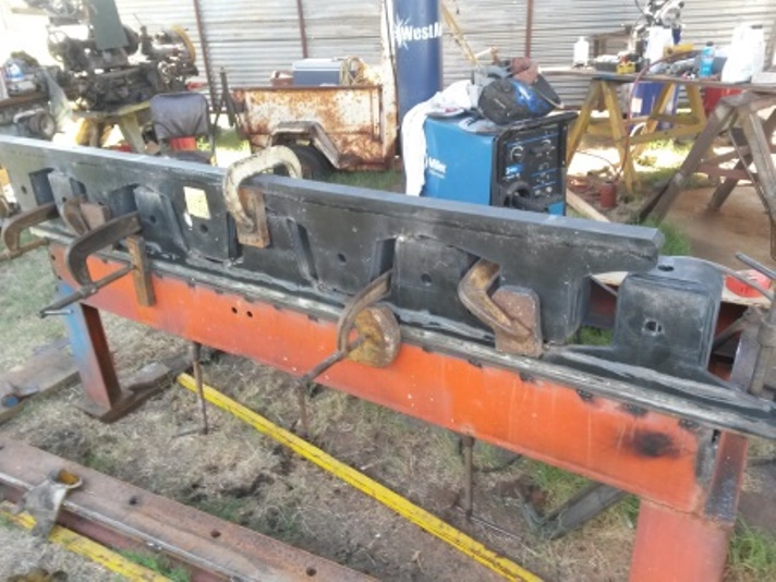

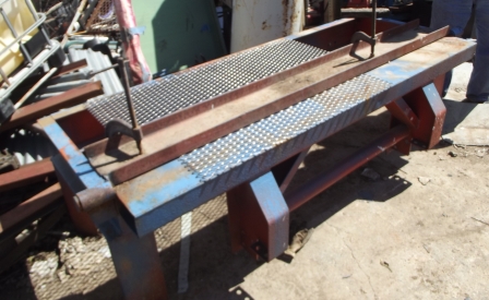

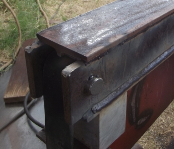

As you can see it was about as rudimentary of a metal break as possible

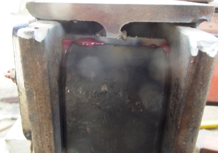

So first things first the gate or swing beam had to go and a top clamp was needed

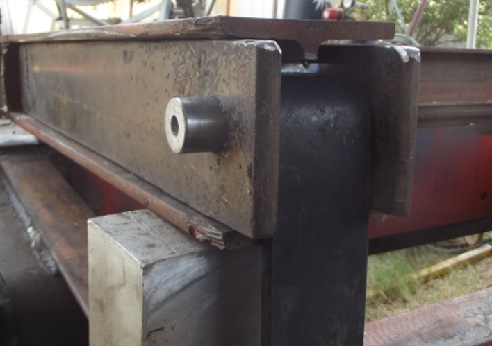

Attachment 19399
Attachment 19400

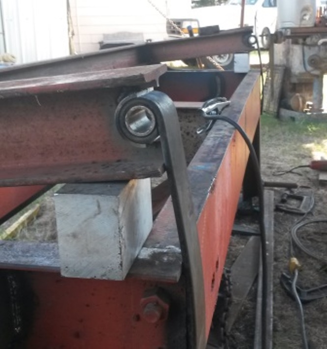

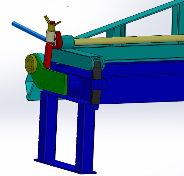

then a new gate had to be made
Attachment 19401
Attachment 19402

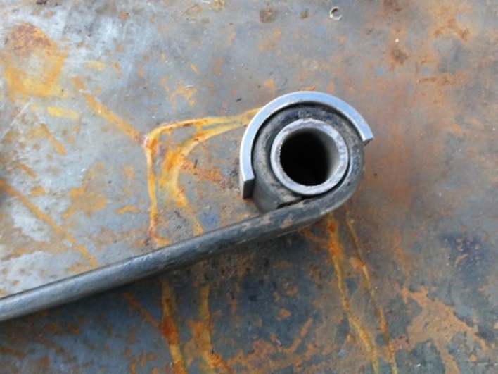

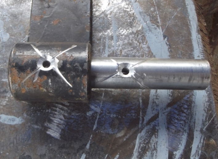

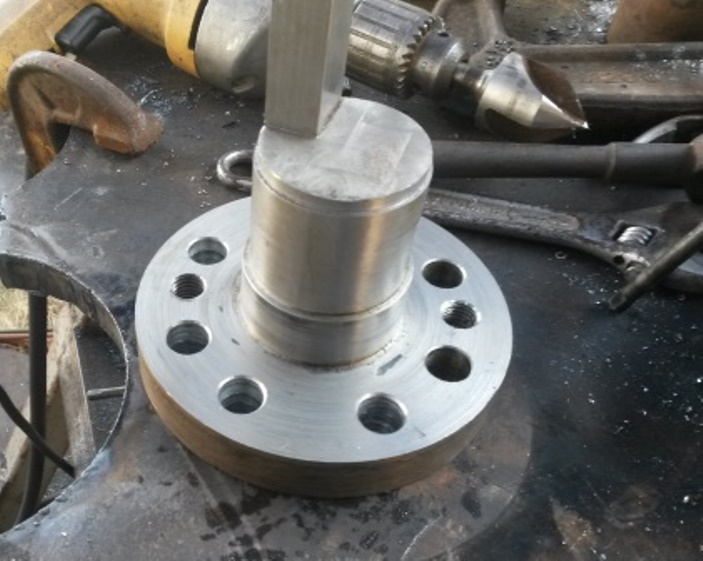

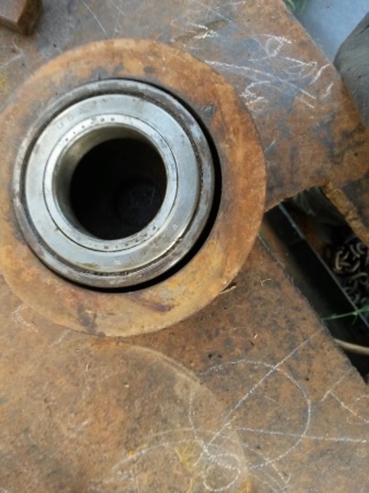

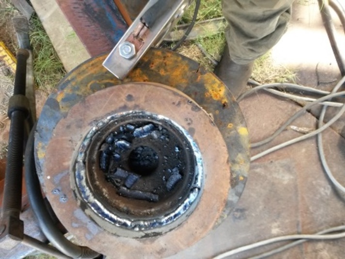

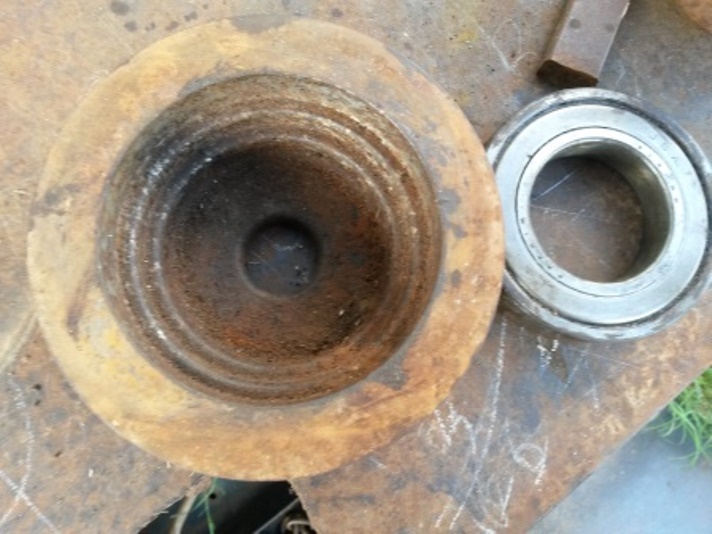

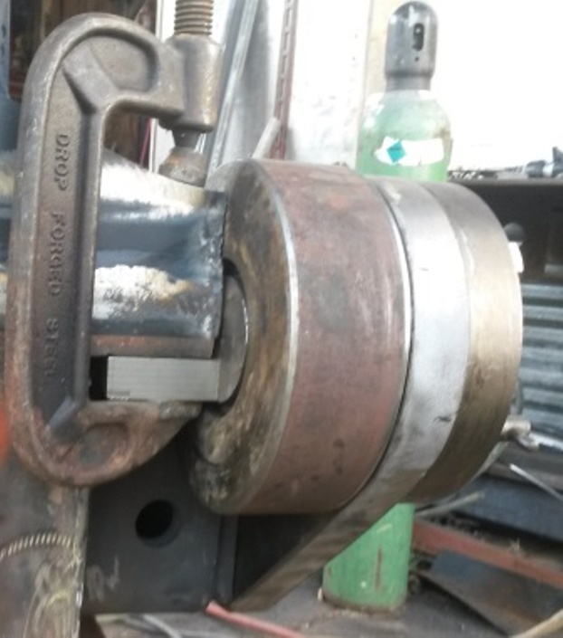

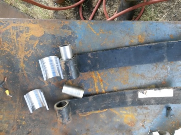

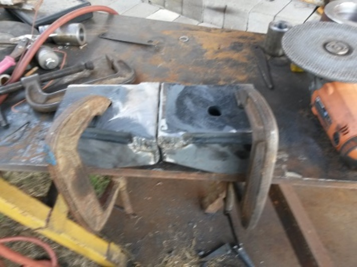

next the parts for the pivot. I have a large stack of these I think they were once used as casting molds that a guy used to make small train wheels
the bore was too large for my 6212 bearings so I welded them up then machined them out to the depth of 2 bearings
Attachment 19403
Attachment 19404
Attachment 19405
Attachment 19406

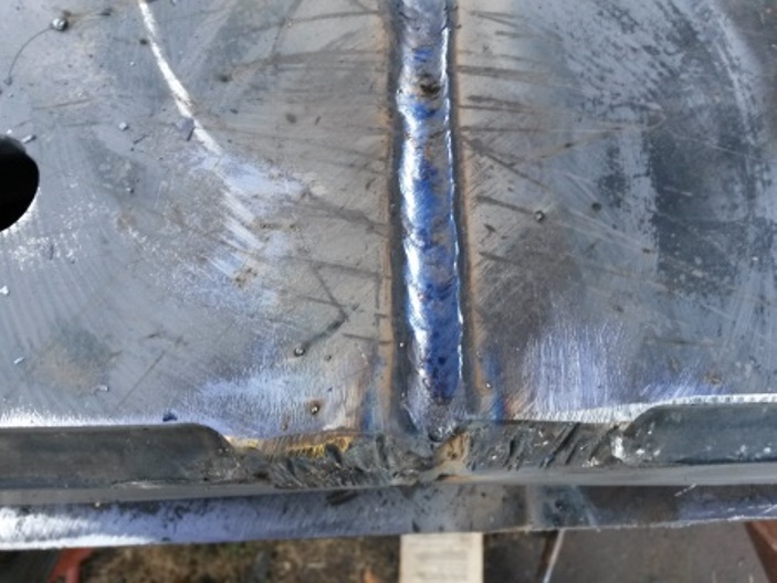

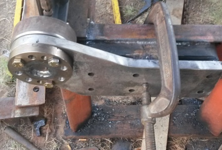

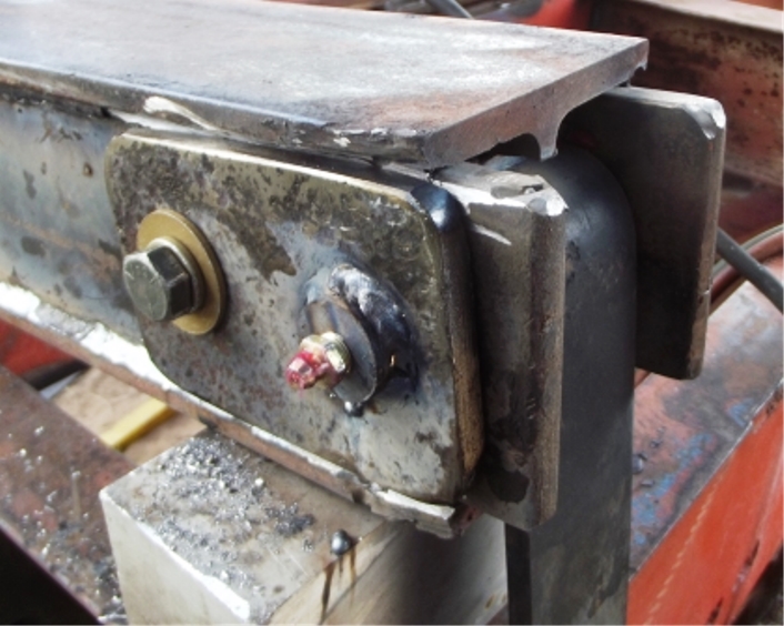

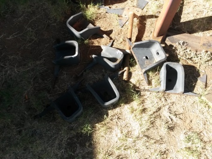

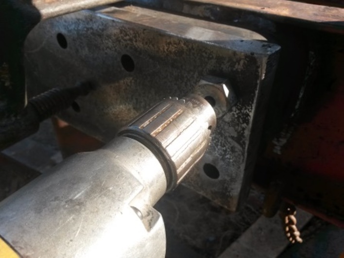

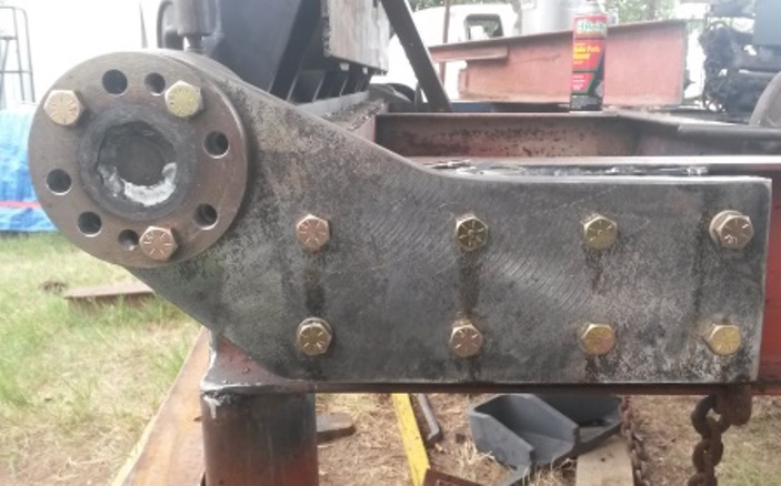

Some left over cut offs from the Forklift carriage will become the mount base which the gate pivot mounts will bolt to
Attachment 19407
Attachment 19408

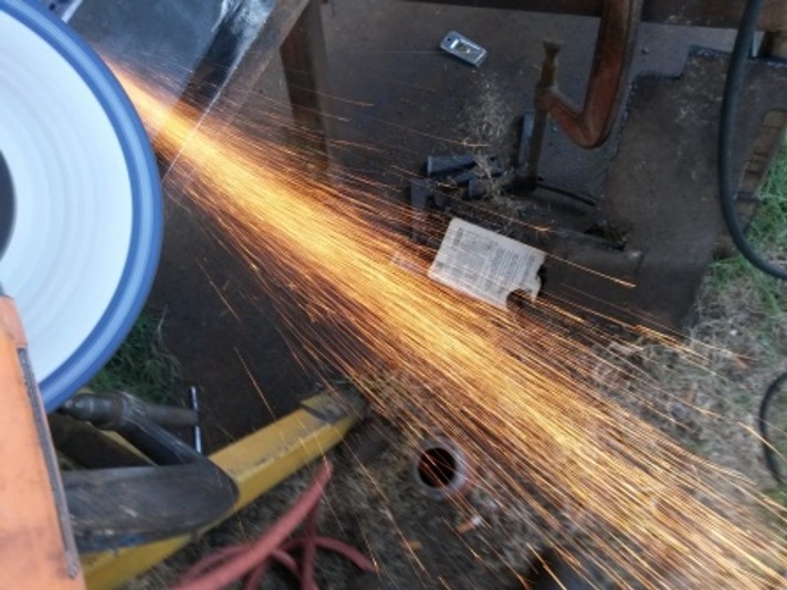

you can see how tough Caterpillar metal is by the sparks at least 120,000 PSI tensile
Attachment 19409
