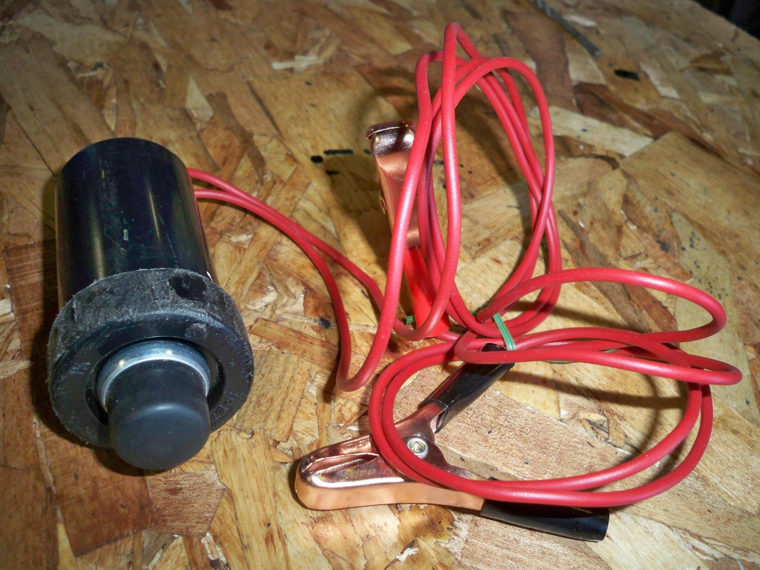

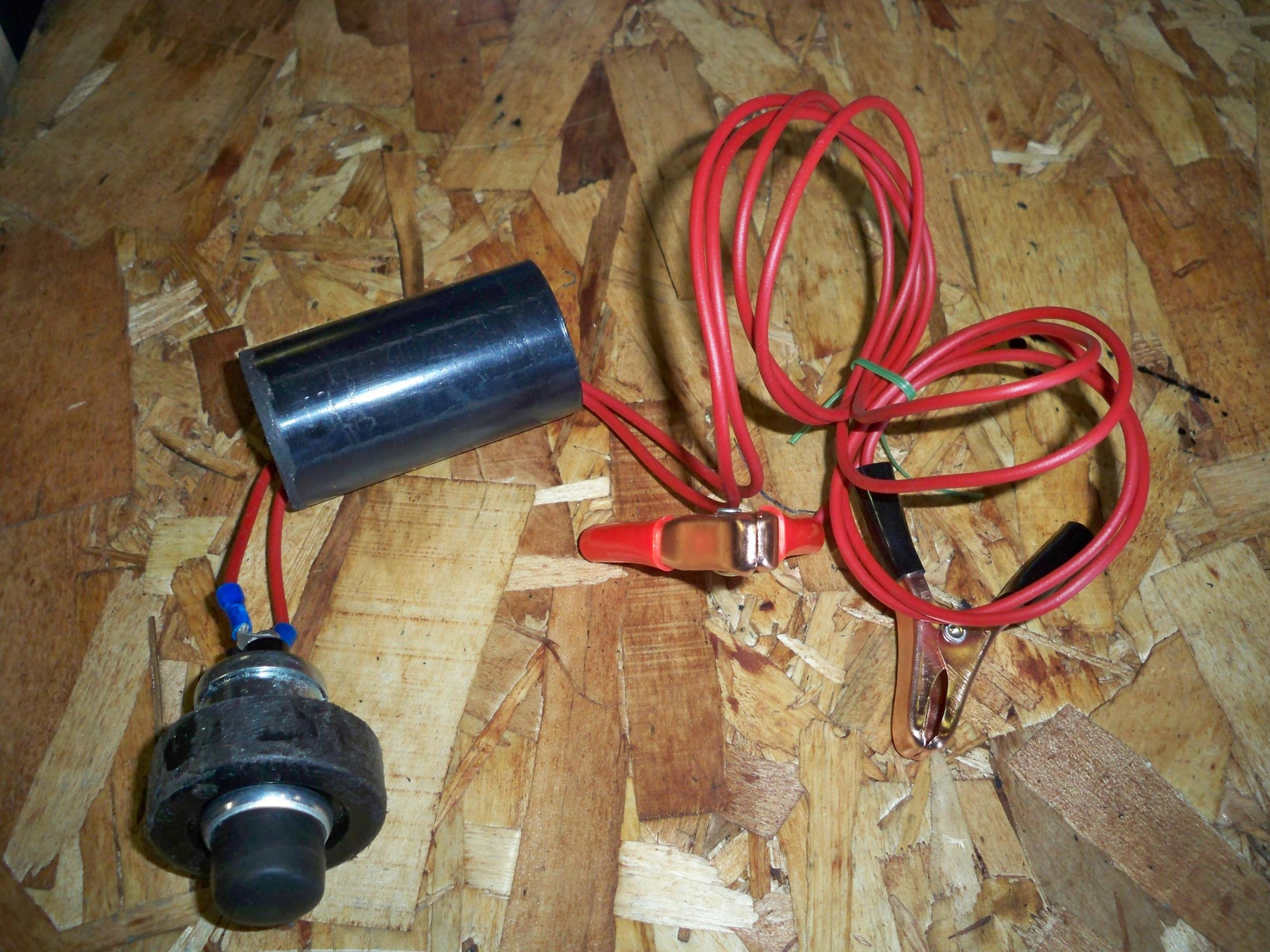

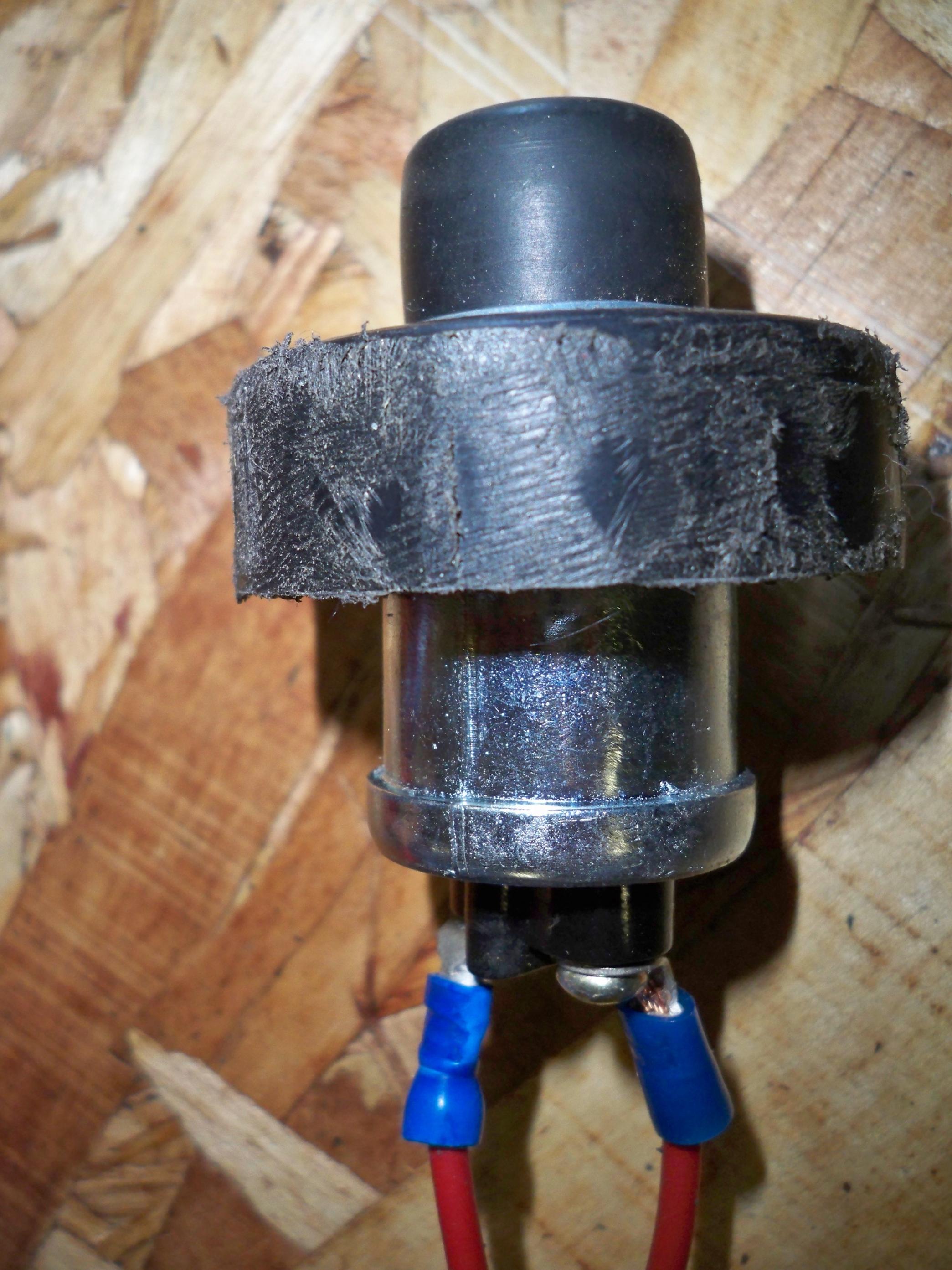

Attachment 17604Attachment 17605Attachment 17606[LEFT] Two alligator clips, a few feet of 12Gauge automotive wire,a $6.00 momentary push button, a short piece of 1 1/4 ABS plastic plumbing pipe and a 1 1/4 ABS pipe cap. Assemble as pictured and handy for starting or turning an engine over from where you are working under the bonnet. Also usable for making a circuit ,checking power etc. Cheaper than purchasing one already made.
