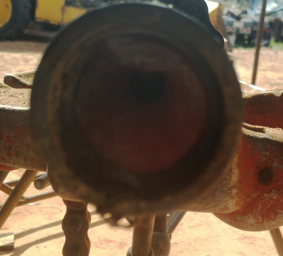

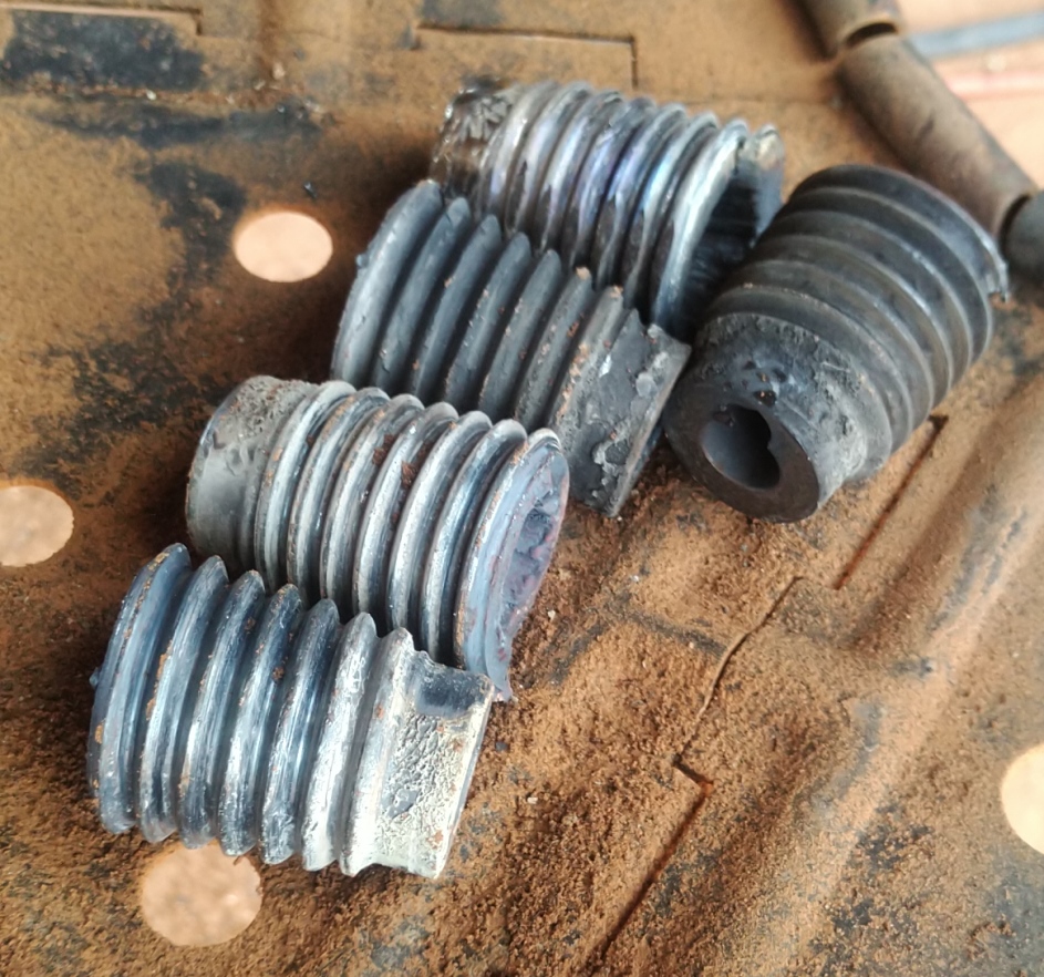

    A little over an hour later this is what I had.
    These are the treads from broken drill bits they are tightened up initially with a hydraulic tong then the boring process makes them tighter and tighter until the torque is too much for the thread

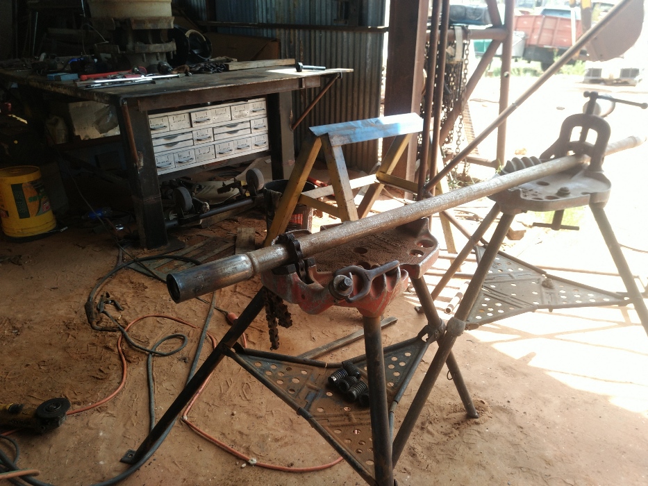

    I started out clamping the drill stems in my pipe vises

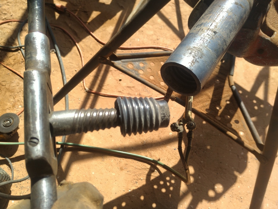

    Then burned out the center of the dutchmen's
    the core is still read

    Once cooled the #7 extractor had no problem removing them
