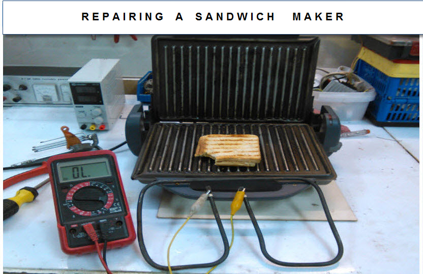

    REPAIRING A SANDWICH MAKER

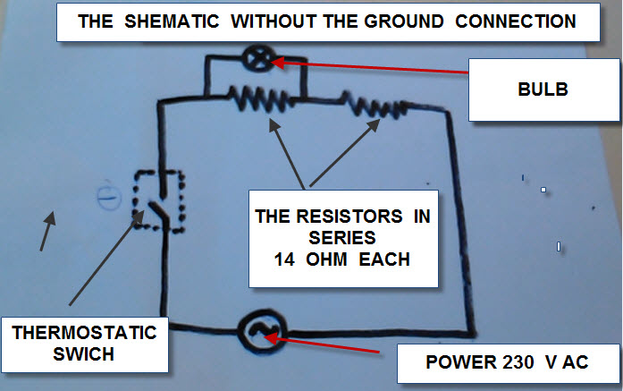

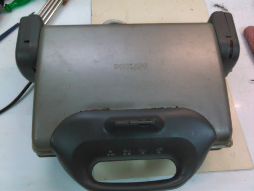

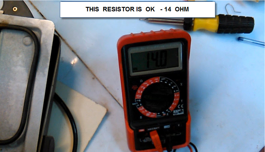

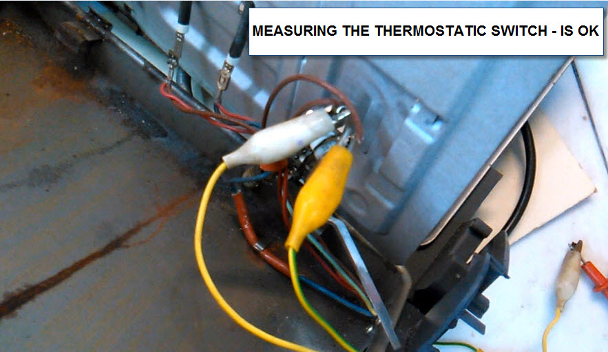

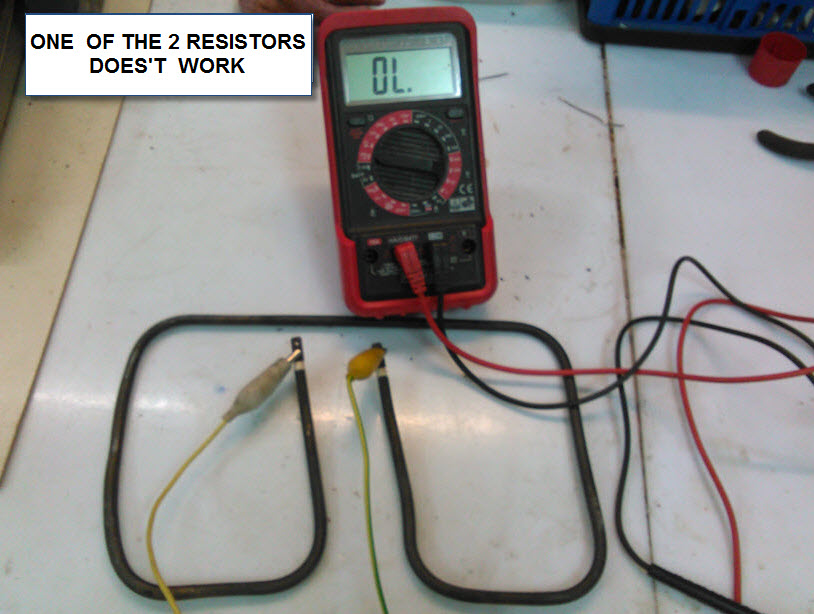

    It is very easy to repair a sandwich maker at home by measuring all the stuff inside. We have to measure the thermostatic switch and the 2 resistors that are connected in series . Her the power is 220-230 v and every resistor is 110 v - 900 v - 13.5 Ohm. I had to replace one of the 2 resistors. The coast was 7 E. You can watch all the repairing here:
