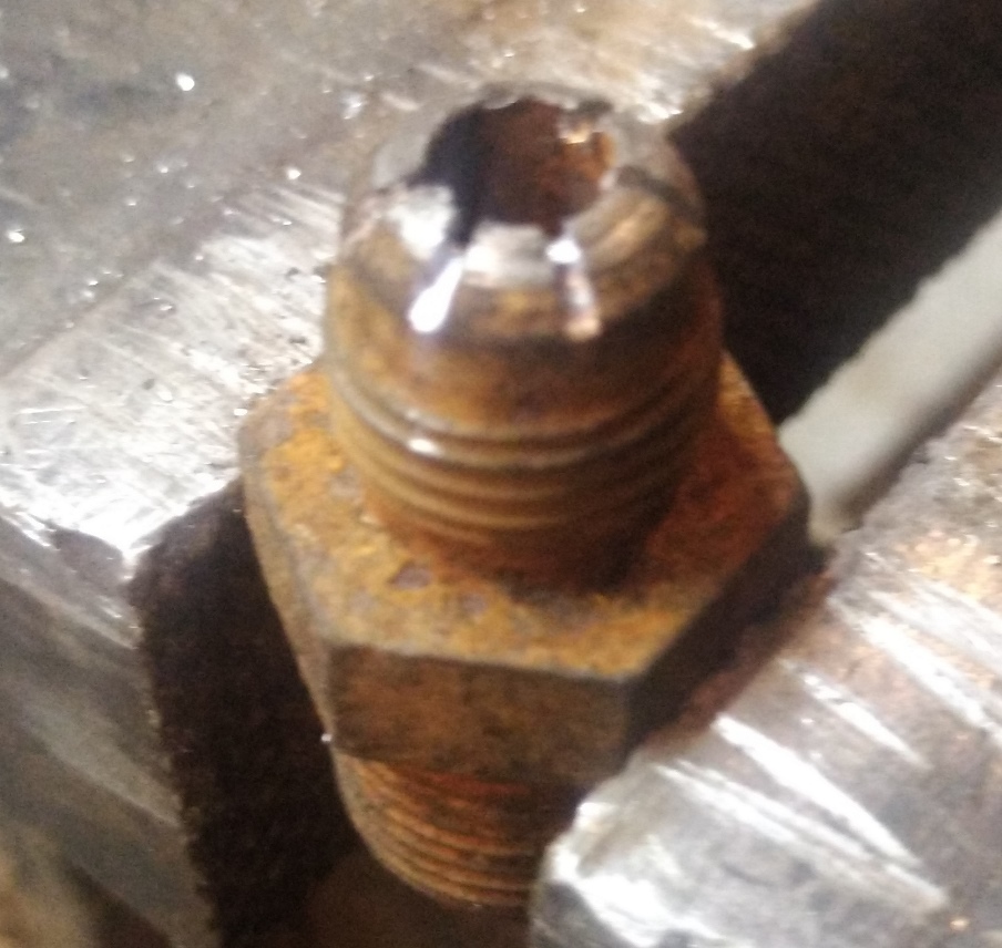

In needing to do some testing I noticed my new fitting to make up the test kit was back ordered. leaving me no choice but to dig through some scrap fittings and hopefully find a suitable temporary substitute
the only one I could find should have been included in the last load of scrap iron but I just needed to make it work a couple of times
To do this I took another equally scrap fitting and cut a few slots in the seating area to use it as a reseating tool
Attachment 41851

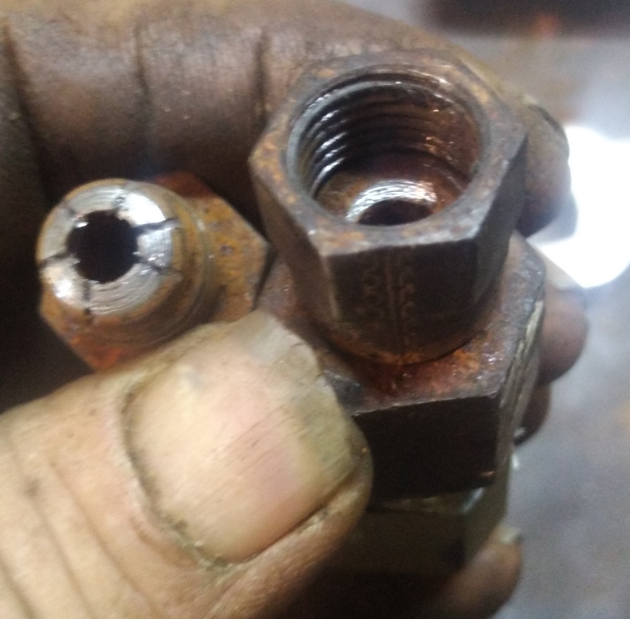

A little more cleaning and I can make this work
Attachment 41852
