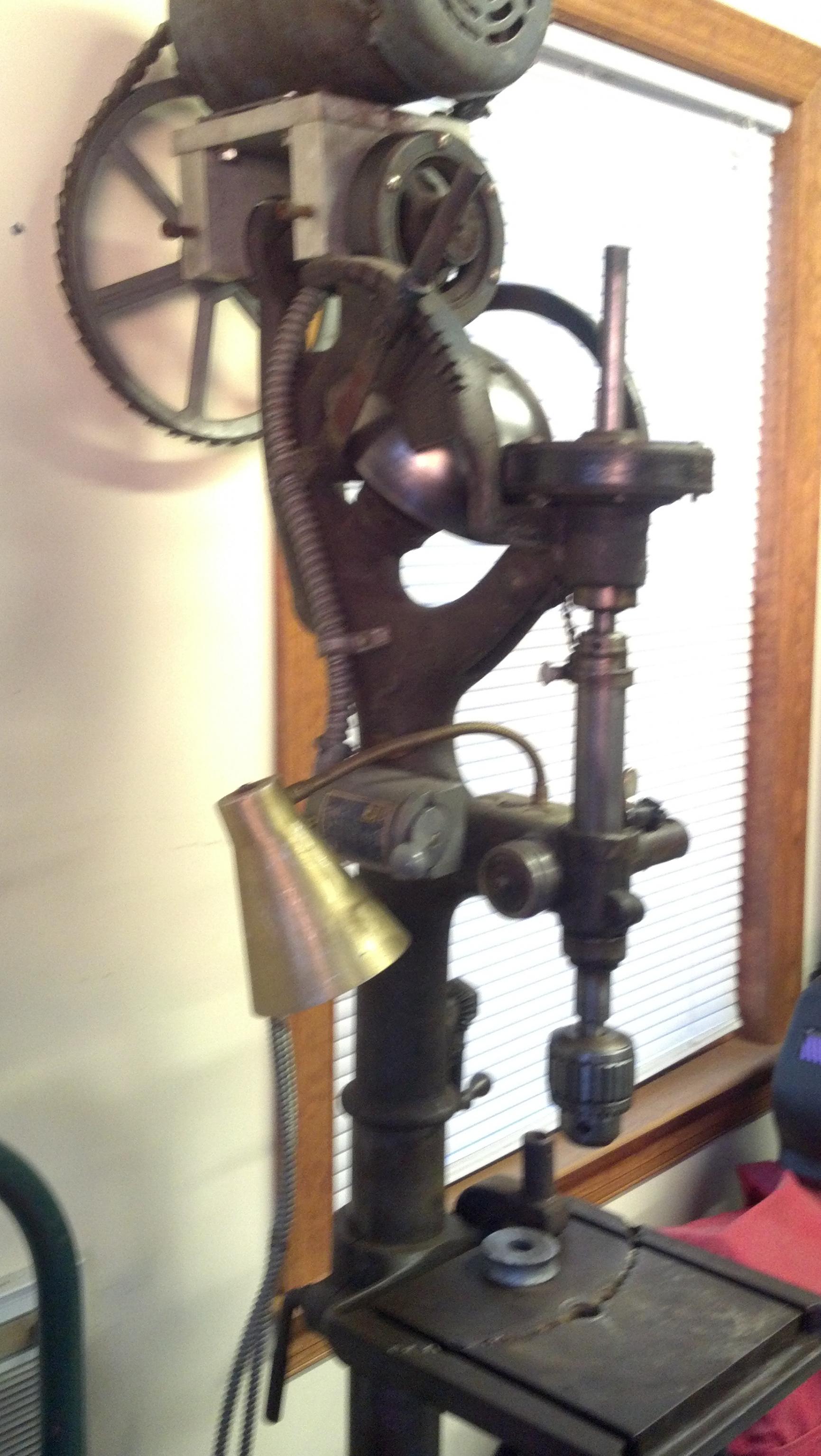

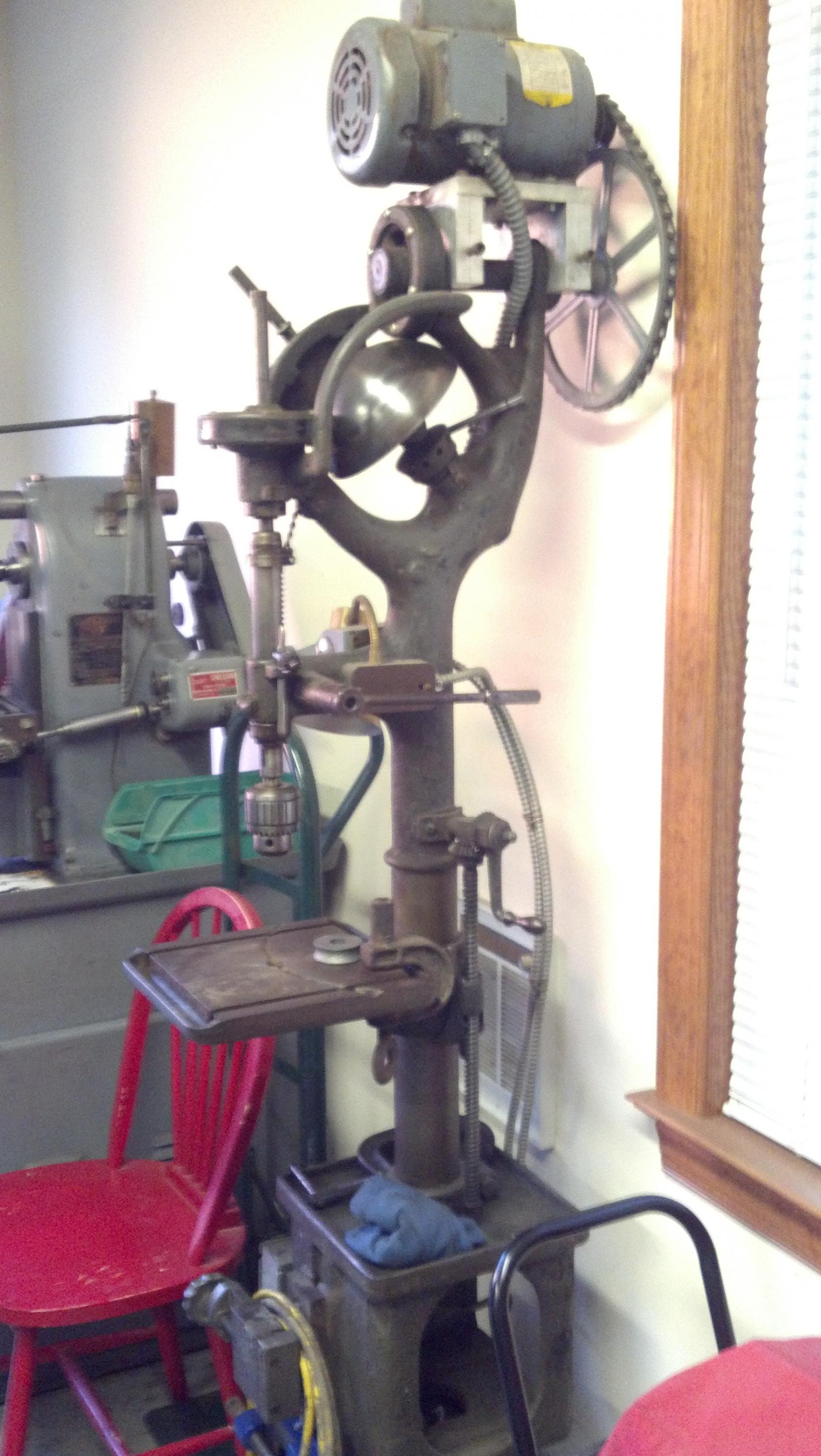

Those old camelback drill presses are great. I have an AHS variable speed drillpress that is converted to v belt drive. It is 100 years old and still works great. I have since moved the motor below inside the base. One day I plan on doing a resto on this one too.
