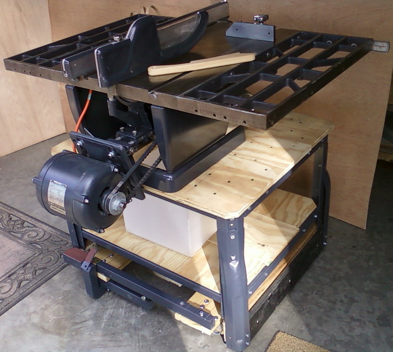

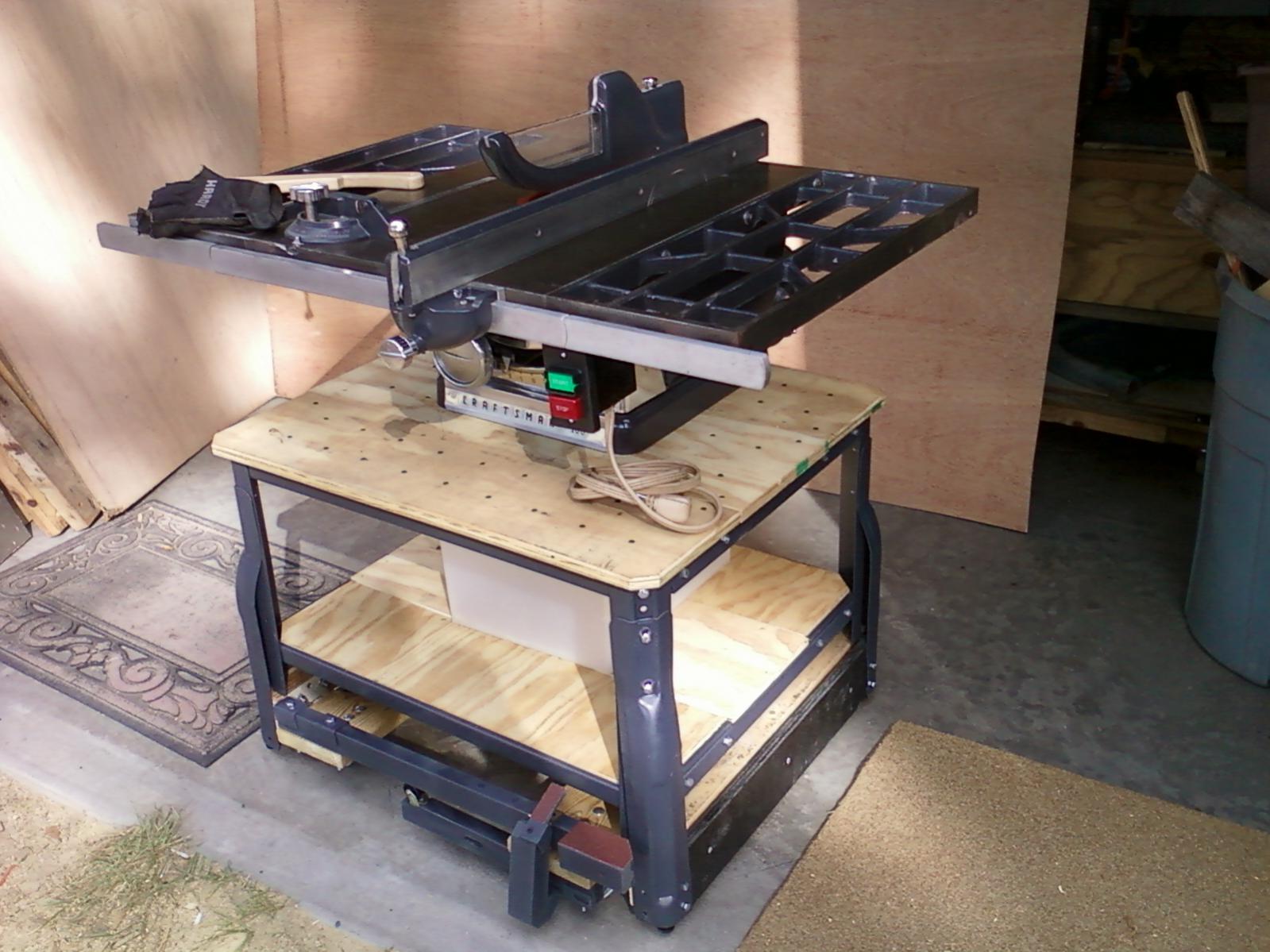

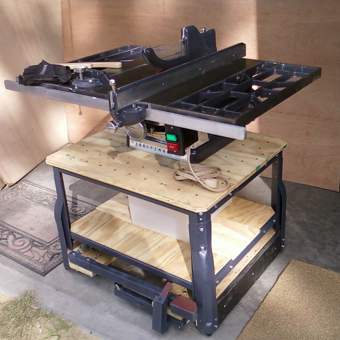

    My son fully restored this old saw to "better than new" condition for me. I modified the base and made a lift mechanism borrowing ideas from several others.
    Restored 1959 Craftsman 100 Table Saw-restored-craftsman-100-saw-lift-base.jpg

    It was a pleasure restoring this old saw for you Dad.
    Hope you get many years of use.
    Another piece of American iron saved from the scrapper.

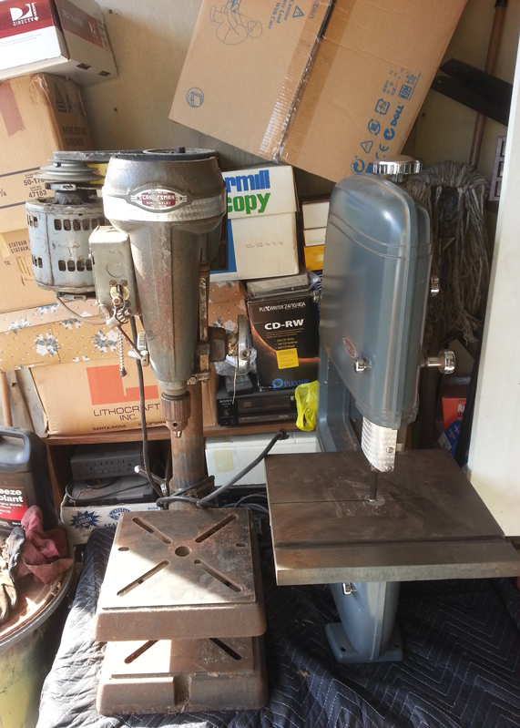

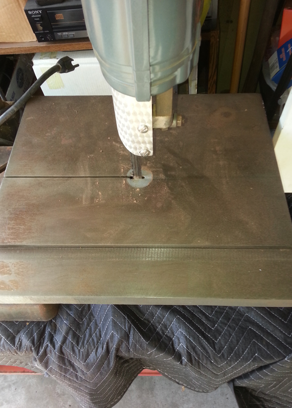

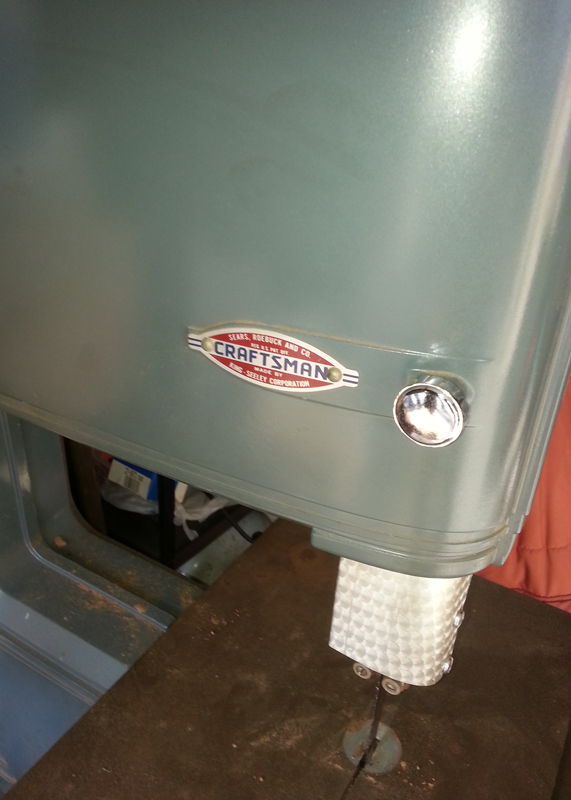

    This is amazing and a nice restoration. Nice work Mikerichards1319 and congrats to a Dad (oldtimetexan) with a fine son! Interestingly I just acquired a matching pair of 1958 King Seeley/Craftsman drill press (bench) and 12" band saw. About dropped my jaw when I saw this post. The DP is a bit rough and the number plate is missing and been moded but built like a brick. The BS is almost mint, other than it has a MonkeyWards motor on it...Guy told me it was a hybrid! LOL
    Would love to know more about your restoration Mike.
    Thanks for Sharing this. ~PJ

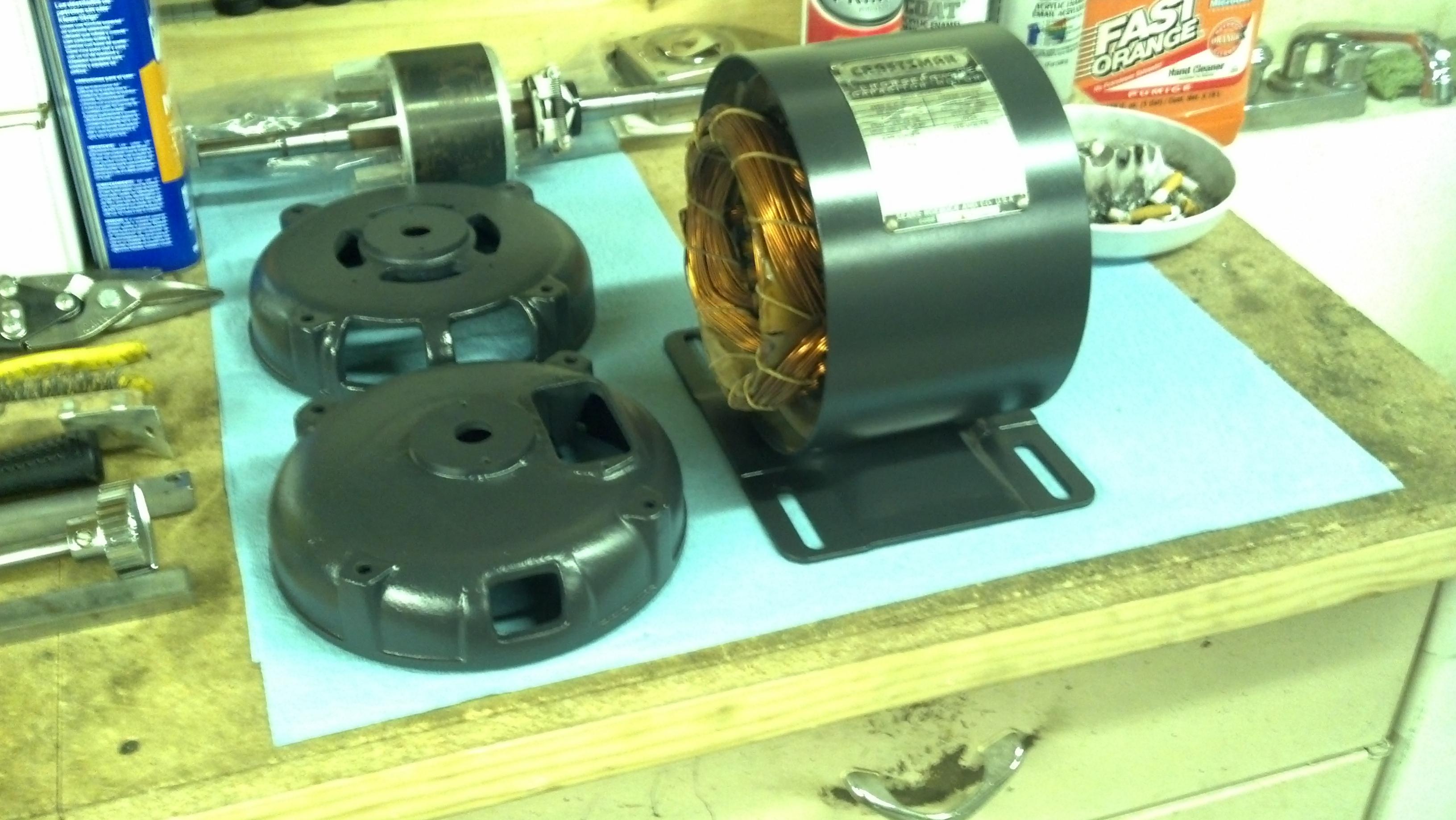

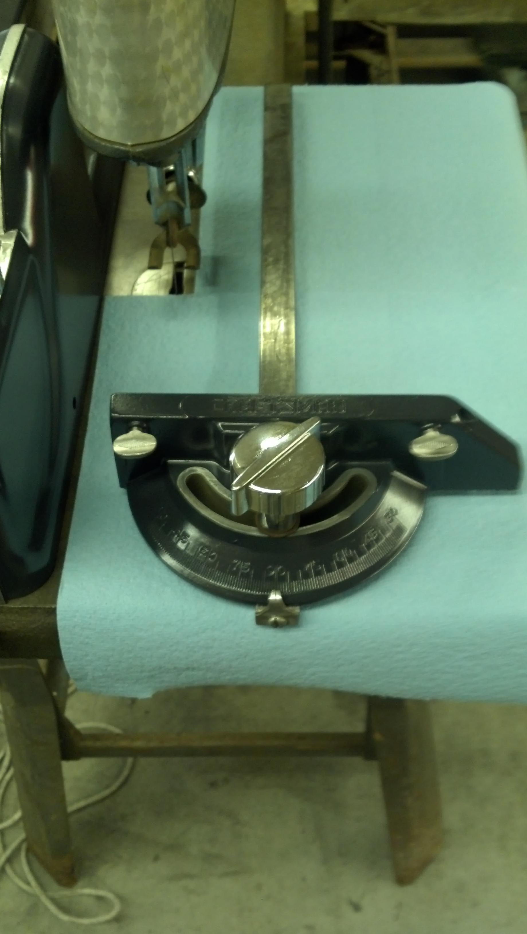

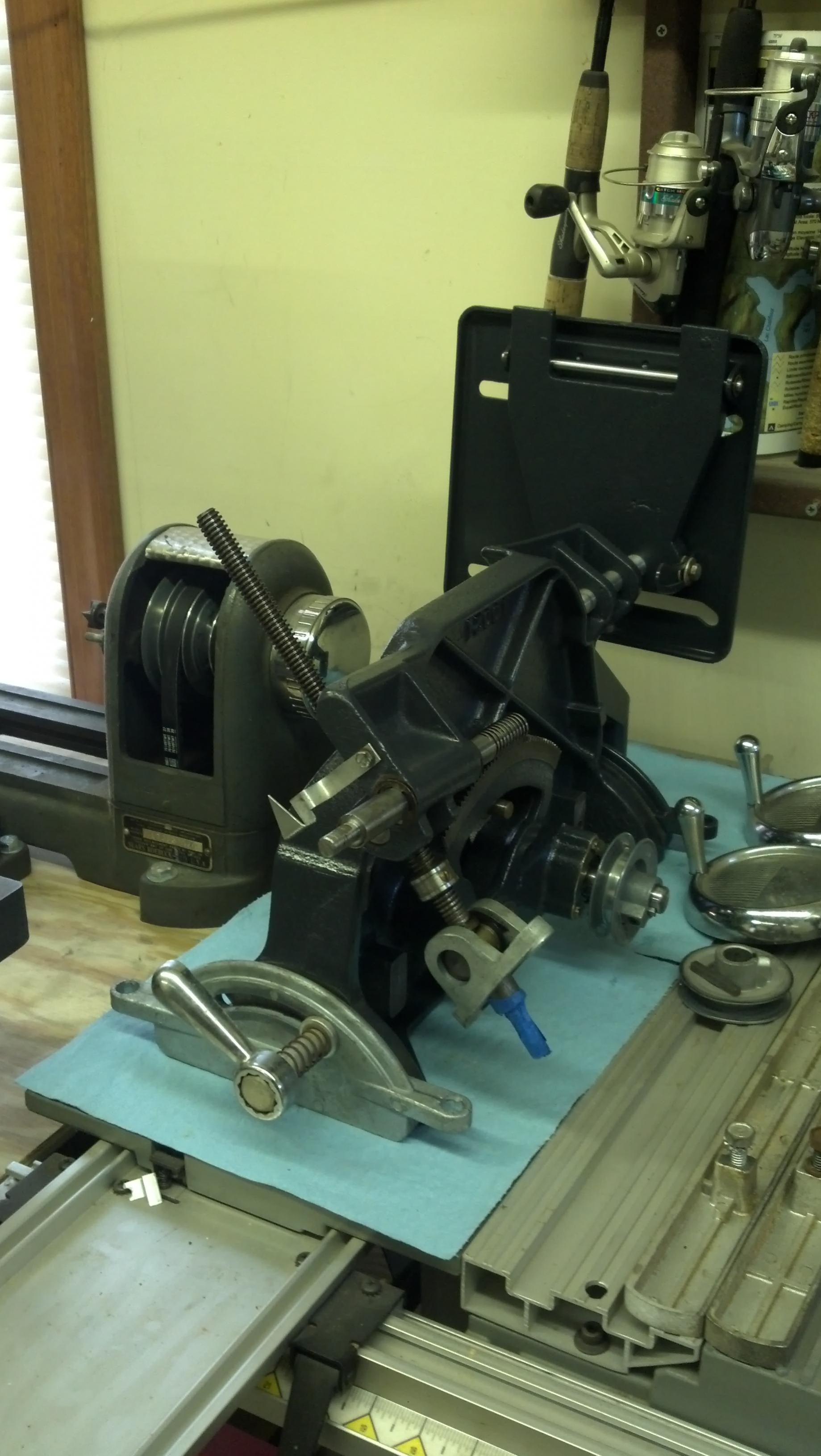

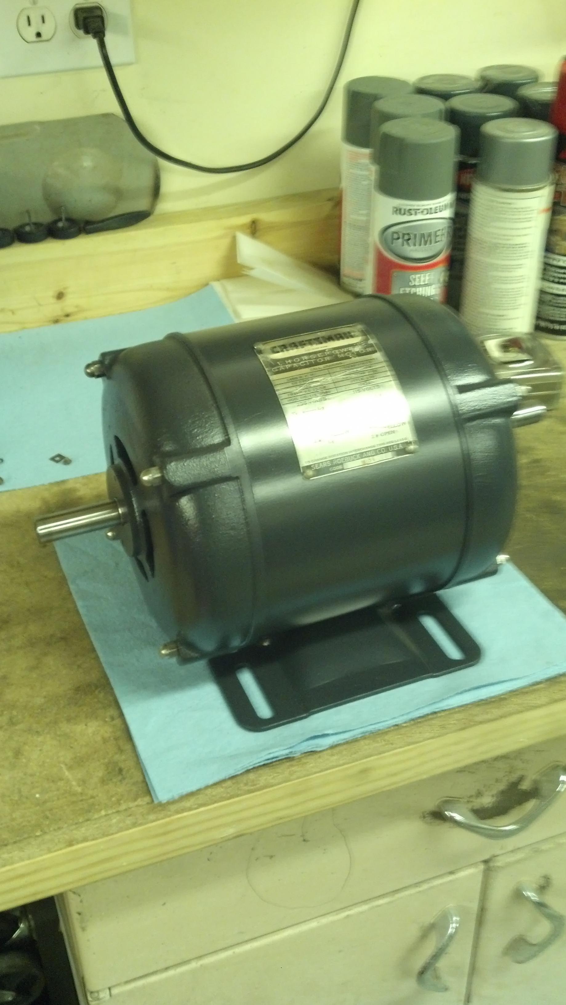

    Restored 1959 Craftsman 100 Table Saw-2015-03-08_11-28-23_188.jpgRestored 1959 Craftsman 100 Table Saw-2015-03-08_11-28-32_170.jpgRestored 1959 Craftsman 100 Table Saw-2015-03-08_21-18-39_37.jpgRestored 1959 Craftsman 100 Table Saw-2015-03-13_07-41-14_343.jpgRestored 1959 Craftsman 100 Table Saw-2015-03-13_11-56-47_432.jpgRestored 1959 Craftsman 100 Table Saw-2015-03-13_14-48-50_26.jpgRestored 1959 Craftsman 100 Table Saw-2015-03-13_14-48-58_920.jpgRestored 1959 Craftsman 100 Table Saw-2015-03-08_21-18-21_58.jpgRestored 1959 Craftsman 100 Table Saw-2015-03-13_11-58-09_769.jpgRestored 1959 Craftsman 100 Table Saw-2015-03-13_14-46-16_662.jpg

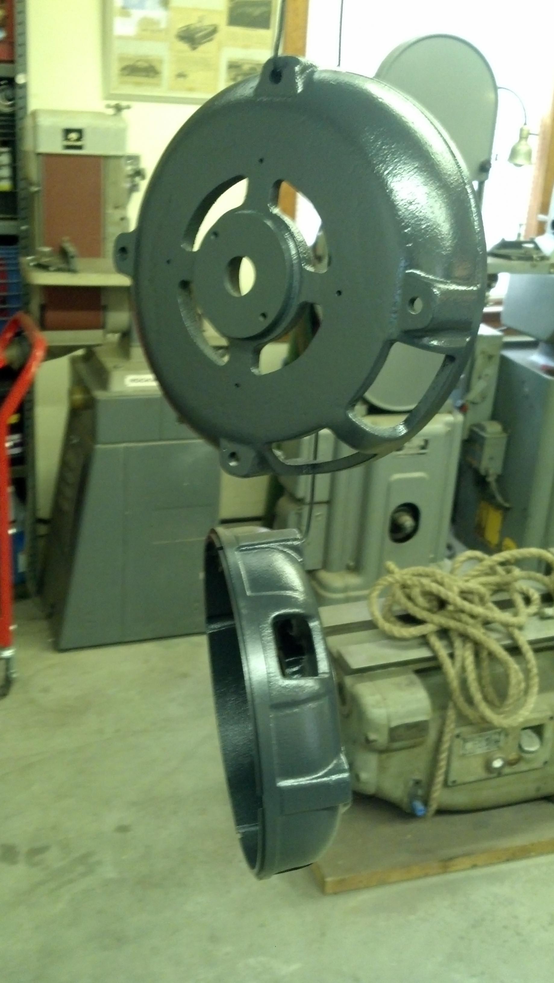

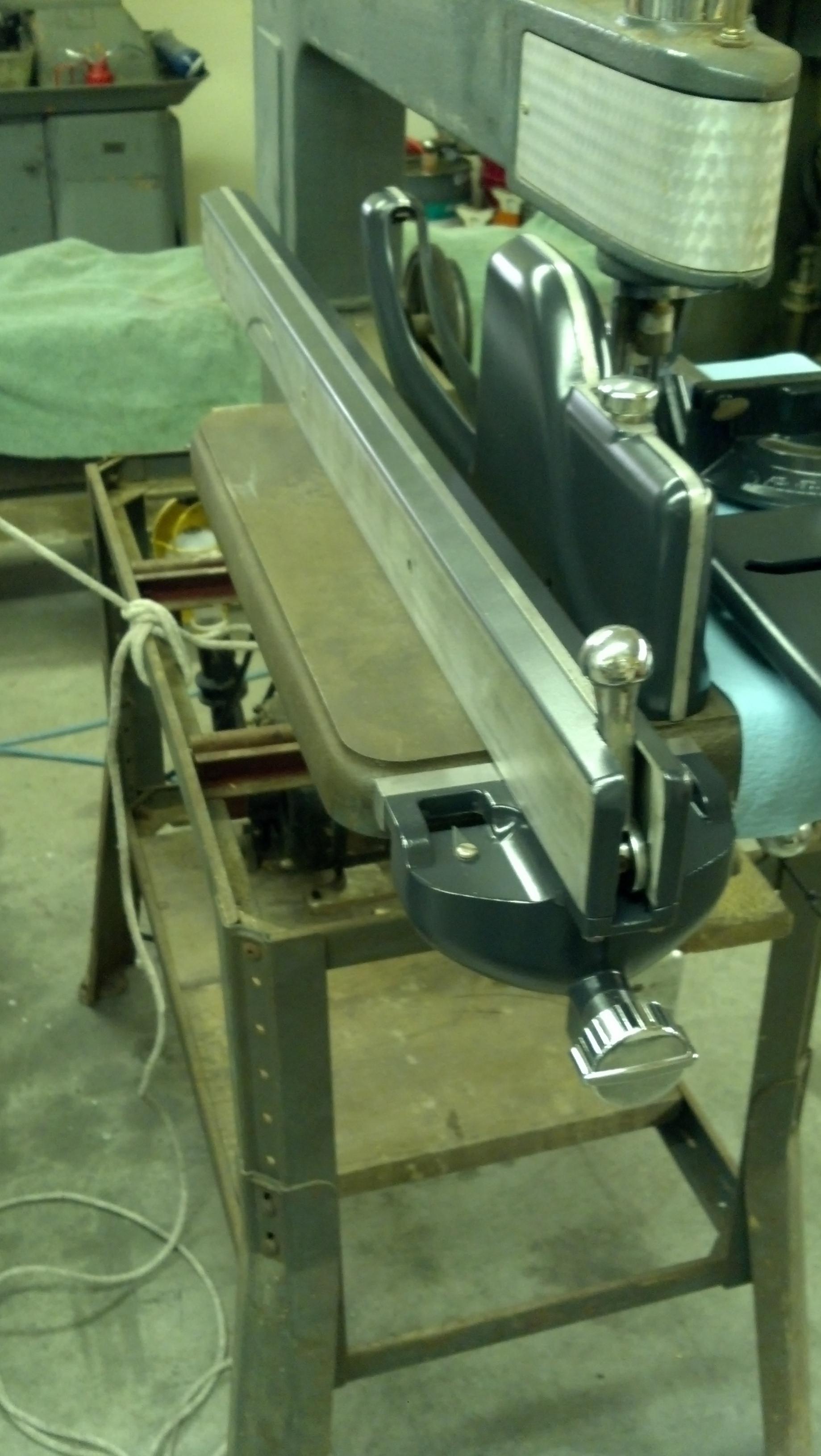

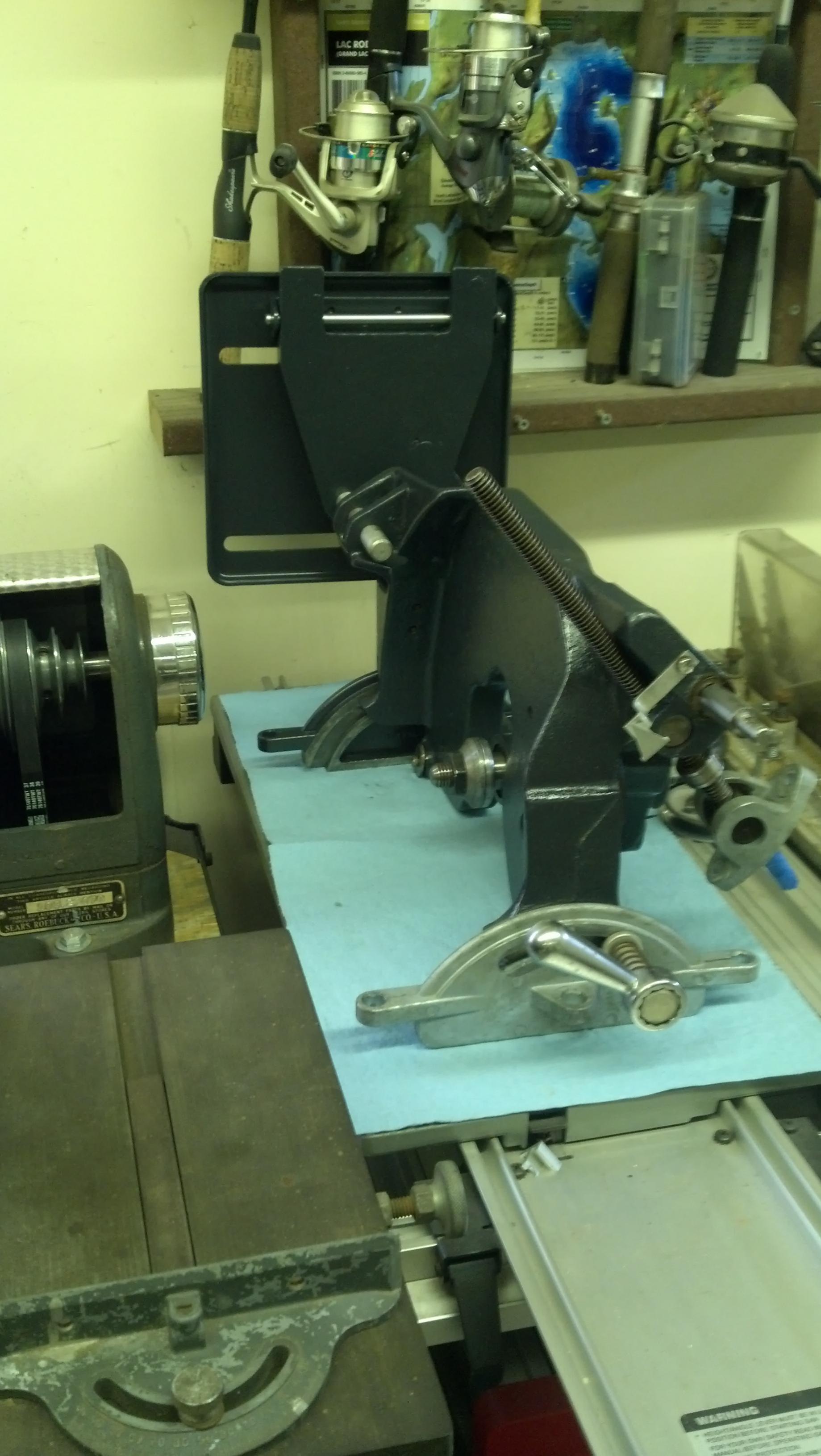

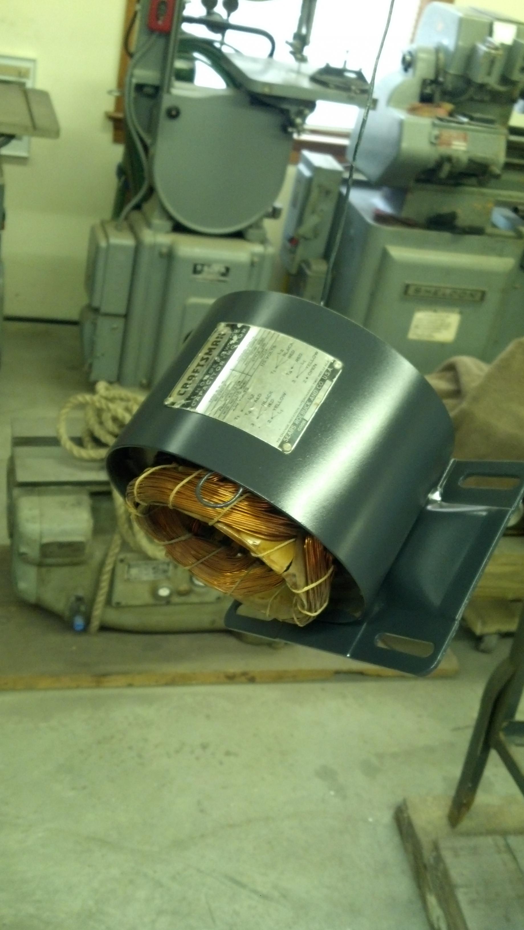

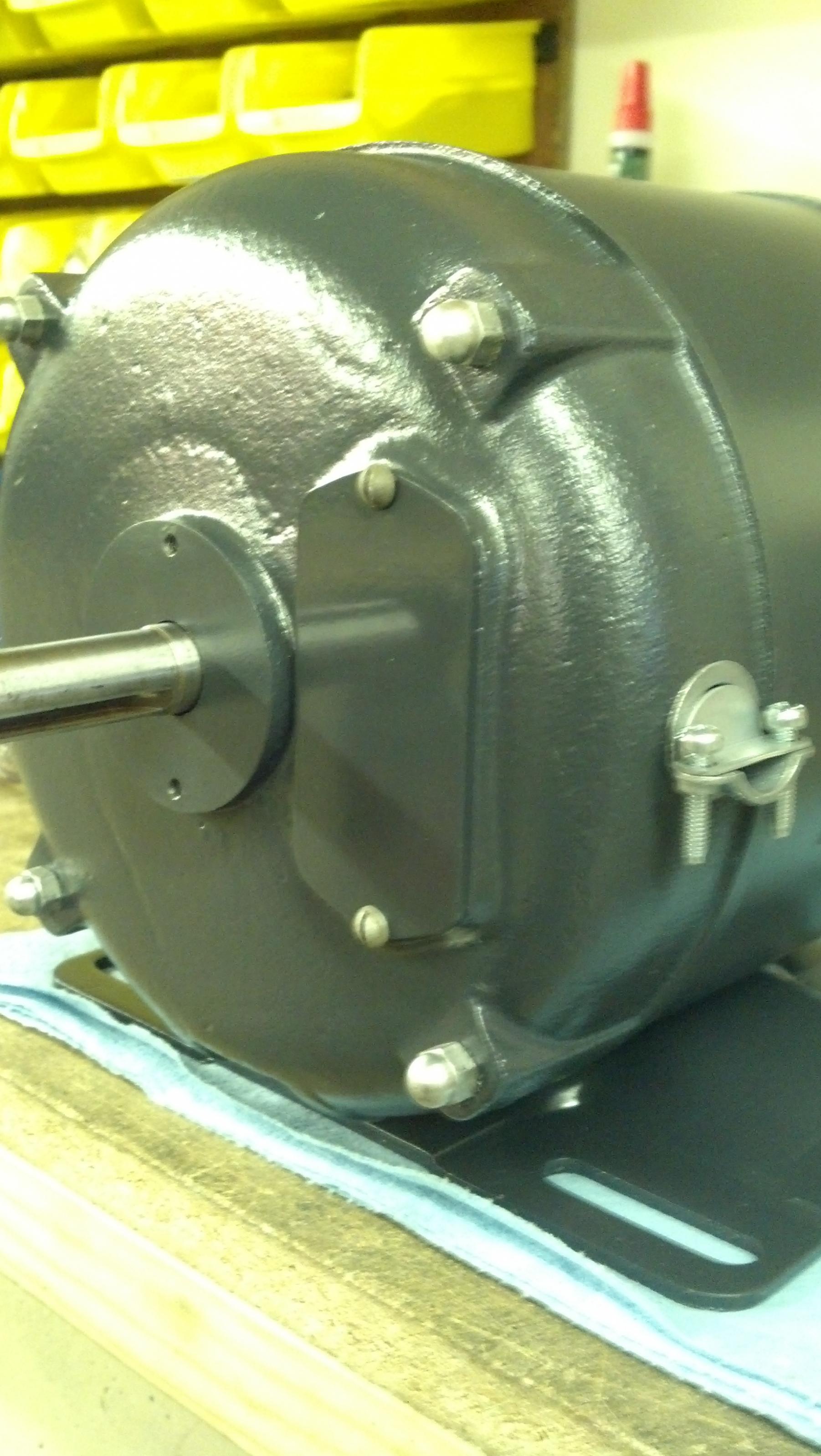

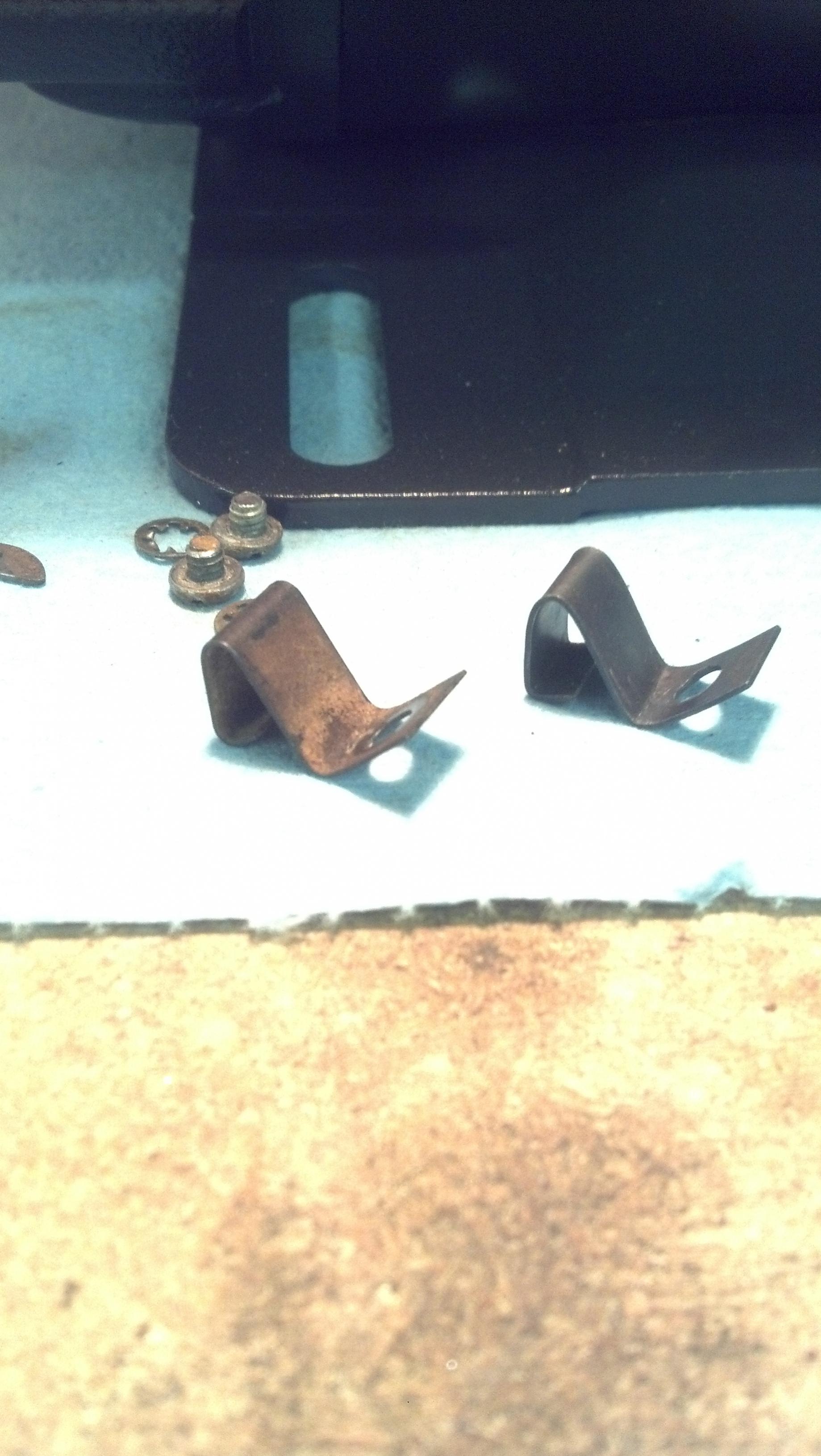

    I replaced the bearings in the motor and arbor. Cleaned everything up and painted while in pieces.

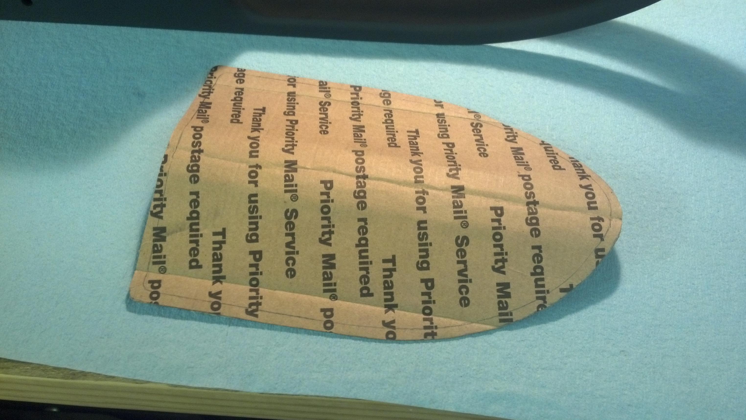

    Restored 1959 Craftsman 100 Table Saw-2015-03-14_14-03-53_628.jpgRestored 1959 Craftsman 100 Table Saw-2015-03-14_14-04-23_577.jpg

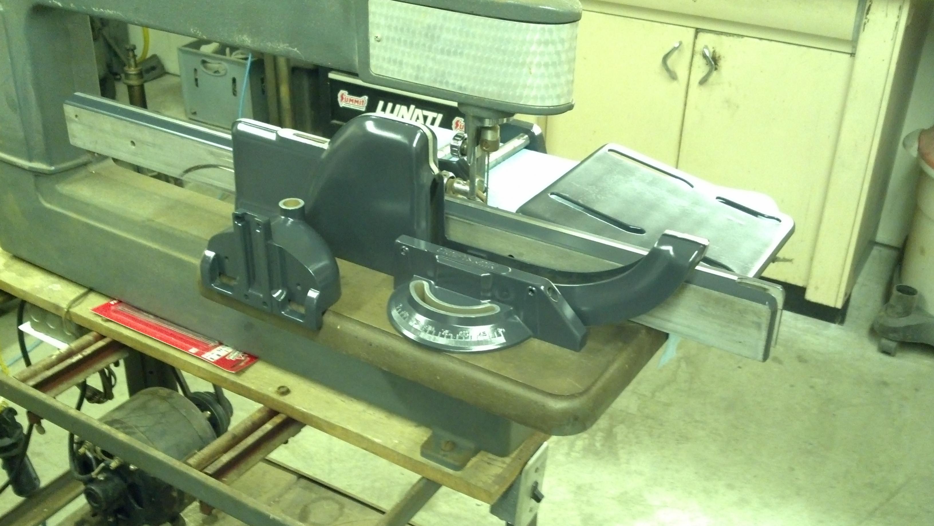

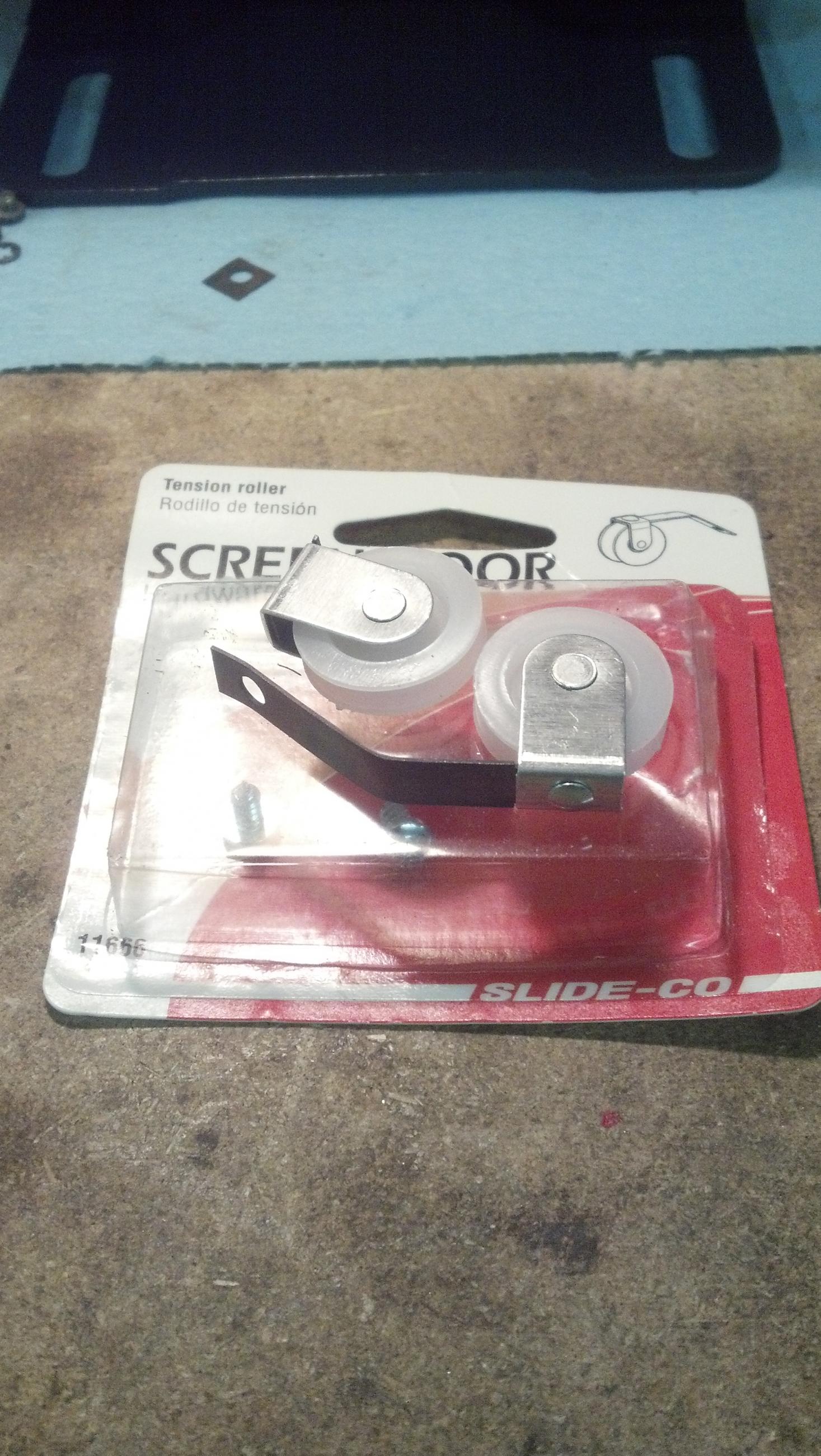

    Made the spring lock for the blade insert out of a screen door roller.
    Attached Thumbnails Attached Thumbnails Restored 1959 Craftsman 100 Table Saw-2015-03-14_14-33-11_312.jpg   Restored 1959 Craftsman 100 Table Saw-2015-03-14_14-33-31_813.jpg   Restored 1959 Craftsman 100 Table Saw-2015-03-14_14-41-39_121.jpg   Restored 1959 Craftsman 100 Table Saw-2015-03-14_14-41-45_445.jpg   Restored 1959 Craftsman 100 Table Saw-2015-03-14_14-43-55_730.jpg

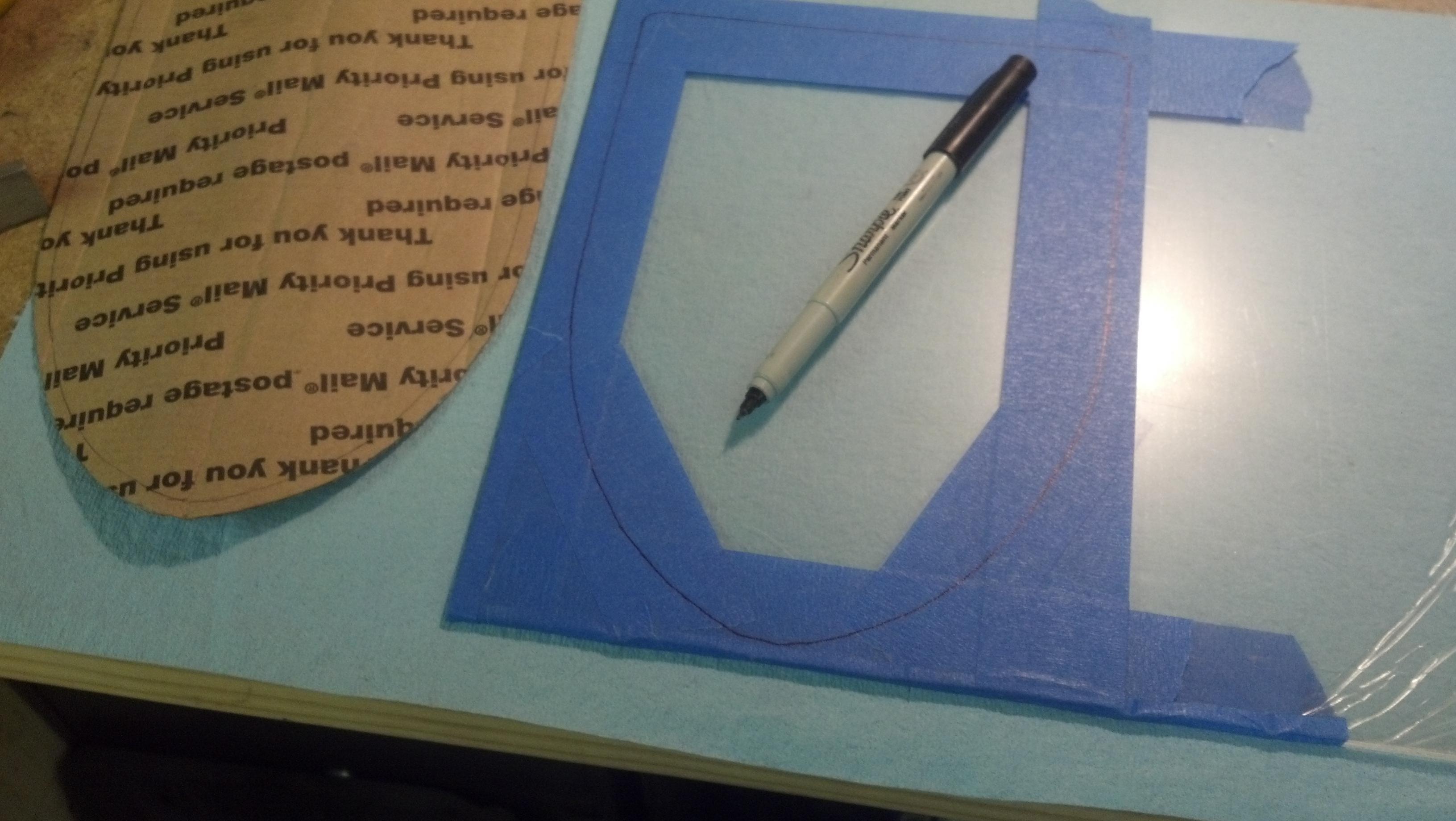

    Ran out of room on the last post.
    Restored 1959 Craftsman 100 Table Saw-2015-03-14_14-33-11_312.jpgRestored 1959 Craftsman 100 Table Saw-2015-03-14_14-33-31_813.jpgRestored 1959 Craftsman 100 Table Saw-2015-03-14_14-41-39_121.jpgRestored 1959 Craftsman 100 Table Saw-2015-03-14_14-41-45_445.jpgRestored 1959 Craftsman 100 Table Saw-2015-03-14_14-43-55_730.jpgRestored 1959 Craftsman 100 Table Saw-2015-03-14_14-59-11_658.jpgRestored 1959 Craftsman 100 Table Saw-2015-03-14_15-06-03_246.jpgRestored 1959 Craftsman 100 Table Saw-2015-03-14_15-06-20_613.jpgRestored 1959 Craftsman 100 Table Saw-2015-03-14_15-24-32_811.jpgRestored 1959 Craftsman 100 Table Saw-2015-03-14_15-44-37_964.jpg

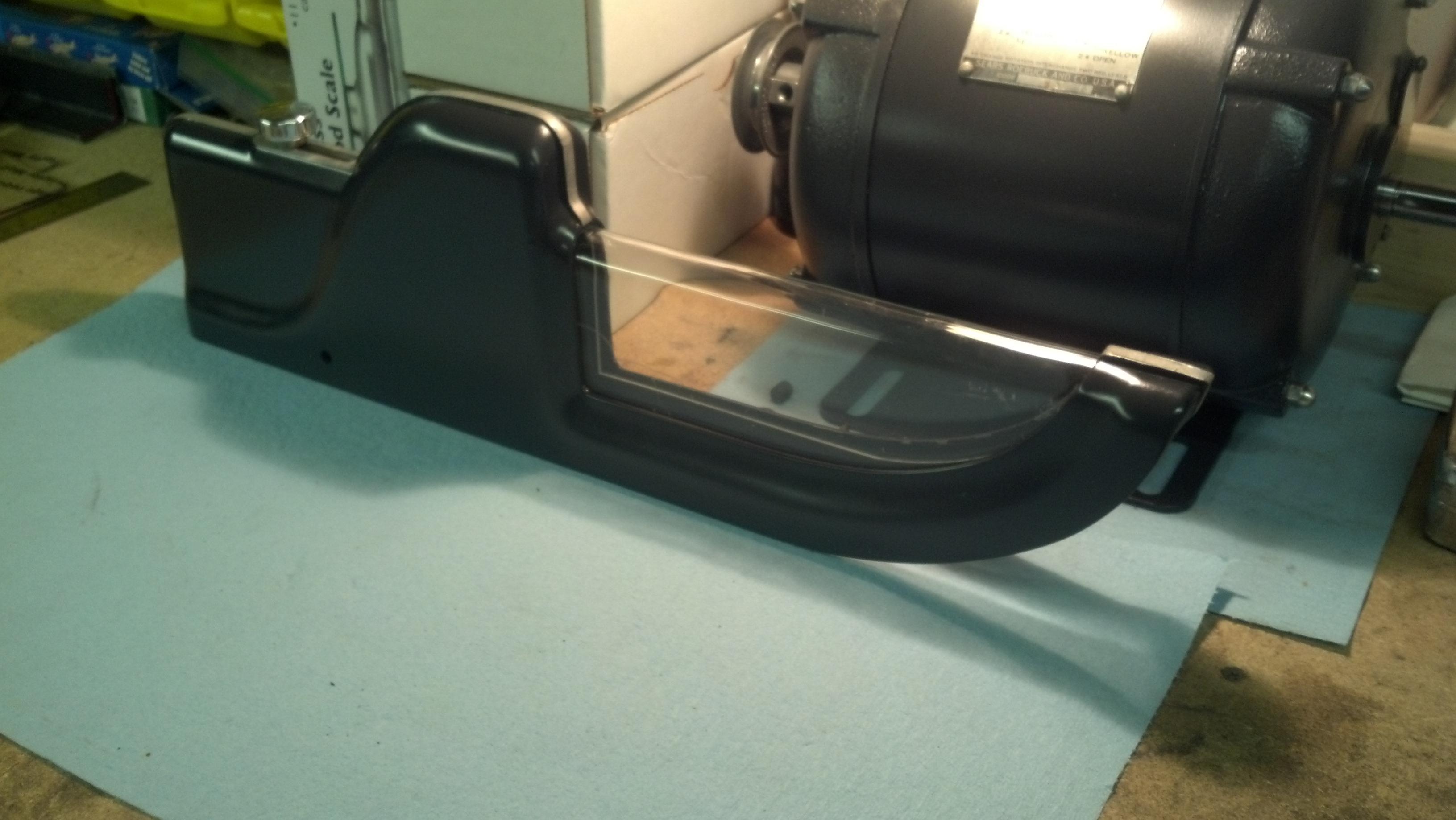

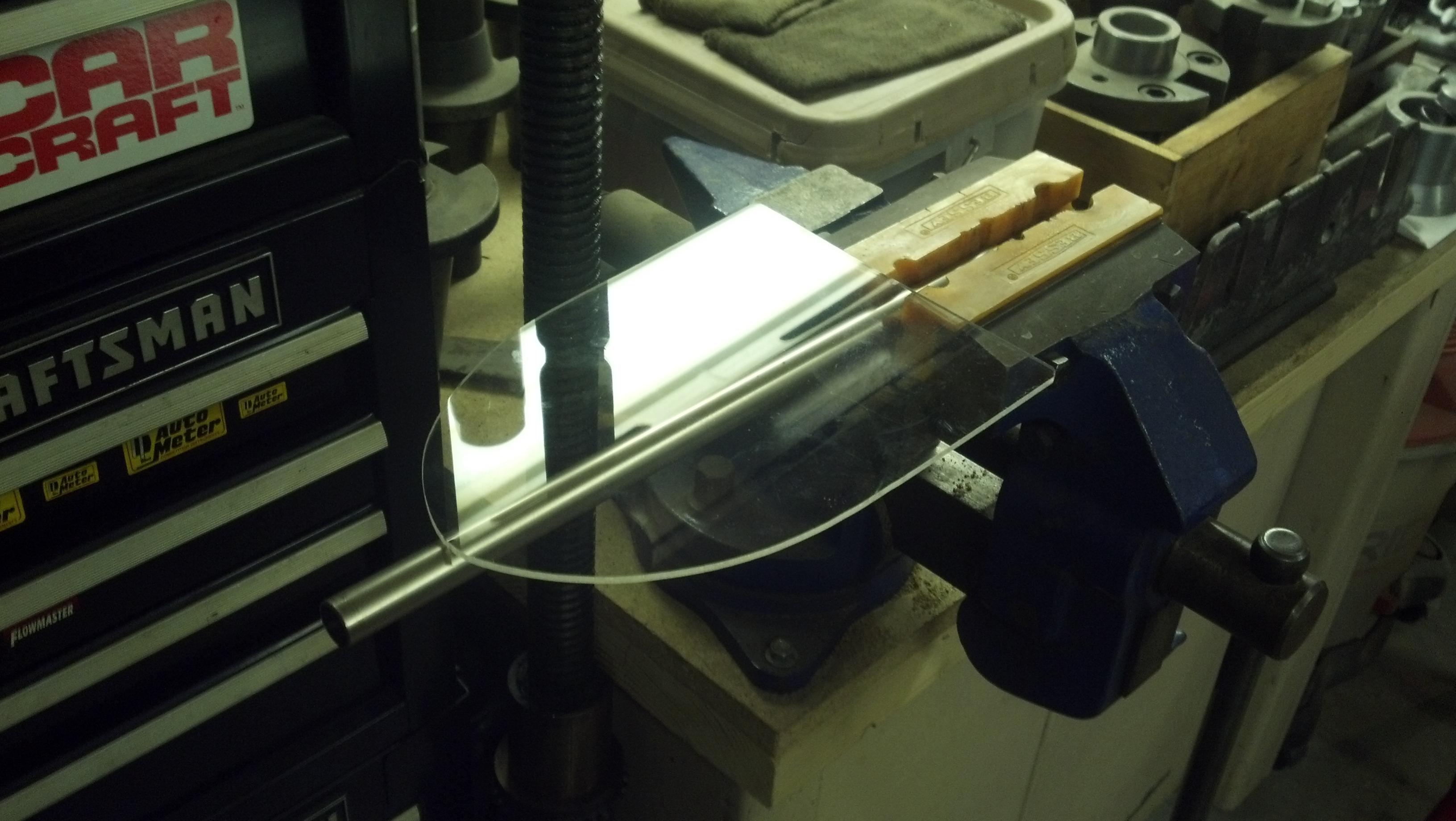

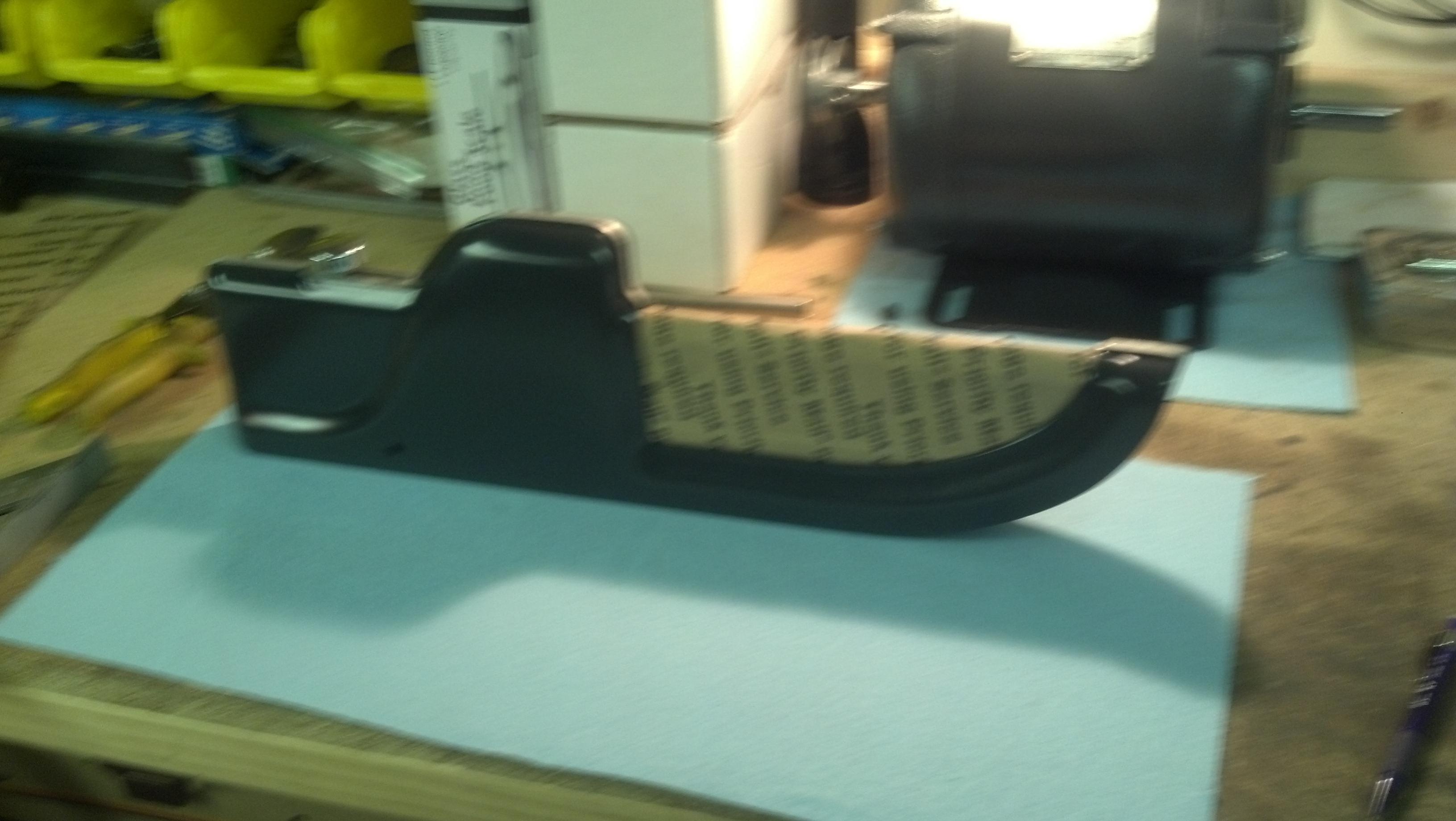

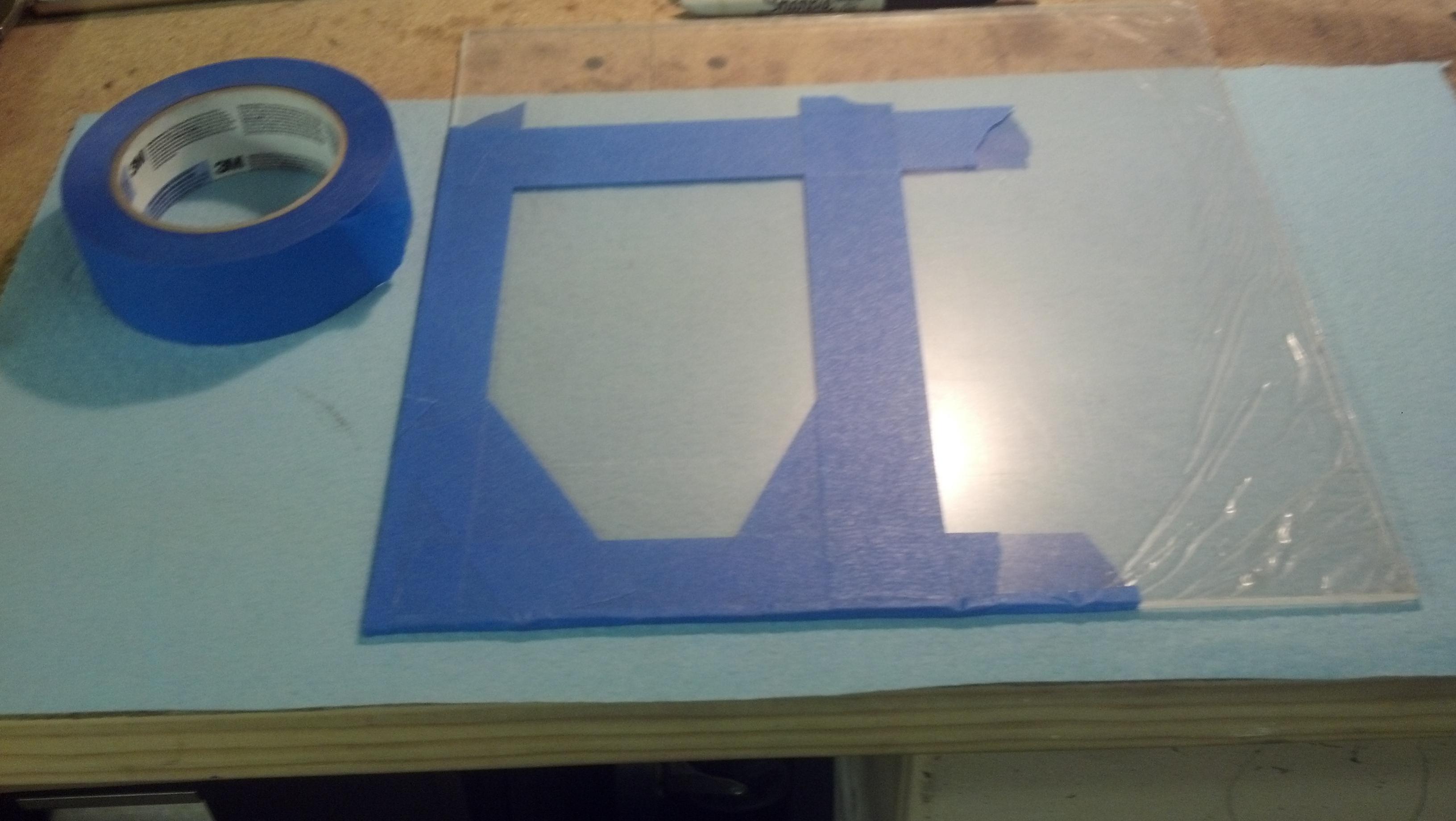

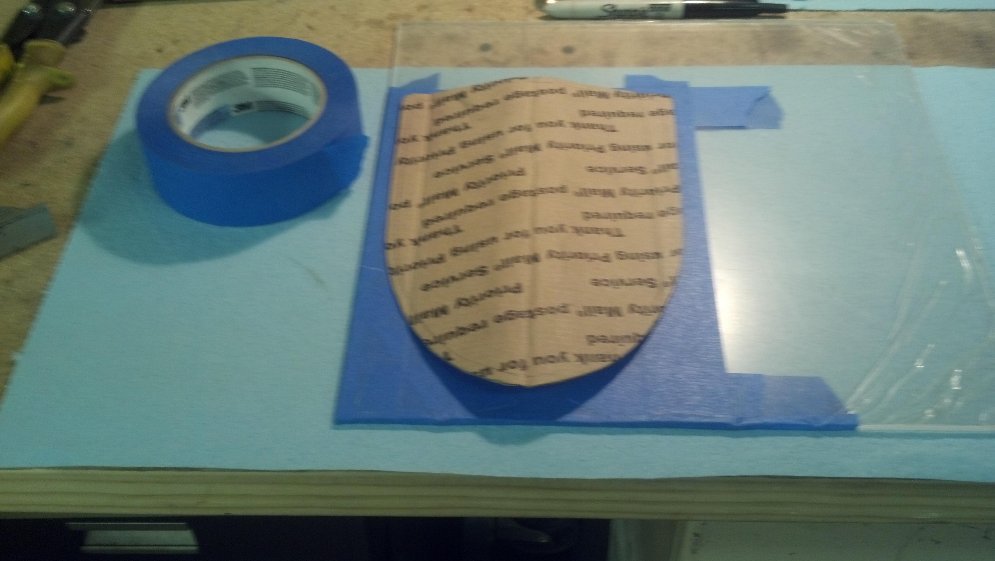

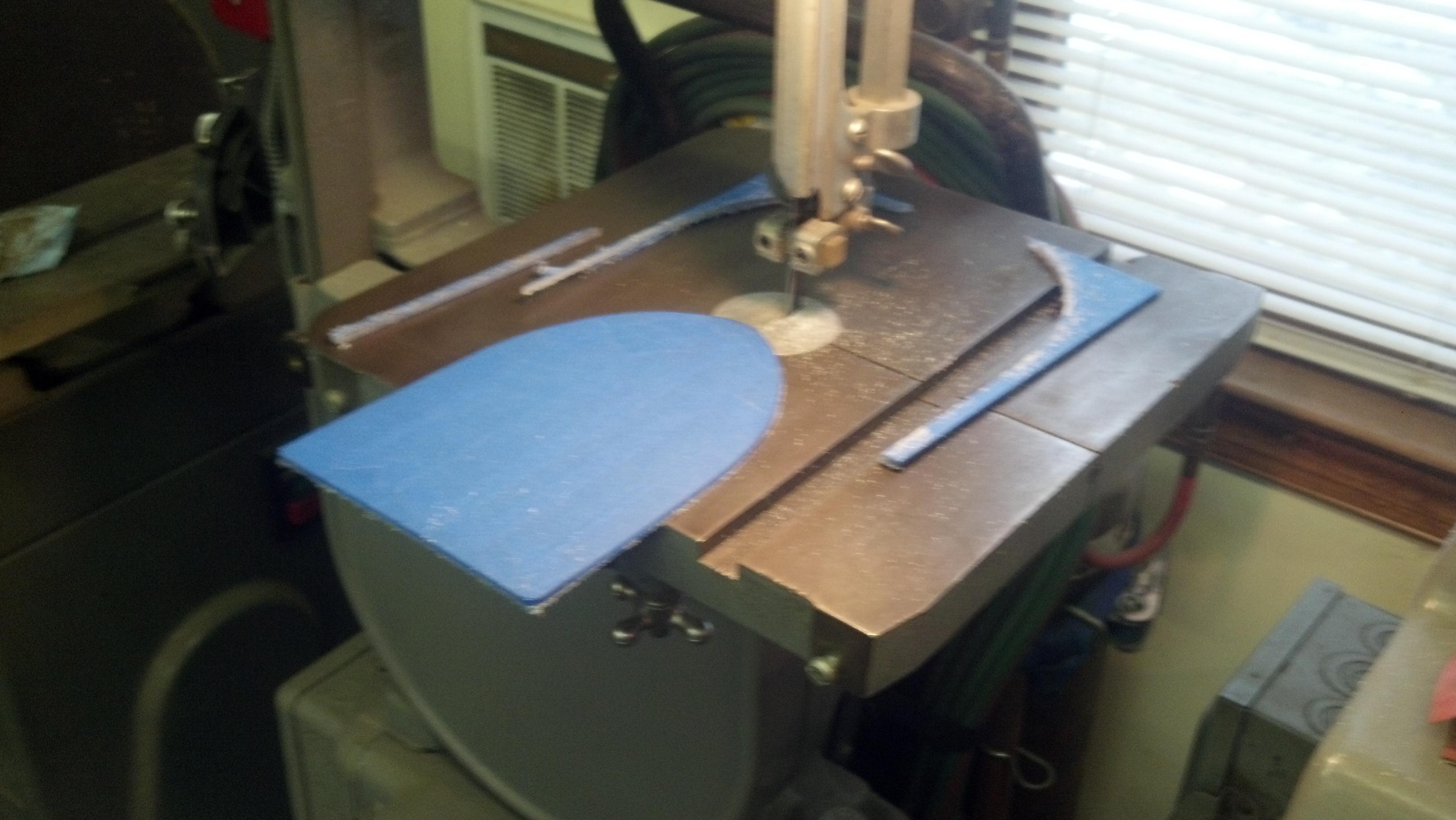

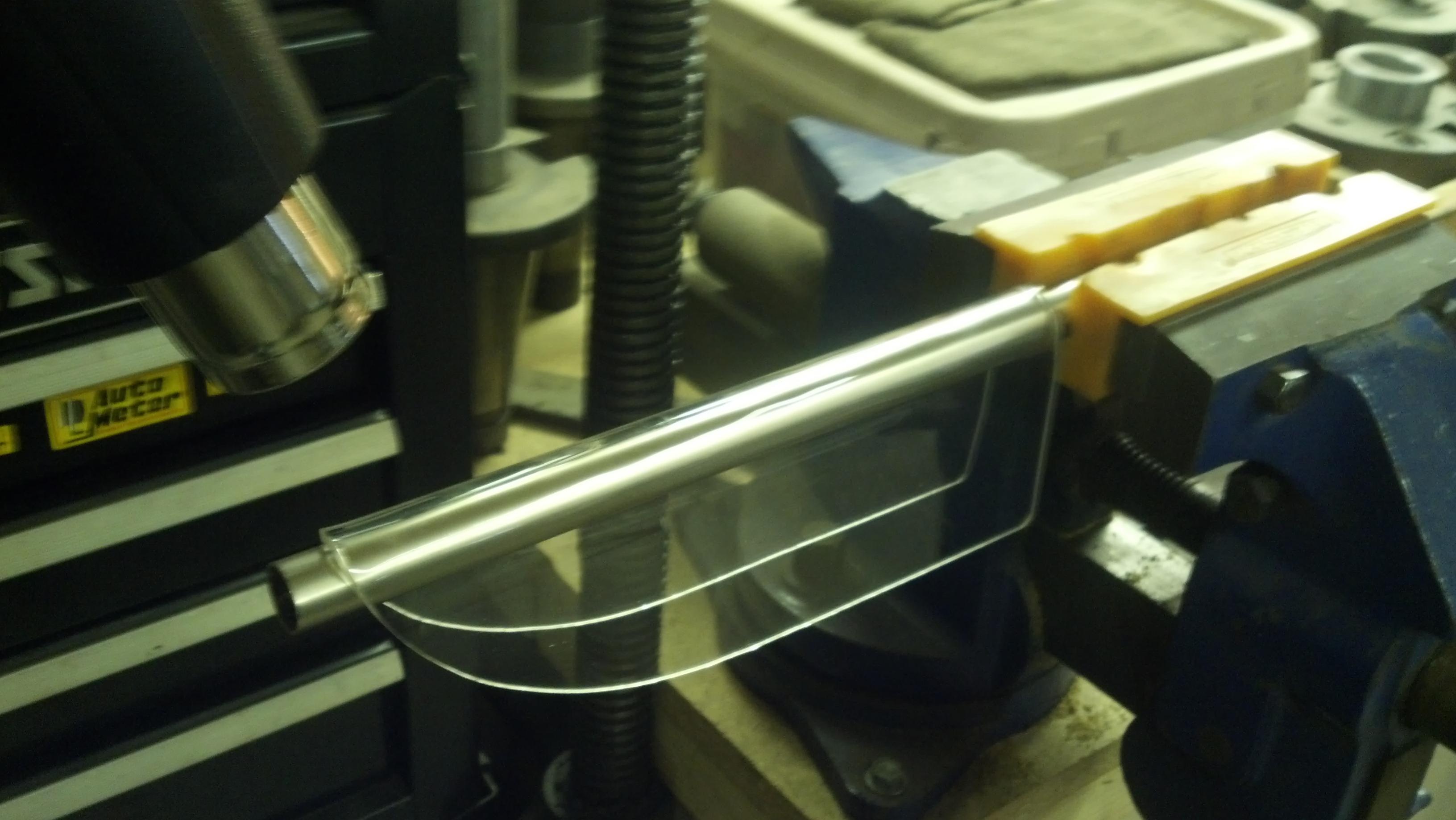

    I made the insert for the blade guard out of plexiglass. I used a piece of cardboard to make a template and transferred it to the plexiglass to cut out on the bandsaw. Then I used a heat gun to bend it over a piece of pipe to form the shape.
    Restored 1959 Craftsman 100 Table Saw-saw-back-1.jpgRestored 1959 Craftsman 100 Table Saw-saw-front-1.jpg
    Here is the front and back of Dad's saw.

    Wow, Nice Job Mike. The acrylic guard looks Perfect and great idea on the restore. Motor and plate look terrific too, plus a good clean out I bet. Looks from the picture you have quite a few older Craftsman tools...Wood Lathe and the Bandsaw? or Scroll saw? (deep throat). And is that a Clausing I see in the background? Thanks Very much for sharing...The Passion really Shows!

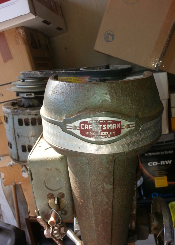

    I found out today that I might be wrong about the Matching Pair after talking to who I got them from and their provenance. Turned out he had the number plate. The DP is a 103.23130 but haven't figured the actual date yet so it could be from 48'-55' and the band saw is a 103.24280 which appears to be around March of 52'. Here are a couple of pics. Lots of work yet.
    Restored 1959 Craftsman 100 Table Saw-kingseeley_bs1_web.jpg Restored 1959 Craftsman 100 Table Saw-kingseeley_bs2_web.jpg
    Restored 1959 Craftsman 100 Table Saw-kingseeley-dp_bs_web.jpg Restored 1959 Craftsman 100 Table Saw-kingseeley-dp1_web.jpg

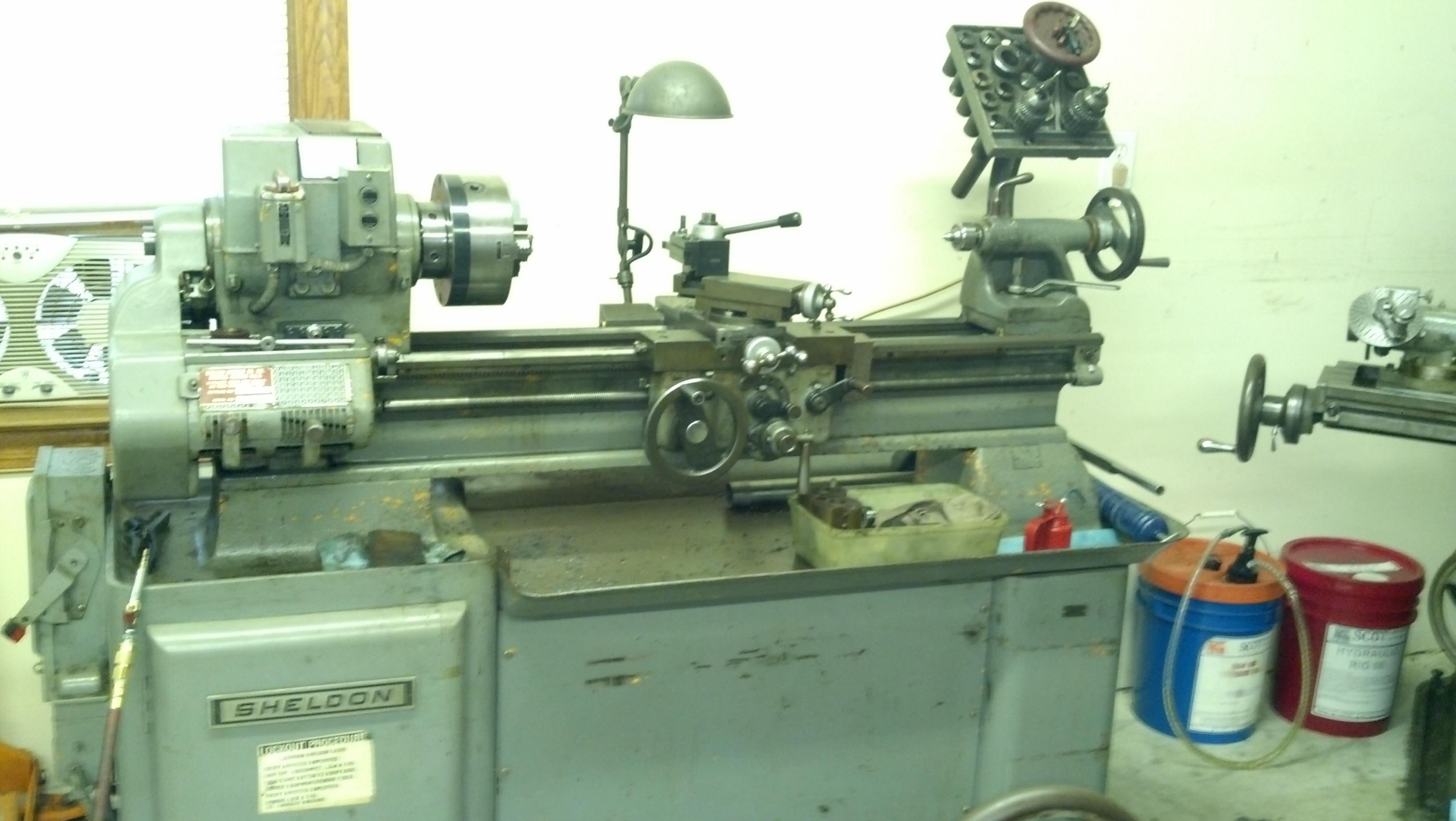

    Yes I do have some old Craftsman items.
    Drillpress and Bandsaw like yours, wood lathe, belt/disk sander and 24 inch Scroll saw.

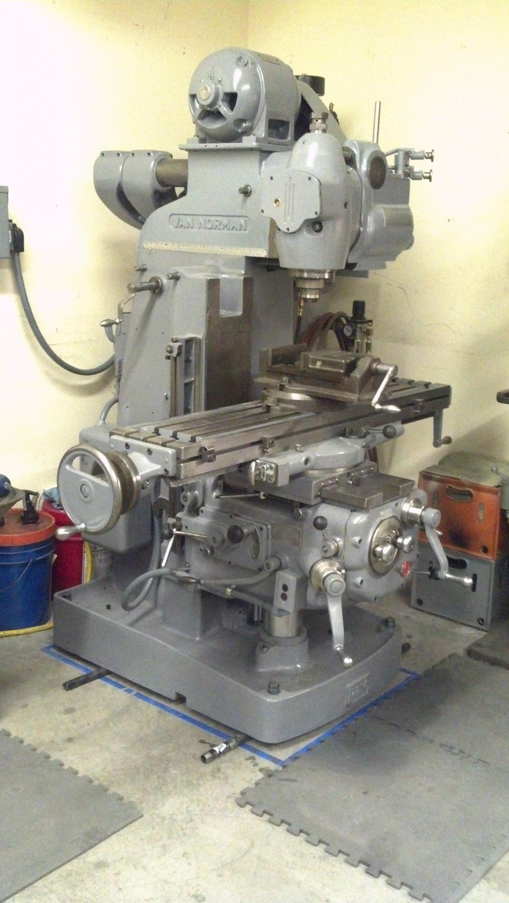

    in the background is actually a Sheldon WM-56-P lathe.
    Next to that is a Van Norman 22M milling machine.
    The 22M was my latest restoration.

    Wow Mike those are beautiful restorations and you are definitely passionate to take on the VN 22M, beast. Oh My!! Hope you have the concrete under it! Do you have the horizontal stuff for it? Couldn't find much info on the 22M but assume its 3x autofeed based on what I can see but the table and lift are beefier than the others I saw. Honestly I'm just a novice to some of this older industrial stuff, but love it, especially bringing them back to life for another long run!
