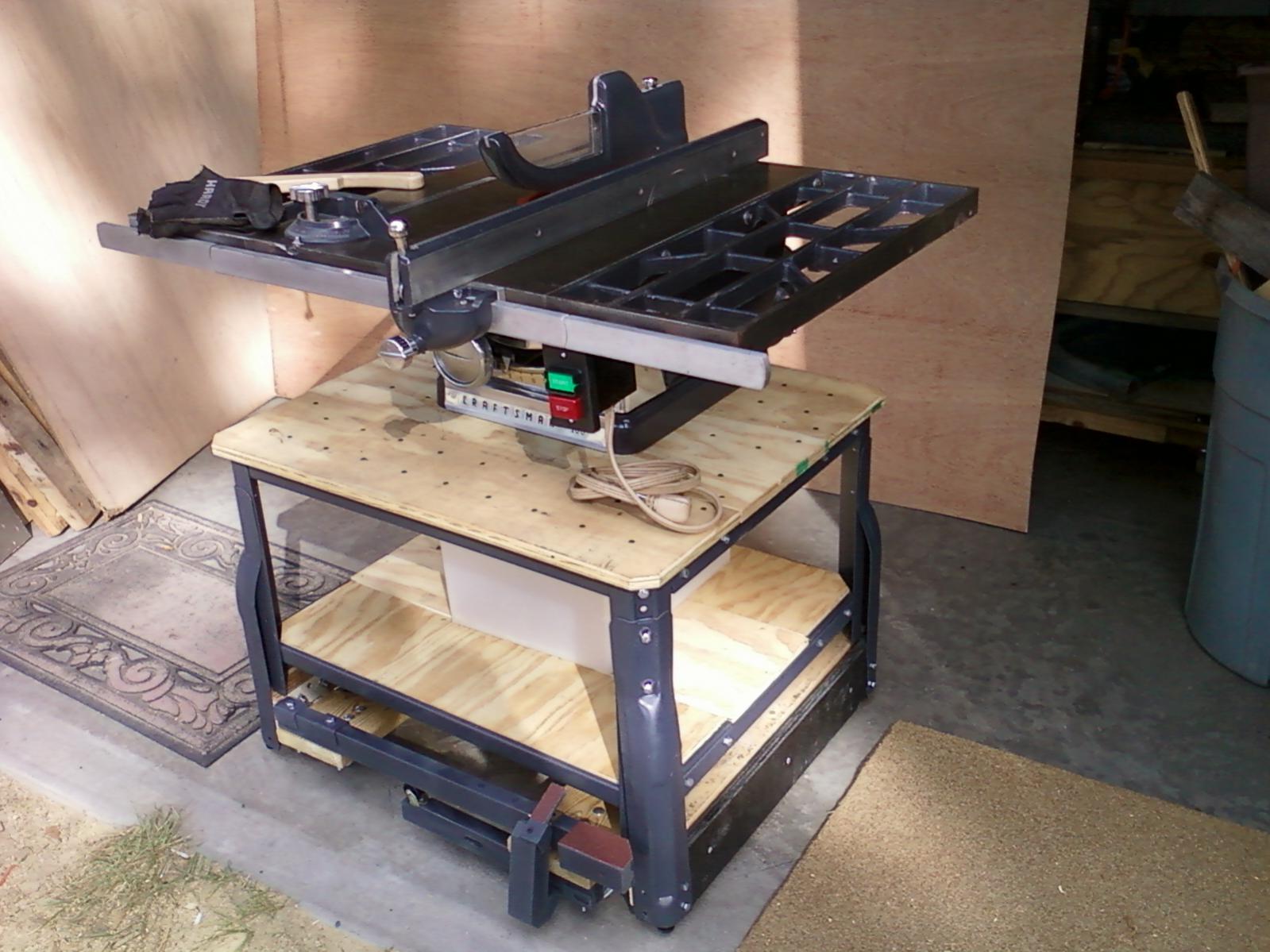

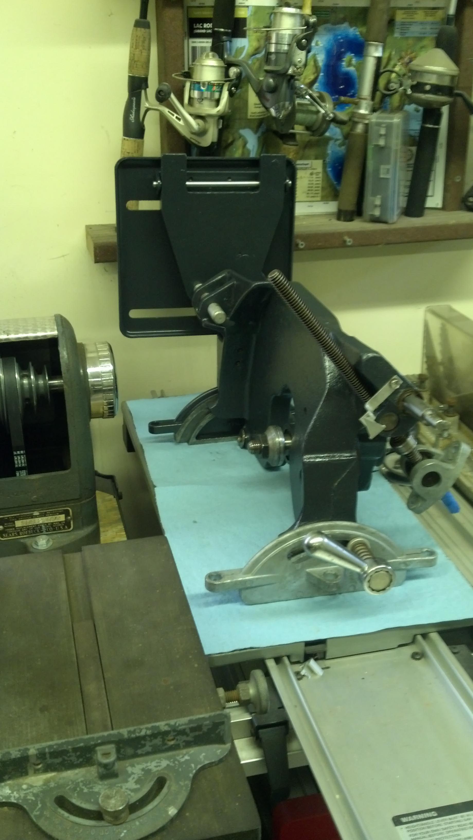

My son fully restored this old saw to "better than new" condition for me. I modified the base and made a lift mechanism borrowing ideas from several others.

It was a pleasure restoring this old saw for you Dad.
Hope you get many years of use.
Another piece of American iron saved from the scrapper.

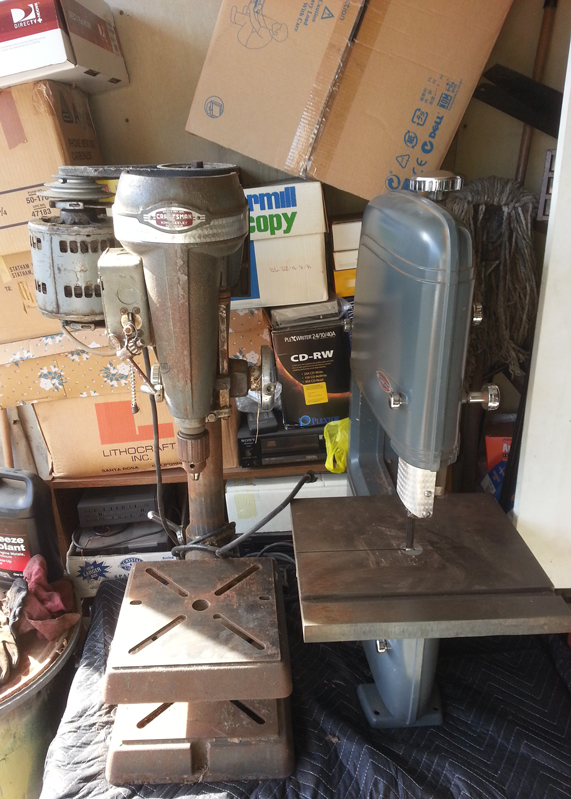

This is amazing and a nice restoration. Nice work Mikerichards1319 and congrats to a Dad (oldtimetexan) with a fine son! Interestingly I just acquired a matching pair of 1958 King Seeley/Craftsman drill press (bench) and 12" band saw. About dropped my jaw when I saw this post. The DP is a bit rough and the number plate is missing and been moded but built like a brick. The BS is almost mint, other than it has a MonkeyWards motor on it...Guy told me it was a hybrid! LOL

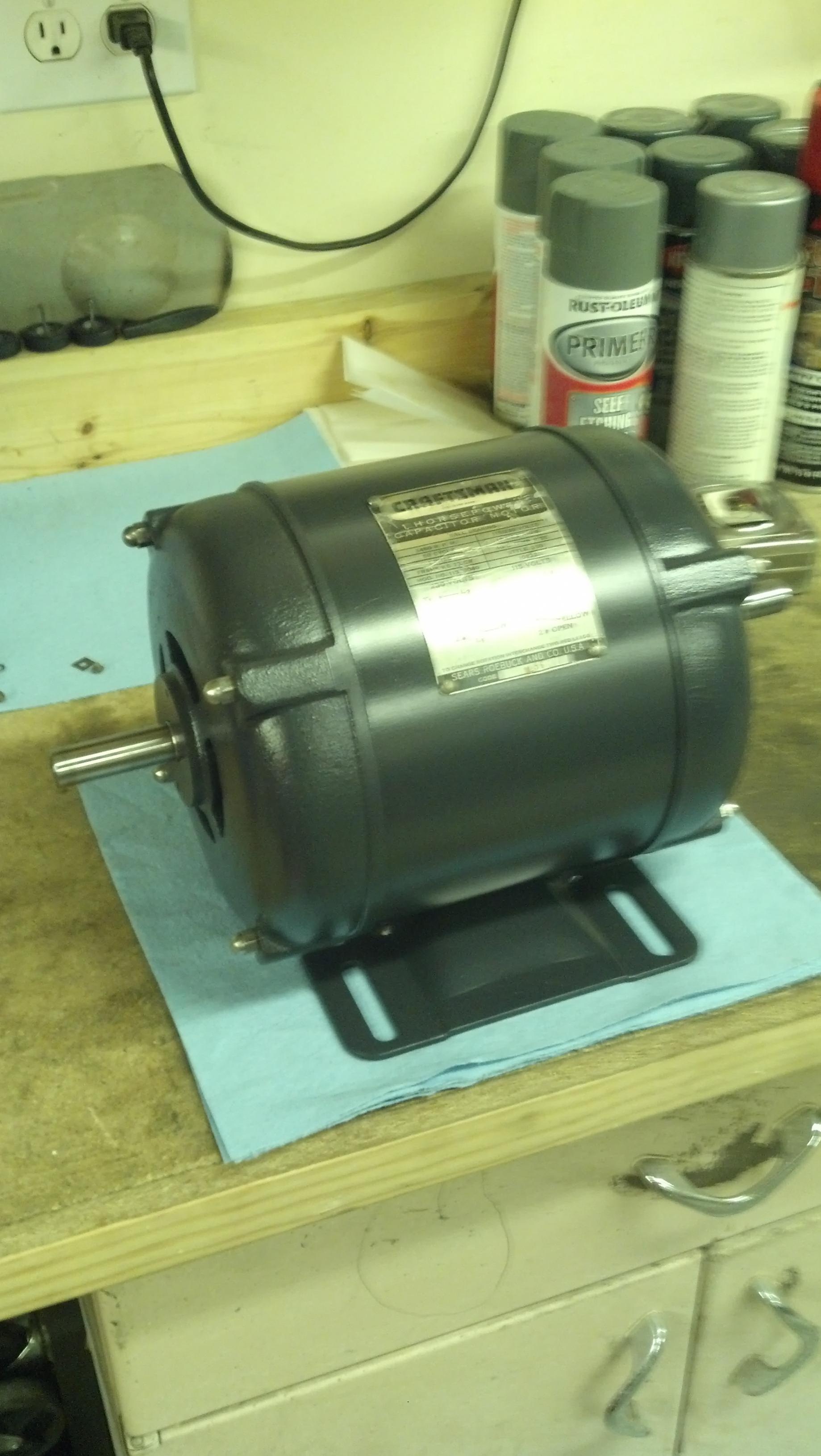

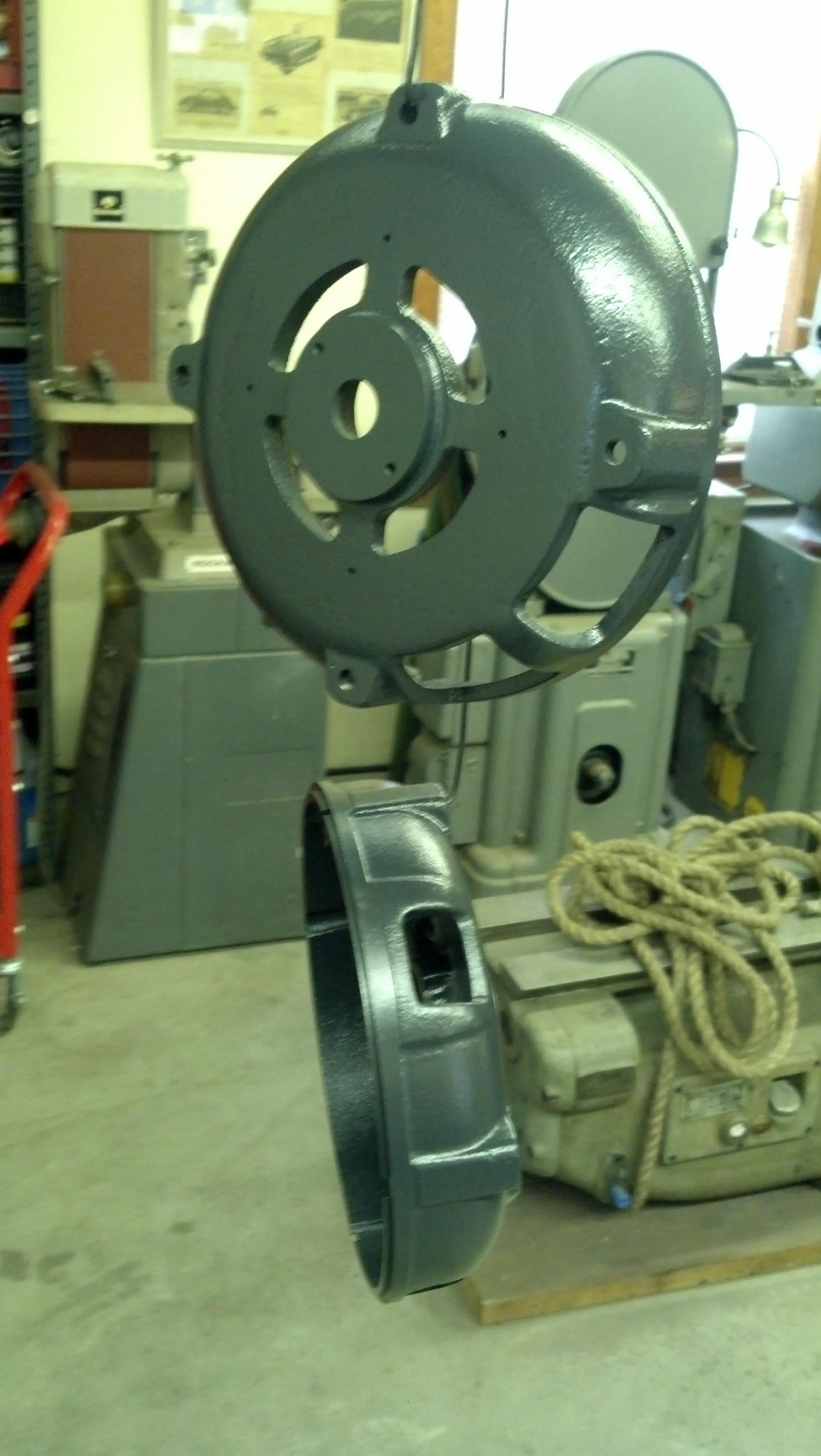

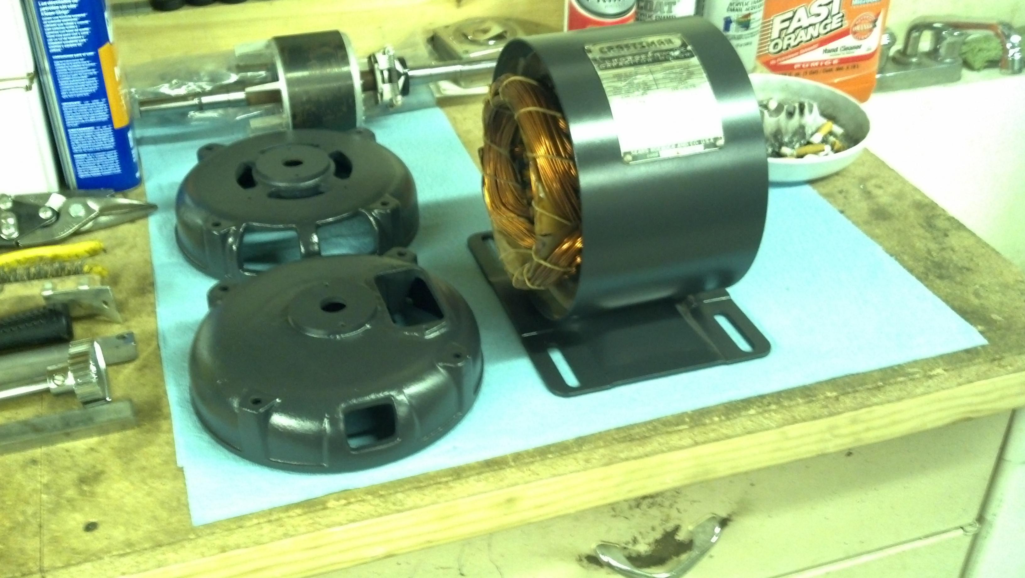

Attachment 14841Attachment 14842Attachment 14843Attachment 14844Attachment 14845Attachment 14846Attachment 14847Attachment 14848Attachment 14849Attachment 14850

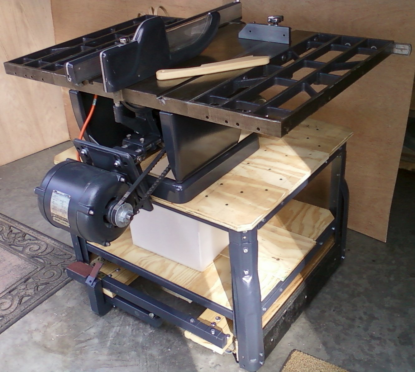

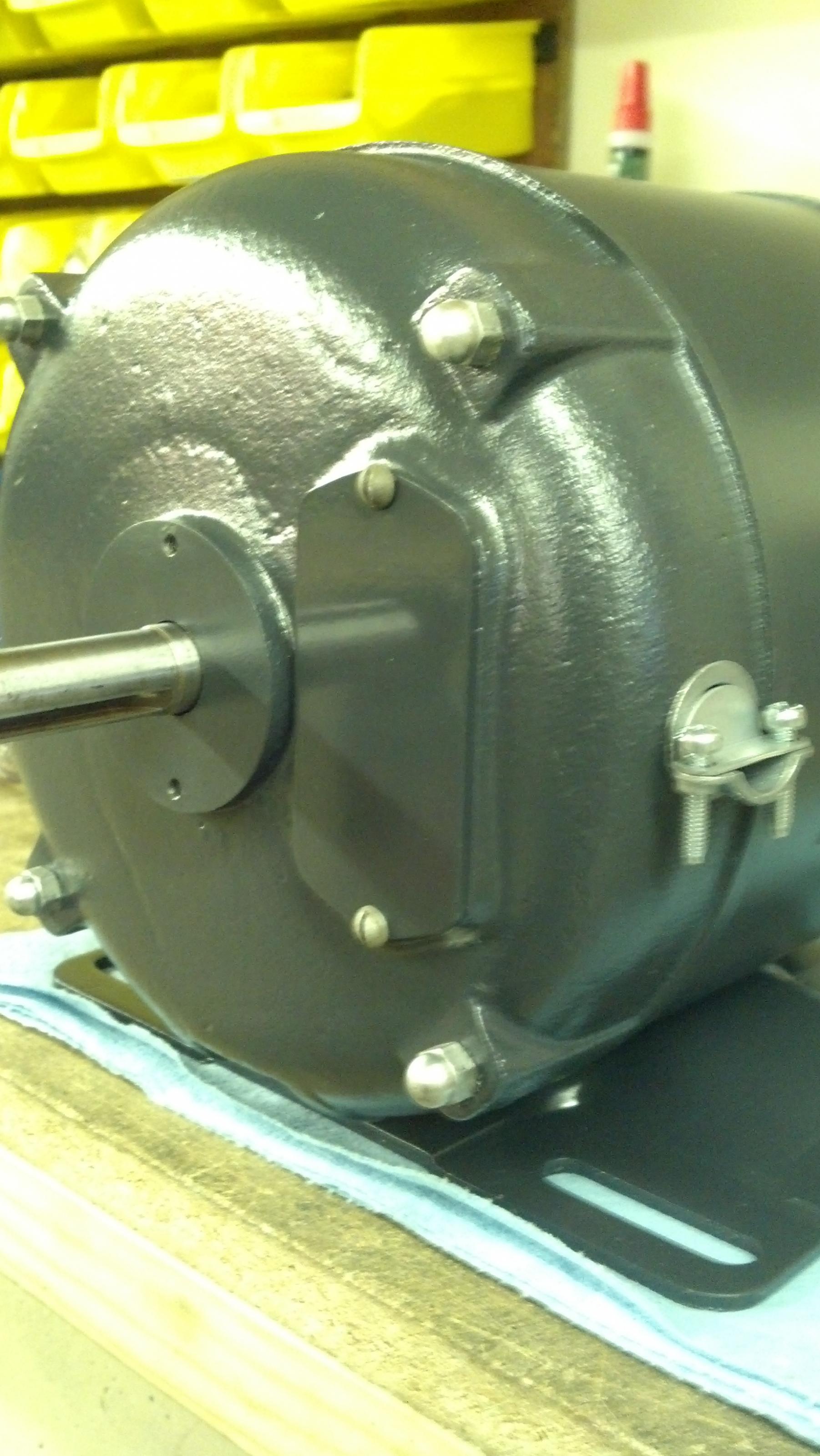

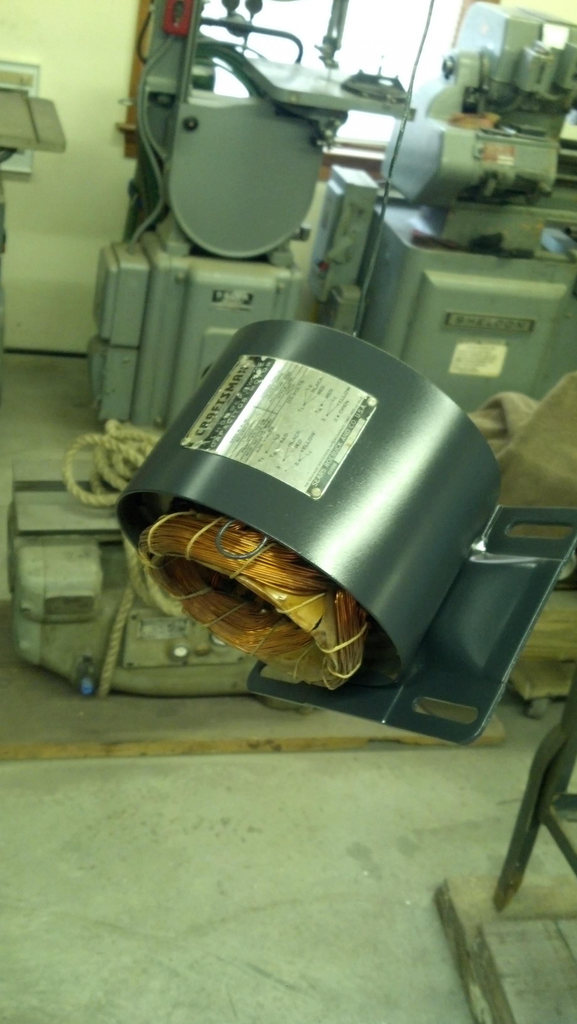

I replaced the bearings in the motor and arbor. Cleaned everything up and painted while in pieces.
Attachment 14851Attachment 14852

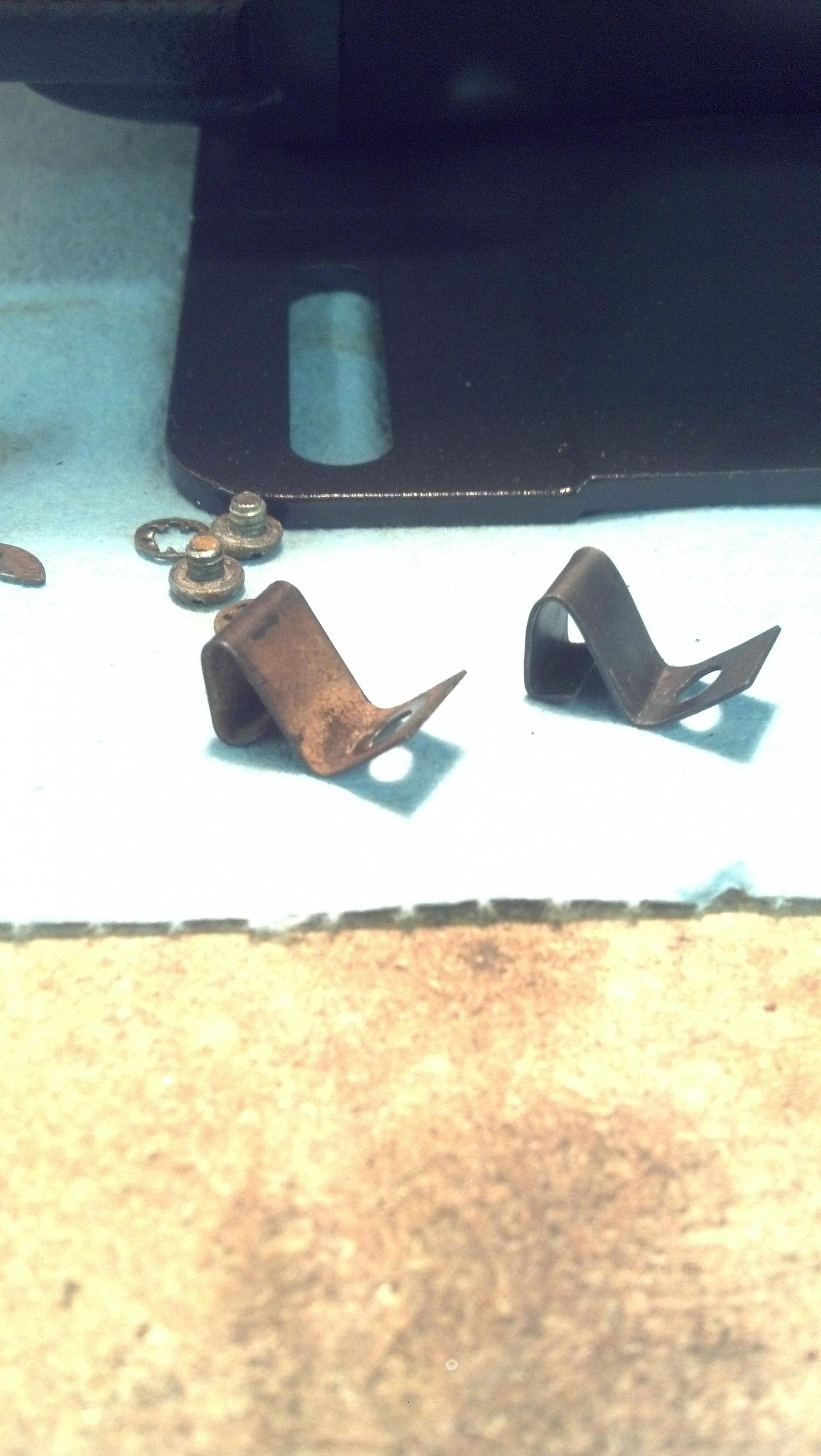

Made the spring lock for the blade insert out of a screen door roller.

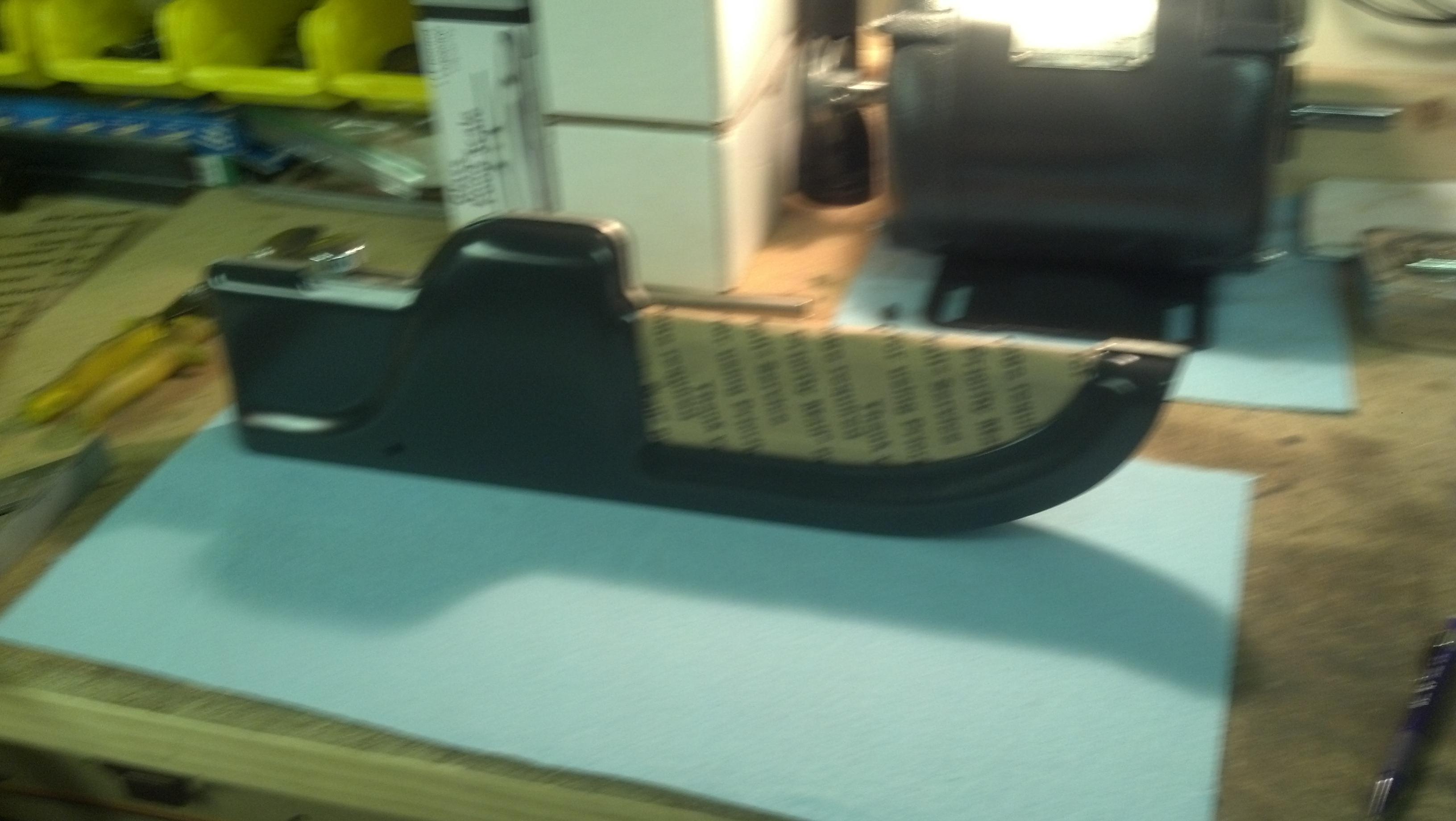

Attachment 14861Attachment 14862Attachment 14863Attachment 14864Attachment 14865Attachment 14866Attachment 14867Attachment 14868Attachment 14869Attachment 14870

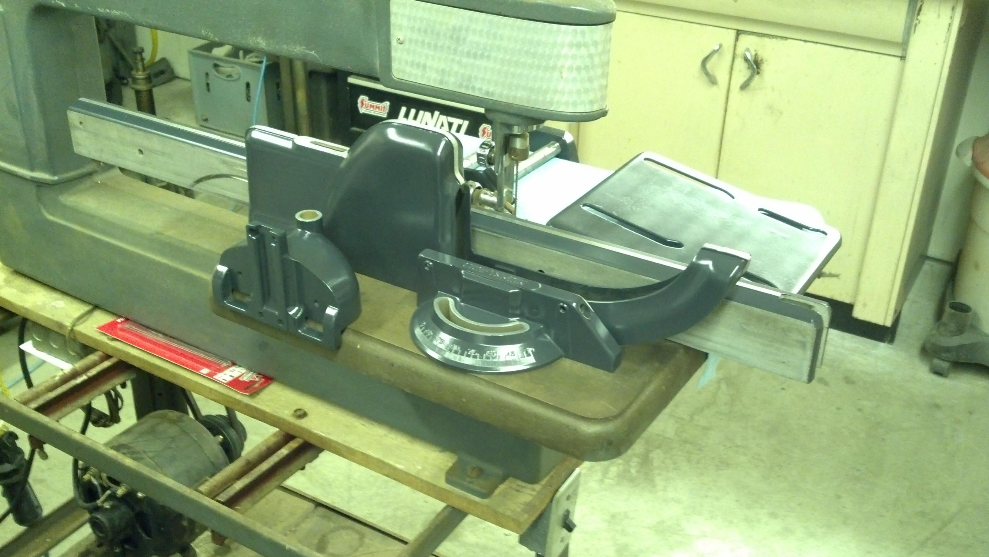

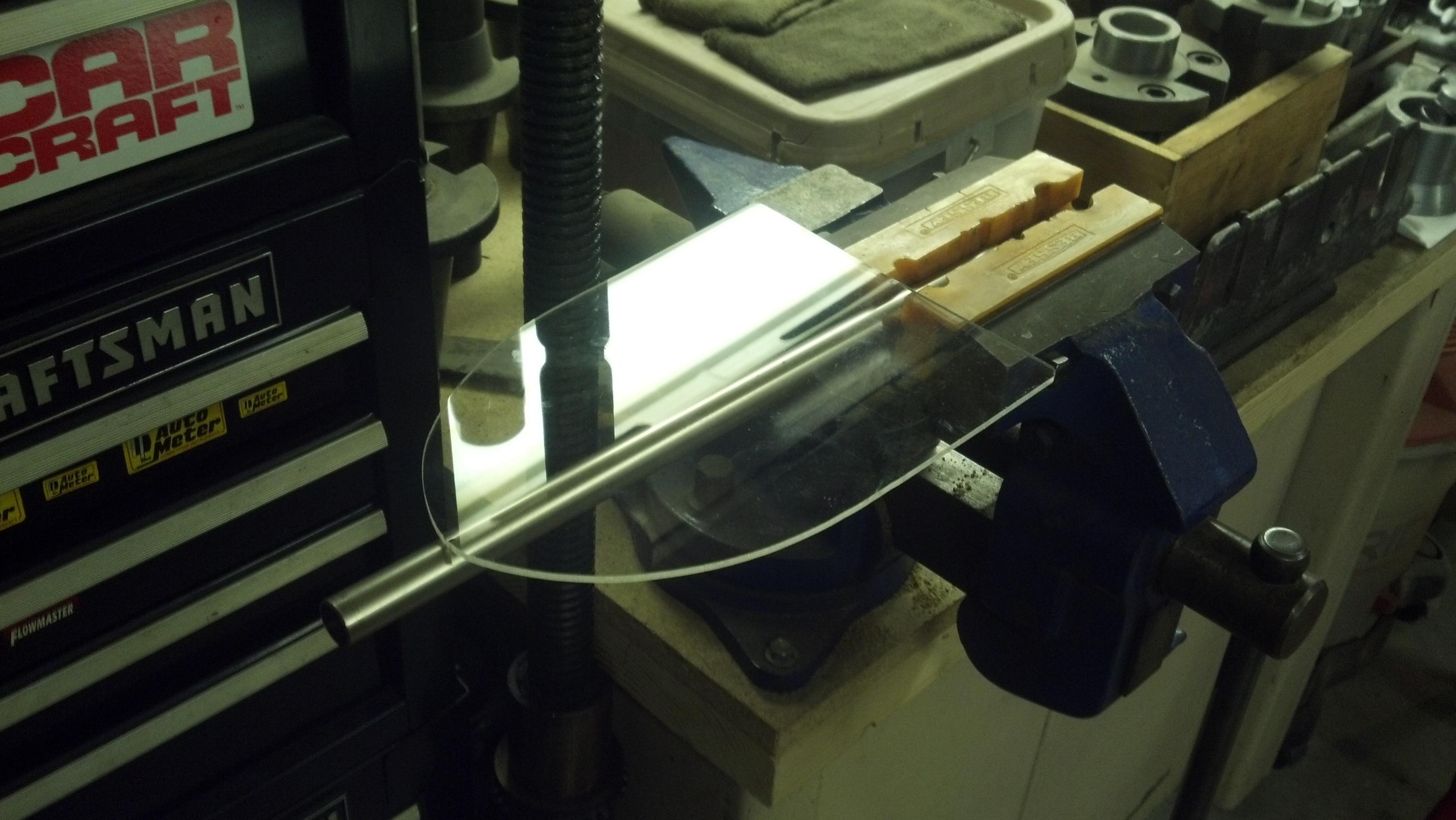

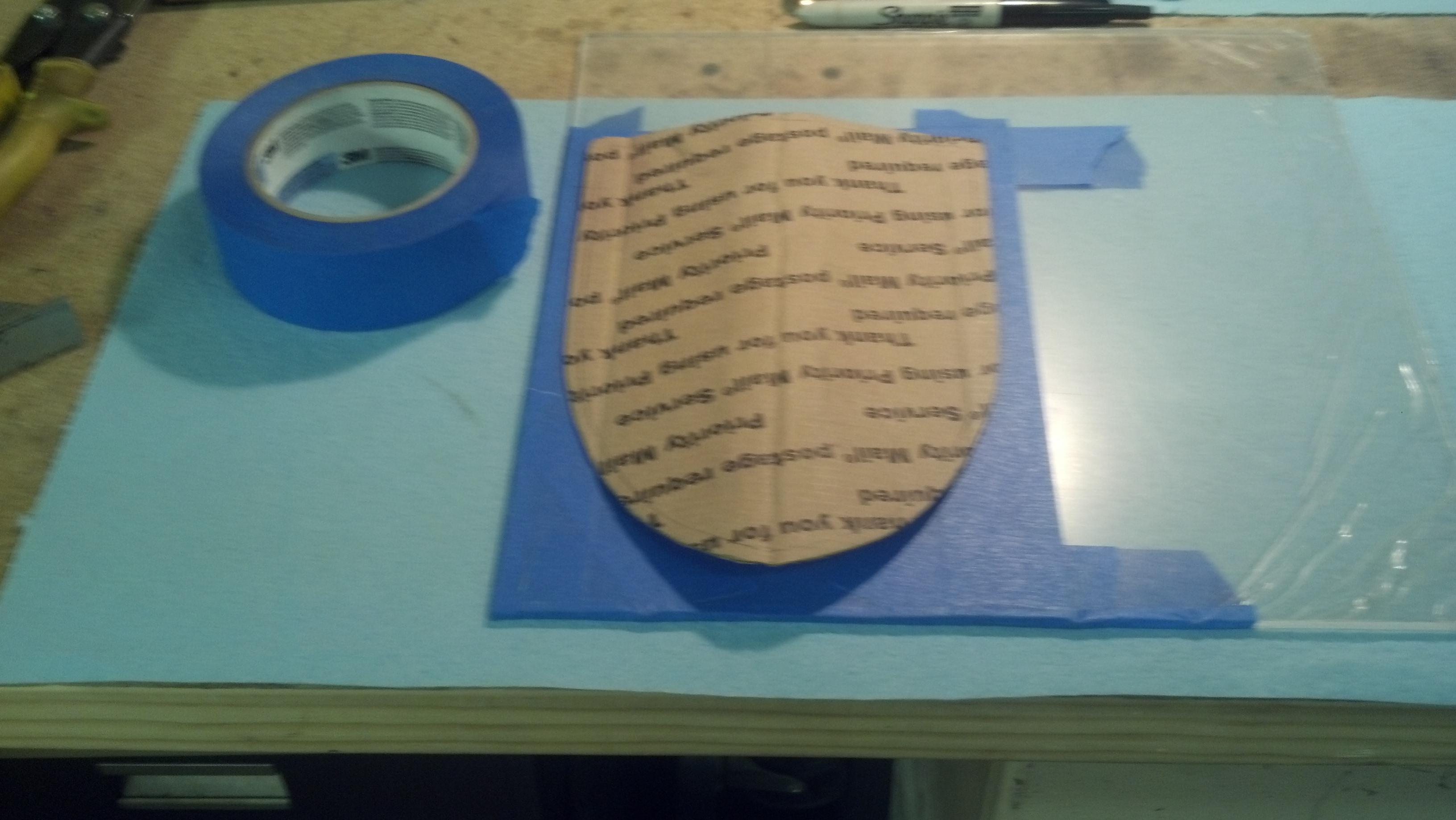

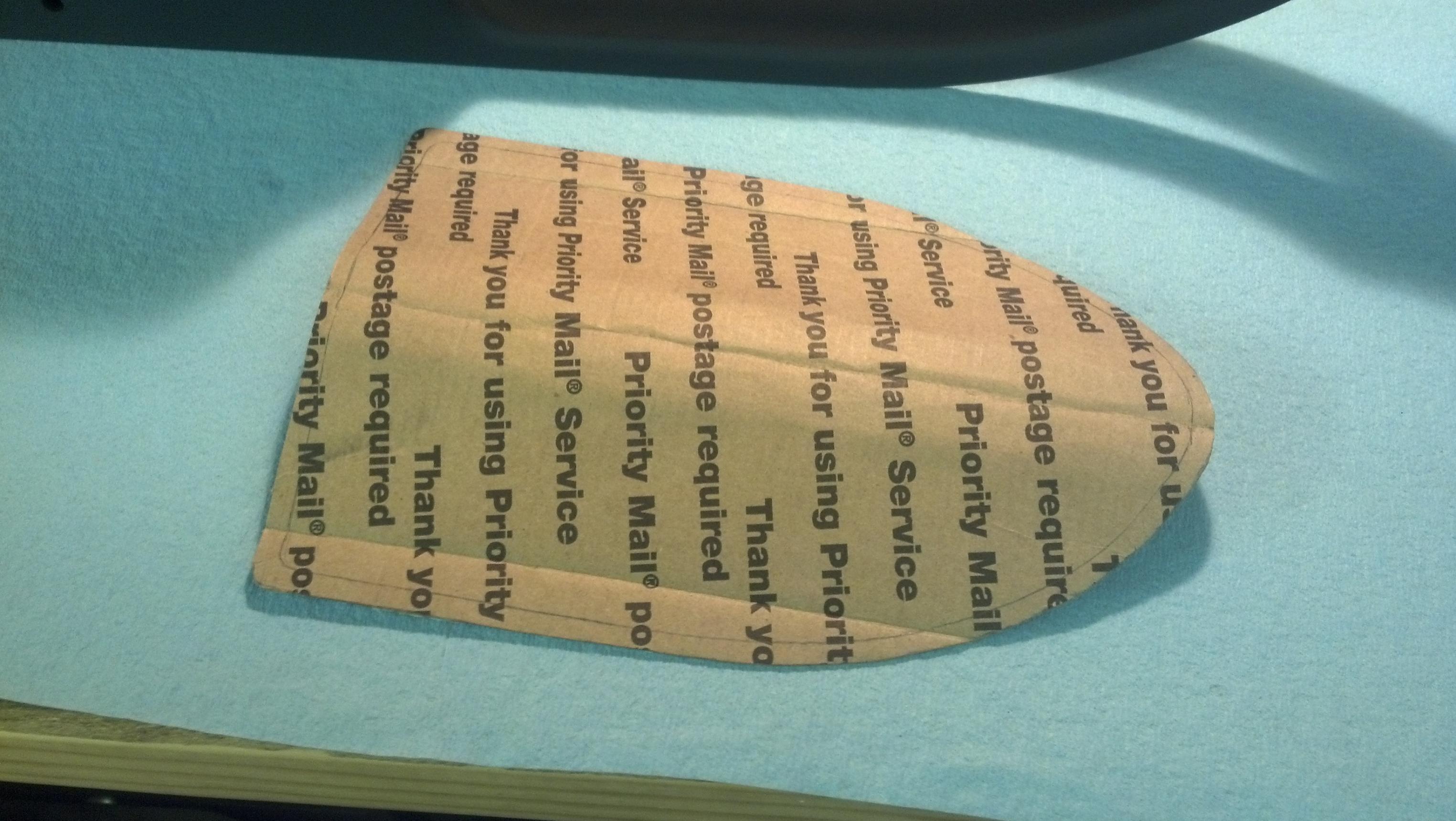

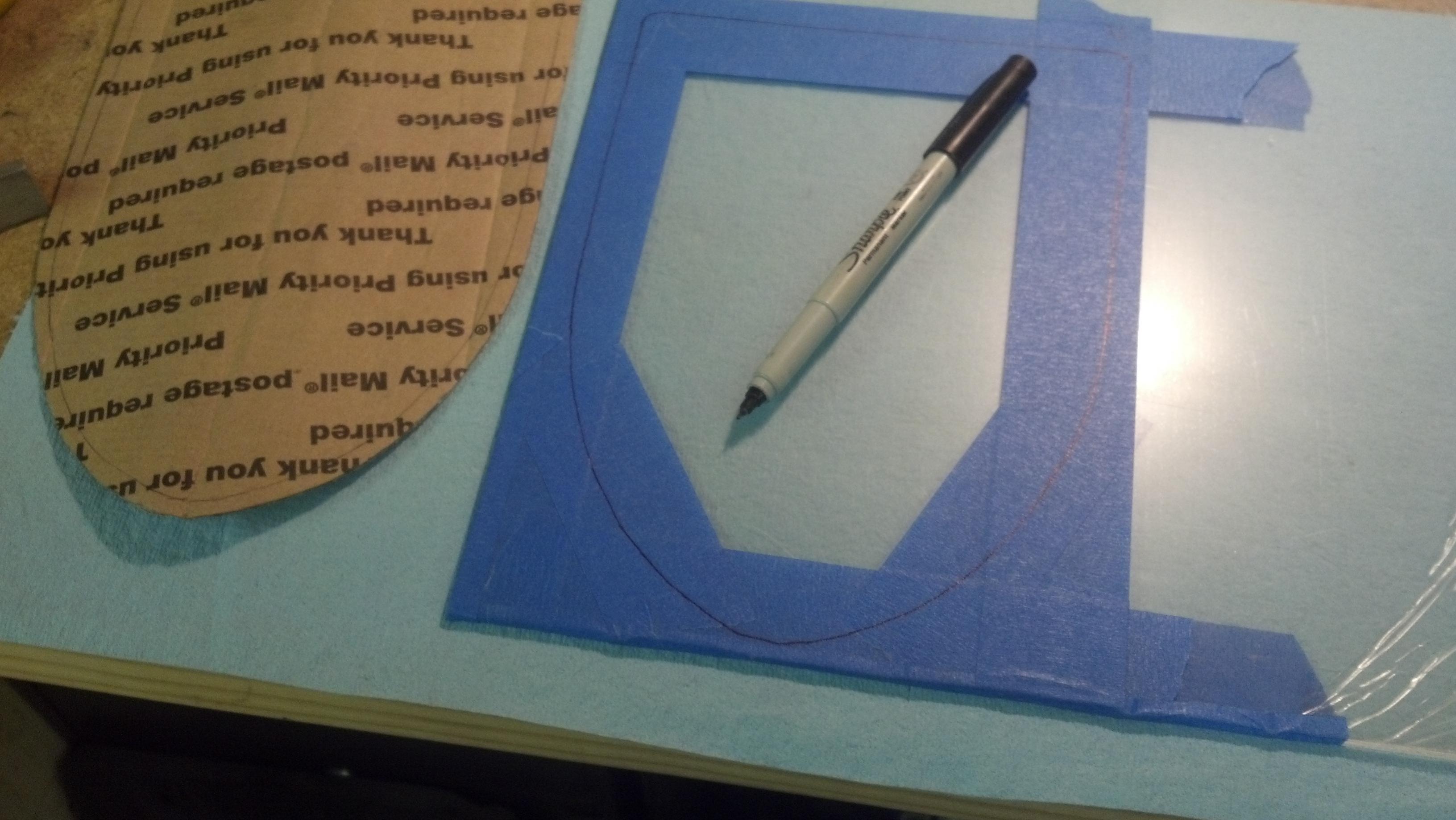

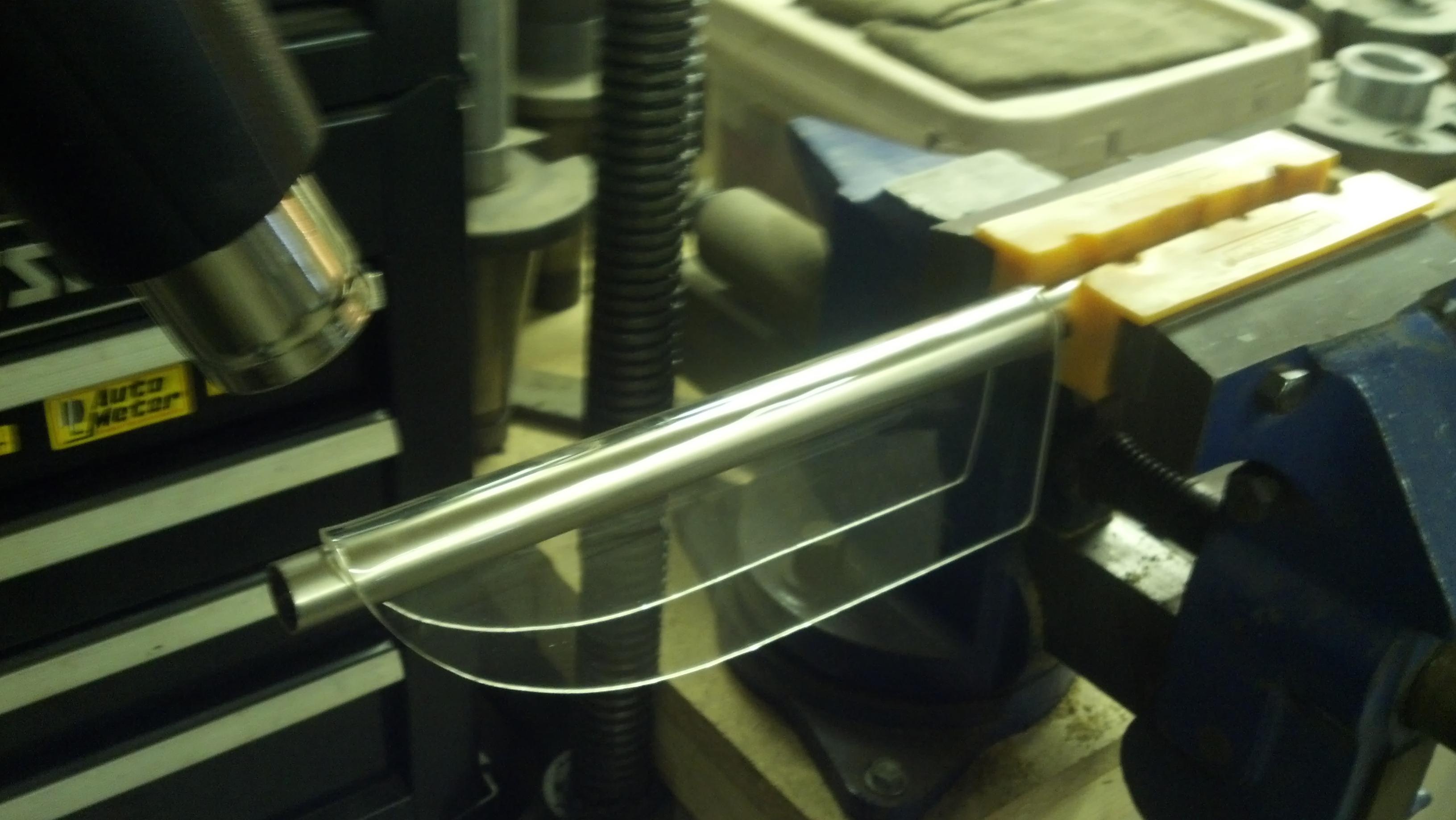

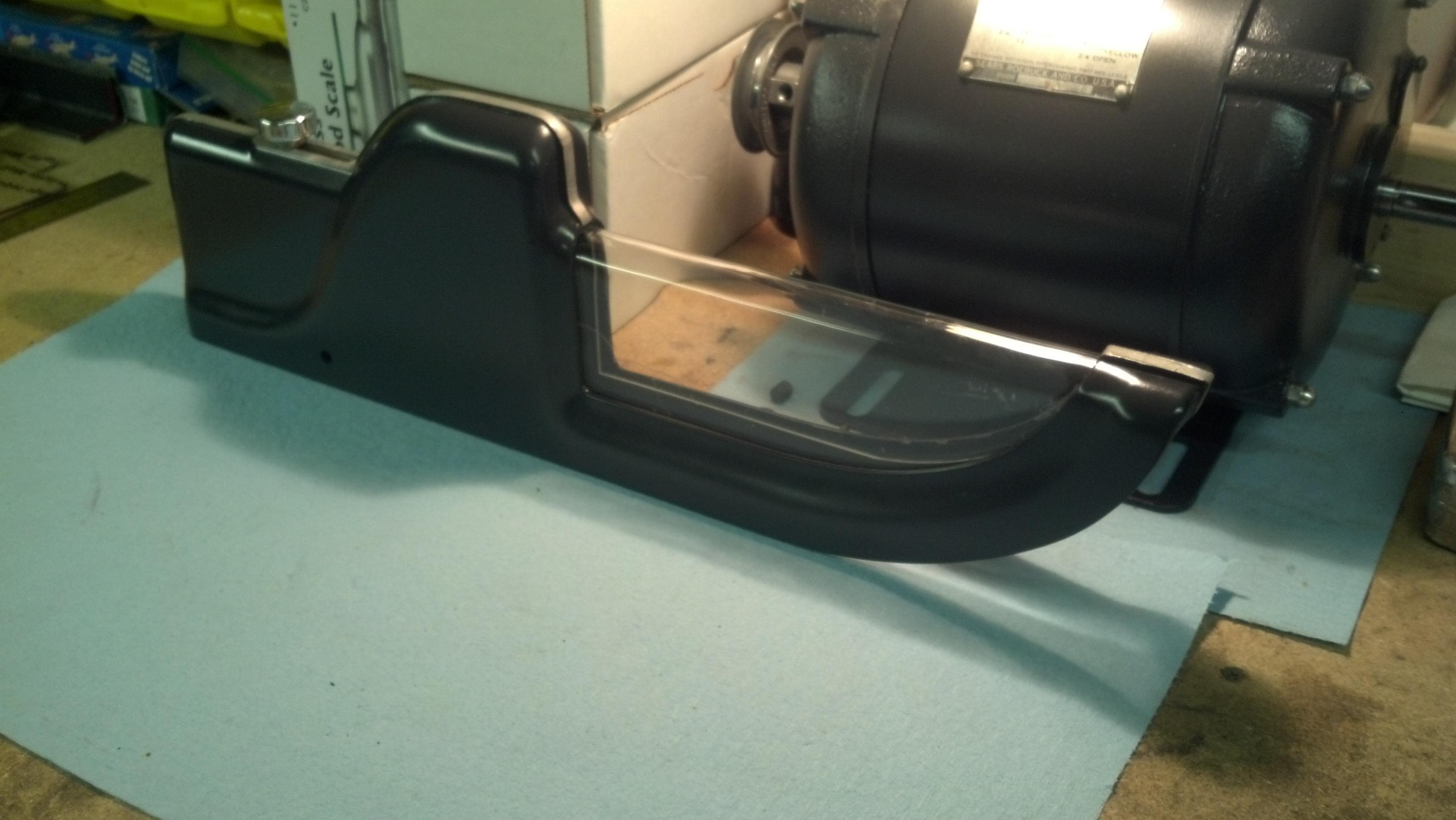

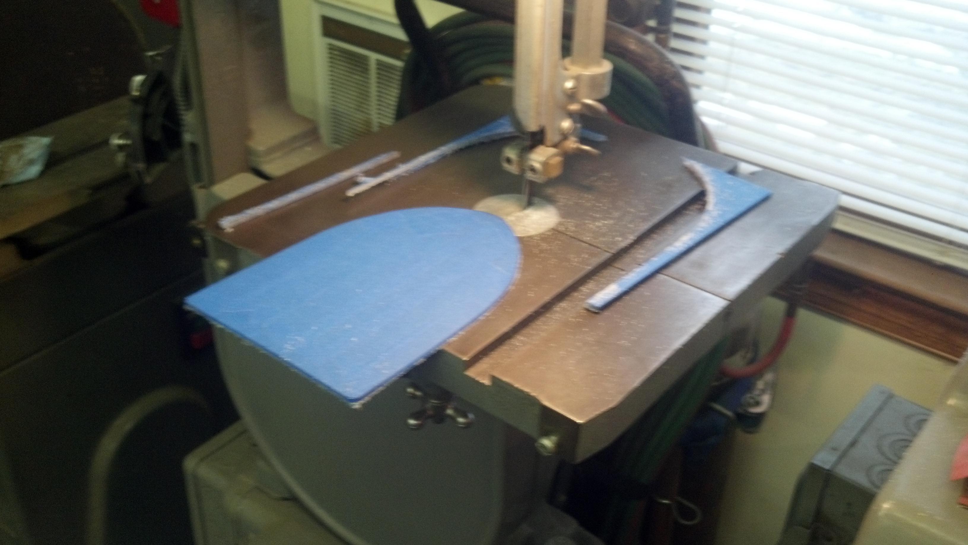

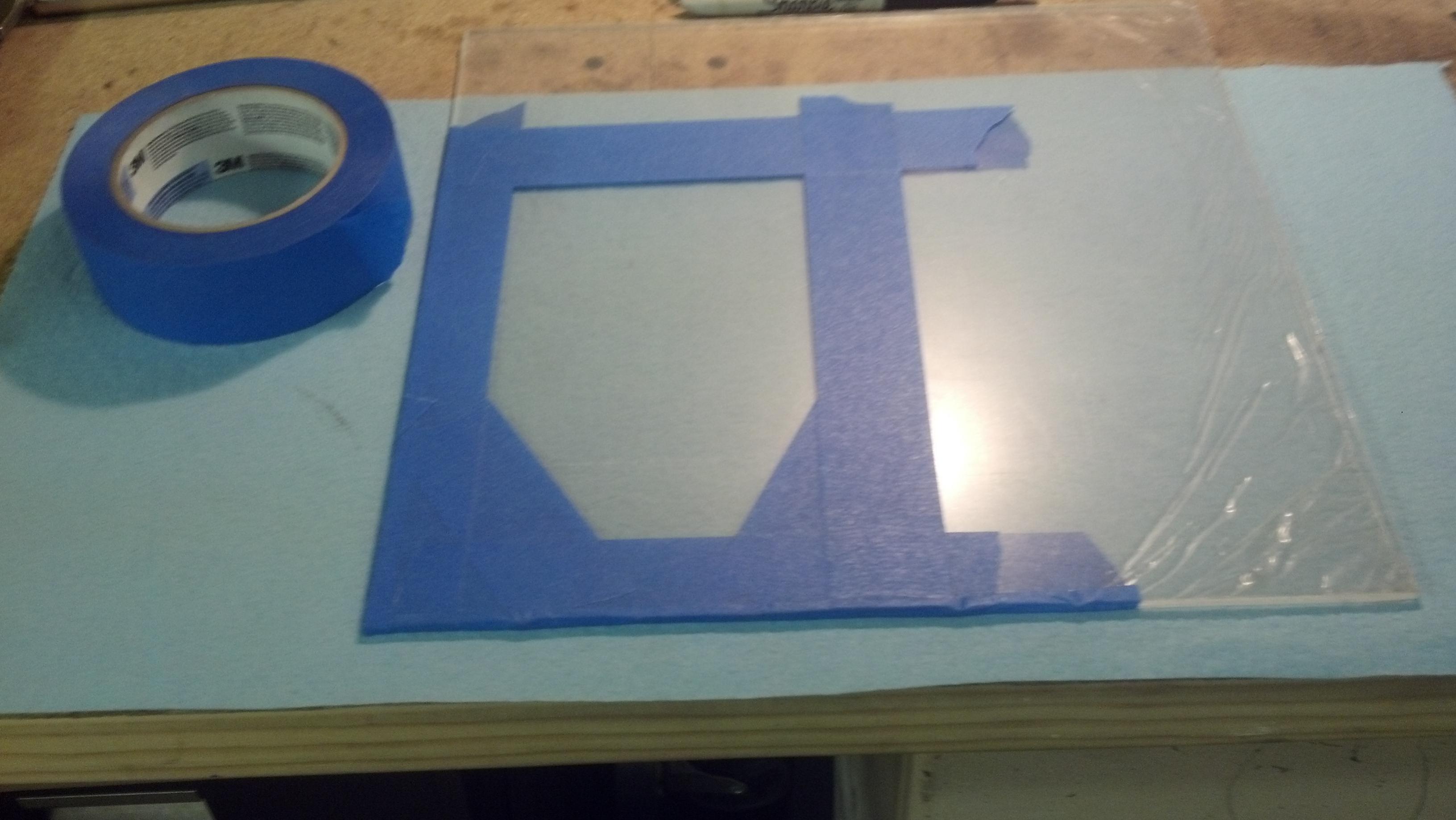

I made the insert for the blade guard out of plexiglass. I used a piece of cardboard to make a template and transferred it to the plexiglass to cut out on the bandsaw. Then I used a heat gun to bend it over a piece of pipe to form the shape.

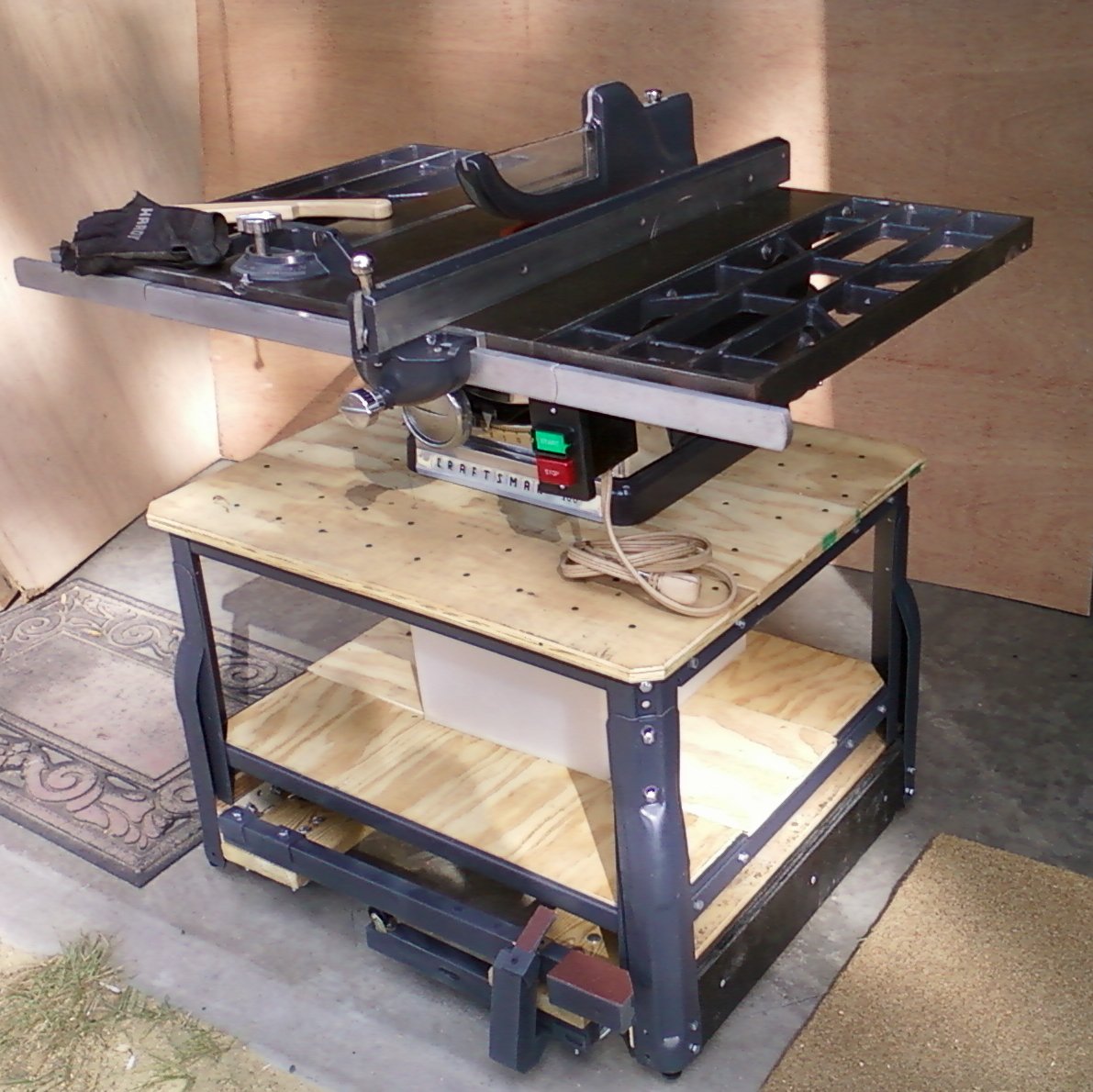

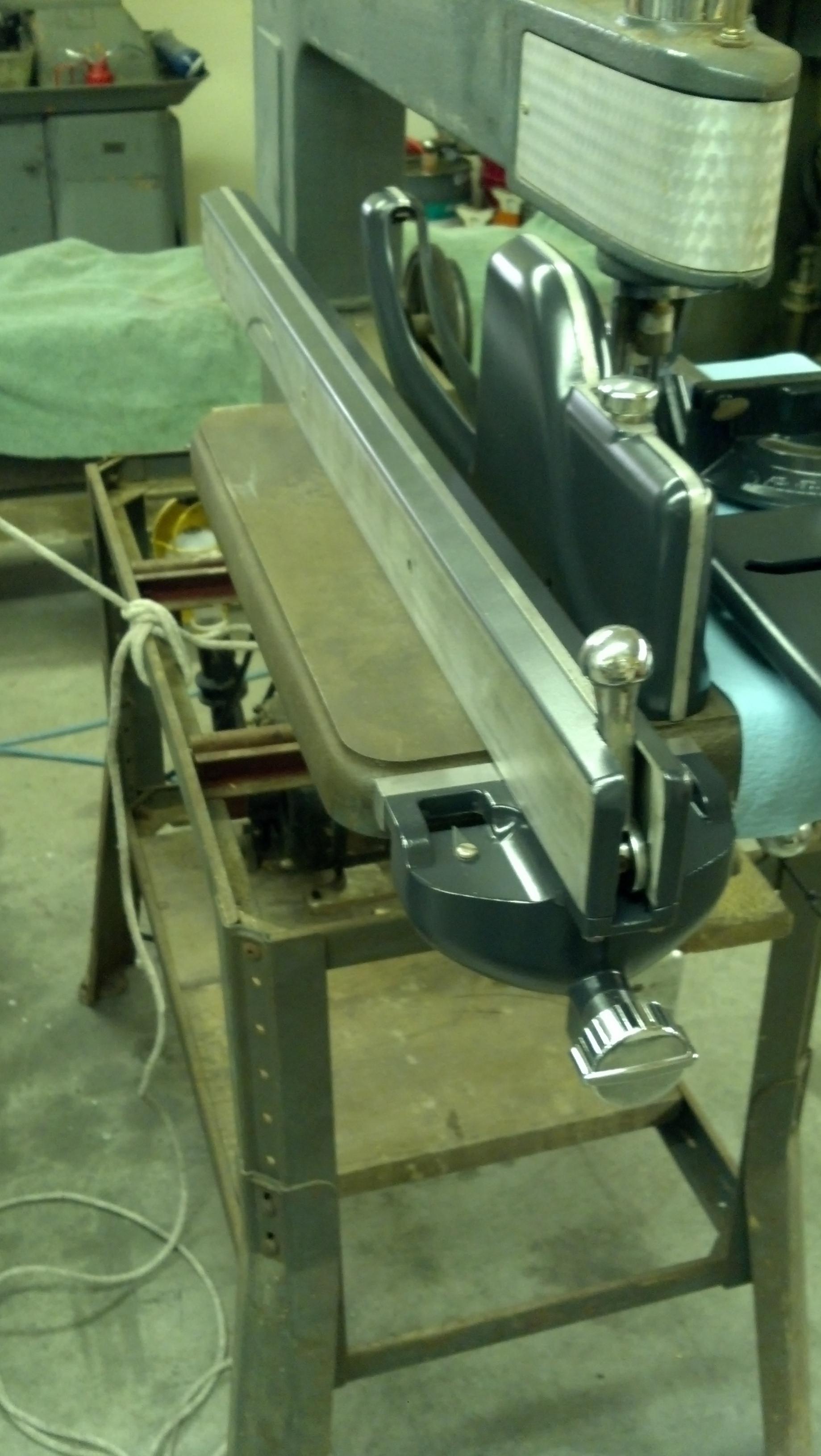

Attachment 14871Attachment 14872

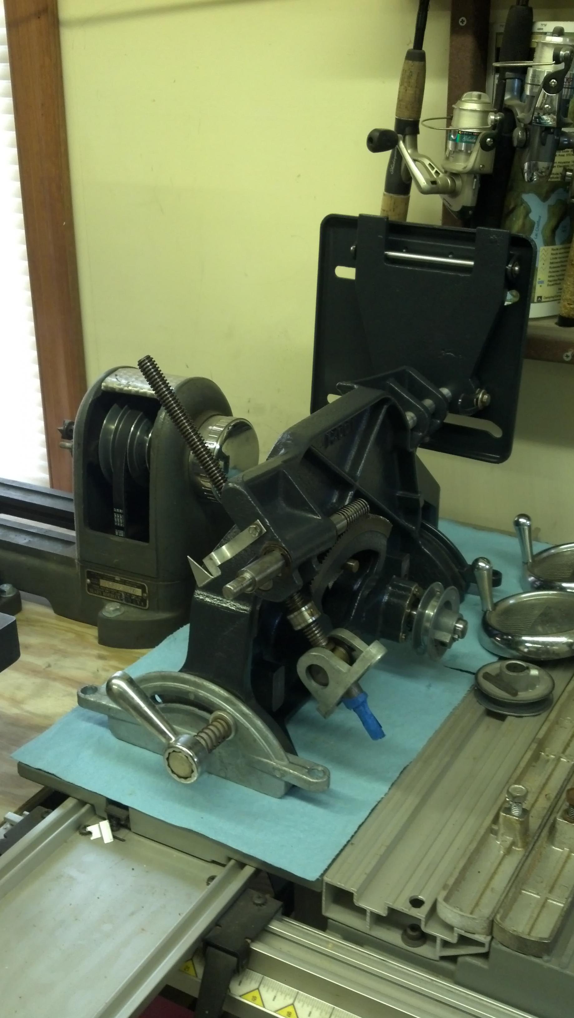

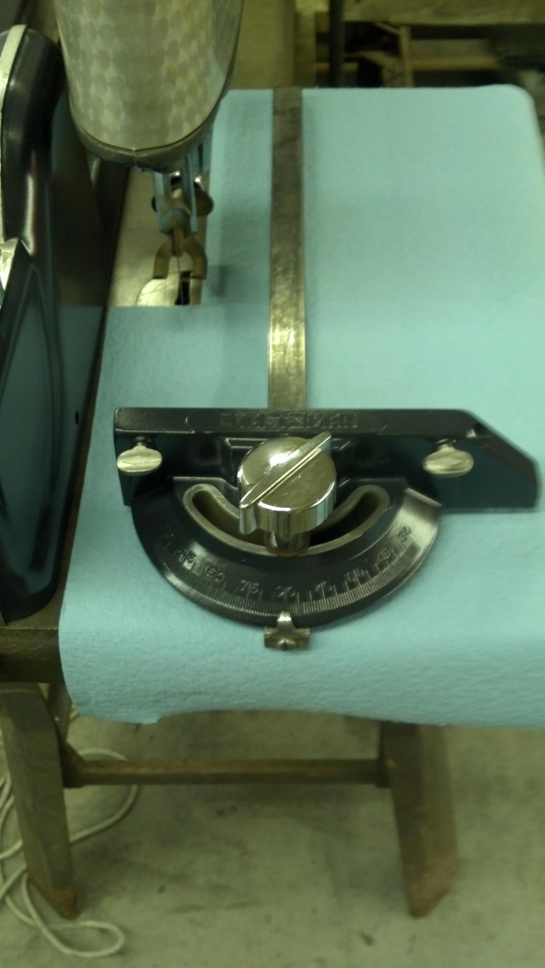

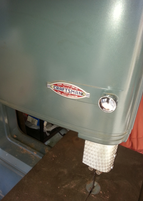

Here is the front and back of Dad's saw.
Wow, Nice Job Mike. The acrylic guard looks Perfect and great idea on the restore. Motor and plate look terrific too, plus a good clean out I bet. Looks from the picture you have quite a few older Craftsman tools...Wood Lathe and the Bandsaw? or Scroll saw? (deep throat). And is that a Clausing I see in the background? Thanks Very much for sharing...The Passion really Shows!

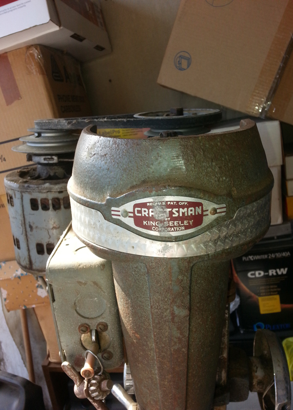

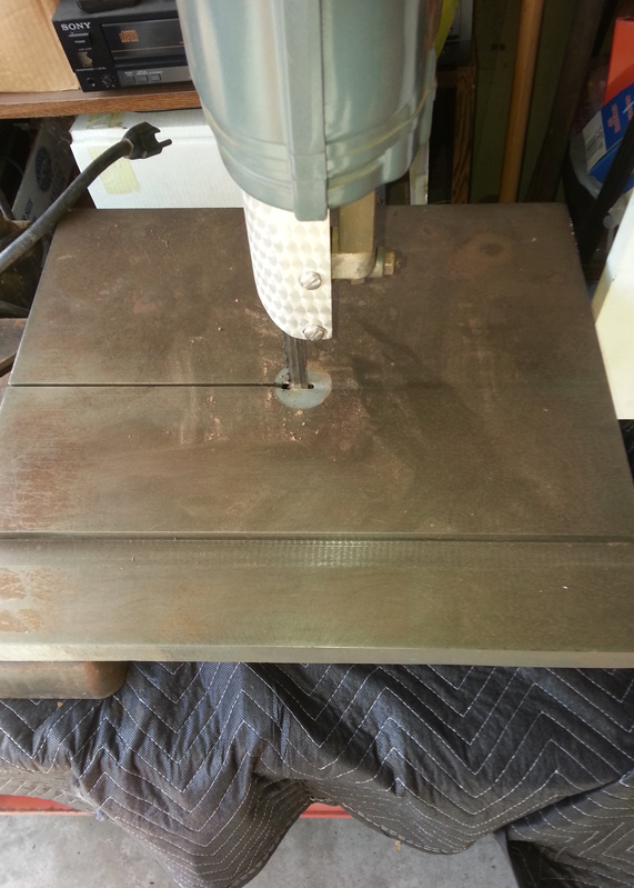

I found out today that I might be wrong about the Matching Pair after talking to who I got them from and their provenance. Turned out he had the number plate. The DP is a 103.23130 but haven't figured the actual date yet so it could be from 48'-55' and the band saw is a 103.24280 which appears to be around March of 52'. Here are a couple of pics. Lots of work yet.

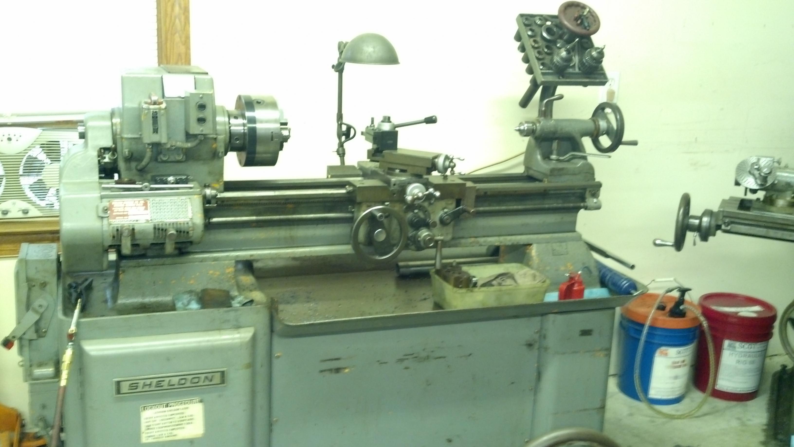

in the background is actually a Sheldon WM-56-P lathe.

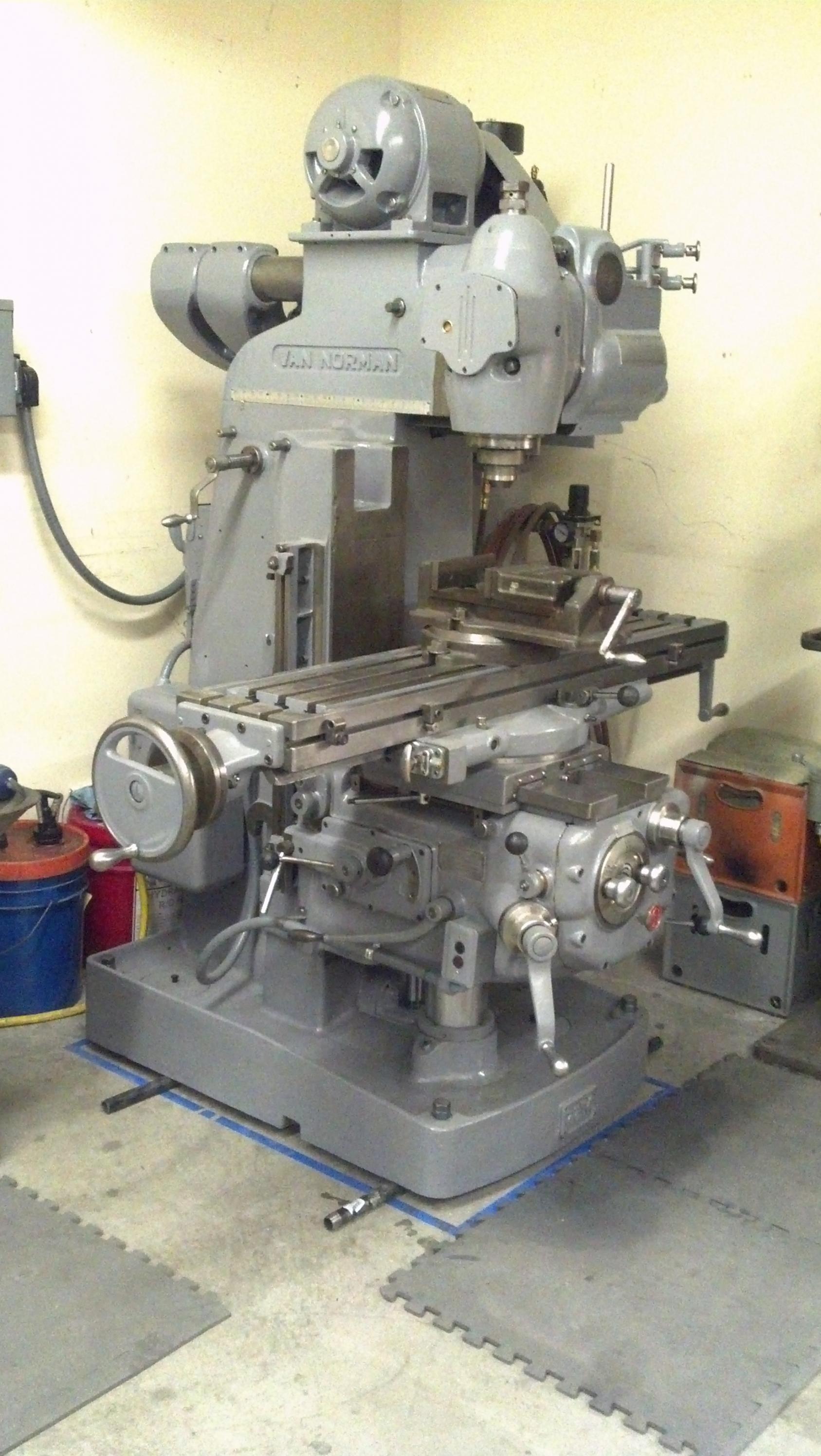

Next to that is a Van Norman 22M milling machine.
The 22M was my latest restoration.

Wow Mike those are beautiful restorations and you are definitely passionate to take on the VN 22M, beast. Oh My!! Hope you have the concrete under it! Do you have the horizontal stuff for it? Couldn't find much info on the 22M but assume its 3x autofeed based on what I can see but the table and lift are beefier than the others I saw. Honestly I'm just a novice to some of this older industrial stuff, but love it, especially bringing them back to life for another long run!
The Sheldon 13" has that look of Built to last and precision...Nice piece of Kit!! Looks to be a later variety (50's+)? My brother picked up a 43', 13"x 6' SB a while back in pretty good shape with lots of extras...on a heck of a deal.
