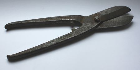

I bought this old pair of Gilbow tin-snips for just 50 pence

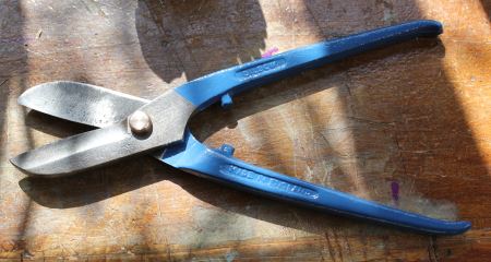

I cleaned them up and made a simple phosphor bronze nut and bolt
The result is a delightful pair of tin-snips where the bearing doesn't bind when they are under load. OK, my time in cleaning them, grinding an edge back on and making the nut and bolt (not so simple in PB) has added quite a lot of cost - or is it just value??
