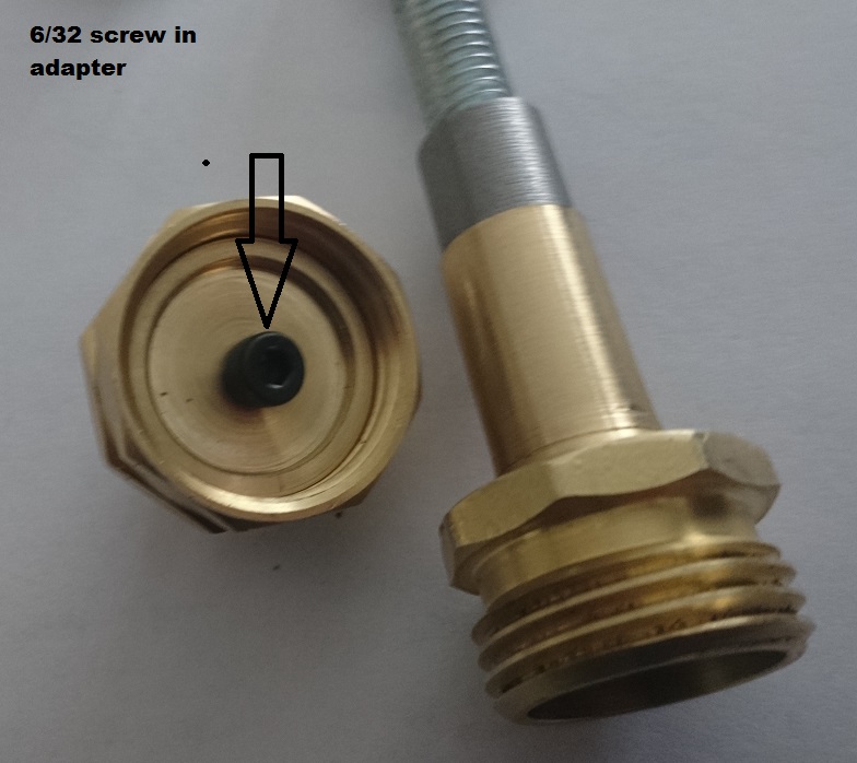

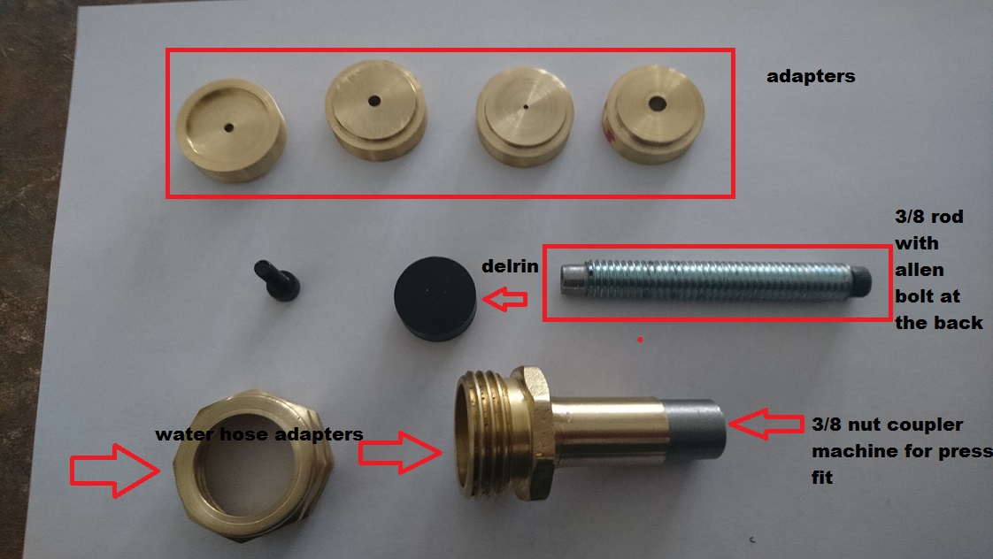

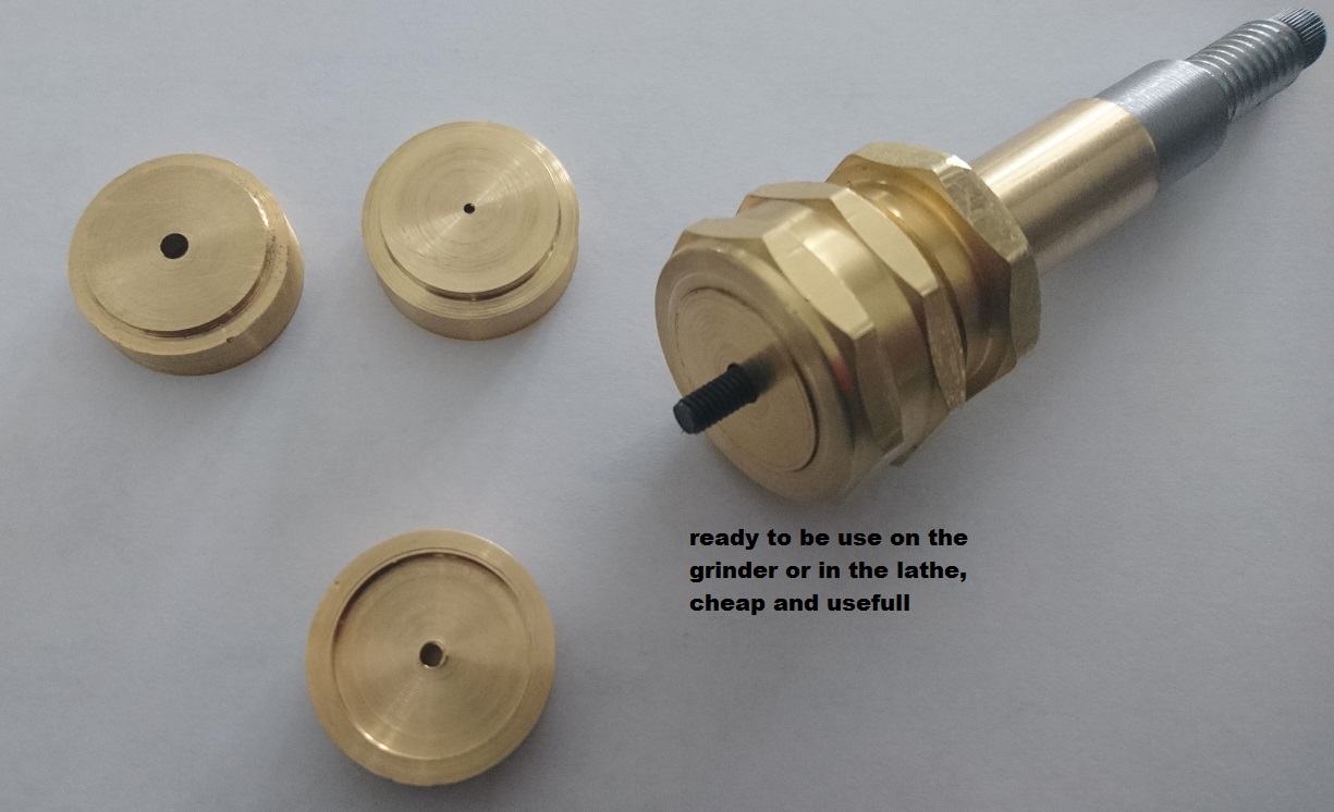

Hi this is my version of lantern chuck.:rolleyes:
it's cheap, easy to make and versatile. It will hold a nail up to a 3/8 bolt.
you could to 3/4 head if you want. the main body are water coupler. one end was machine
so I could press fit a 3/8 nut coupler.I did put a socket head bolt at the end so I can use it in a lathe.

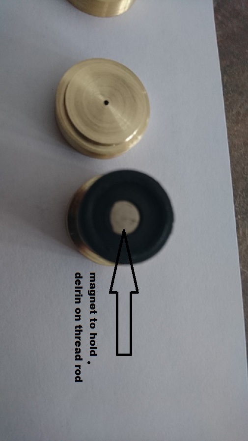

the delrin parthas a magnet in it. It's precise enough you can put it in a lathe to machine a screw,bolt
enjoy the picturesAttachment 27600Attachment 27601Attachment 27602Attachment 27603
